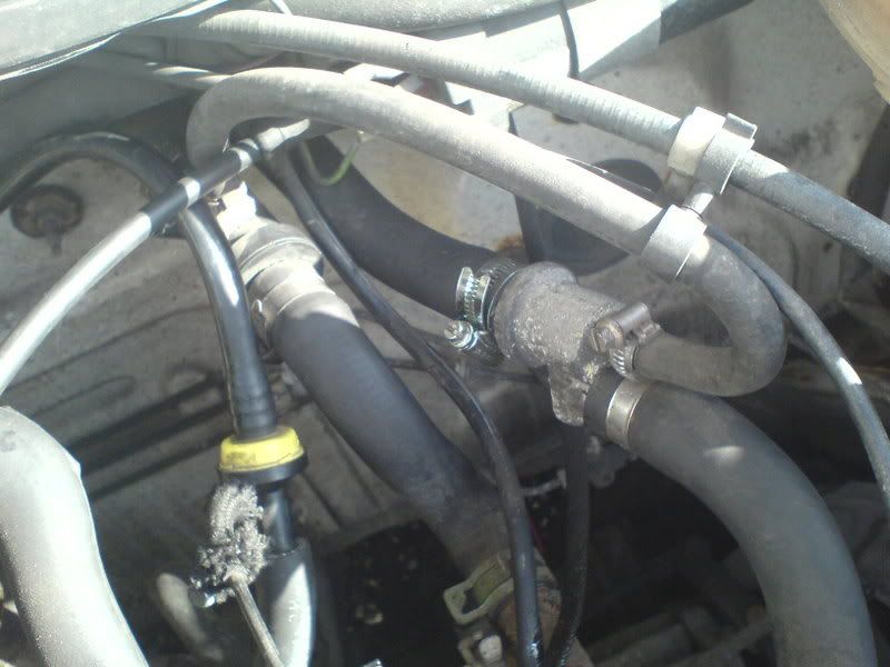

Gavin wrote:The heaters work well, but have no clue on the age of the heater core, nor if there is a bypass valve fitted (how would I check?)
Look at the two hoses that go into the bulkhead and feed the matrix, if it's just two normal looking hoses it's not there. If there's a metal cyclinder and a smaller rubber hose bridging the two larger hoses it's still in place.

Yes mate that is still there. Unfortunately i'm now having the same problem as before the carb was properly adjusted by the garage, where the revs would be high for 2 seconds after turning the key from cold, drop to how the idle should be, and then after 5 minutes the revs will begin to lower until the car stalls while misfiring (all whilst being idle). The car will not idle at all after this happens unless given throttle.
