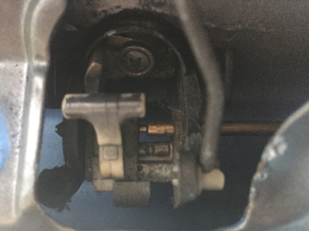

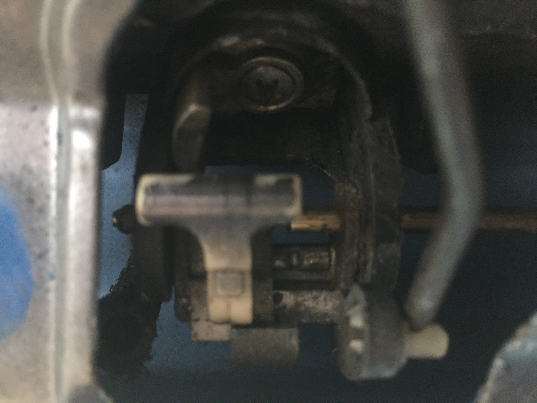

I'm still being thick though, Which plastic tabs am I potentially missing??
I disconnected the washer pipe and have taken a couple of better photos, surprisingly hard to do with the boot in the air and upside down underneath it lol.

Not sure if its the way the picture is but does the rod that runs horizontally goingbtonthe plastic but that's shaped like the letter T?
To me it looks like it's stopped short but, like I said, it could be the picture

Also your locking mechanism looks different to mine.
If I have the T shaped white piece where yours is then the other white bit is in a different position plus your T shaped piece seems to be on the opposite side...Not sure if that makes sense or not
This is my lockImage
Sent from my SM-A530F using Tapatalk

The T-piece slides left and right to locked/unlocked. You can lock the boot with the key which slides the T across, this removes it from the central locking. Meaning your Boot can stay locked but your doors remain open, this stops someone opening your boot and steeling your shopping when waiting at a traffic light in the centre of town!

That makes sense.
Update: Fixed! :clapping:
I lubricated it more and got it sliding with less resistance and during the process of freeing up the mechanism it appeared seemed to engage and started working! :party!:
BIG thanks Eddy & Pootz, really appreciate the lengths you've gone to to help! This forum always delivers with such good people :)
