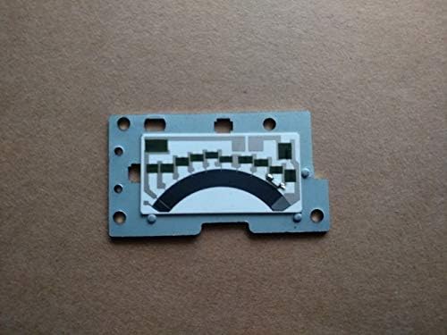

Anyhow this was thrown up when searching... a modern day replacement board for the VW 8v engine MAF / AFM -
Circuit Board
I was aware they were becoming available for the 205 but not others.
The 205 ones get mixed reviews, talk of them not lasting very long, but that's maybe down to poor installation as the originals are very susceptible to damp, hence them failing.
I'd image the re-manufactured ones are the same, requiring the plastic lid to be refitted completely air tight otherwise even atmospheric moisture will cause the resistant material on the board to blur / bleed.
