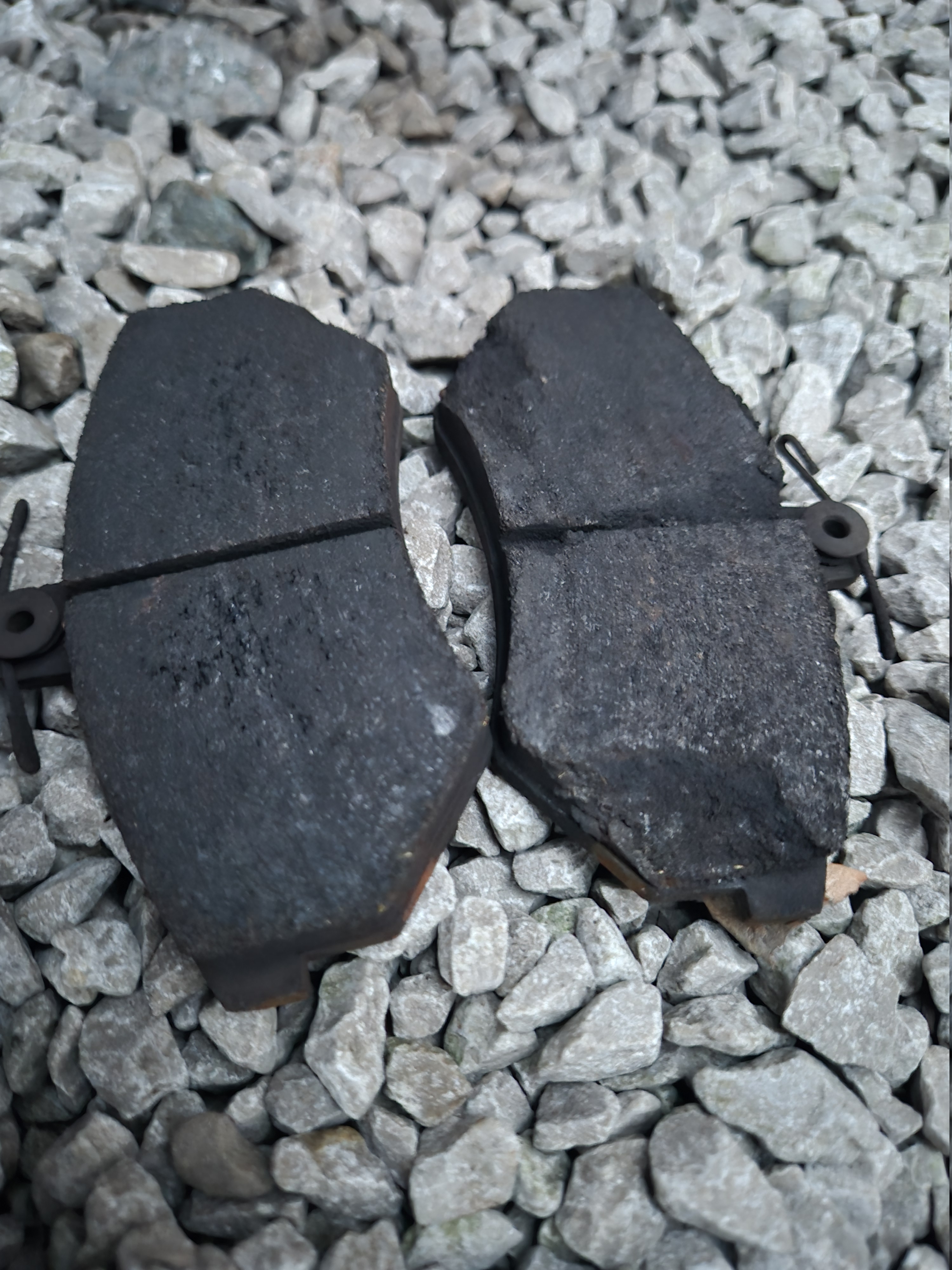

The DS2500s didn’t look too clever either. This is now the second set that has done this to me!

Mintex M1144s came recommended as a good alternative to the Ferodos, so I decided to give them a try.
