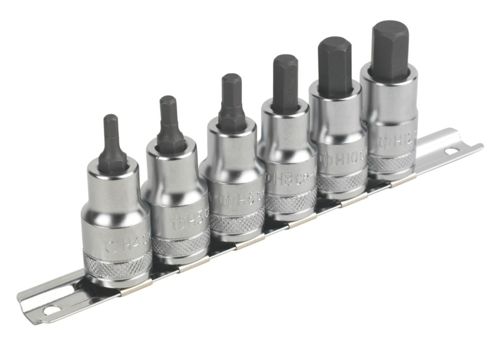

another thing is this bolts. they are long and thin star screws with sleeves put on.
and that might be part of the problem. as from heritage parts centre:
there are also allen screws and sleeves in on piece. as from motointegrator at amazon:
like this i would have it more torsion resistant
but now the heads might become round
plus i do not know how they fit yet.
what are you using ?
edit: the grommet i meant is also on the bottom right of the bolts-picture from heritage parts (second above), i guess.
Re: screws stuck in brake caliper
The bolts tend to be very tight due to the heat generated. As Eddy says get a good fitting tool with a bit of leverage they free up once cracked.
