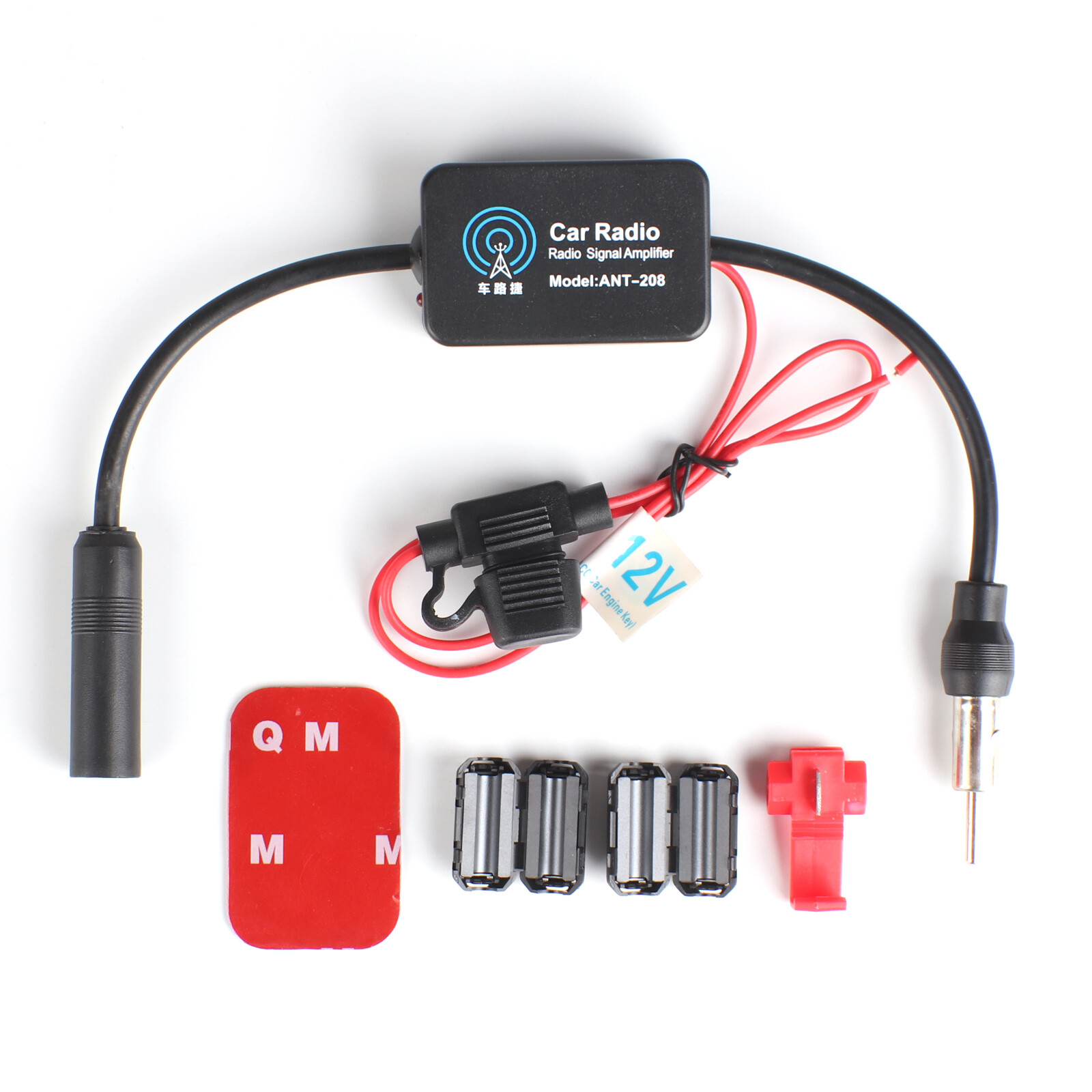

First, the roof areal is rubbish but looking for a quick win I bought an FM amplifier of eBay for a fiver.
It made things better, I could pick up Radio 1 outside of work, but still had a couple of miles of radio black-out on the M5.
Needless to say i didn't use the red scotch block, I crimp fitted a bullet and plugged it into the radios blue accessory feed so it only comes on when the stereo is on.
