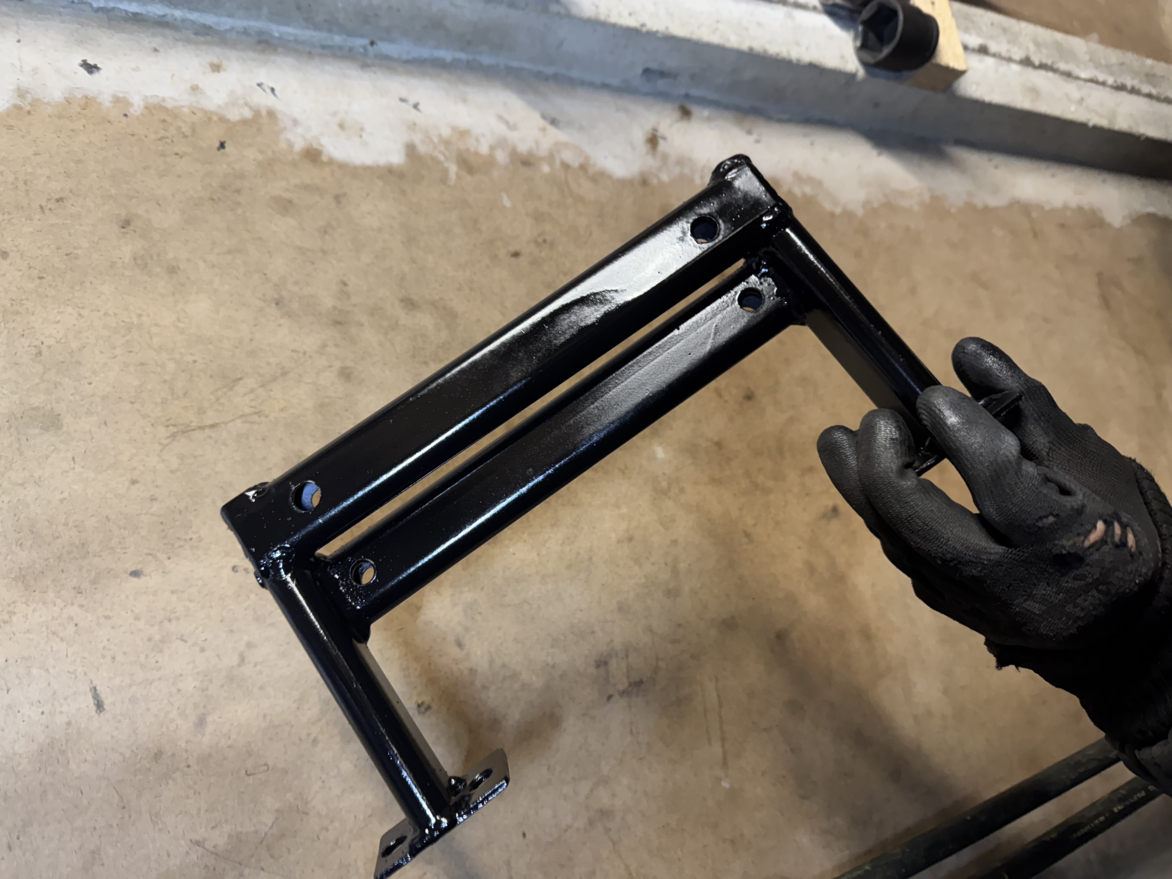

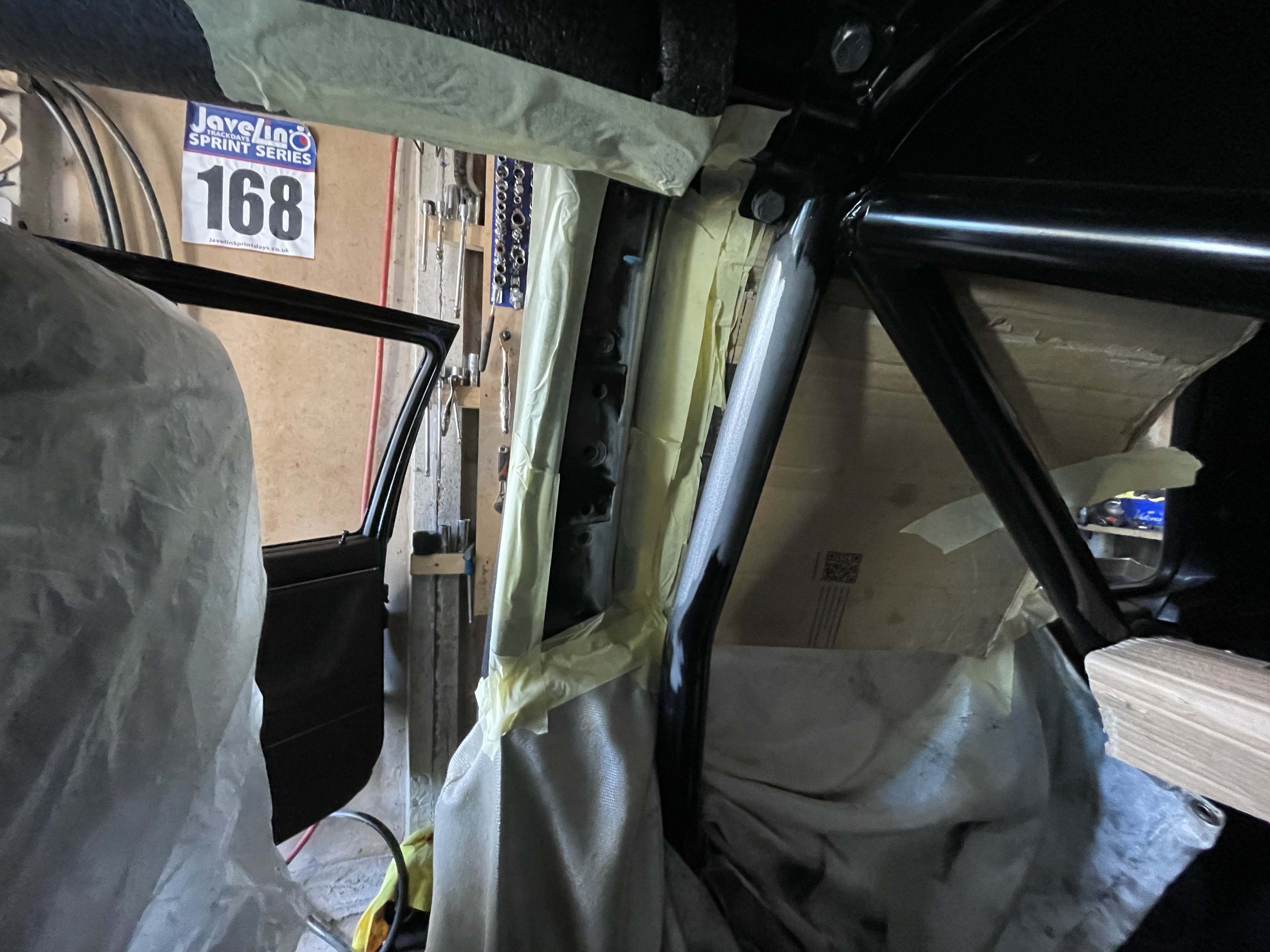

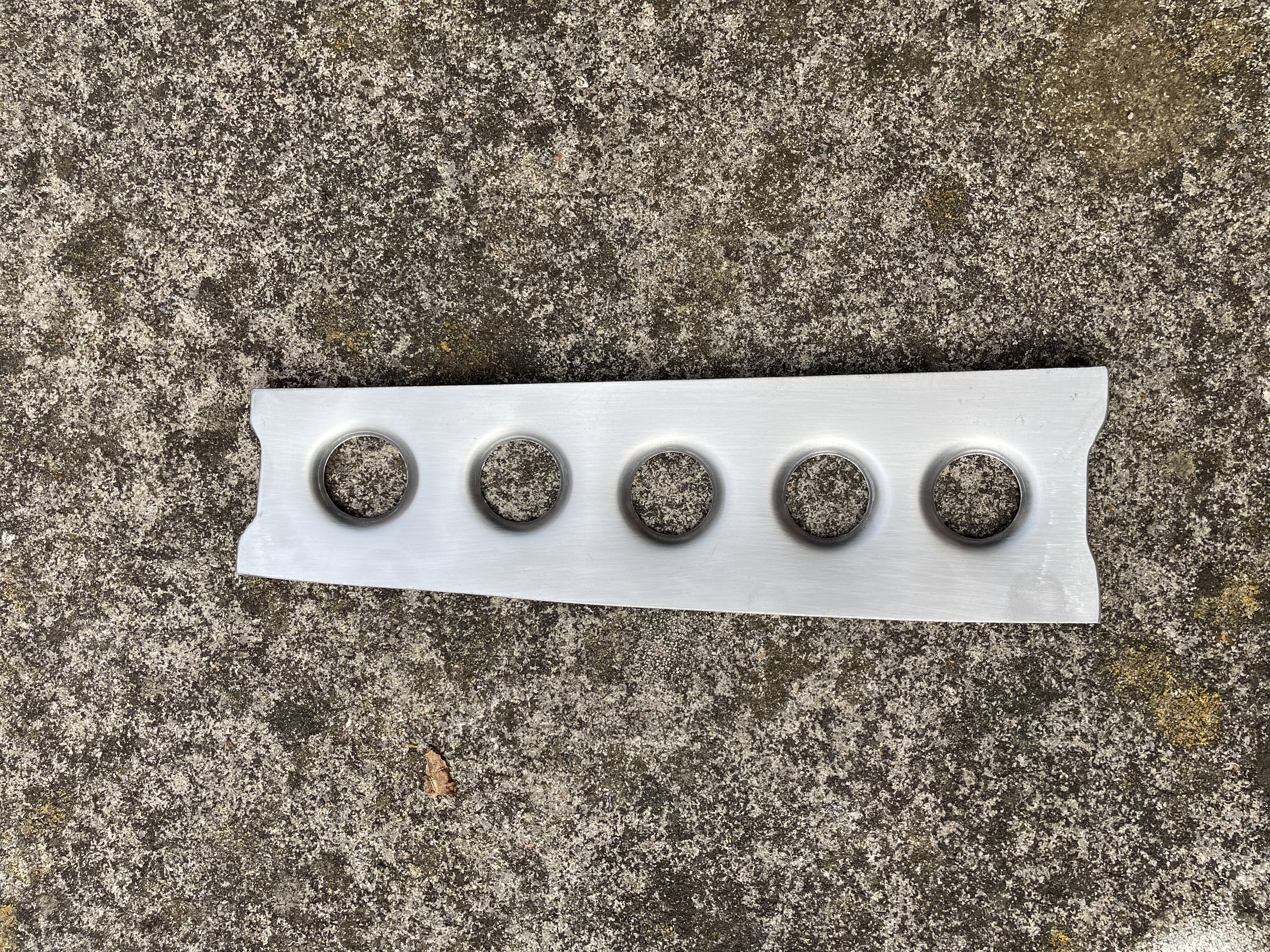

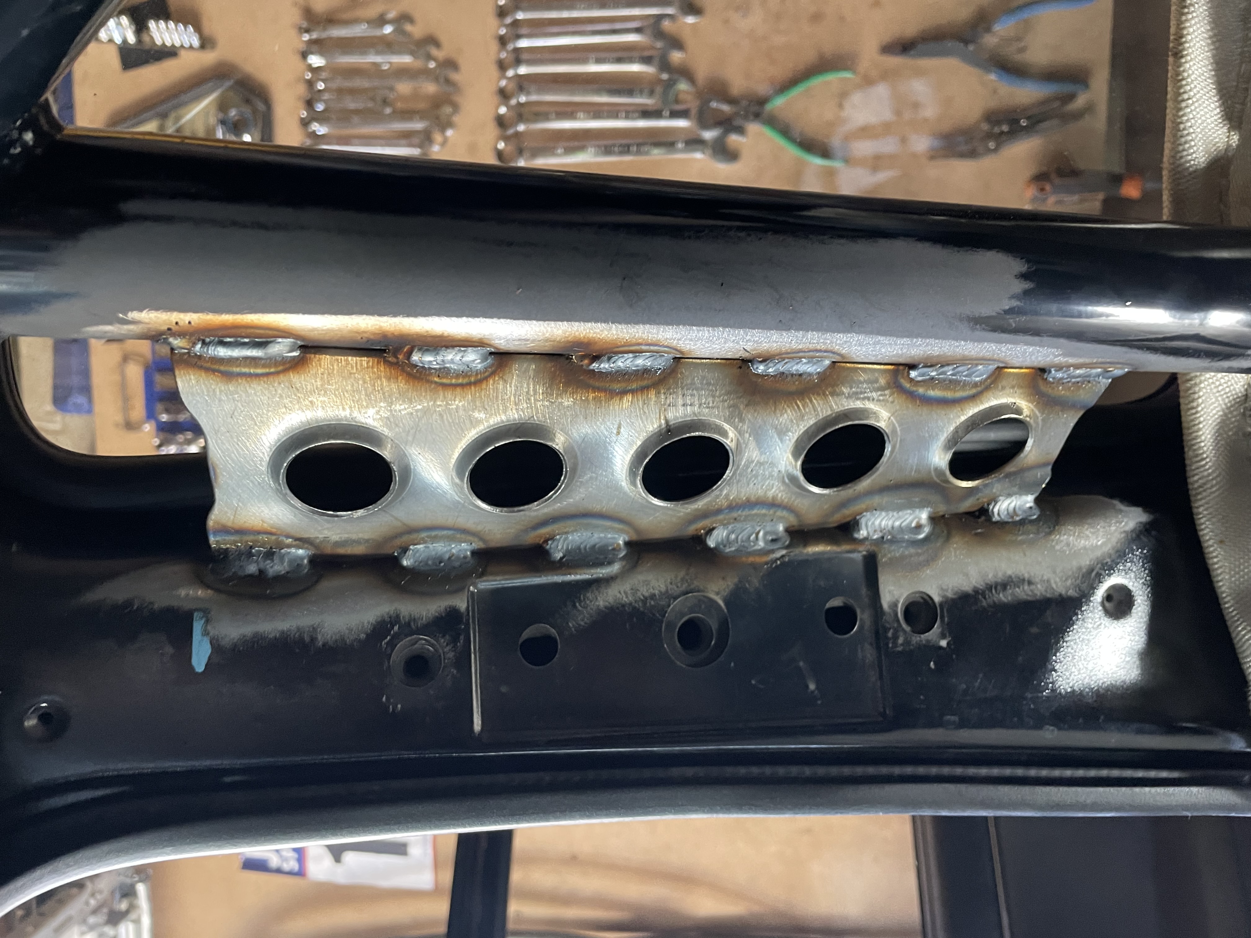

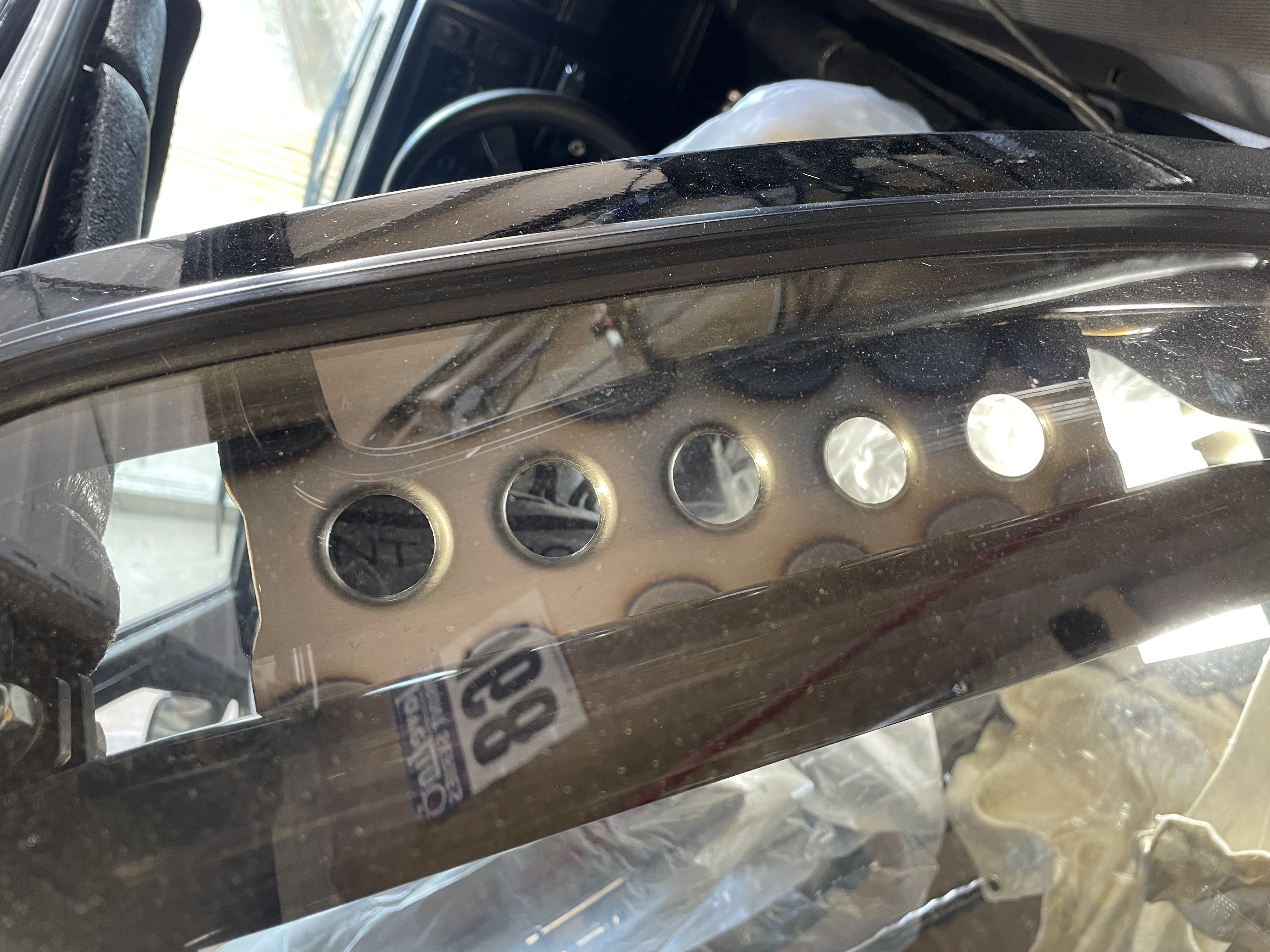

I finally got round to designing and making some B pillar gussets for my cage.
Started out by trying to design something I liked the look of, I find it a challenge to make these look “right” and get the angles of the gussets correct.
Transferred what I had on paper into some steel.
I didn’t want to have to strip the interior so I used a large fire blanket on the floor and protected everything else with cardboard and tape.
Got them all welded in, took a few goes to get the welder set up right, but came out okay in the end.
This was then epoxy primed, and painted satin black. I’ve not got the car out of the garage yet so I don’t know how it all looks in the daylight, but so far I’m pretty happy :)

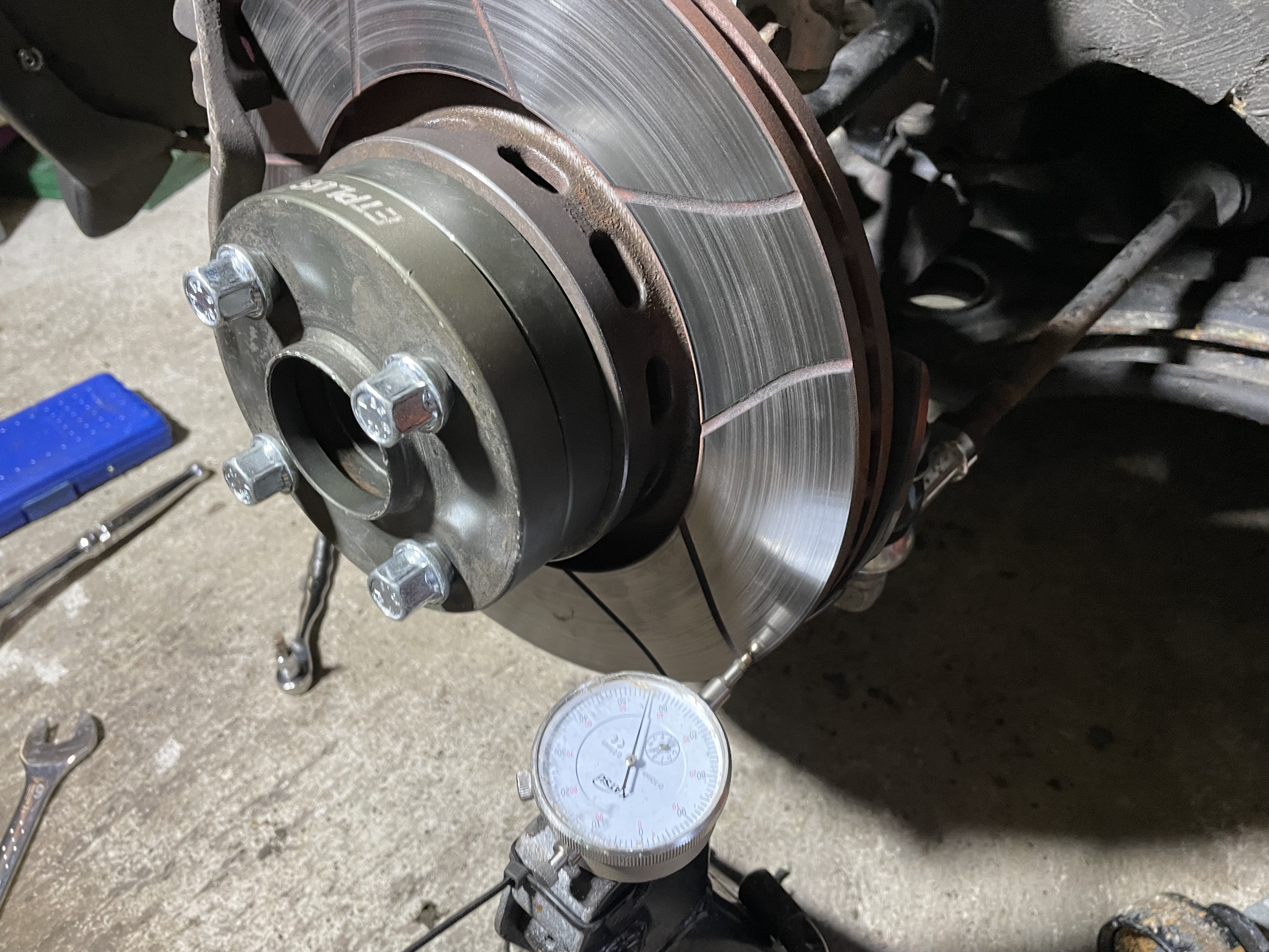

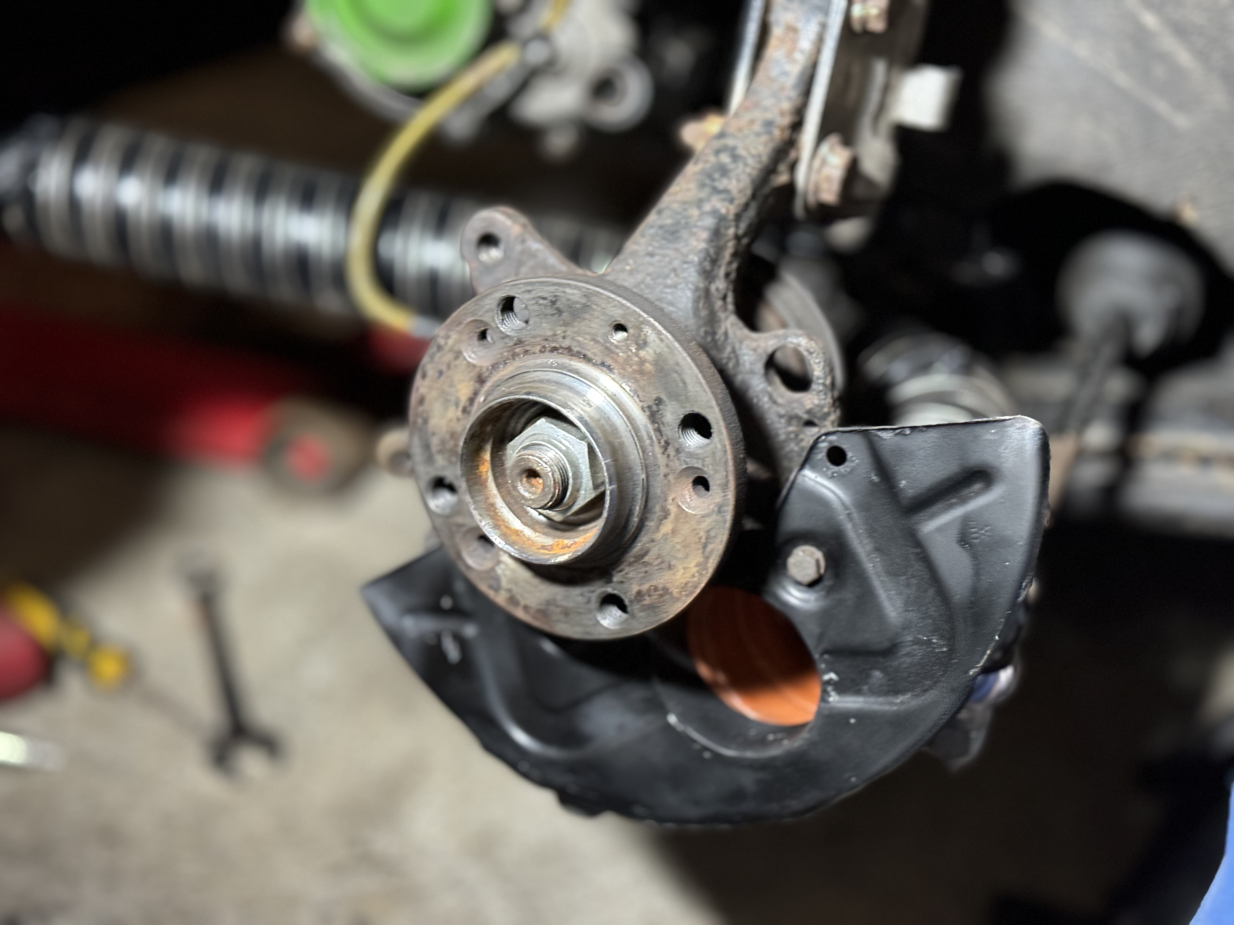

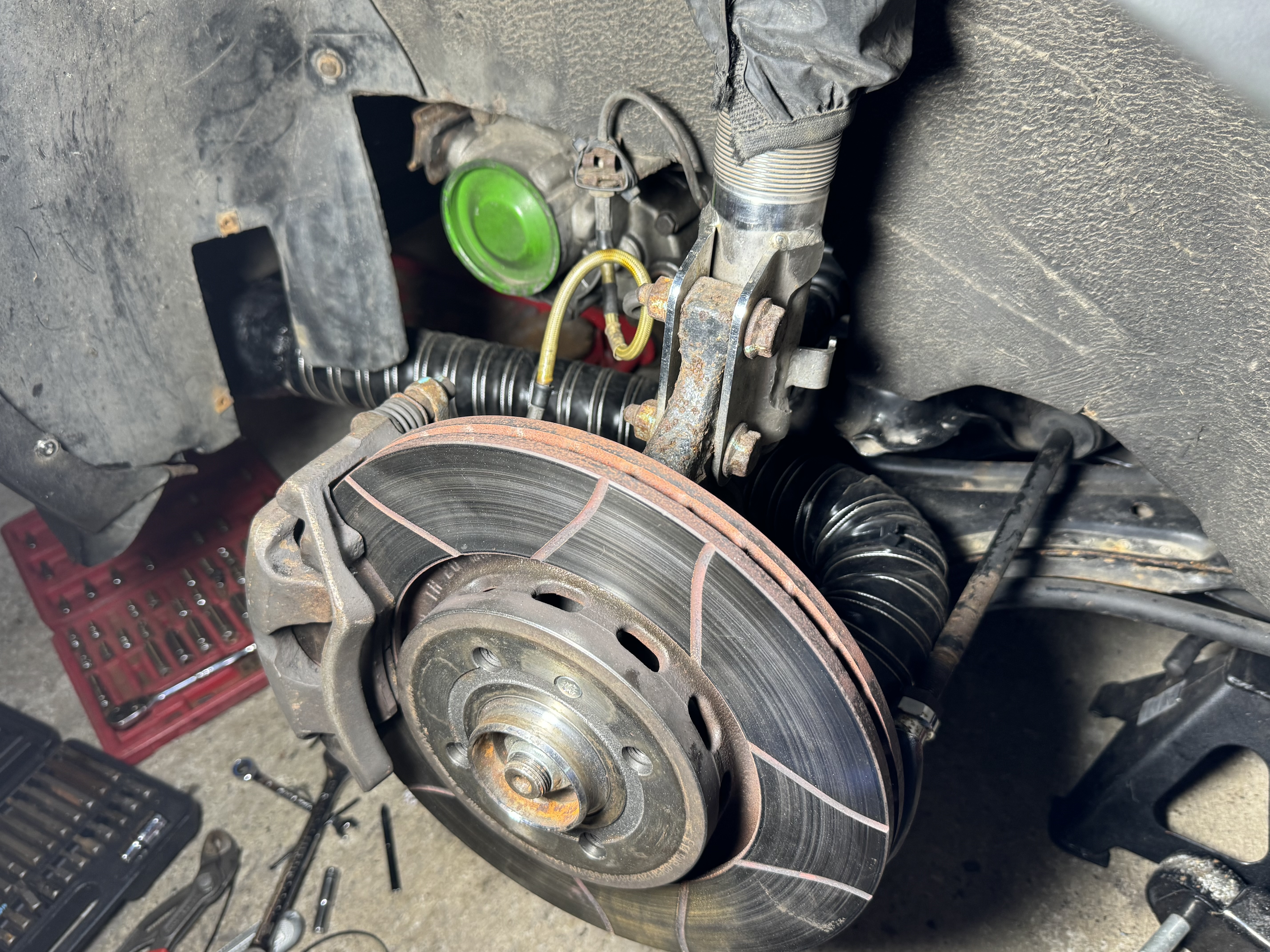

The extended sessions did highlight one problem that you will see in the video – the brakes. When braking there was a crazy amount of shake coming through the steering wheel, to the point where I was struggling to keep hold of the wheel one handed while changing gear. I did some tests with a dial gauge when I got home, thinking it may have been warped discs, but the discs were dead true.
After doing some research and chatting to a few mates, we came to the conclusion it was pad deposits on the discs, I was apprehensive – could pad deposits really cause this much vibration? I cleaned up the discs with some scotch brite pads, and to my surprise completely cured the brake issue.

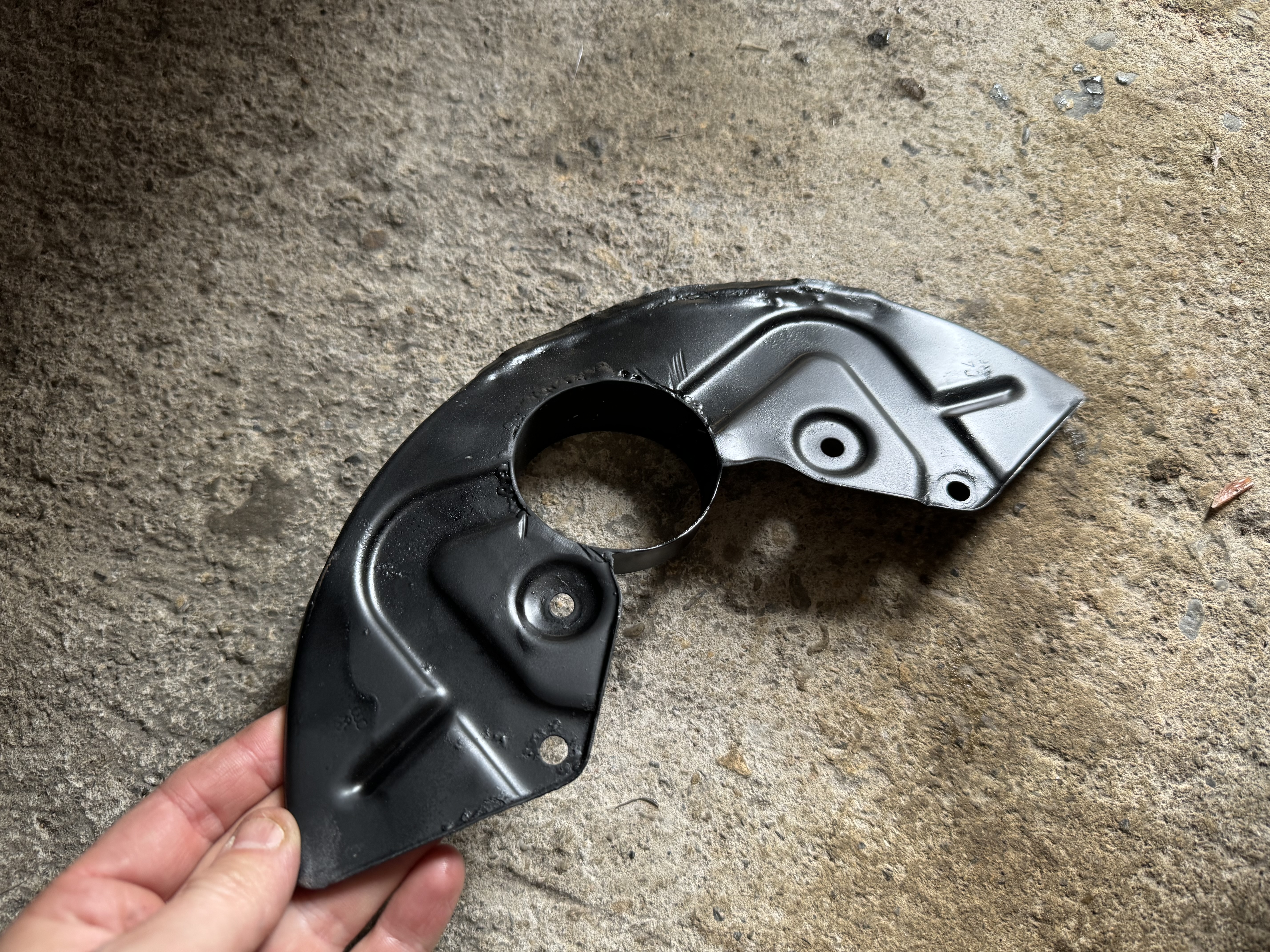

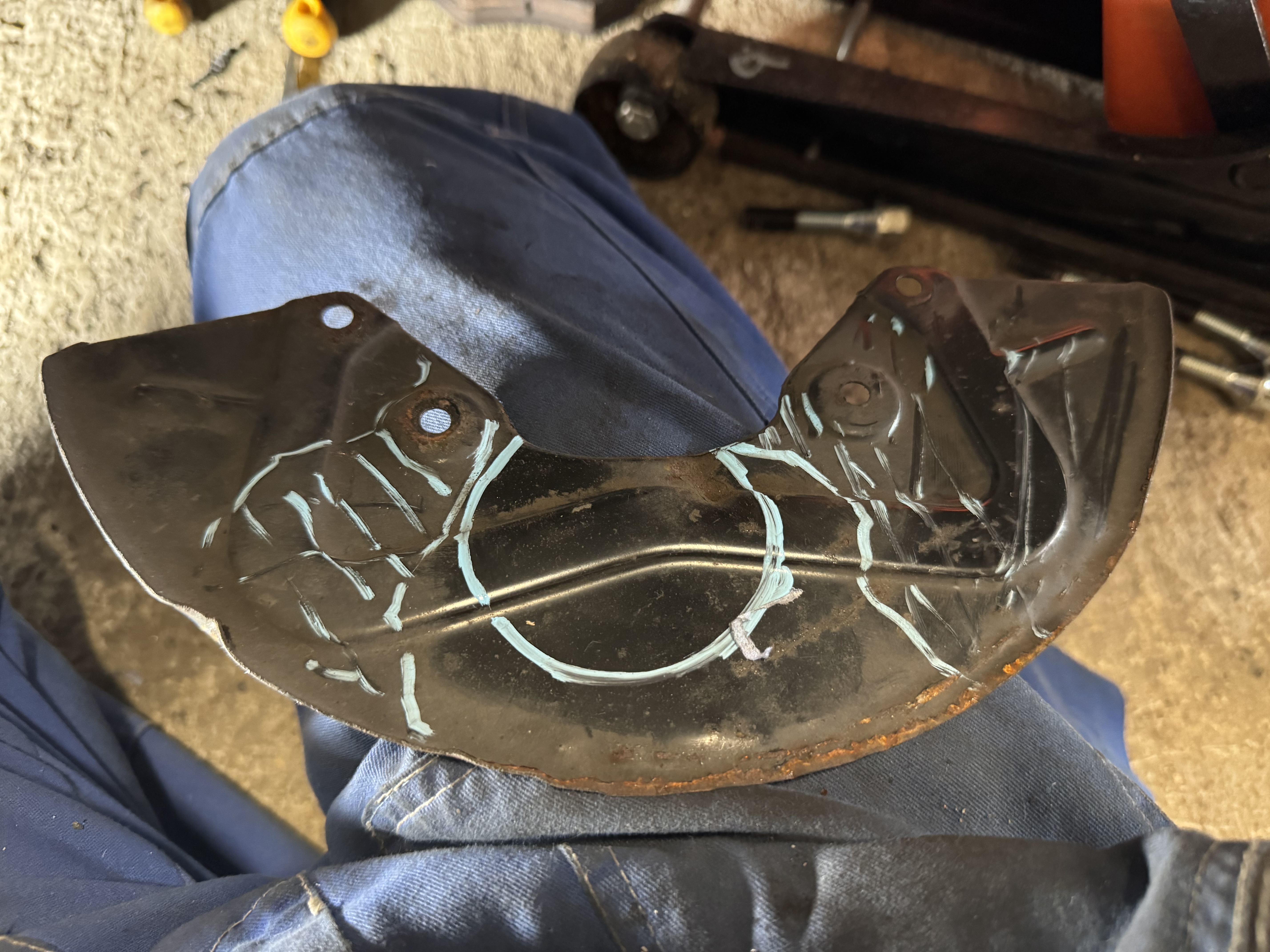

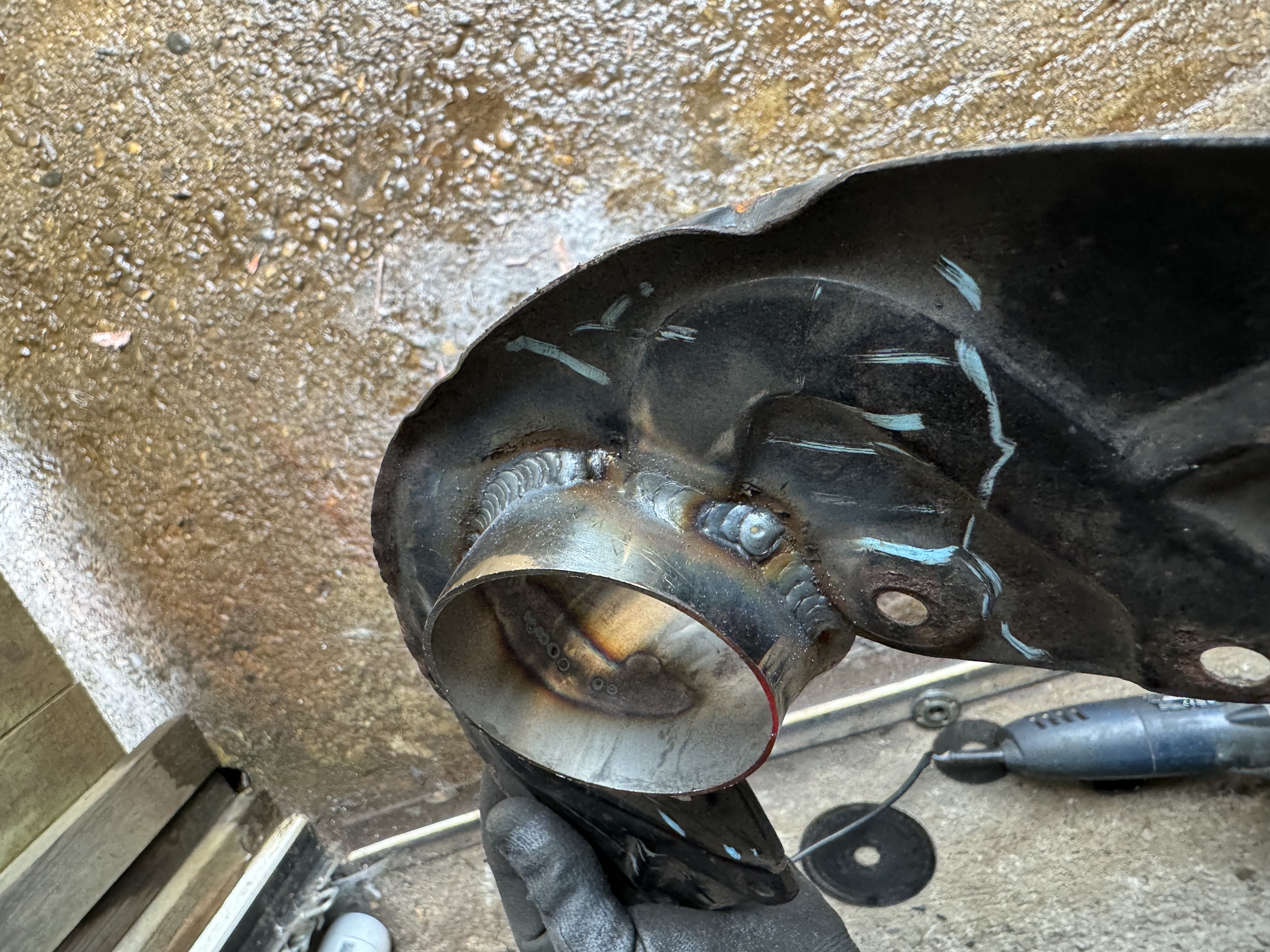

This did highlight one area for improvement though and that was cooling. I use the factory 16v brake ducts, which just vent to the wheel arch, so I decided to improve on that. Again I did my research, with the biggest takeaway being its best to duct air as close to the centre of the disc as possible, so the air can flow through the veins in the disc. With this in mind I started to modify the standard backing plates.
Holes were marked and cut, then a 2.5’ tube welded to the backing plates.

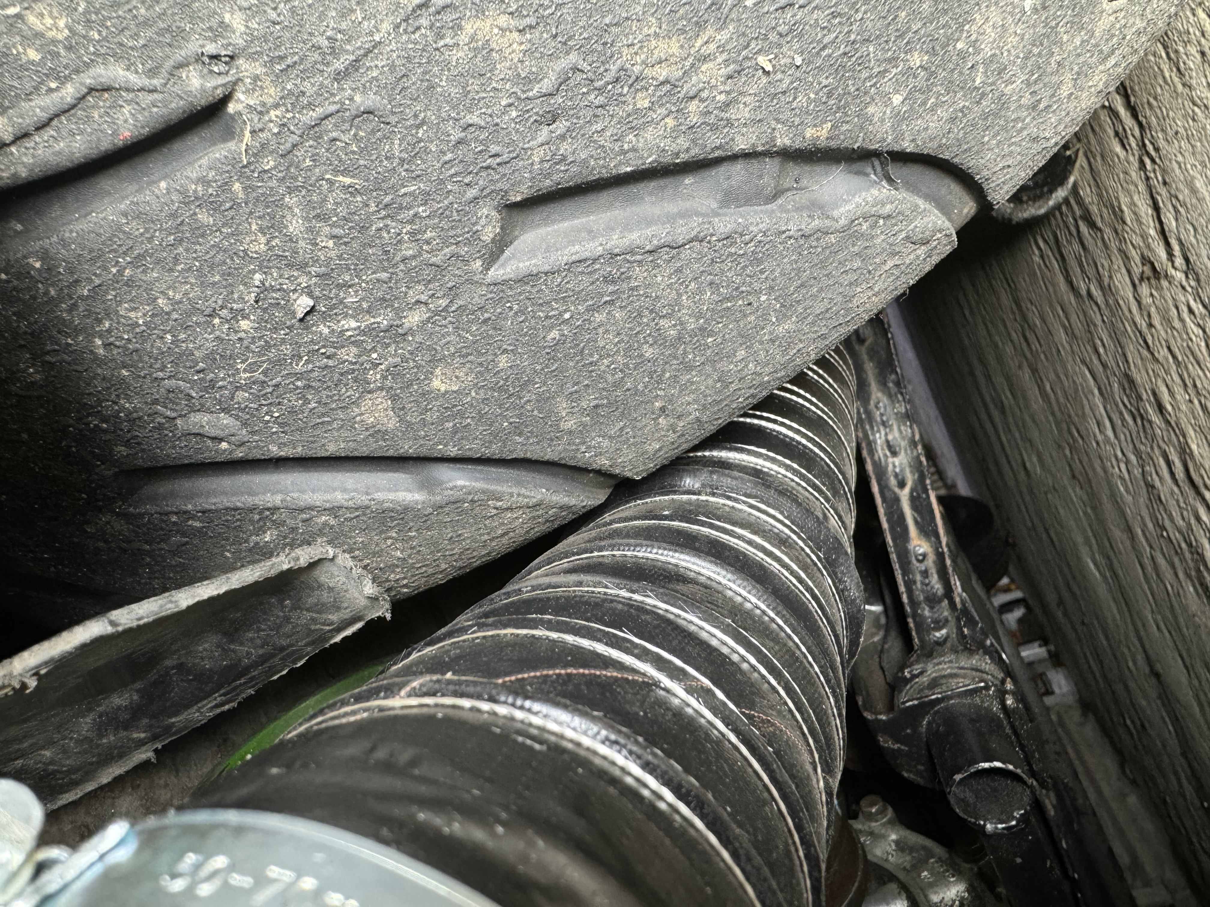

For anyone that has done this, you will know there is just no room for a 2.5’ duct, and there is literally only one way the tube will route without interference with the CV, driveshaft, track rod, suspension articulation, subframe to wishbone distance.

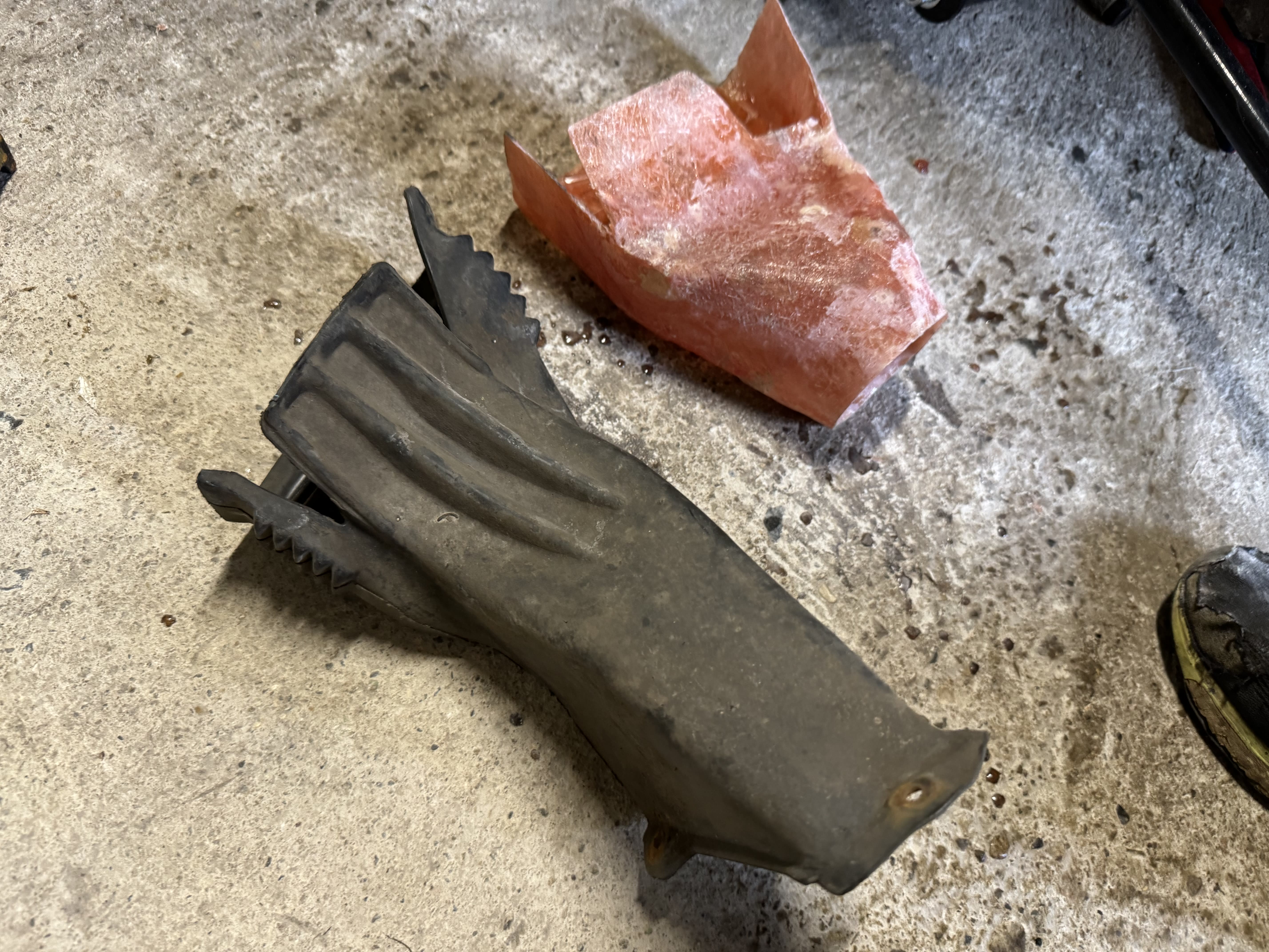

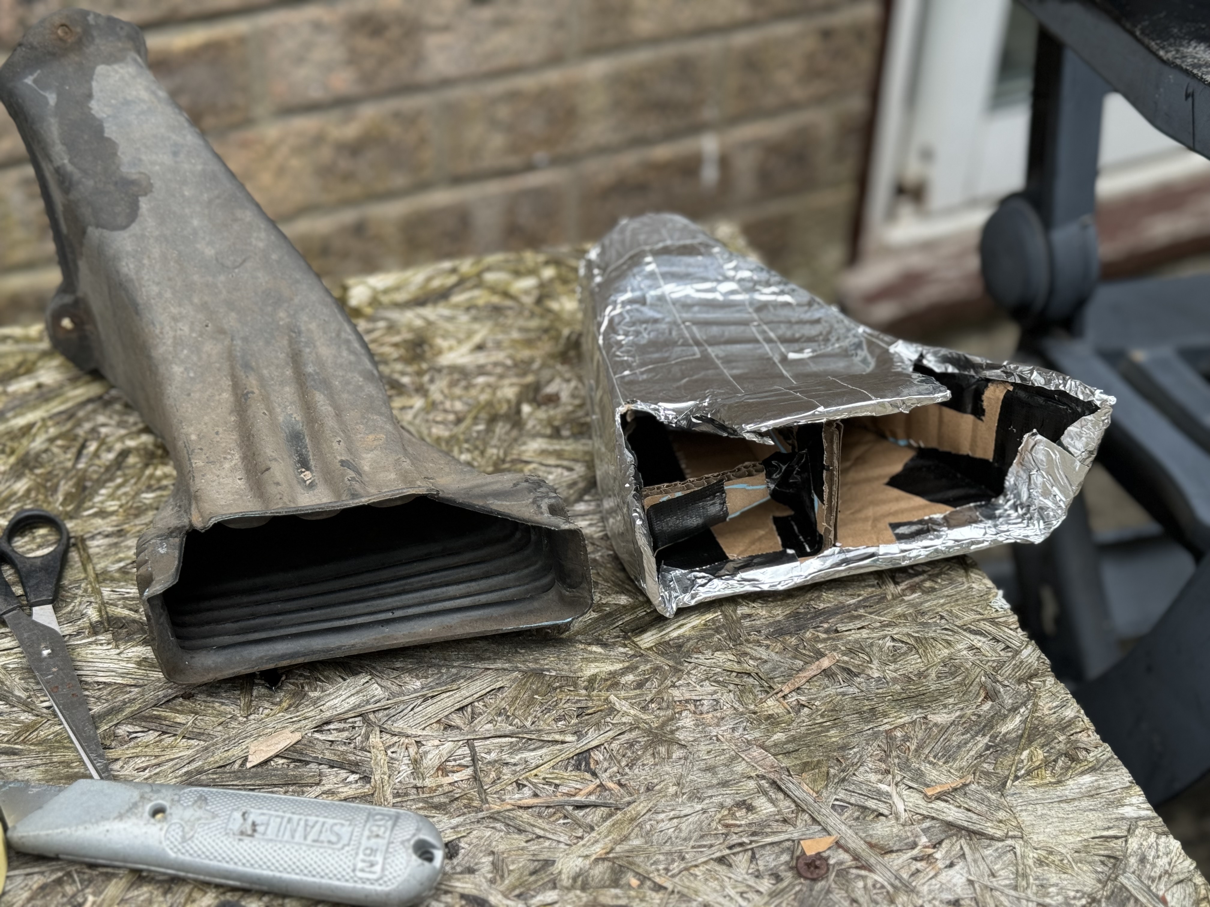

With the disc end sorted it was time to move onto the getting air from the front of the splitter. I’d decided not to bastardise the standard OE ducts, these seem to be worth a fortune now and really the shape didn’t lend itself well.

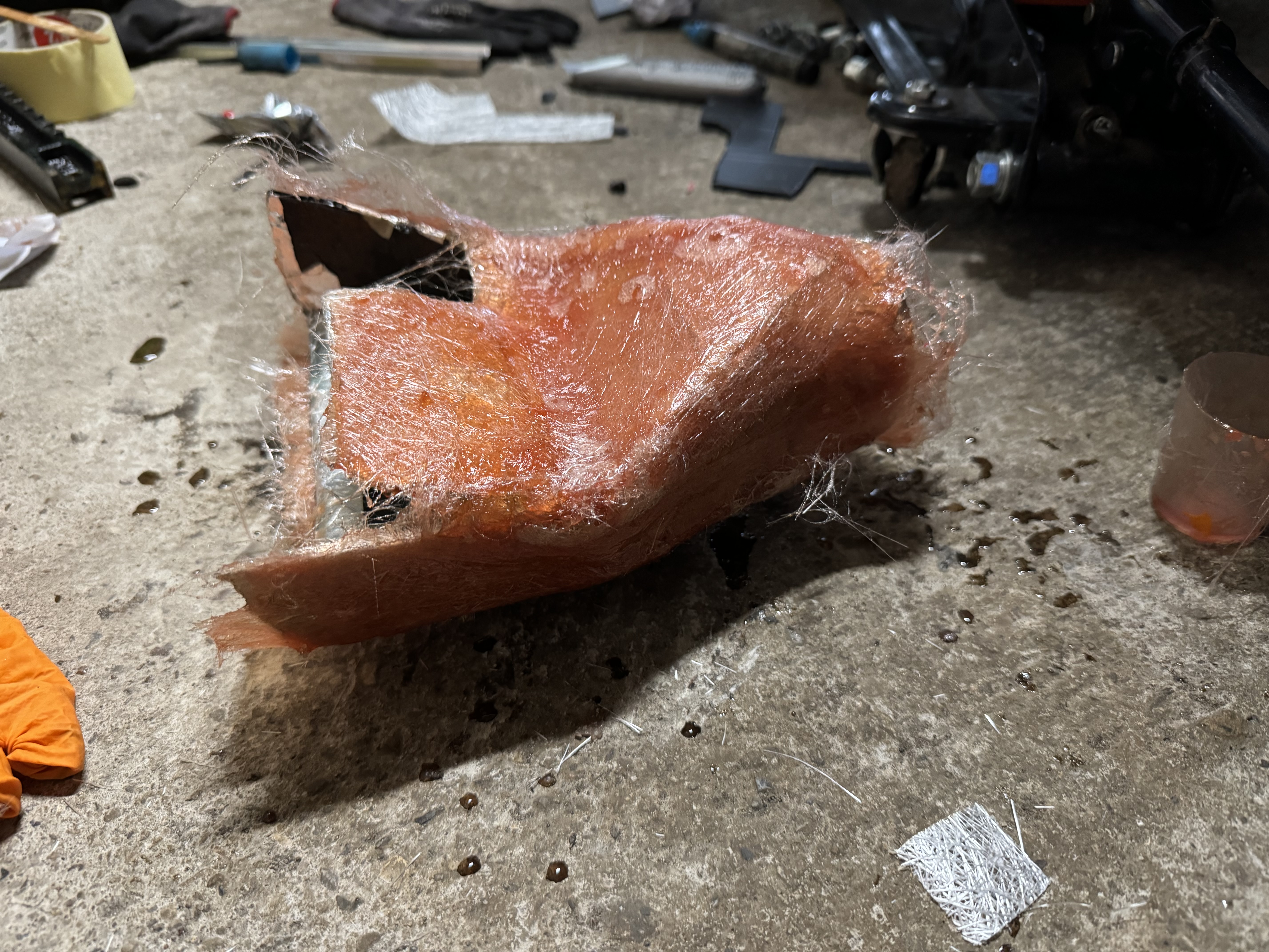

I started by remaking the ducts out of cardboard and tape.
Once happy I then wrapped the card in ali tape, to be used as a plug/mould for fibreglass.
It’s a messy process, but it came out really well once cleaned up.
I then used rivnuts in the metal front valance, to secure along with a cable tie.
I used 2 ply silicone ducting which should help with longevity.
Clearance is tight on lock, but there’s just enough room.

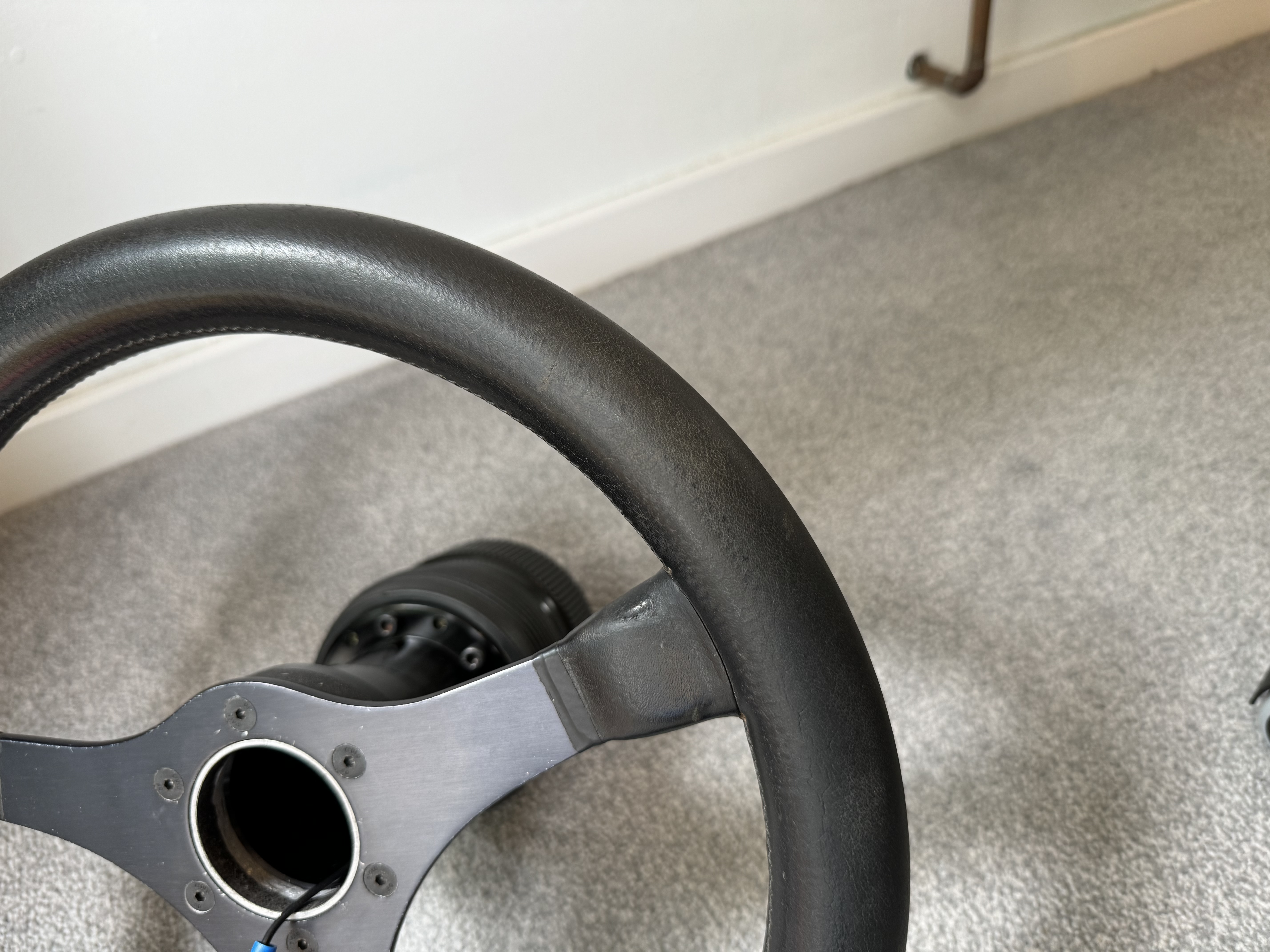

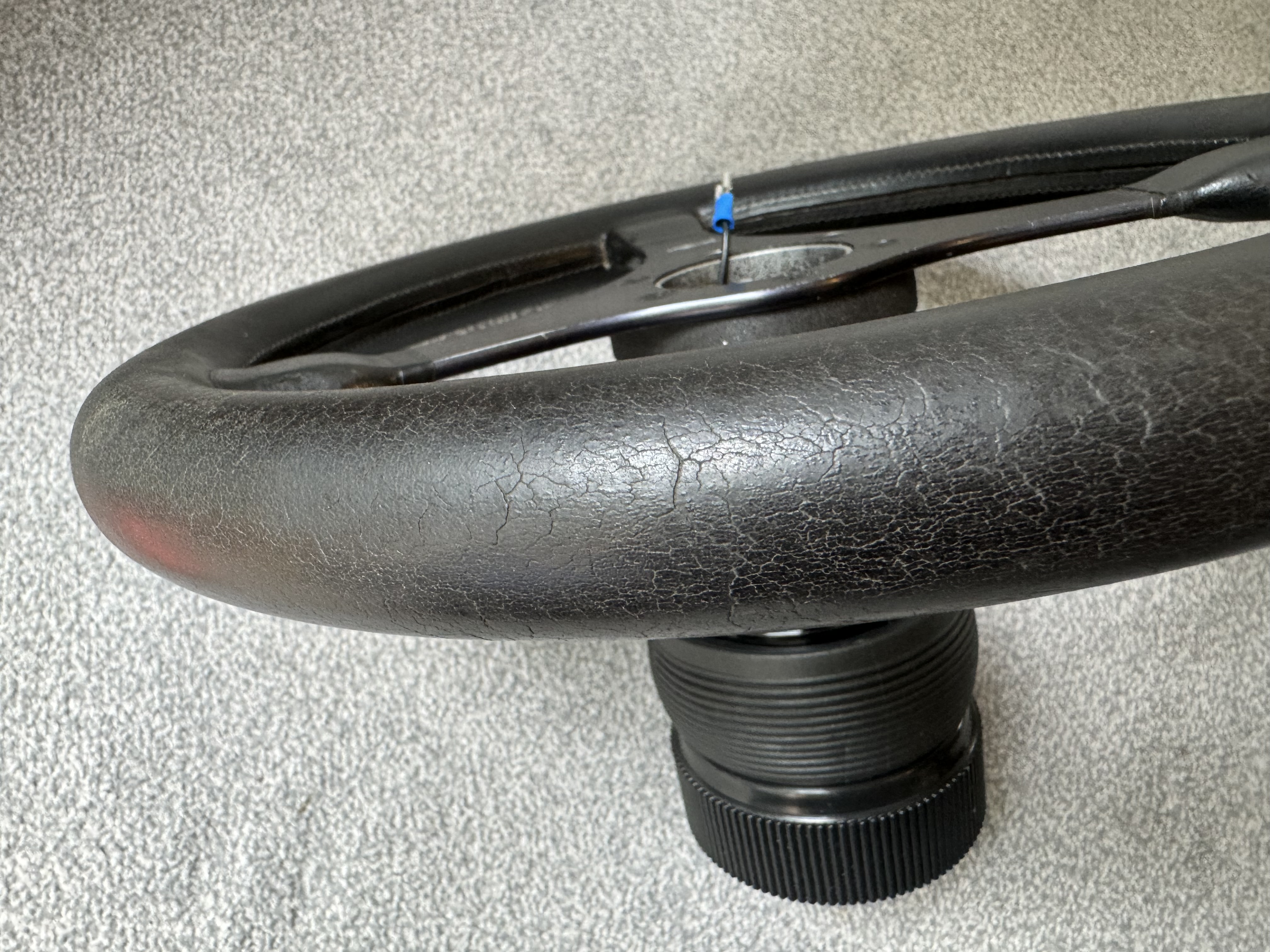

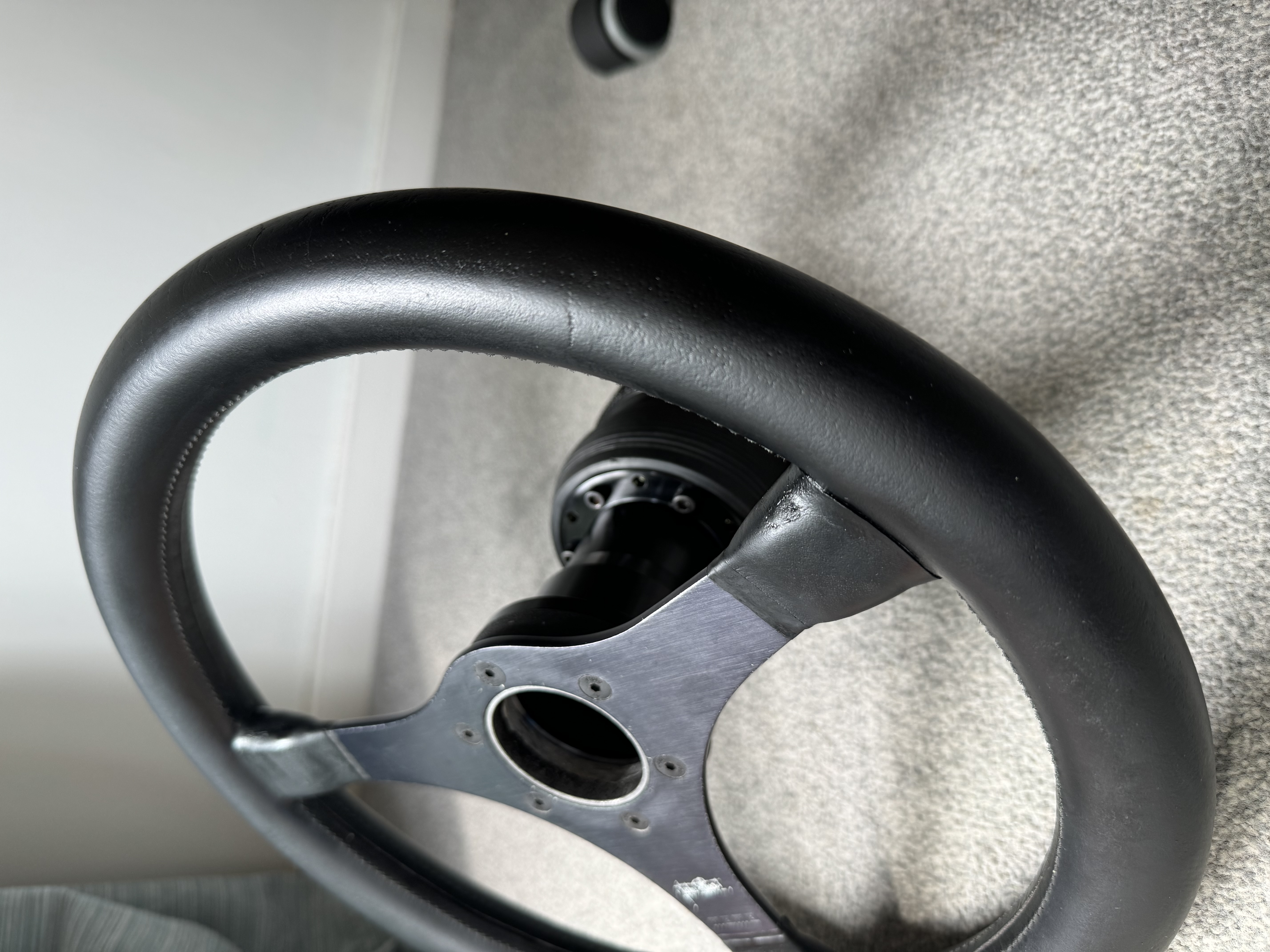

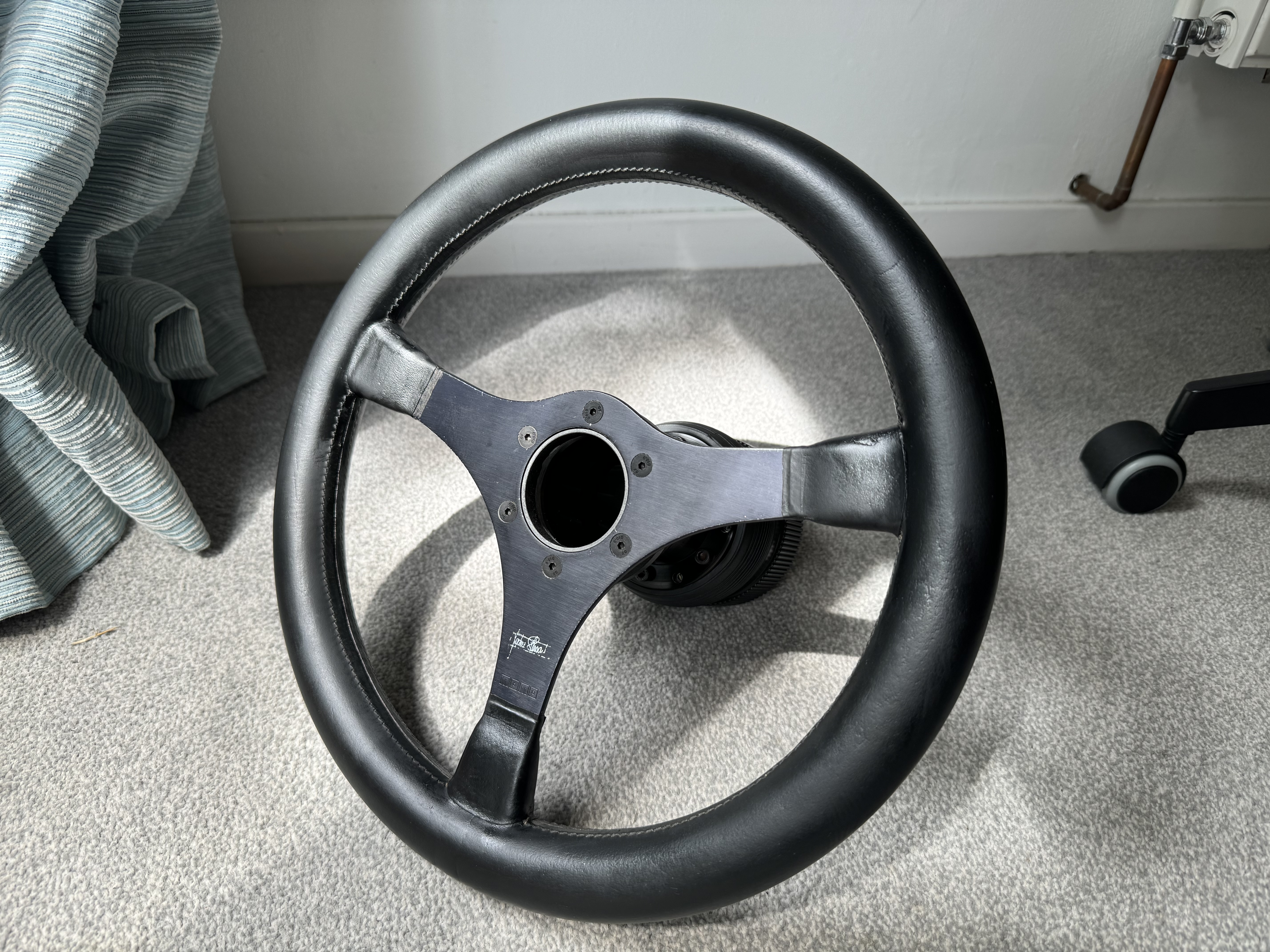

Next update was some cosmetic upgrade to my steering wheel. I absolutely love this wheel, it’s a pretty rare Momo Jackie Stewart circa 1960. The leather was getting tired and my sweaty palms on track were not helping.
I decided to try and restore rather than retrim as I like the patina of an old wheel.
The original wheel:
I grabbed a kit from my local leather place for £50, which included a leather cleaner, sponges, primer, leather paint and a UV top coat.
I started by cleaning the leather and then sanding to scotch up the surface and level and of the bumps.
The finish result is really impressive! I just hope the finish lasts.

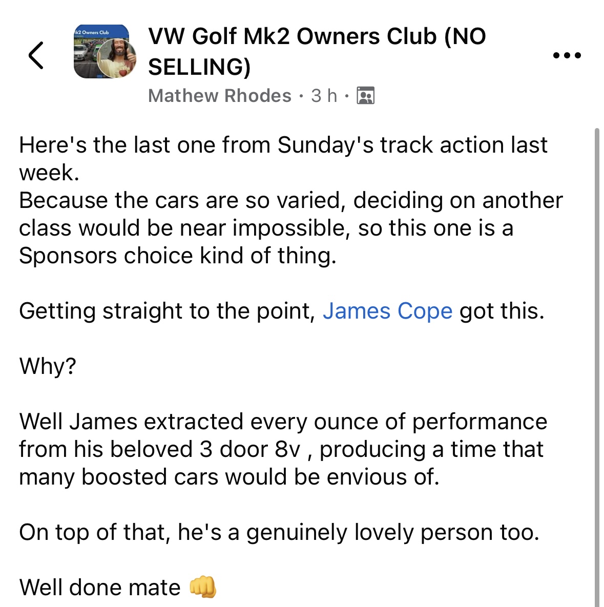

Well I’ll start with Nick, he managed a 27.7 lap, bagging him the fastest time of the day, taking home the silver ware. This is a properly serious time! And expertly driven by the man himself.
As the awards went on the last thing I thought was to hear my name called out. Despite trying to extract as much speed out of the 8v as possible, its just that, an 8v. It was never going to be a competitive car. As the famous John McGuiness says “you can only piss with the d*ick you’ve got”
To my surprise Matt called my name! with a 29.7 lap time. 4/10ths fastest than last year.
I was completely in shock and so chuffed! The award was a sponsors choice, given to the person achieving a decent time with the machinery under them.
Matt also wrote some very kind words in the awards posted on facebook.

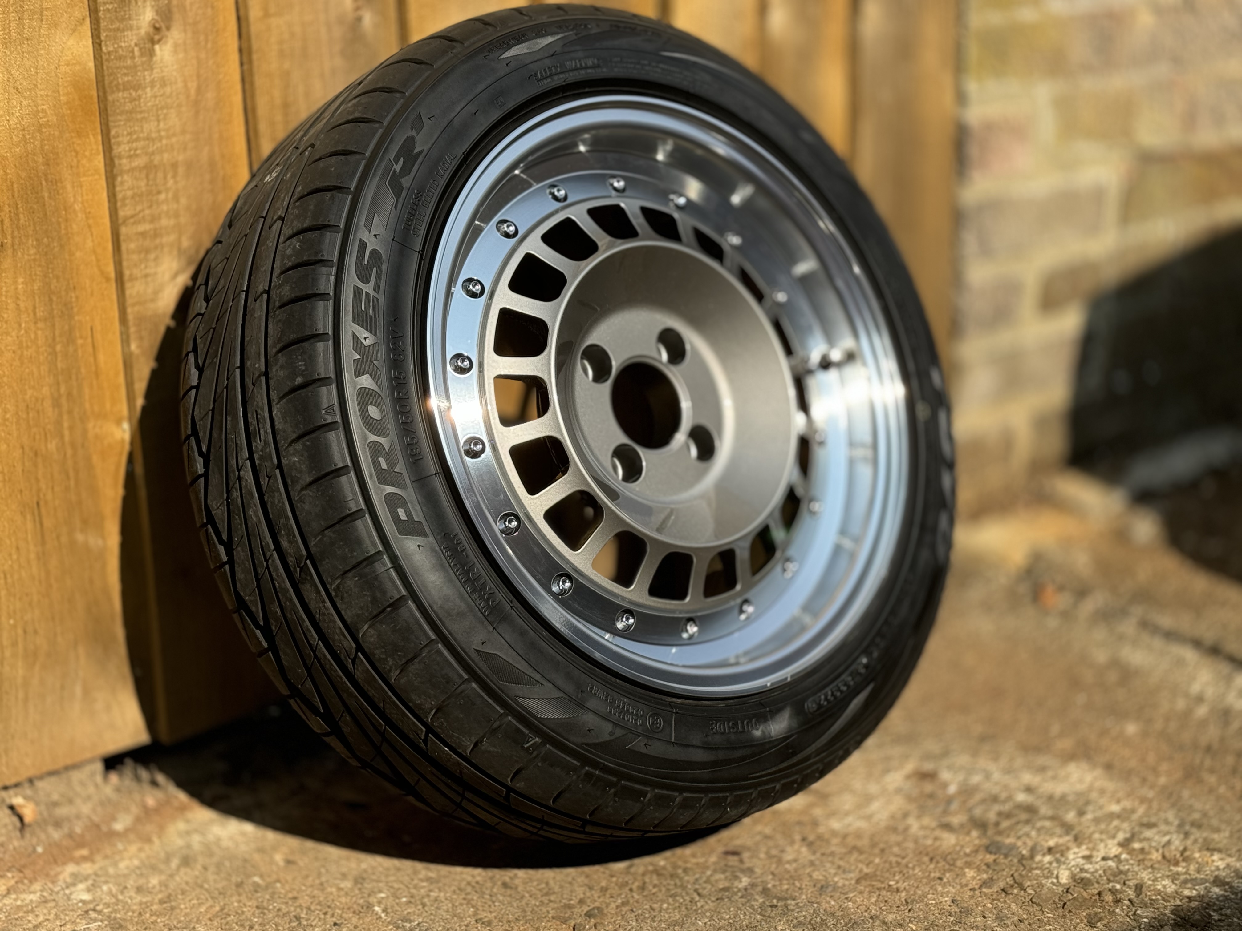

The last update is to the wheels (sorry this is a long post, ive been a busy boy! And I’ve actually skipped a lot of jobs out!)

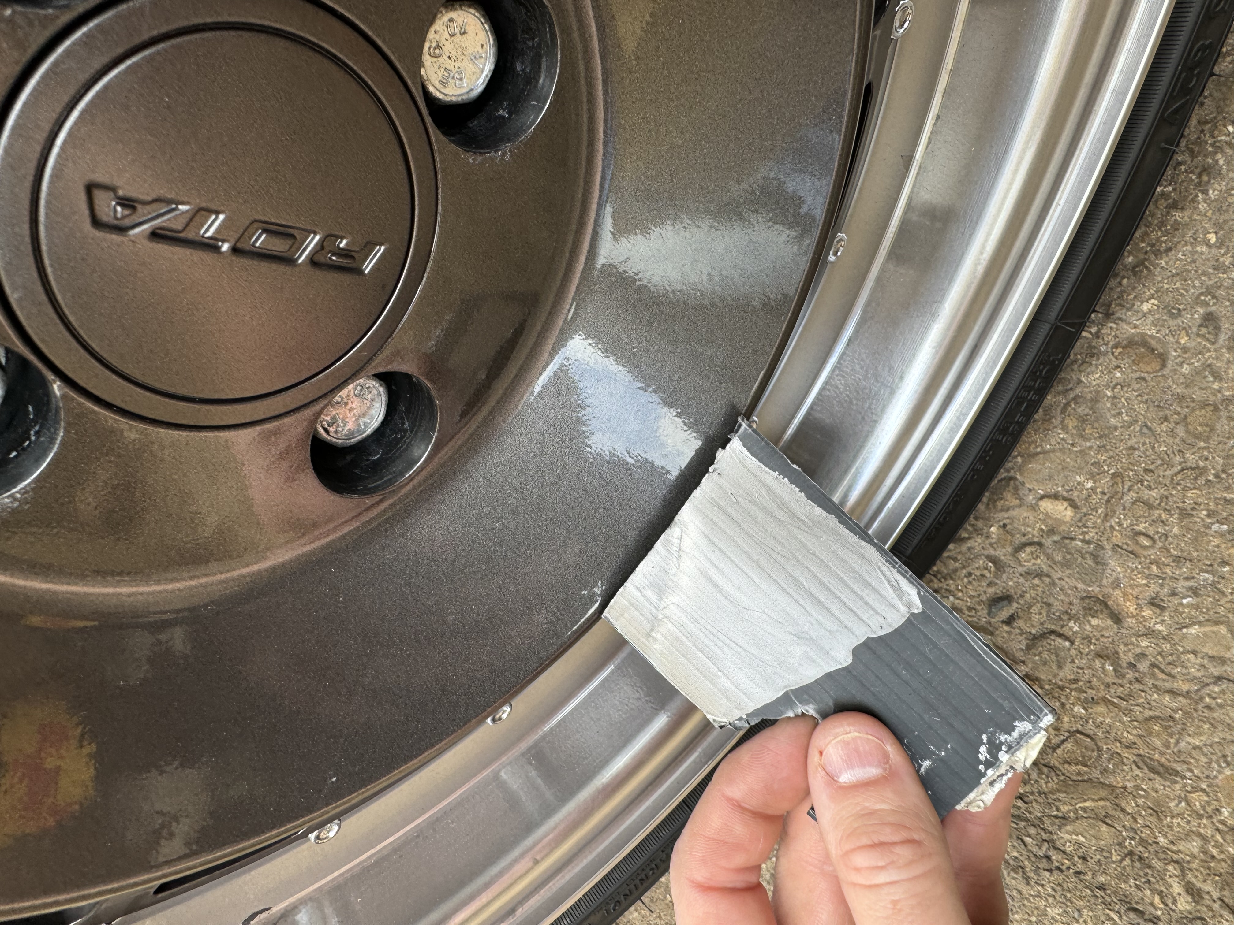

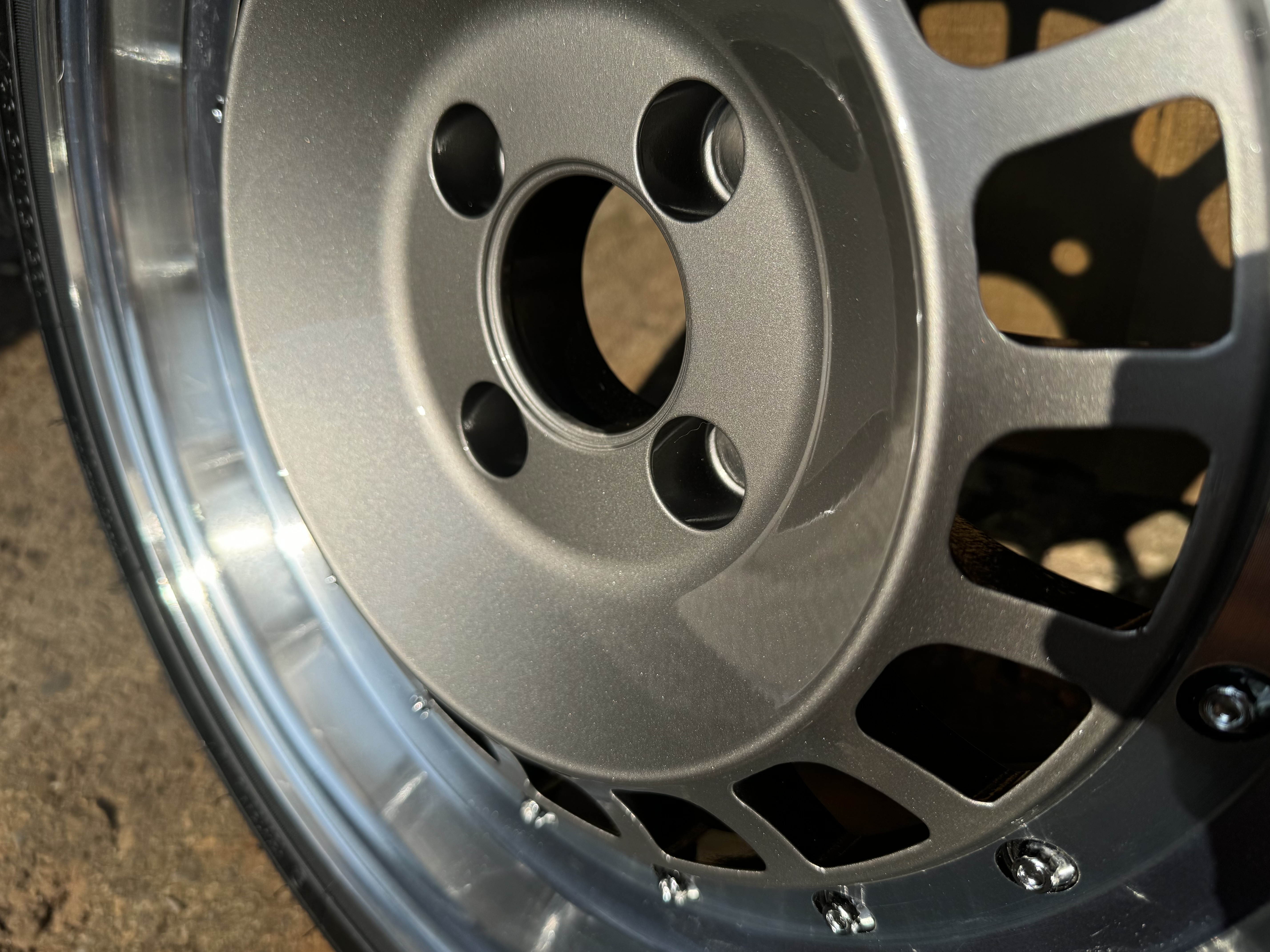

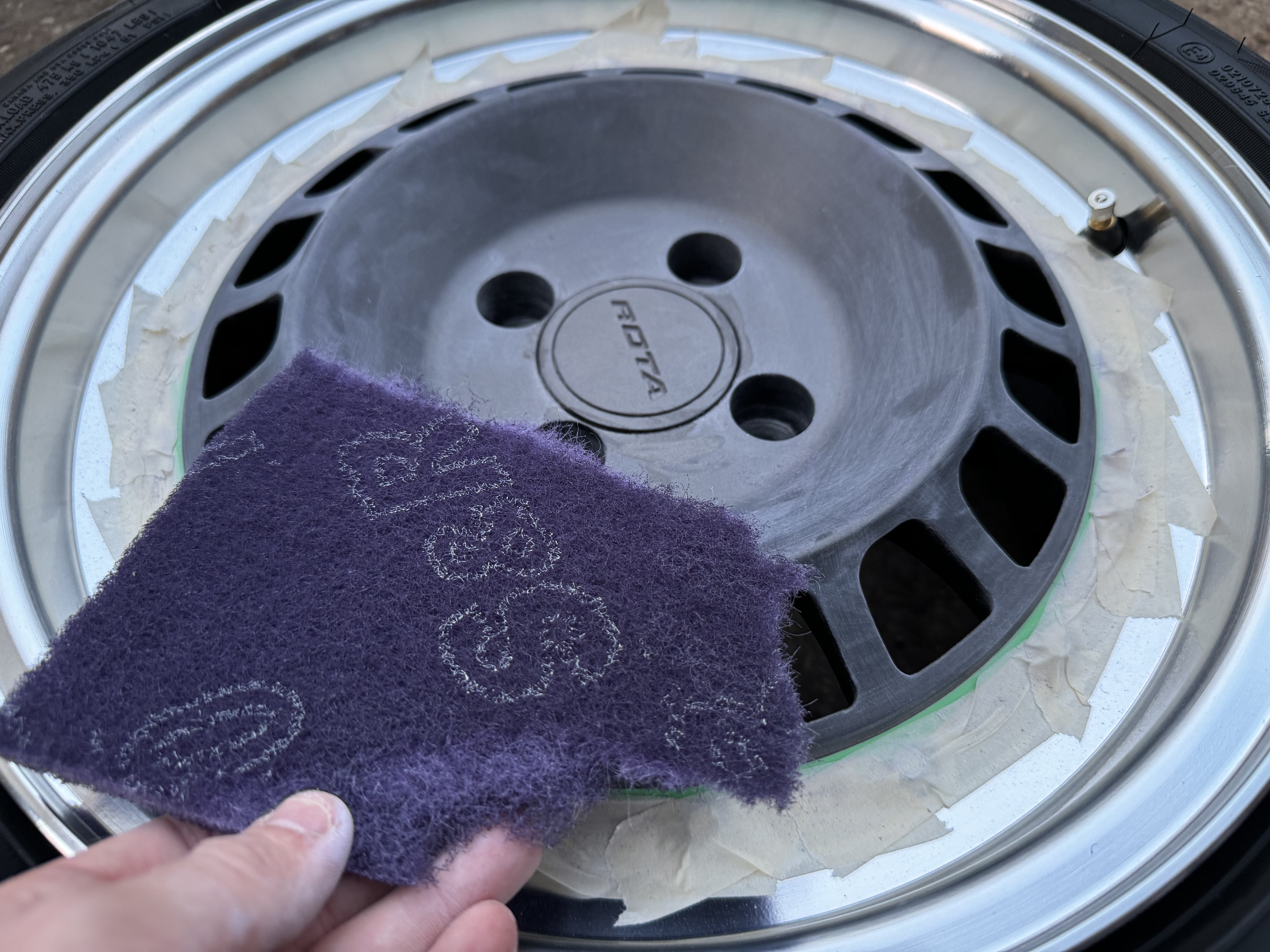

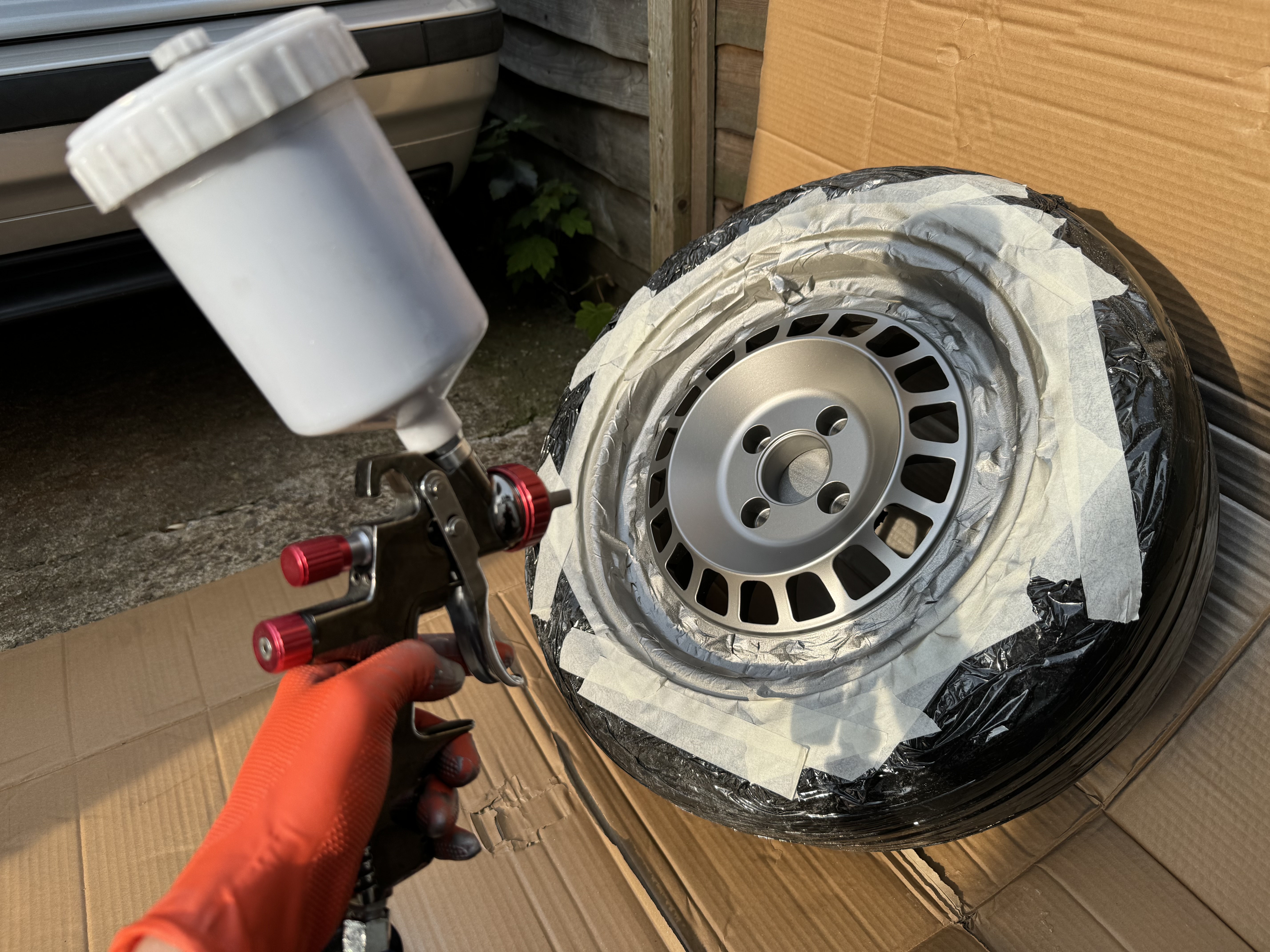

I was never a fan of the dark wheels on a black car, so I decided to tackle them this last week, I spent a while deciding on colour, but finding the exact shade was so hard.
On a whim I decided to mix some base coats I had in the shed, I used some Arctic Silver from the E36 with some L041 Black from my Golf, in about an 80:20 ratio silver/black. And unbelievably this was the result.
I was over the moon with this, it had the perfect amount of goldy glitteryness, with silvery greyness. I also had about a litre of the stuff so Ideal for repaints/ touchups in the future.
The centres were masked up and prepped with some 800 scotch brite.
The inside of the wheel was also prepped. Very tedious work, but its worth the effort spending the time with prep.
Base coat
2k clear coat
Very very chuffed with the outcome.

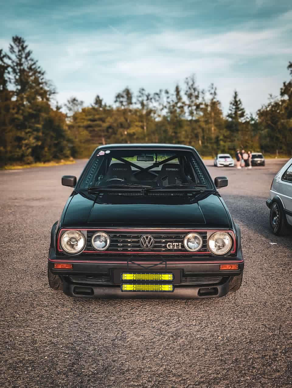

I would be joining Nige in his mk2, and after some confirmation from the organisers we found out there was no restriction on lighting. With Anglesey being totally unlit and a stones throw away (quite literally) from the edge of the Irish Sea, the challenge would be being able to see.

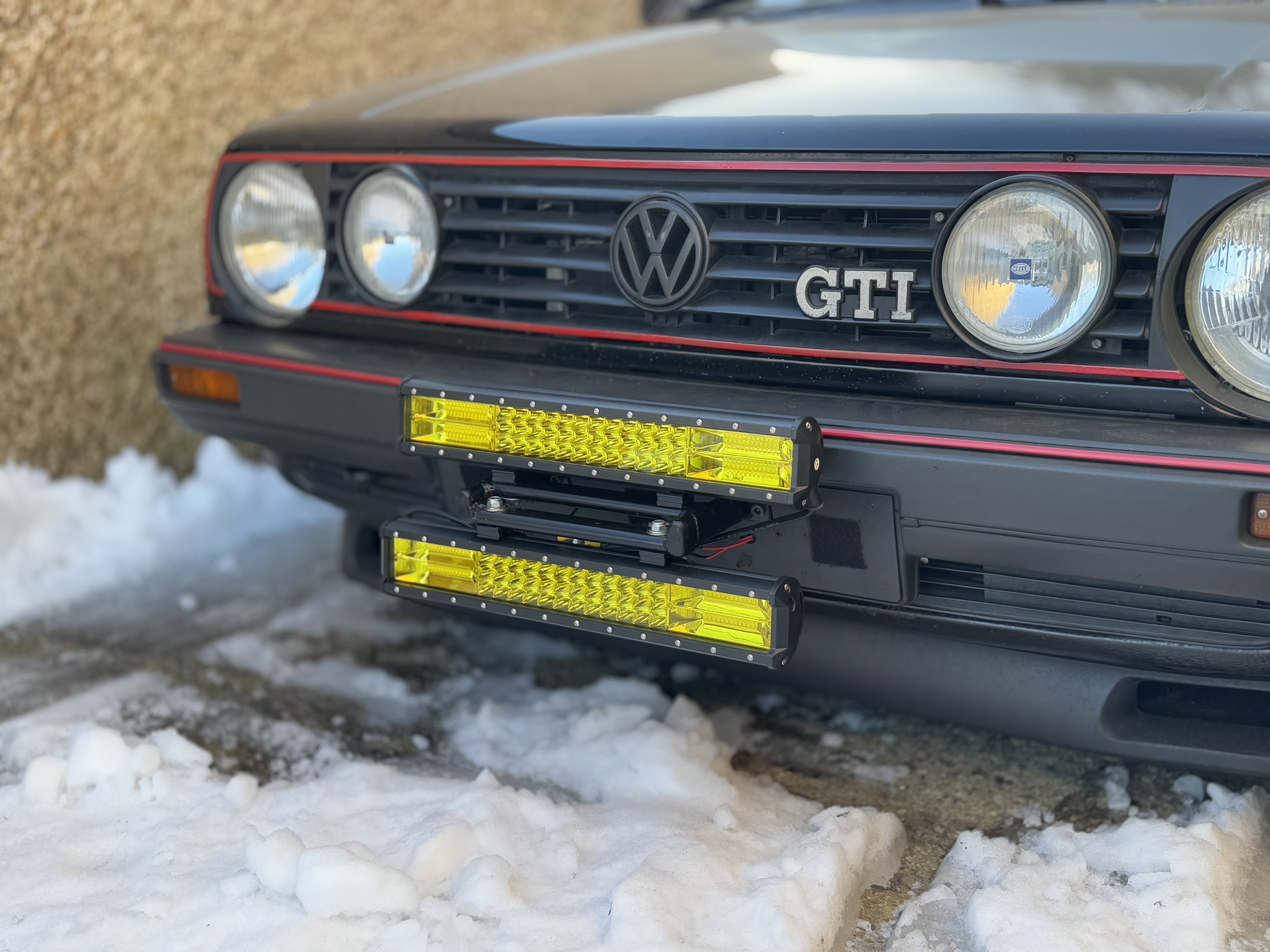

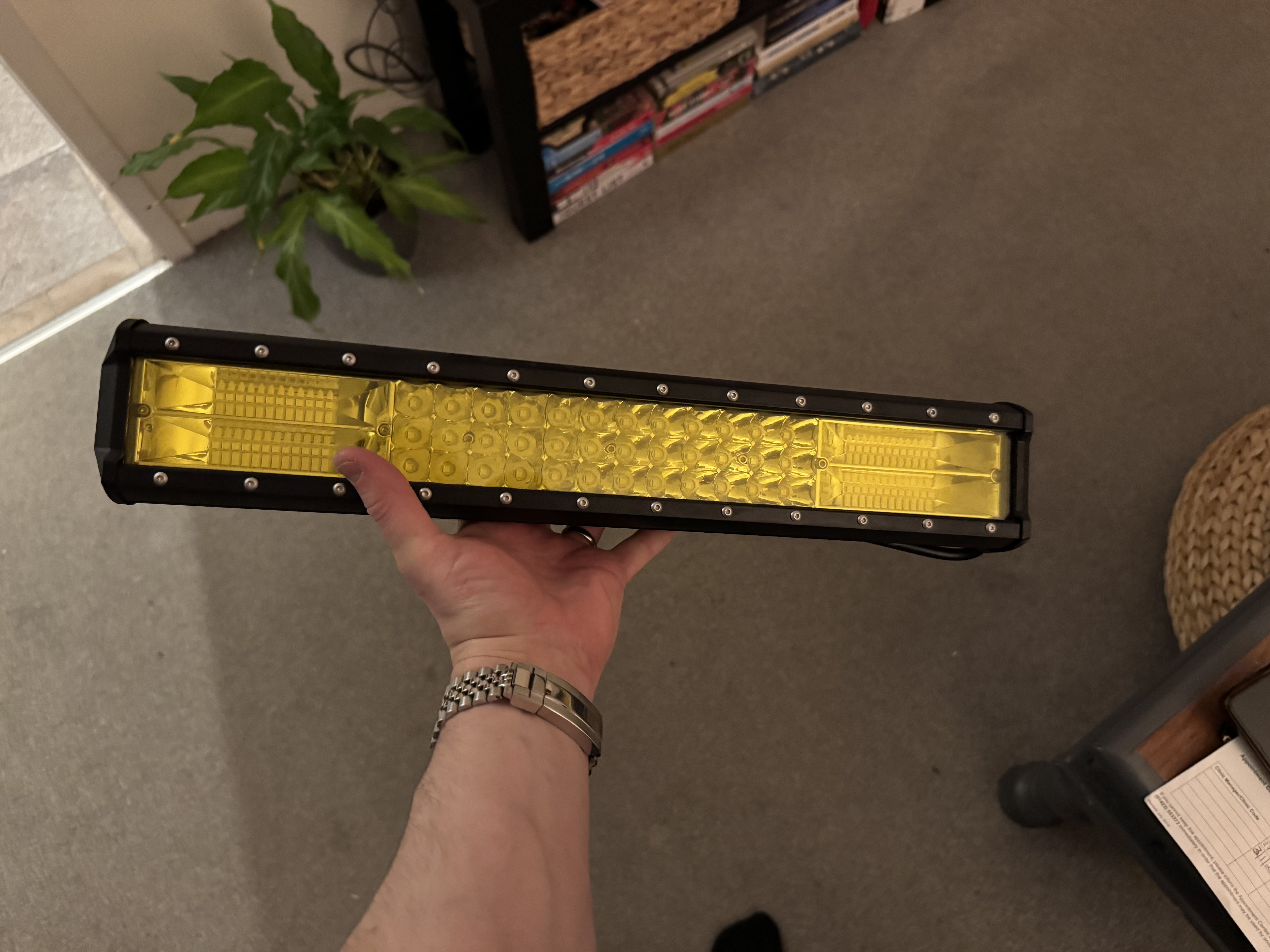

After having a mess around in photoshop I’d decided on a design/layout, and I wanted to go with yellow lighting – for those Nürburgring 24H vibes!

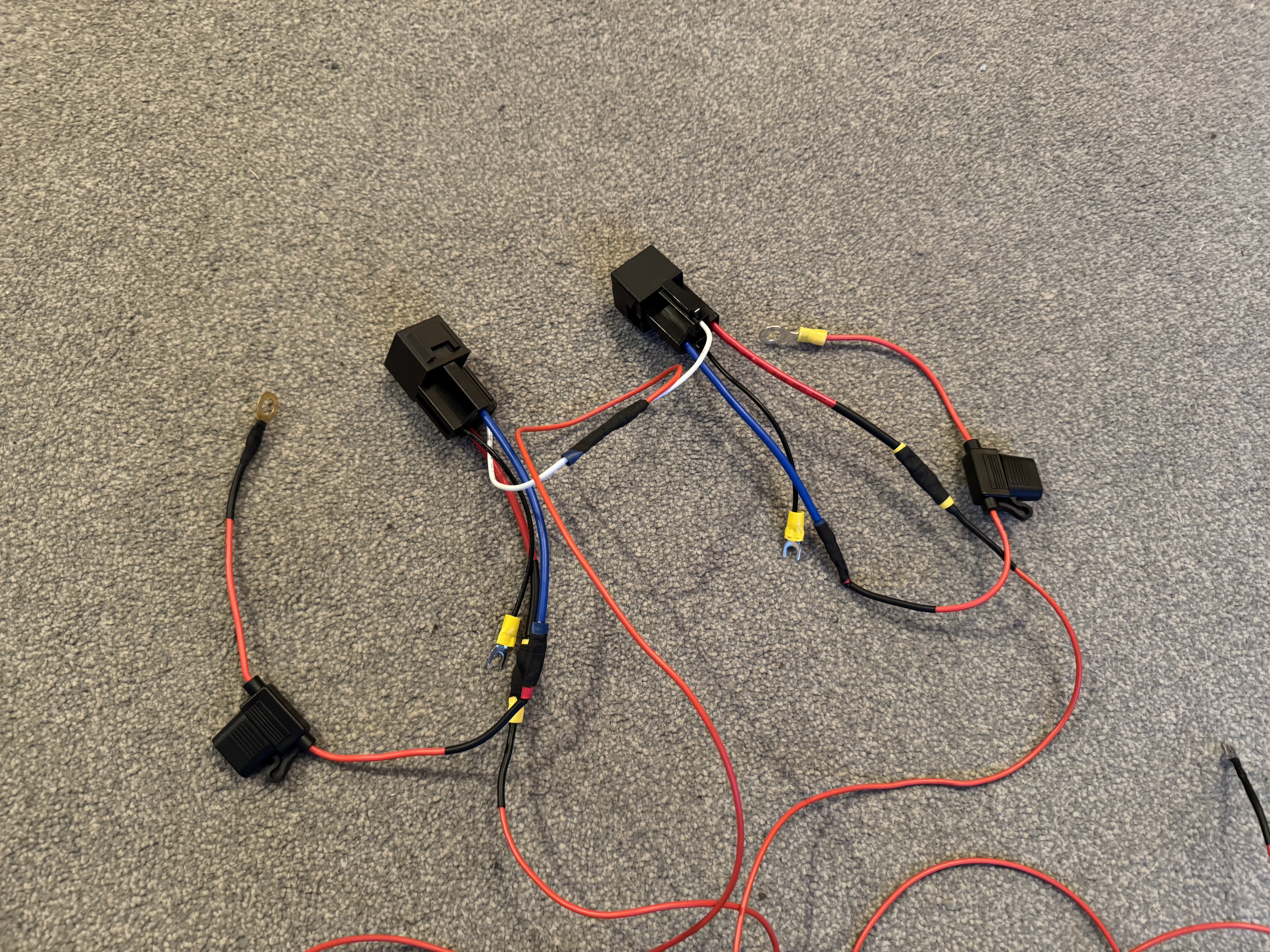

Amazon prime to the rescue, with 2 – 17” 250w LED light bars, some wiring, a switch and a couple of relays.
For me the design criteria had to be:
- Easily removable
- Hidden brackets when not installed
- Be brighter than the sun

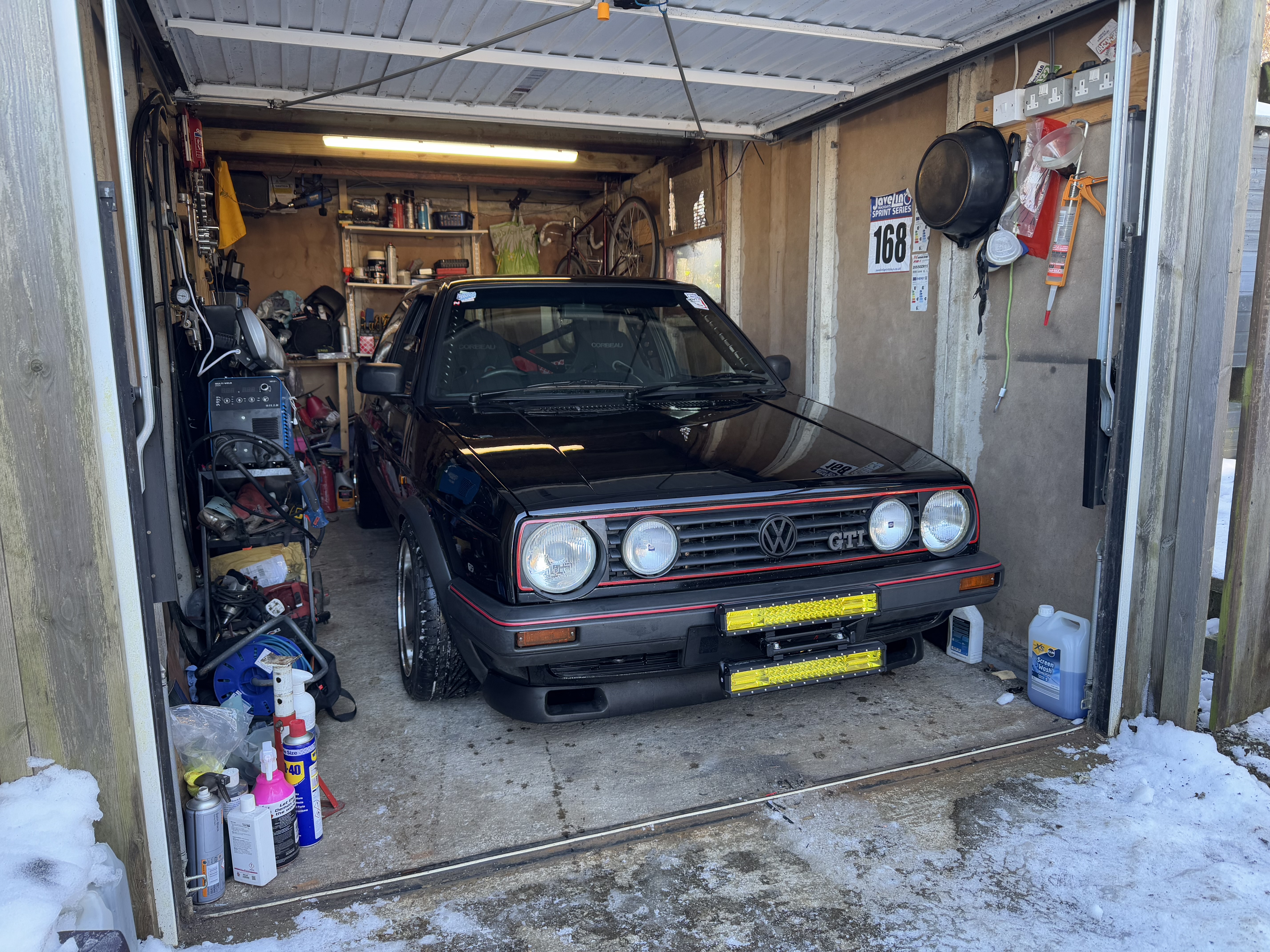

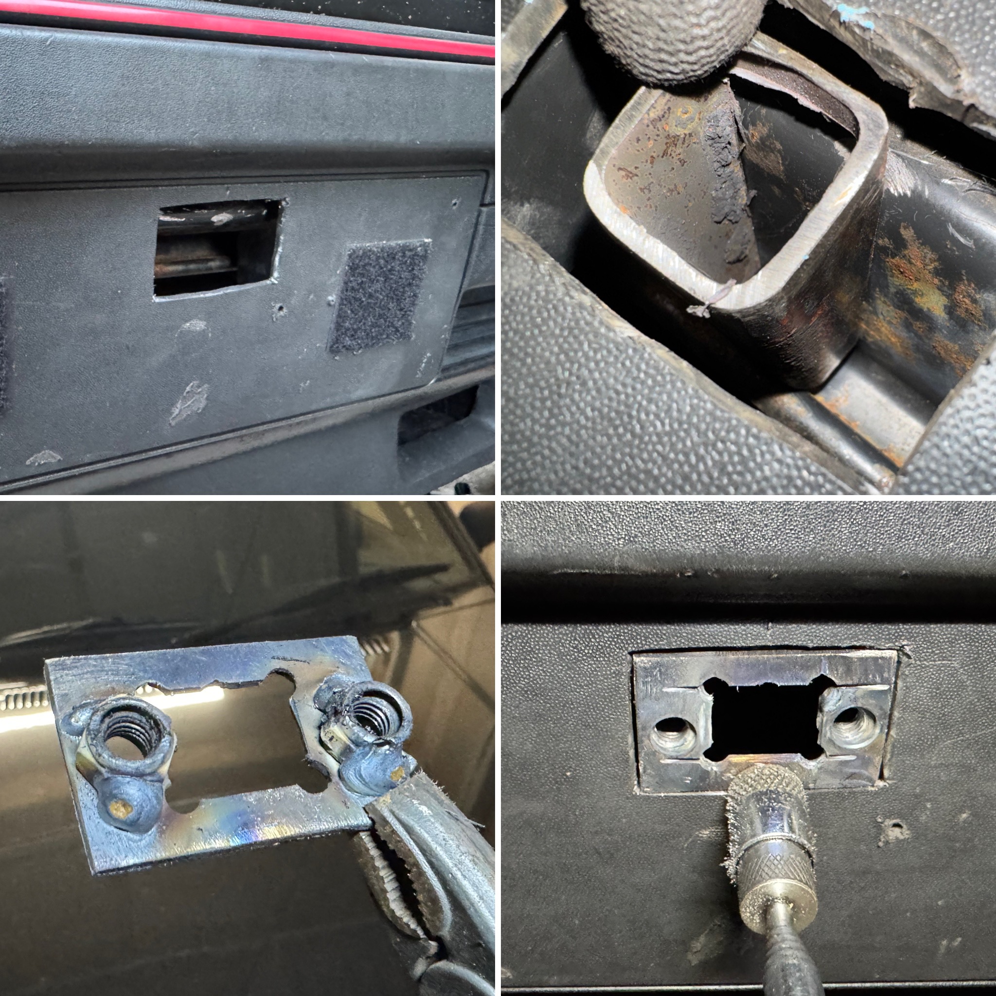

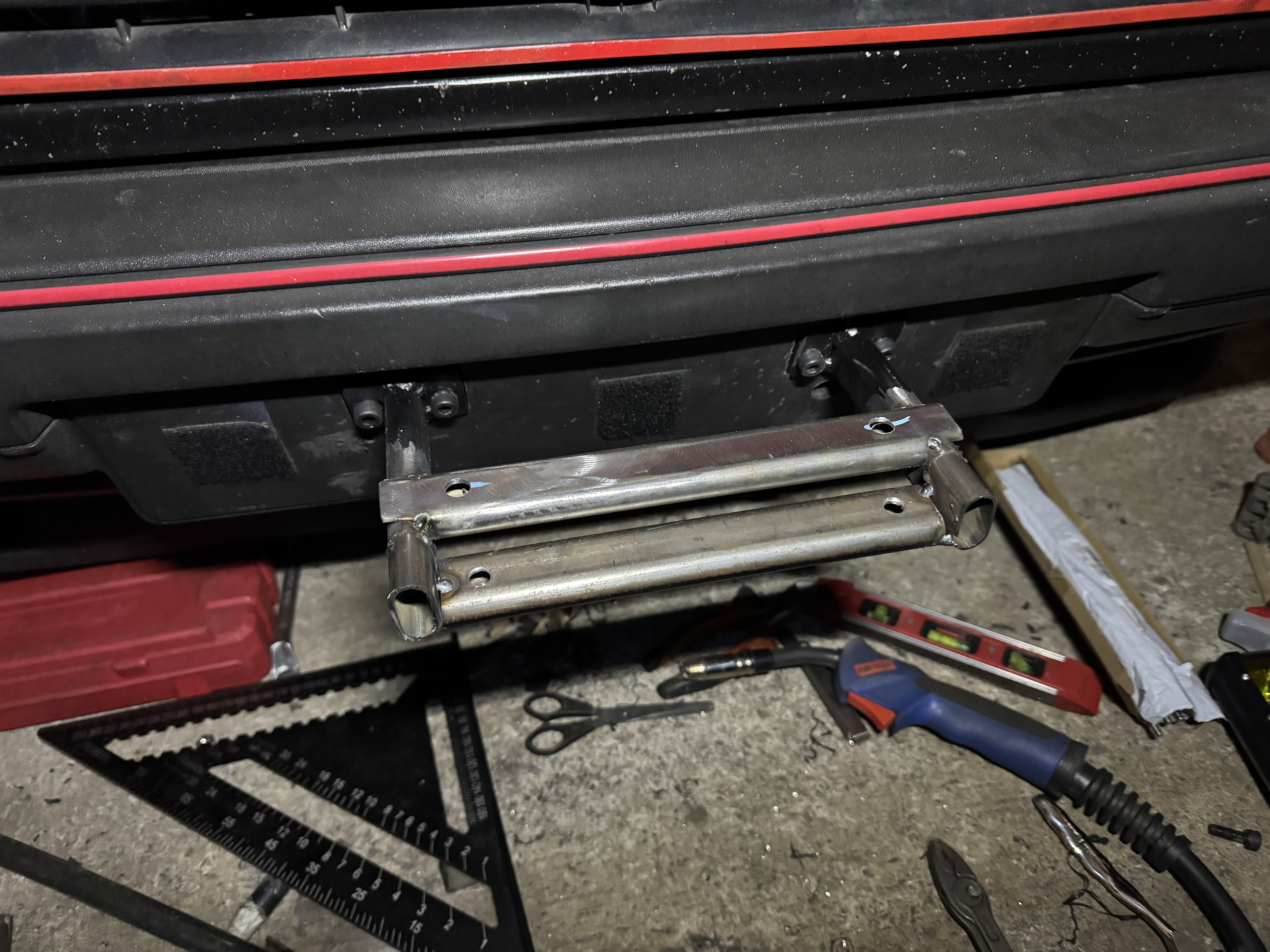

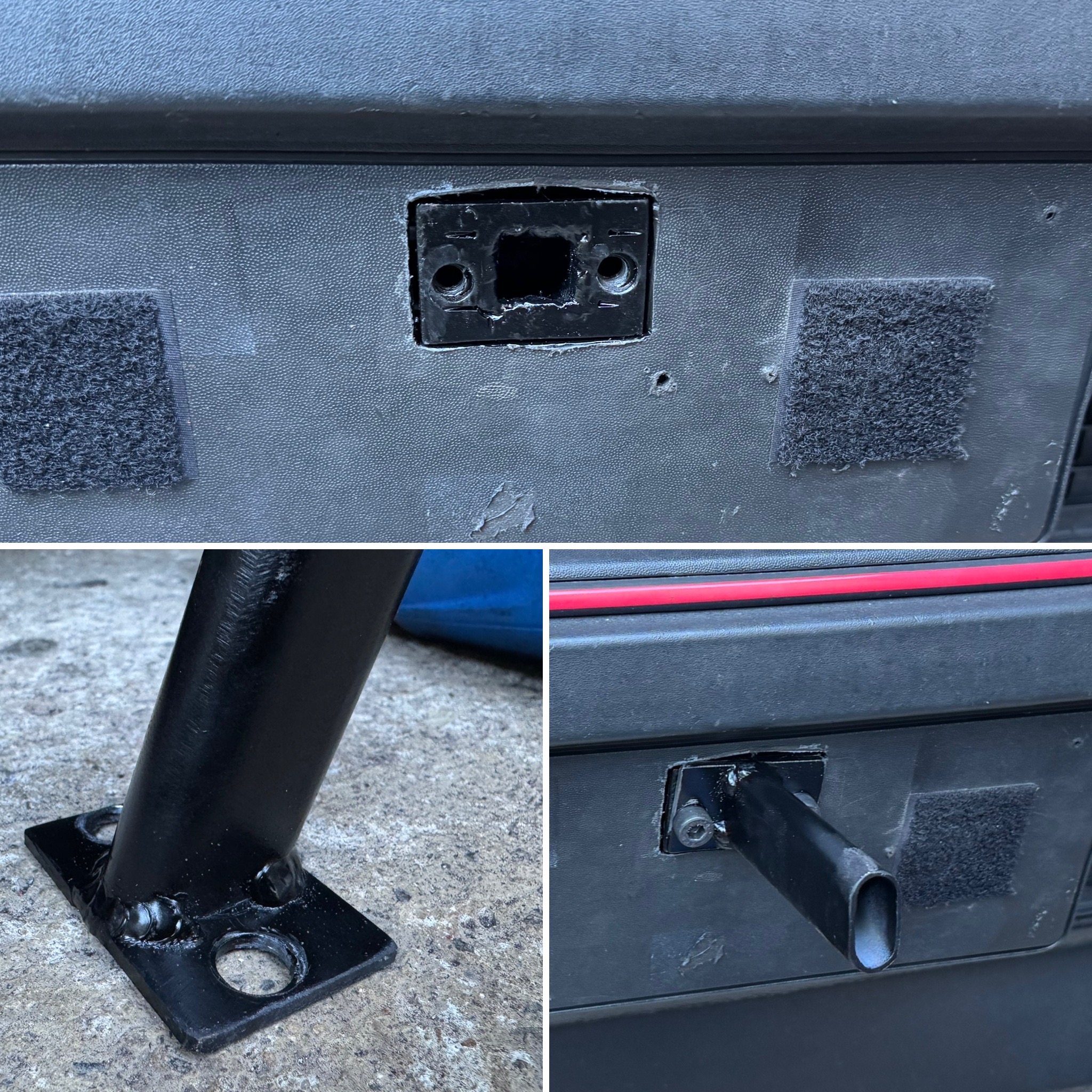

With that in mind, here’s what I came up with. 2 rectangles were cut into the bumper, behind the number plate, to expose the metal bumper iron at the back.
Square box section was cut and angled, so it could be welded to the bumper iron, a cover plate was made with captive nuts, which would be welded to the box and fit flush to the bumper.
Once repeated on the other side, I started to make the brackets which would hold the light bars. The bracket can be bolted and unbolted with some m8 allen bolts.
I’d decided to stagger the 2 light bars, so they can be unbolted easier.
Once all the bracketry was made, I started on the wiring. I was worried about excess heat/ potential for fire from the draw of these LEDs. A chat to some friends and we figured out the draw was 21A, so the wiring was designed to take 25amps to be safe. A good friend drew me up a wiring diagram, which was super helpful. Essentially, they are wired as individual lights through 1 switch, which will make then as safe as they can be, rather than all the load going through one relay.
I was over the moon with how these turned out! And they were bright! - note the snow!!

The light bars were an absolute must!! And I’m so glad I went all in.
My mate Jim took this photo of me going past the pit wall, its got to be my favourite picture of my car and will be getting printed.

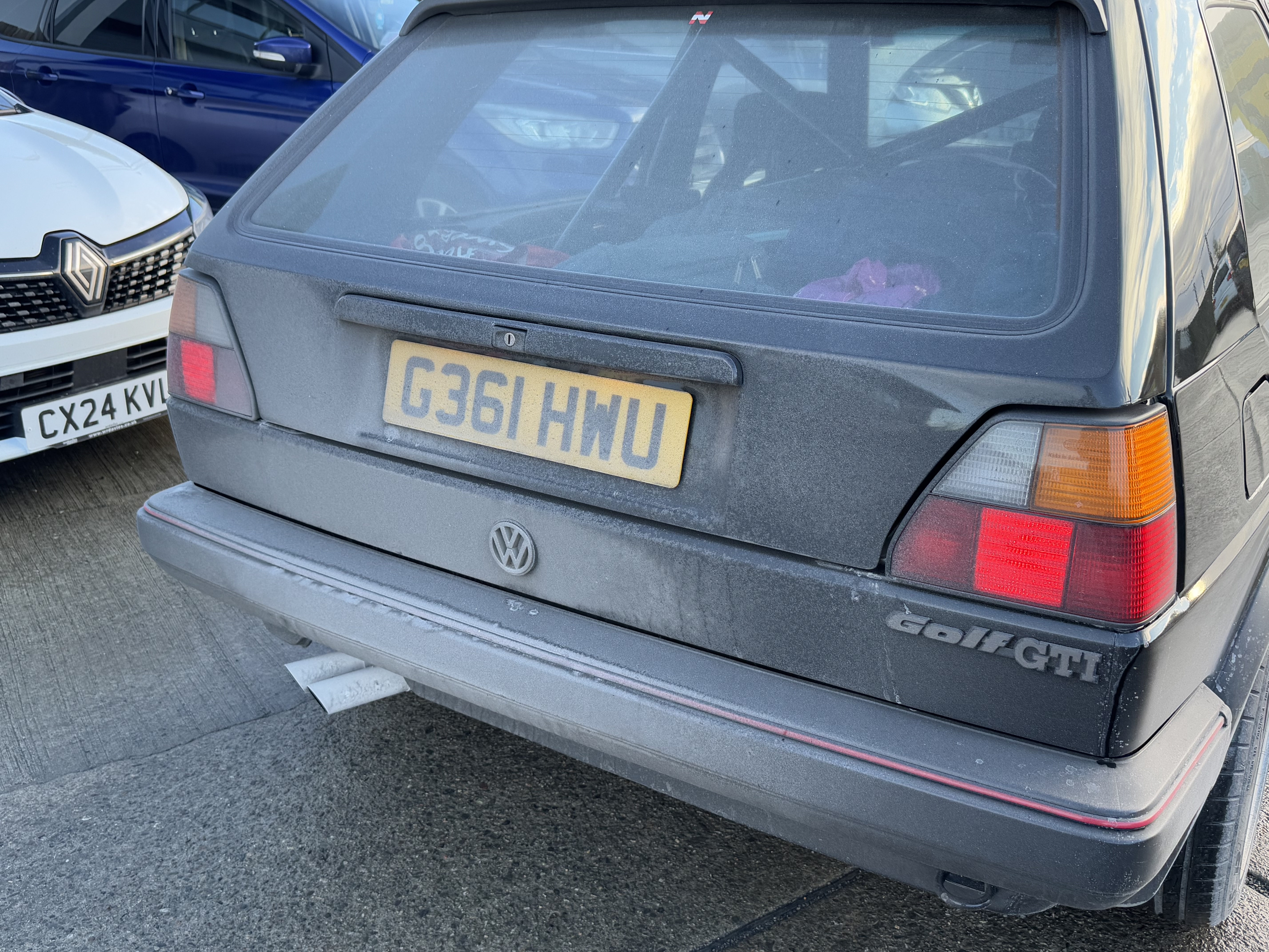

It’s about 15 years since the Golf has seen a salty road, and it killed me inside!
YUCK!
