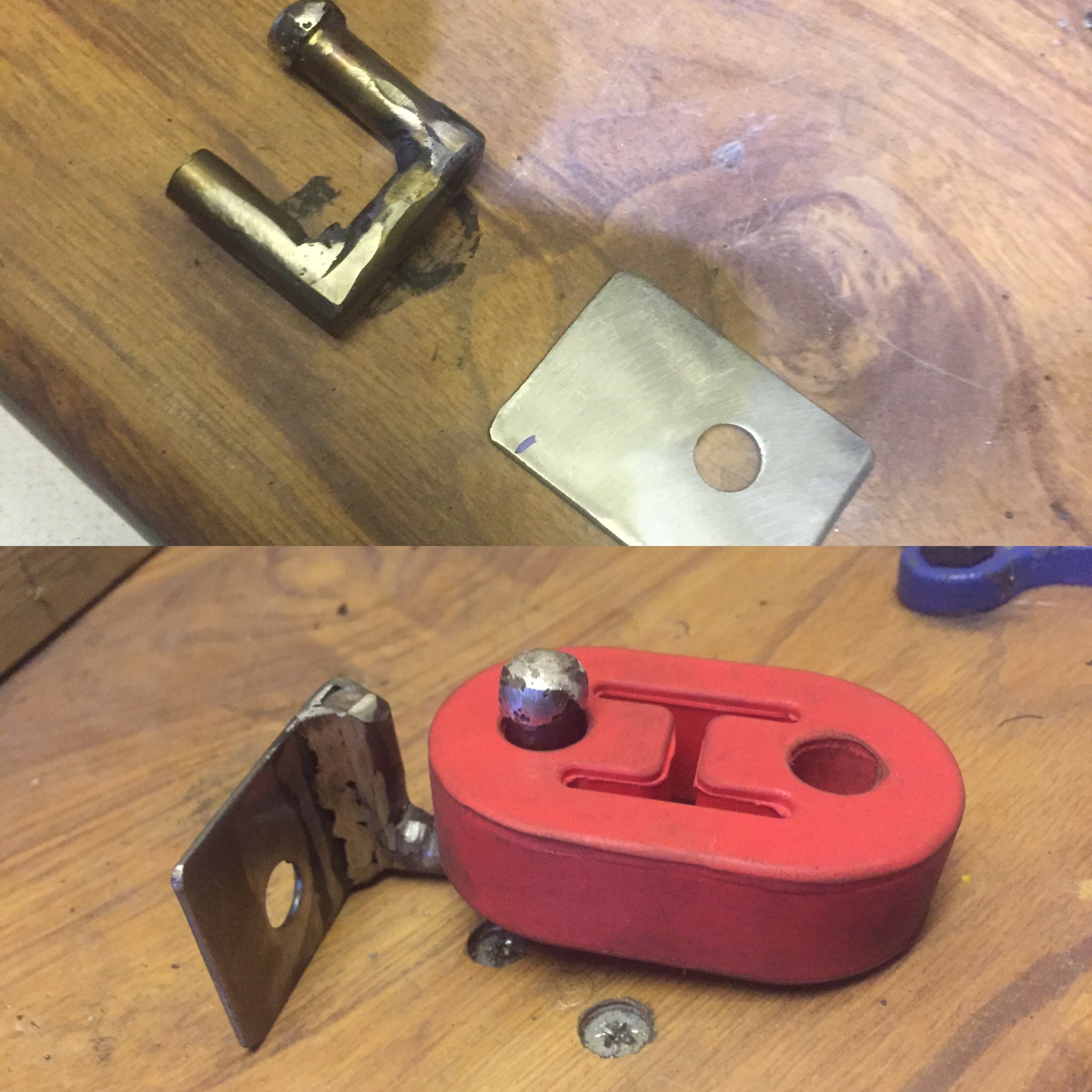

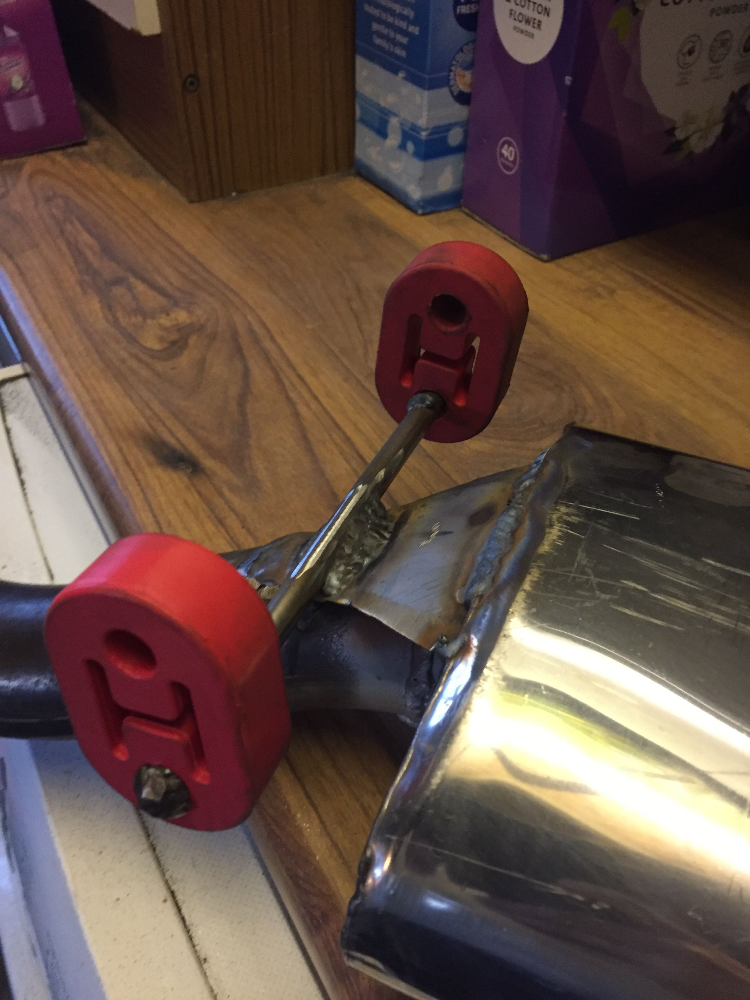

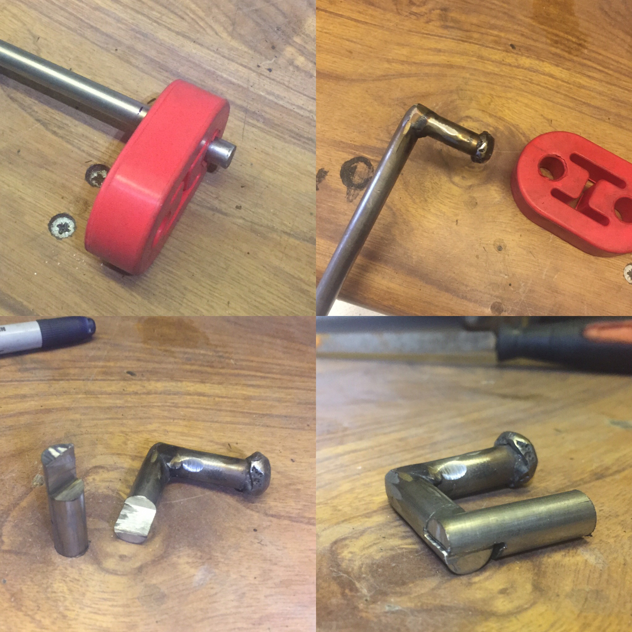

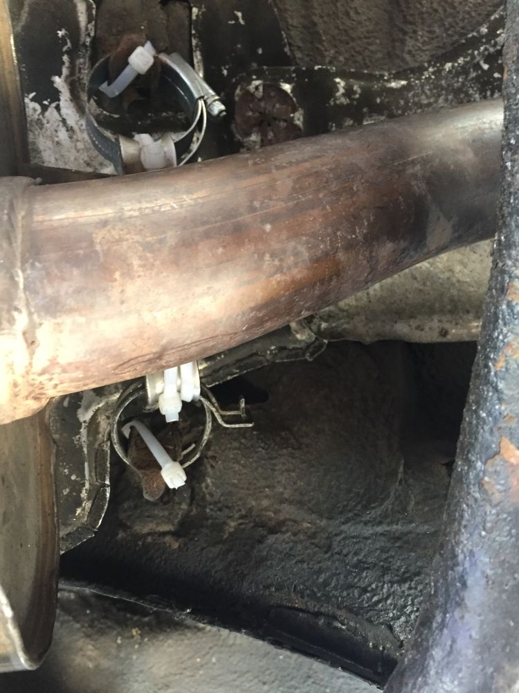

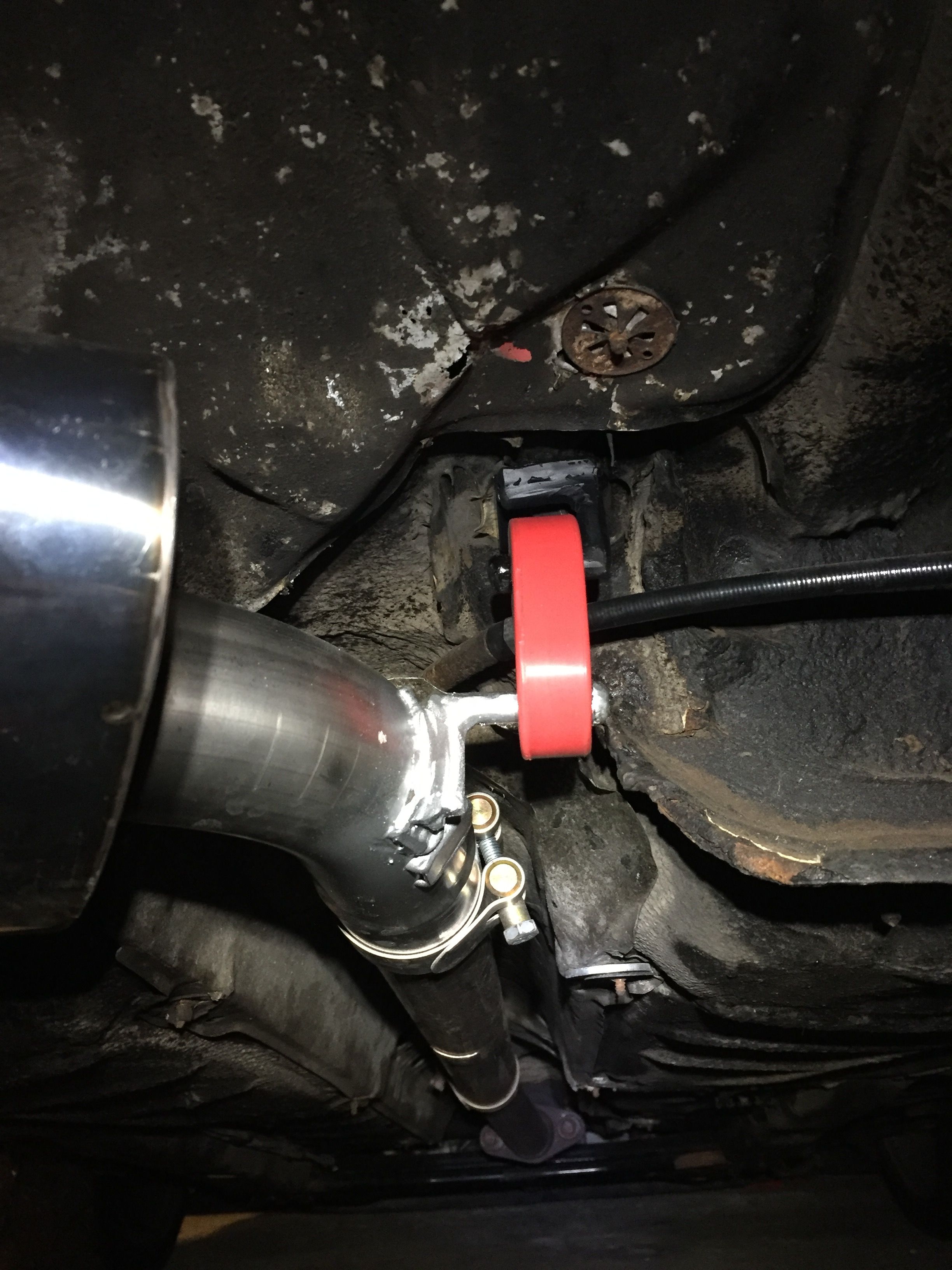

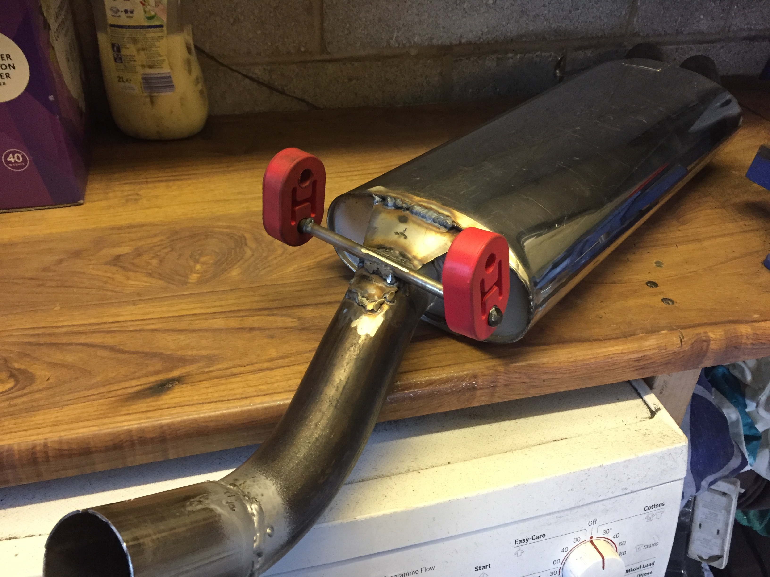

The only issue I had through the week were the exhaust rubbers. No matter which ones I try they always melt!
Re: Cope's GTI
So had to make do with some makeshift hangers

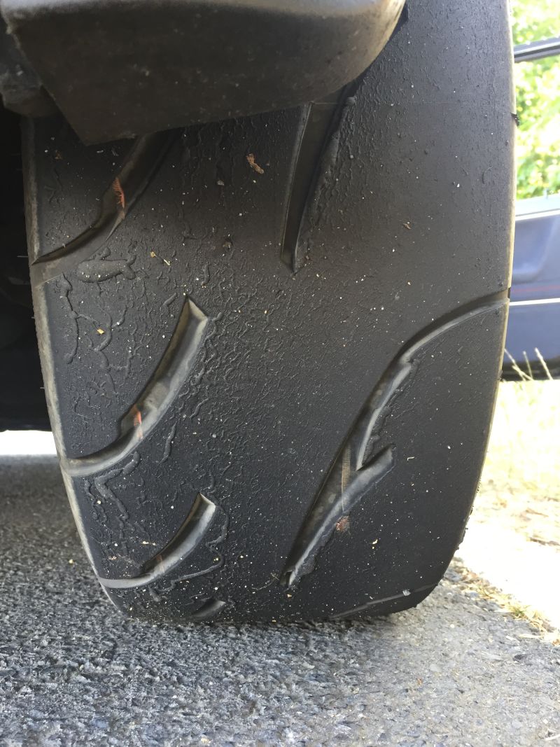

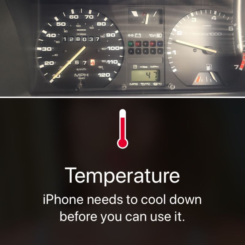

Throughout the trip ambient temps were around 33degrees C! even at 7pm at night. That meant an alarmingly high track temp!!
As a result Beardy and Ford decided not to go out after both experiencing over heating tyres and brakes.
The Golf still felt great so I kept lapping, I think Jeffery came out for almost all of them!
The AR1's were really dealing with the heat well and even though they took a mile or so to warm up the level of grip compared to the NS-2R's is next level!

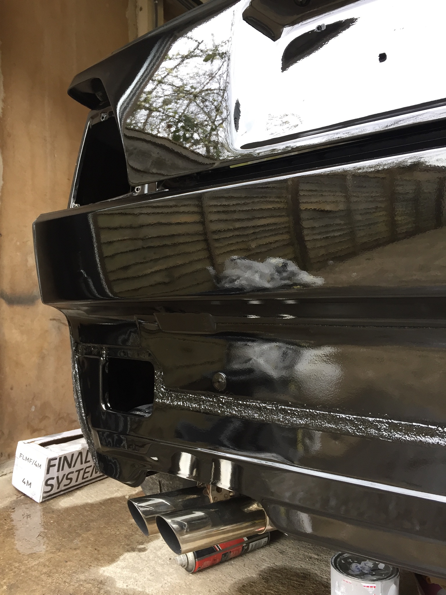

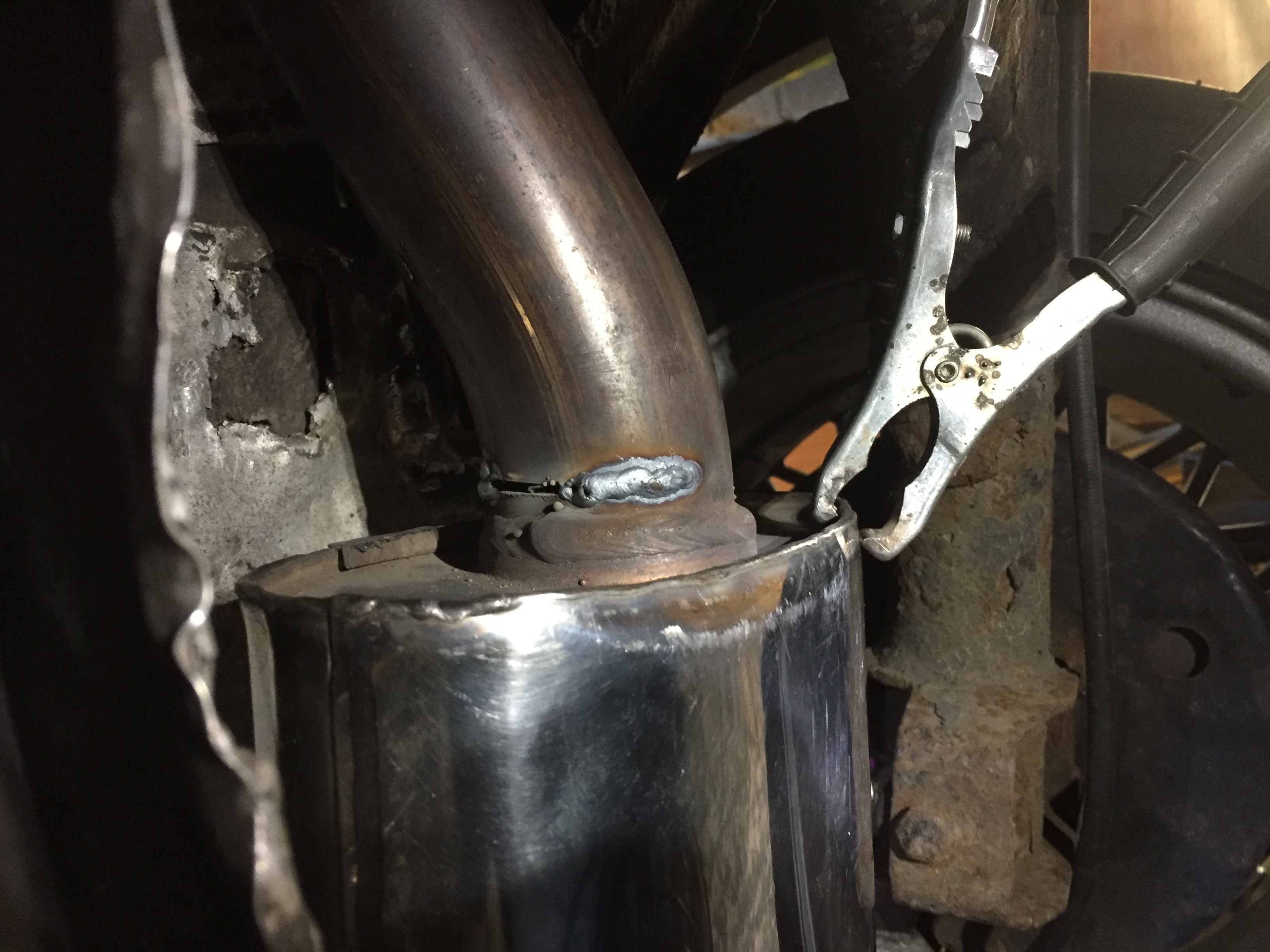

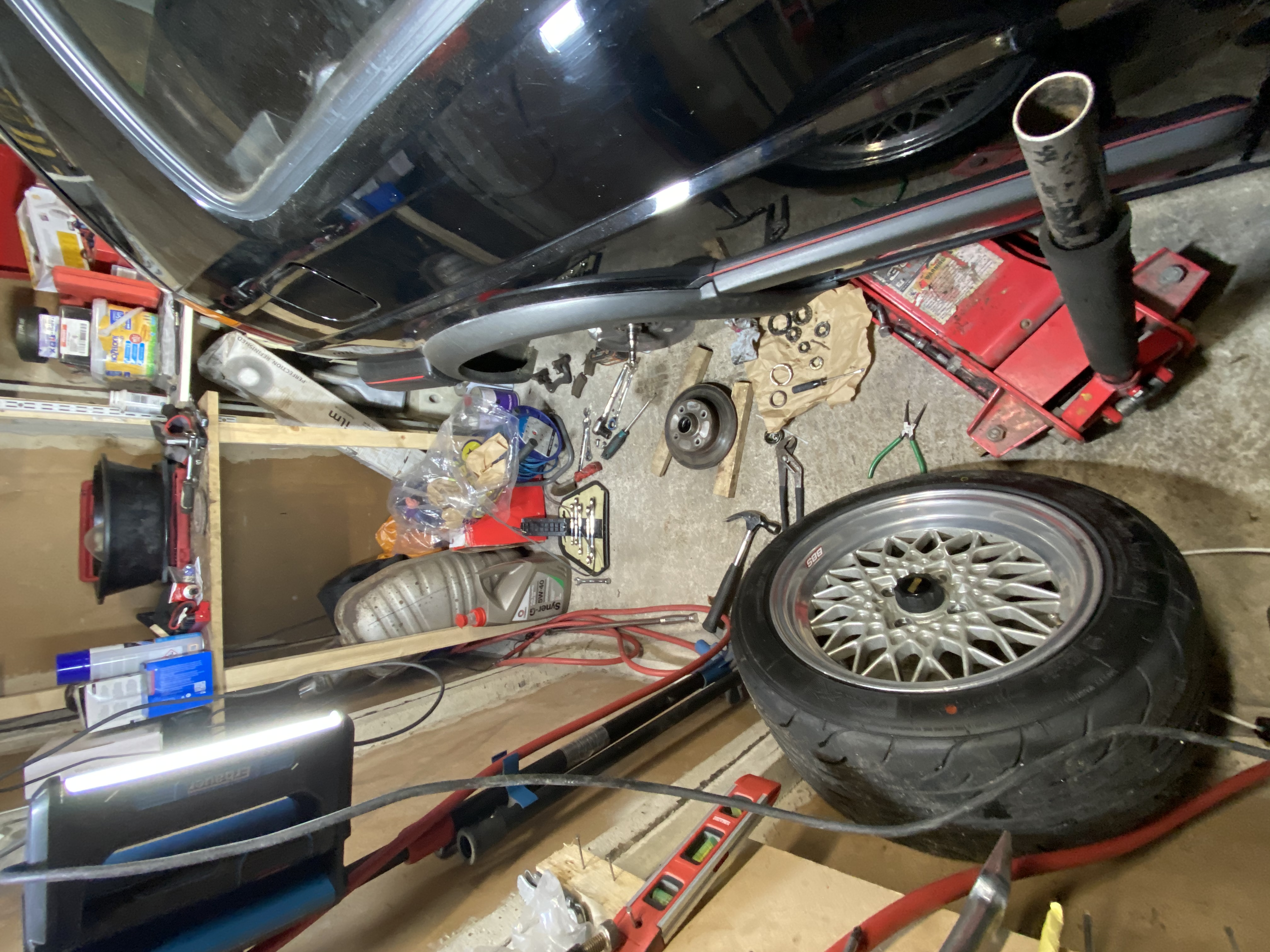

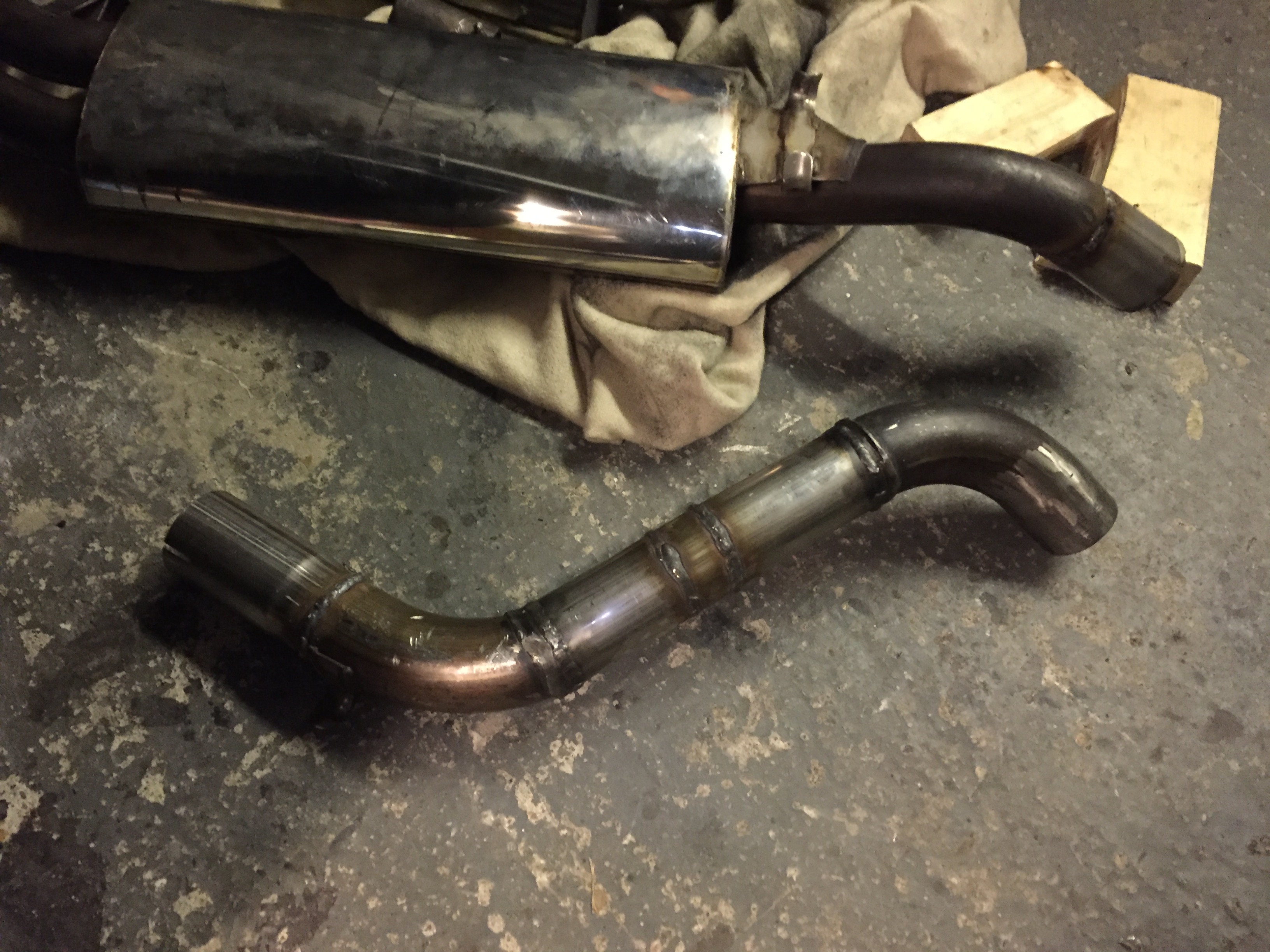

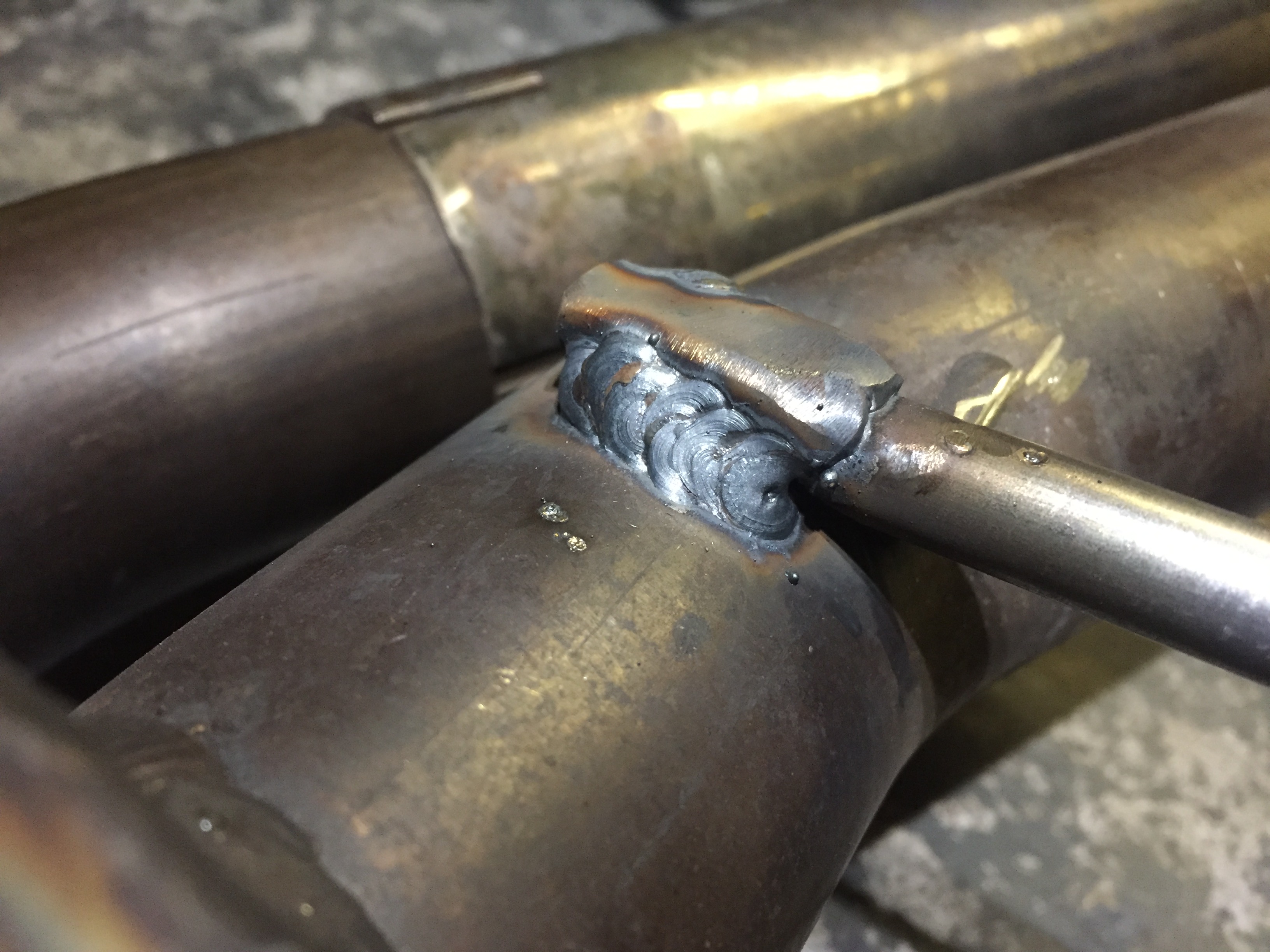

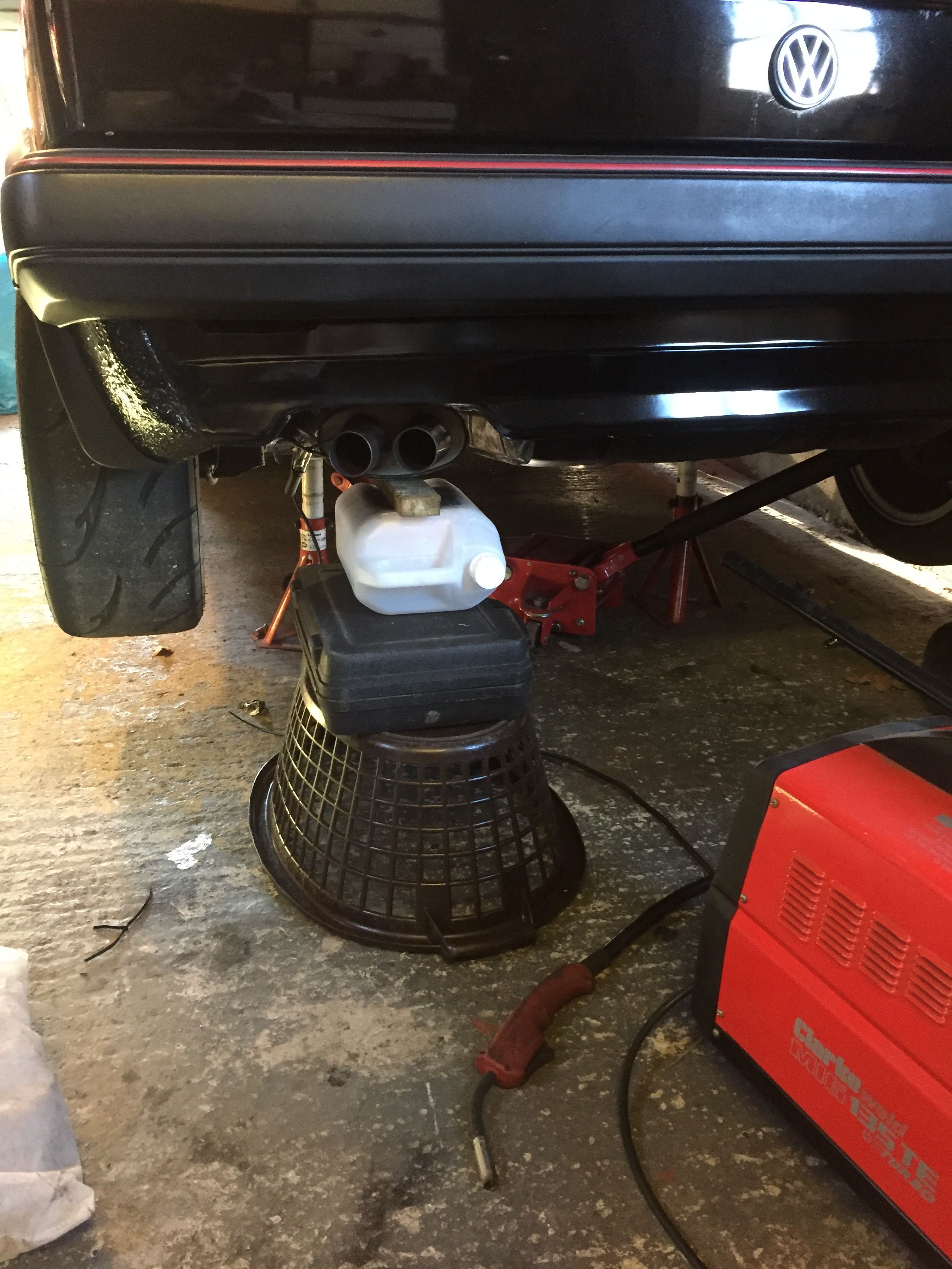

We will start with the exhaust. the mid box on my Miltek classic system started to rattle. I contacted Milltek and they send me out a new one. I decided to make a straight through to back box system using the old box as a template.
This was a fun little project, but ultimately the car was awful! it was loud, really loud. It had lost all its rasp and was all drone. So that idea went out the bag!

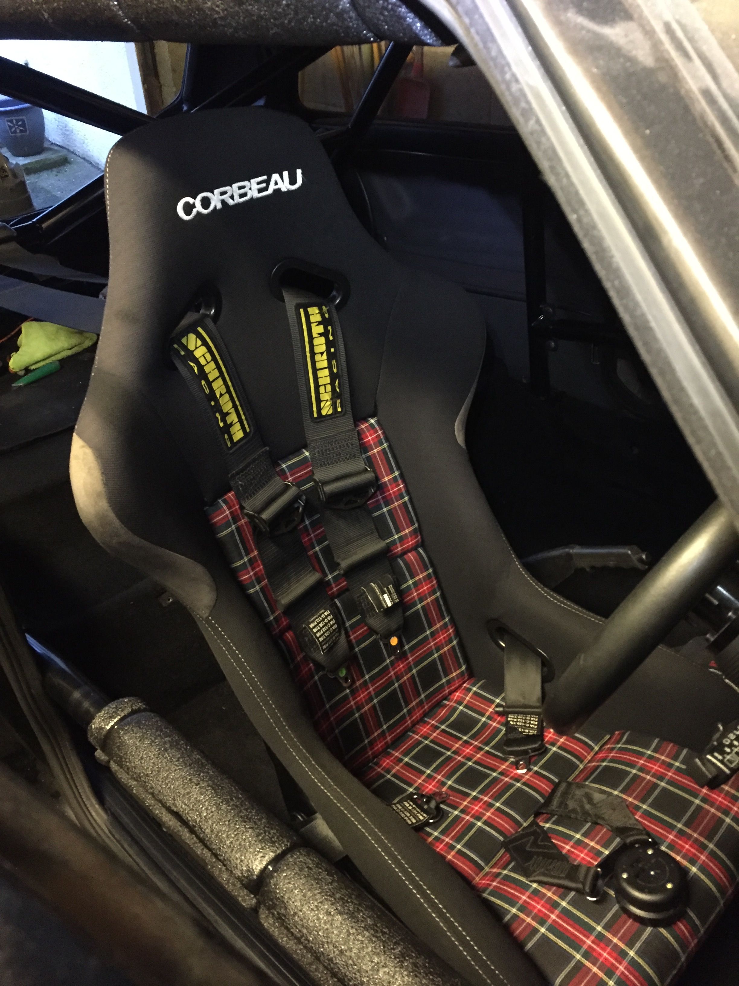

Seats

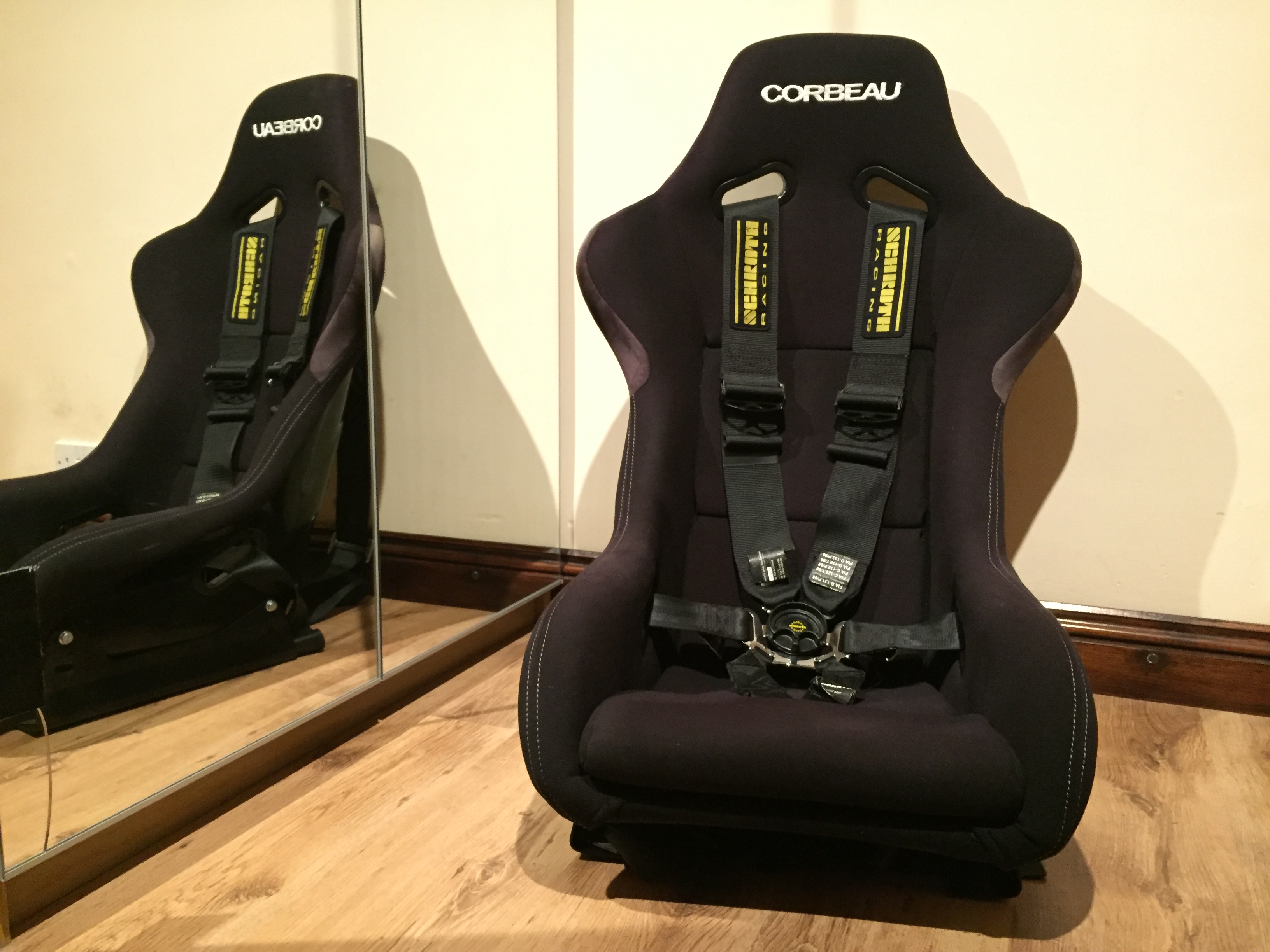

I did a trackday at Croft in Nov 2019, which was brilliant. But one thing was letting the experince down -the seats... Although mk2 Recaros are a lovely seat, for track use the just aren’t stable enough.
Originally I swapped these for a set of Recaro Pole Positions – perfect, just was I was after!
After trying them out, they were the wider ABE versions. Being a slim Jim they weren’t suitable for me so I sold them. I was then on the hunt for some SPG’s or the narrower FIA versions. After some searching and being a bloody tight Yorkshireman, I just couldn’t justify £1200 on a set of seats –Reading this thread, you will all probably know already, I’m fussy. Things have to be just right or I won’t do It and this was no different.
After some research I found out that the older style Corbeau Clubsports were apparently discontinued because they had used the same/similar mould as the Recaro Pole Position. The price was much more suitable for me too, at around £130-£150.a seat used. That’ll do nicely.
Now onto the next issue.

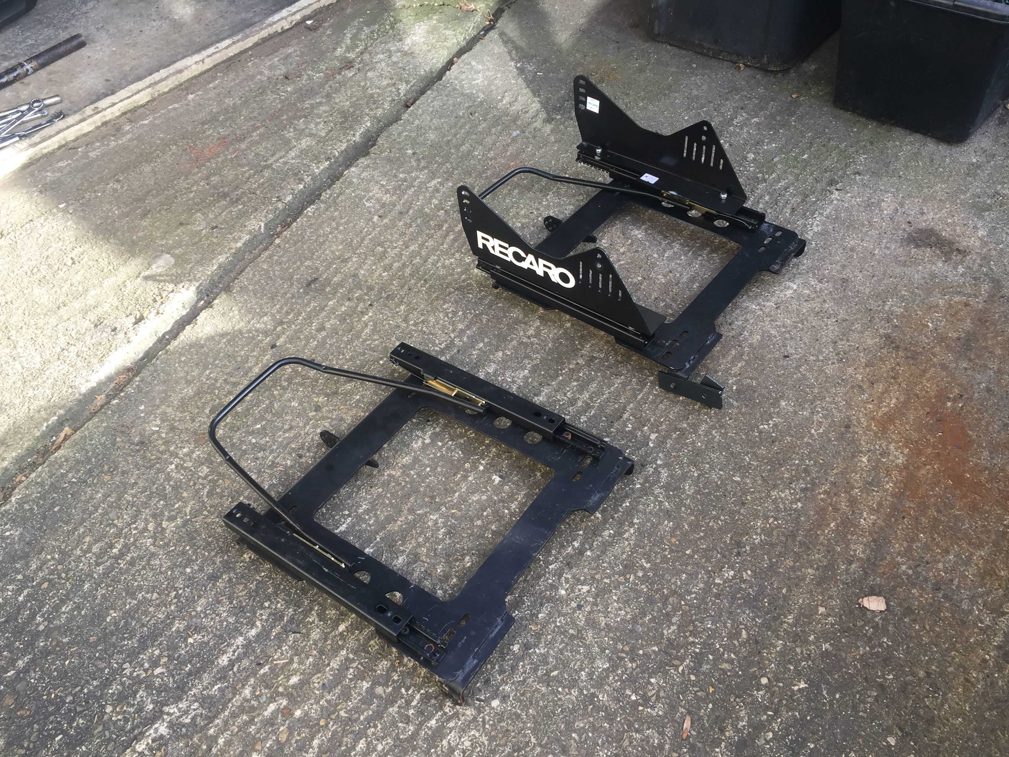

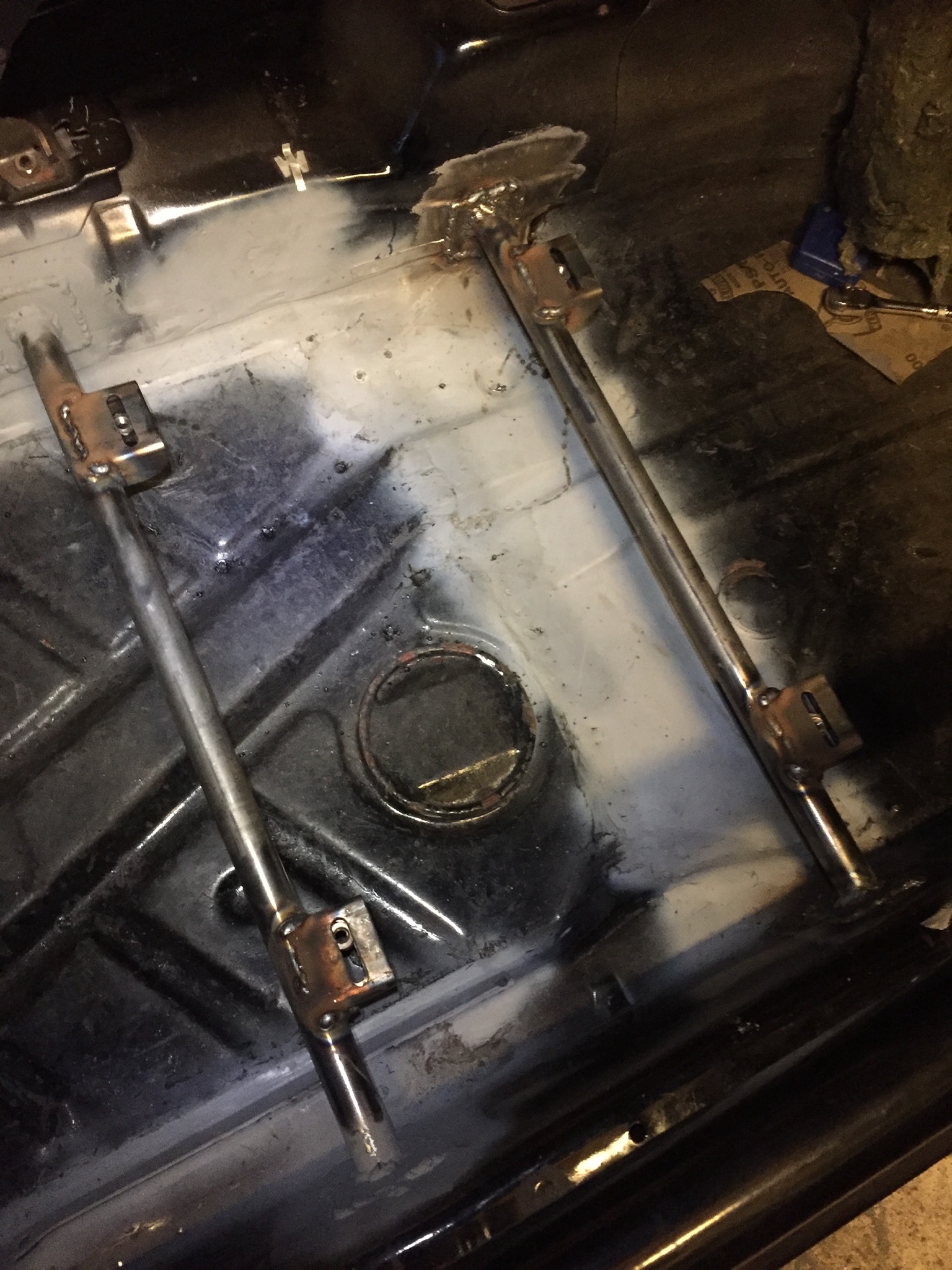

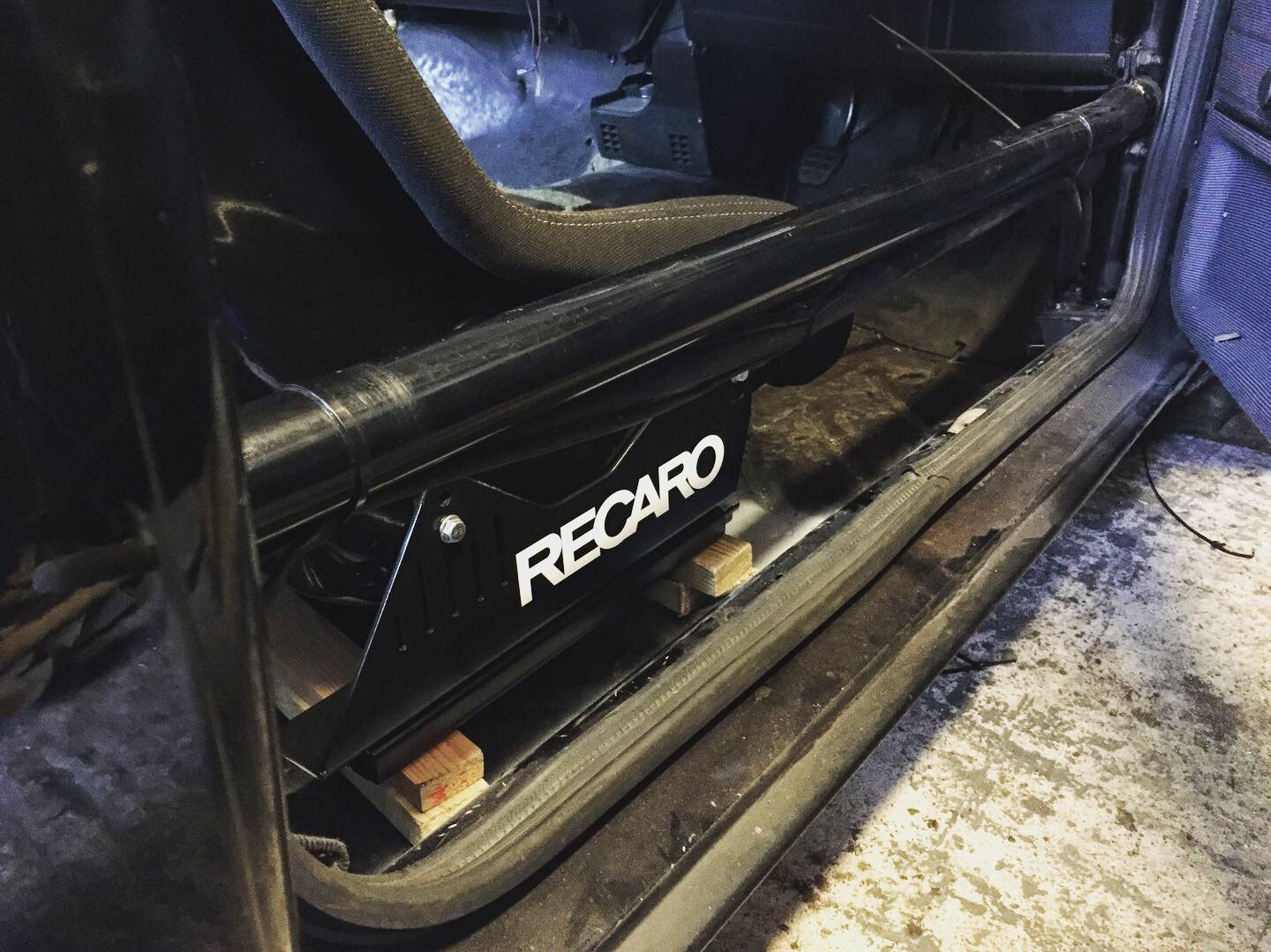

I’d got hold of some mk2 golf bucket seat subframes which bolt into the factory runners. There were 3 immediate problems. Firstly the weight – despite the car being more track orientated I’m not chasing weight saving, but these were a joke. Easily as heavy as the standard mk2 recaro if not heavier. Secondly, due to the design of the factory sliders and the way the subframe bolts into the car there was 3/4mm plug up and down. Thirdly, they sat SO high up. I’m 5’7” – a short arse by any stretch and even I felt like Donkey Kong on Mario Kart.
You can see below how high the seat sat in the car.
So a rethink was in order.

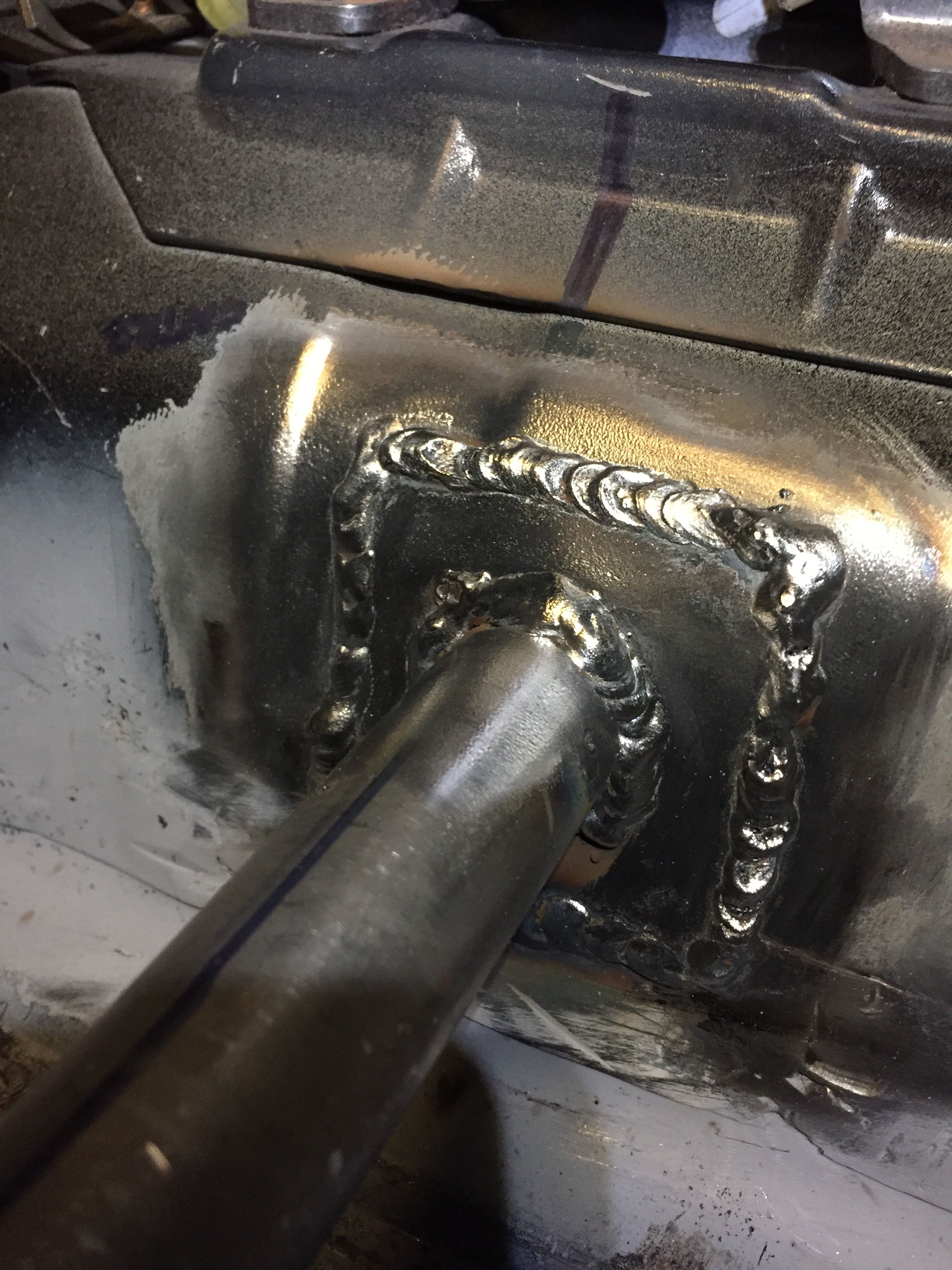

The only real way I was going to be happy was chop out the original factory mounts and weld in tubular rails. So I got a set ordered up and set to the rails with a spot drill. Not a fun job!
I used chocks of wood to get the seat where I wanted to. It’s a long process but it’s the only way to get it 100% correct.
Trying to make diagrams, take measurement throughout. Not only must you get the back and forward position right, left and right but you also have to make sure its square, a pain on a mk2 floorpan!

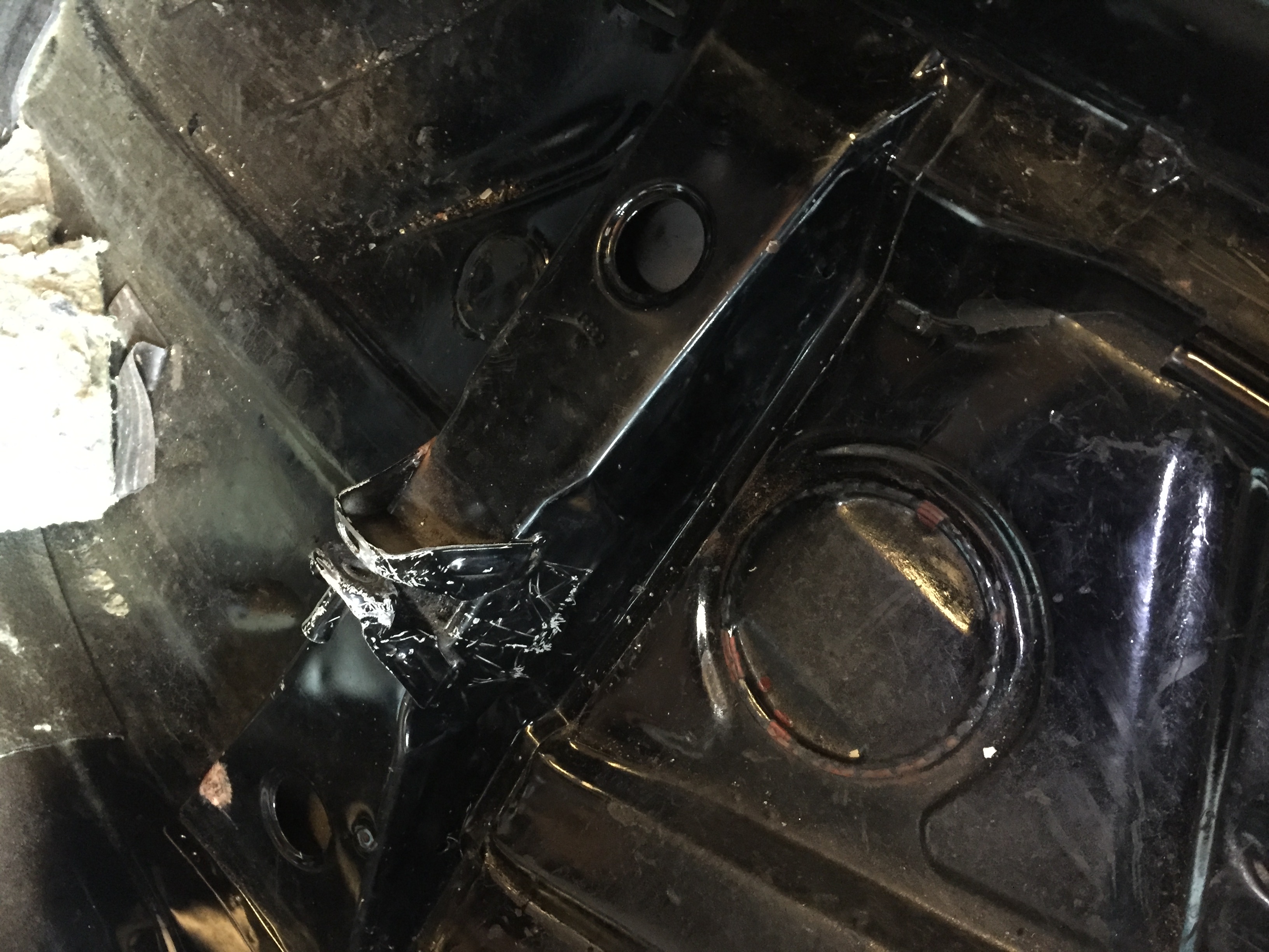

With the seat fitting in progress, another issues raised its ugly head! This time the steering wheel angle and position. I wanted to be sat as low down in the car as possible with my eye line just above the top of the wheel. I ended up making some spacers for the steering column to bring it down around 2.5 inches (the top of the wheel is now inline with the top of the dashboard)
I’ve also spaced the wheel out closer to me by 70mm.
The driving position is now perfect for me! With the clutch in my leg is just off from straight and the wheel is perfectly inline with me shoulders -  well chuffed!

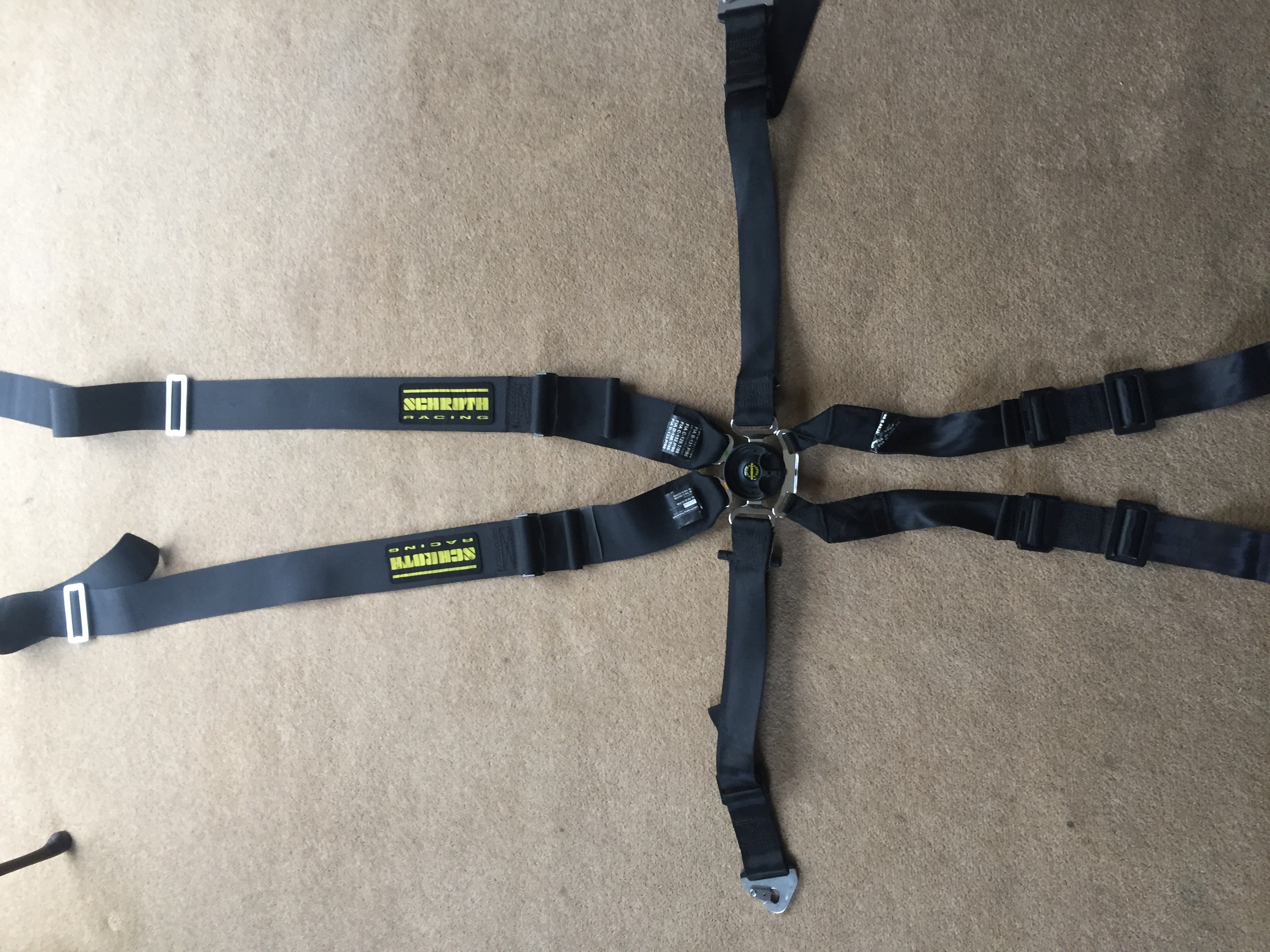

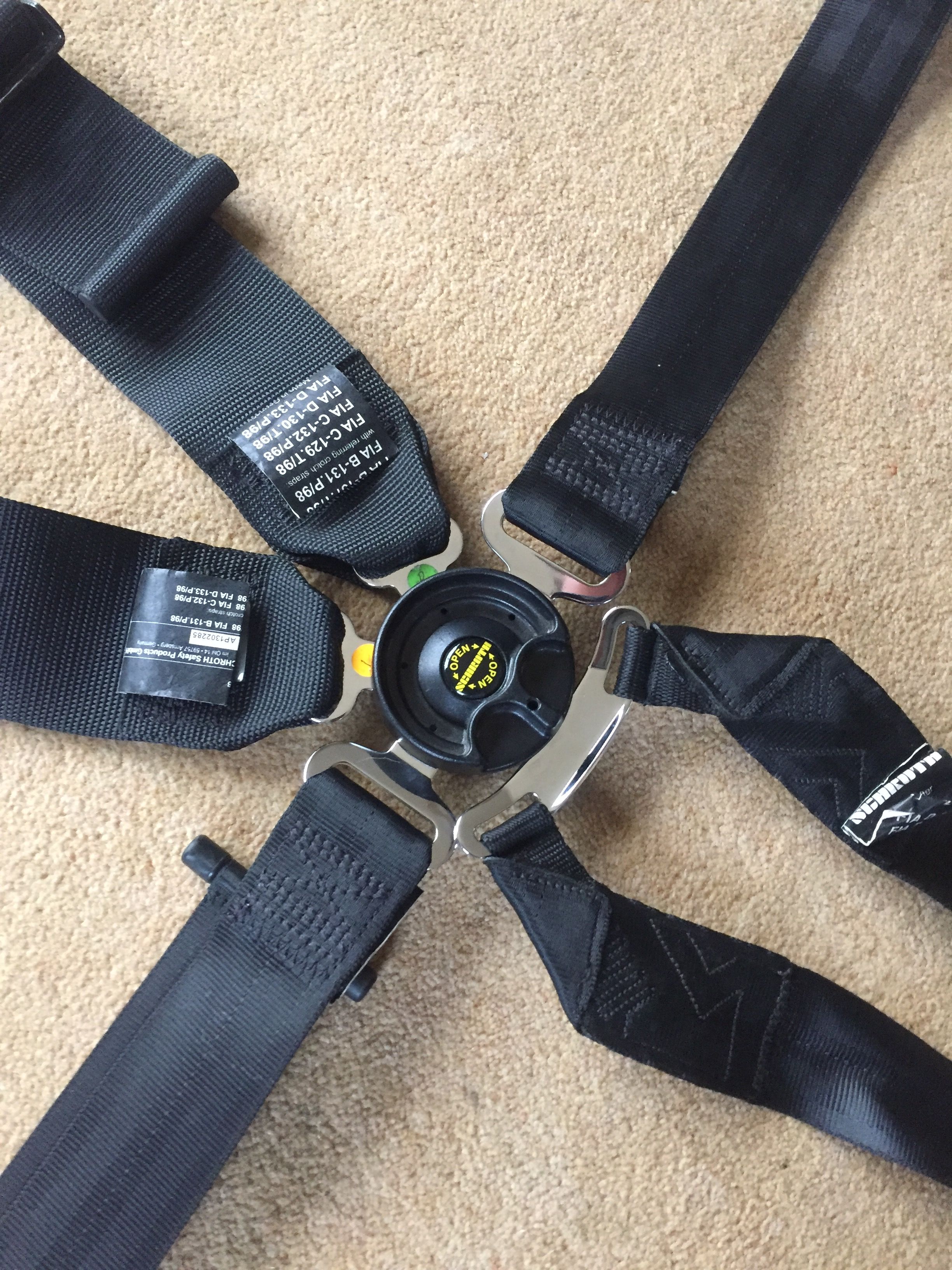

While sorting the seats out I was on the look out for some harnesses. I’d decided on 6 point for the most safety I could. I spoke to a nice chap on fb marketplace who was selling a Schroth harness for £100. I messaged him to ask if he had 2, he said he didn’t – I snapped it up regardless.
To my amazement when the parcel arrived there were 2 sets in the box! I messaged the bloke and he just sent me back a smile! I quickly fired him some beer money over paypal, as a small thankyou. Got very lucky there!

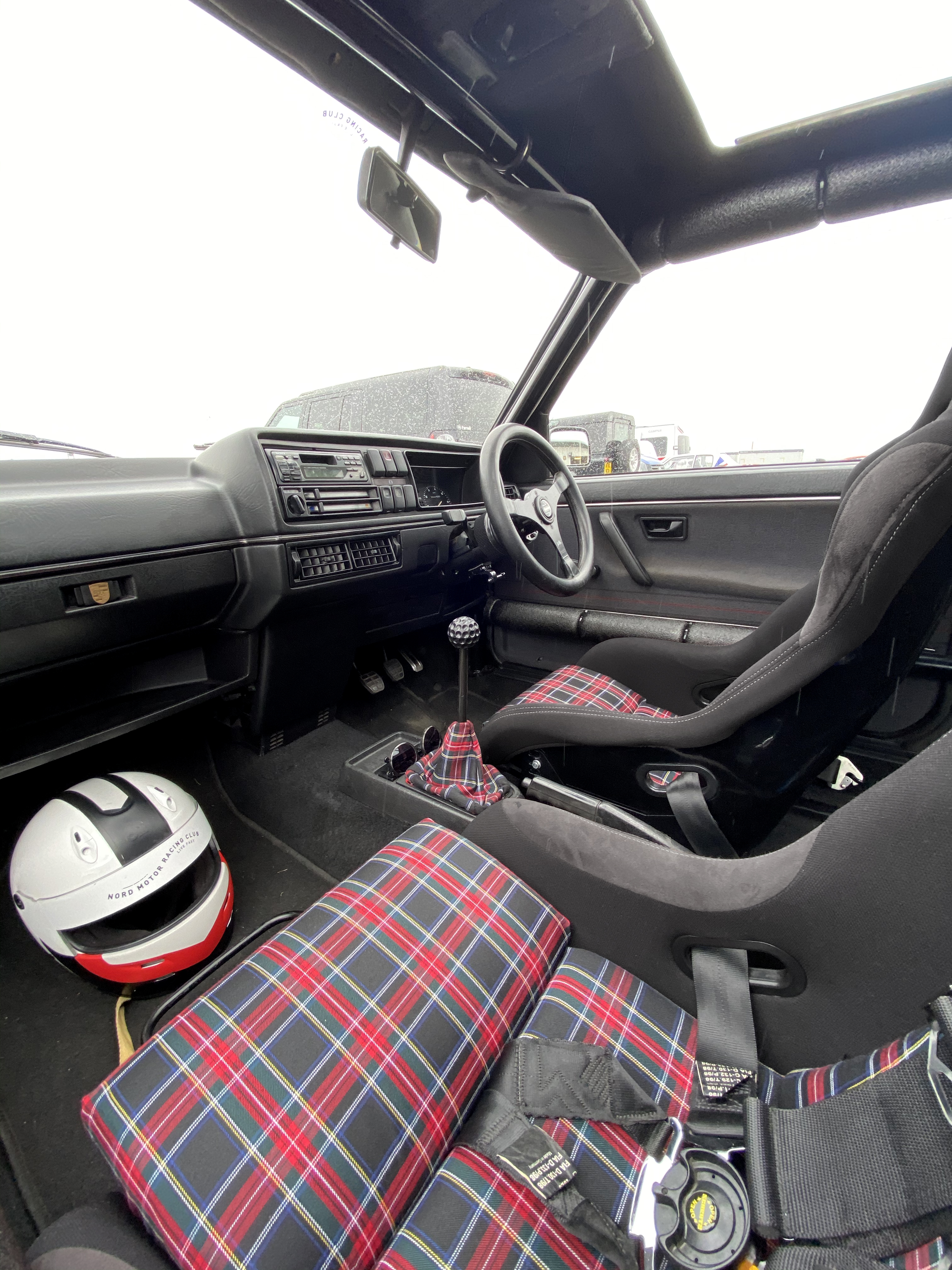

With daily duties sorted, back to the seats.

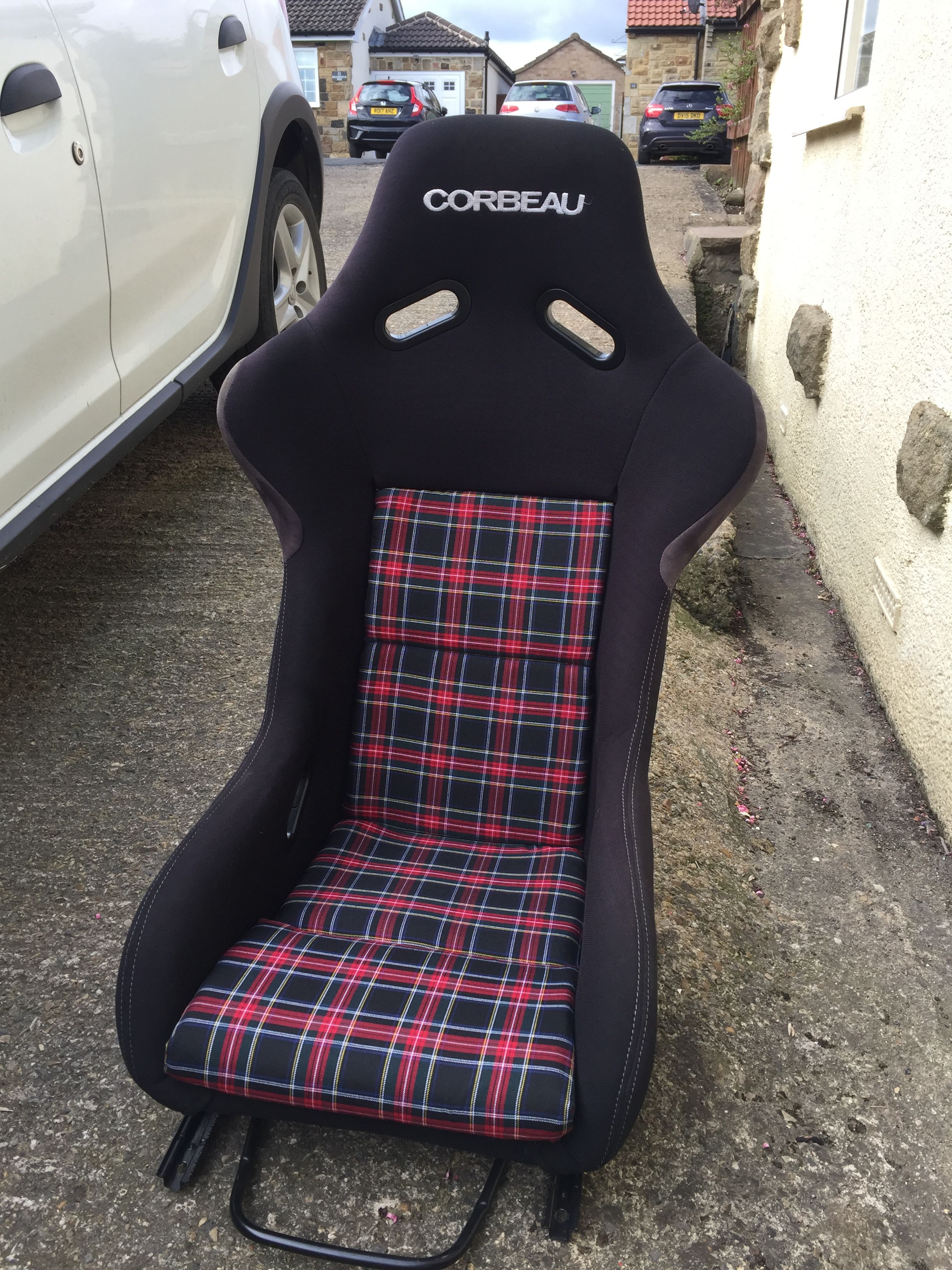

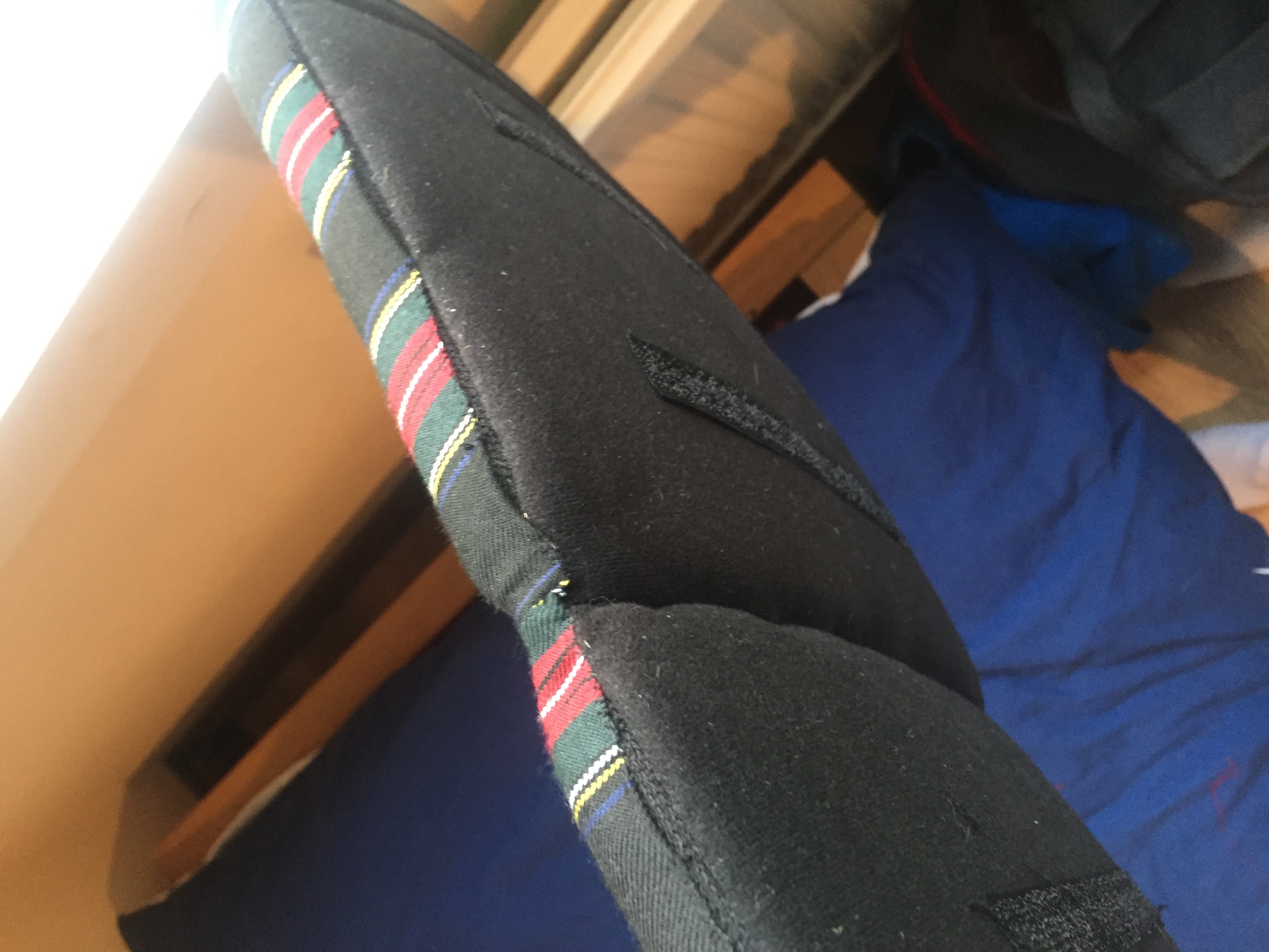

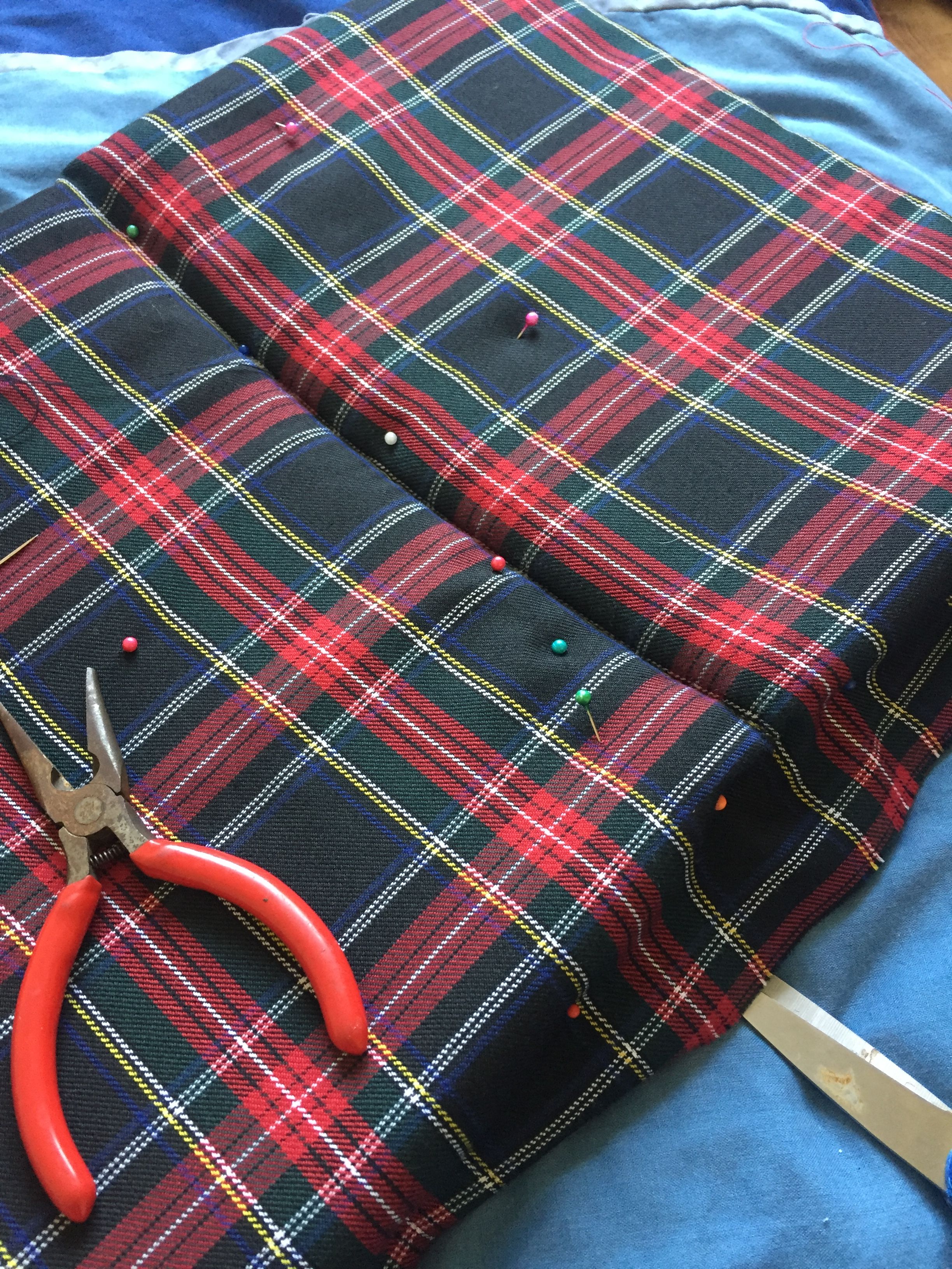

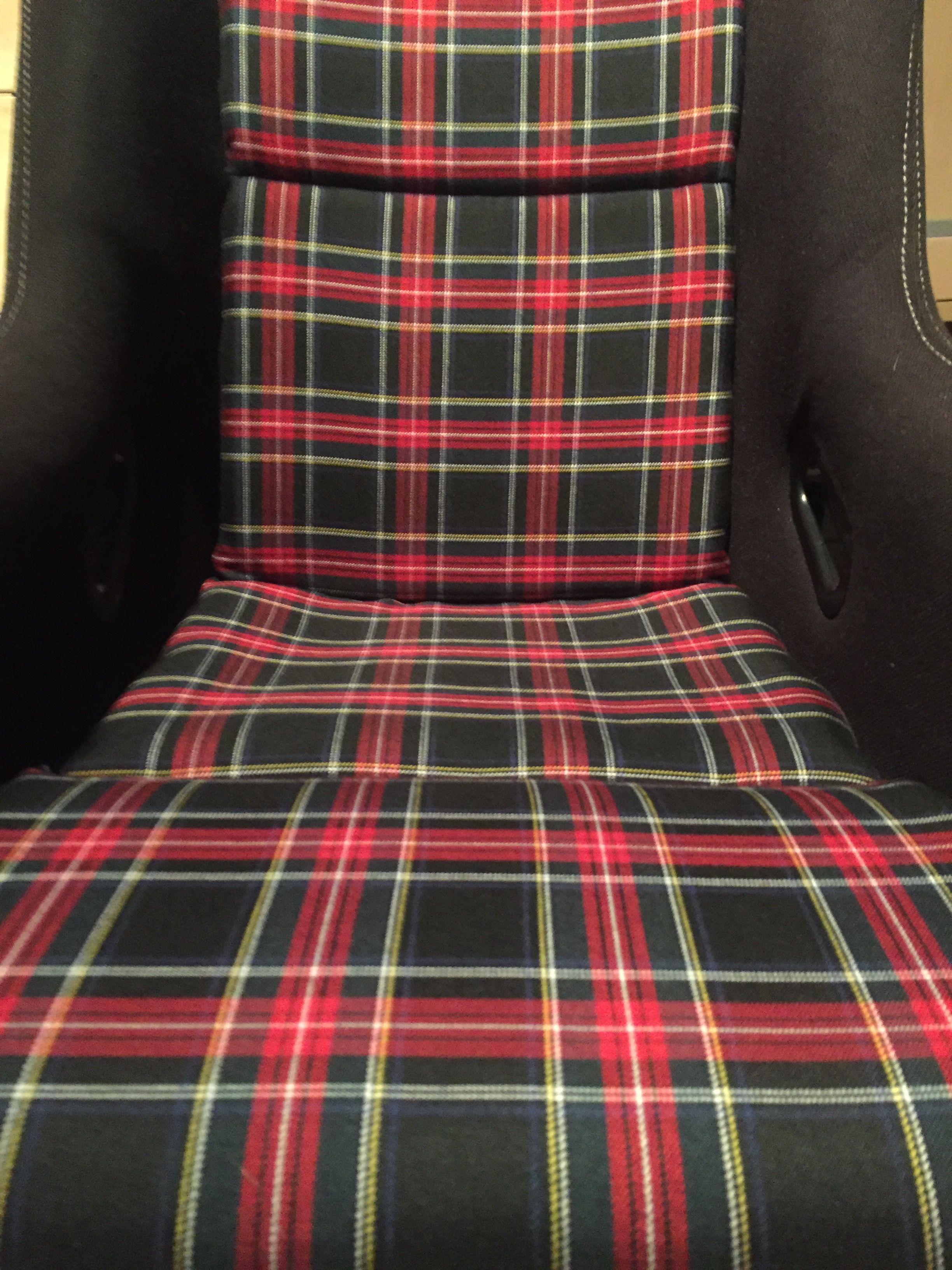

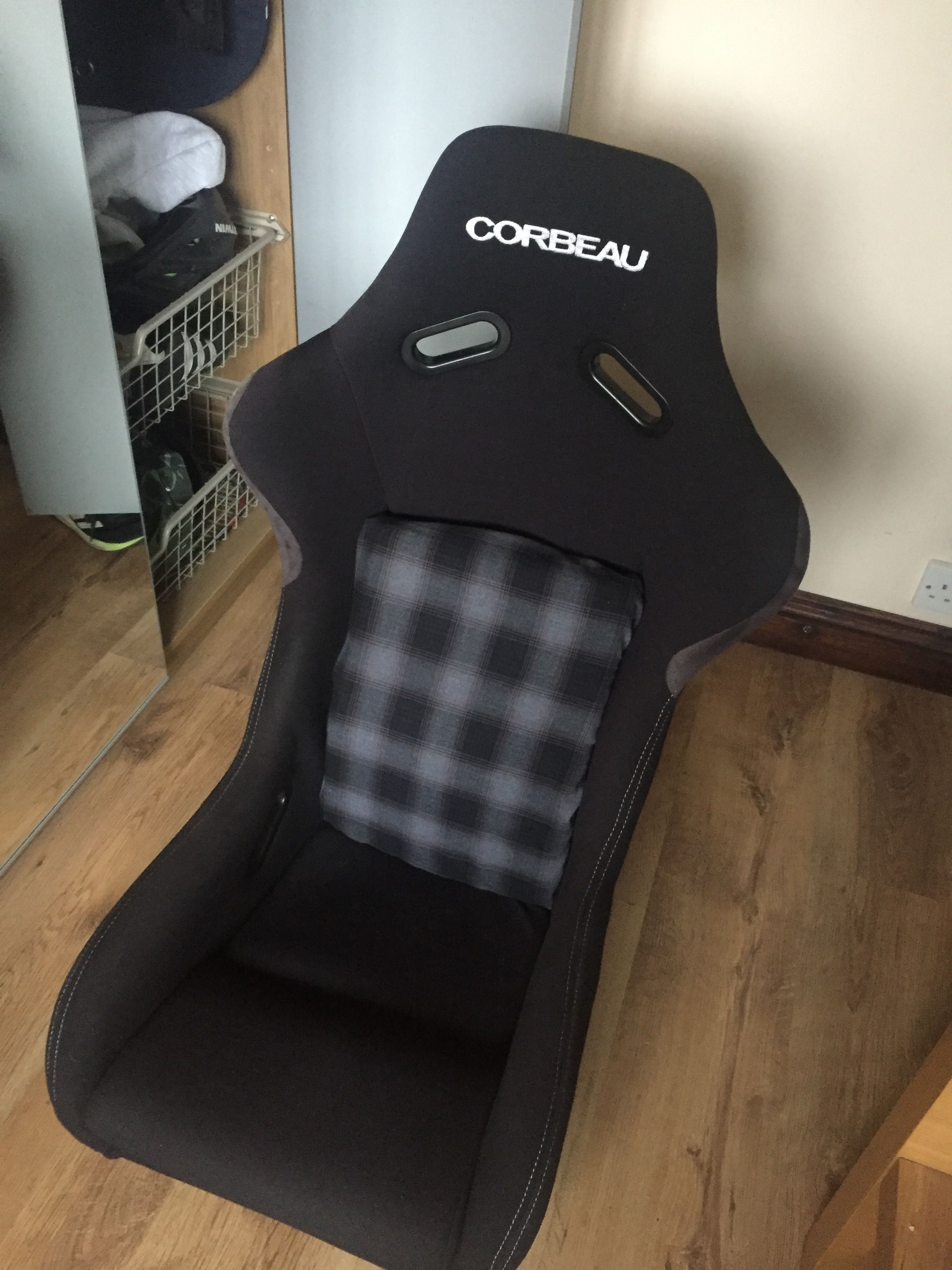

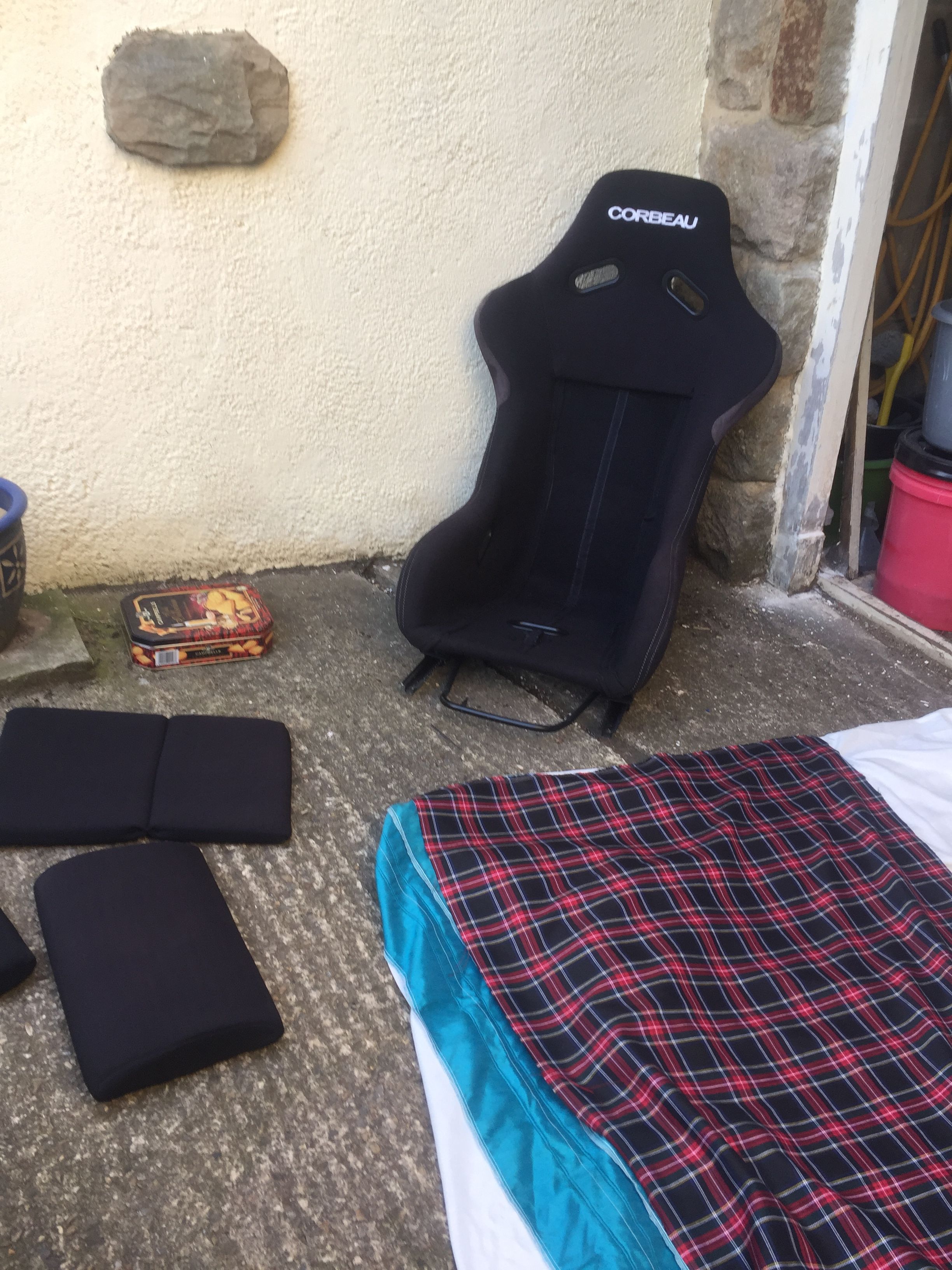

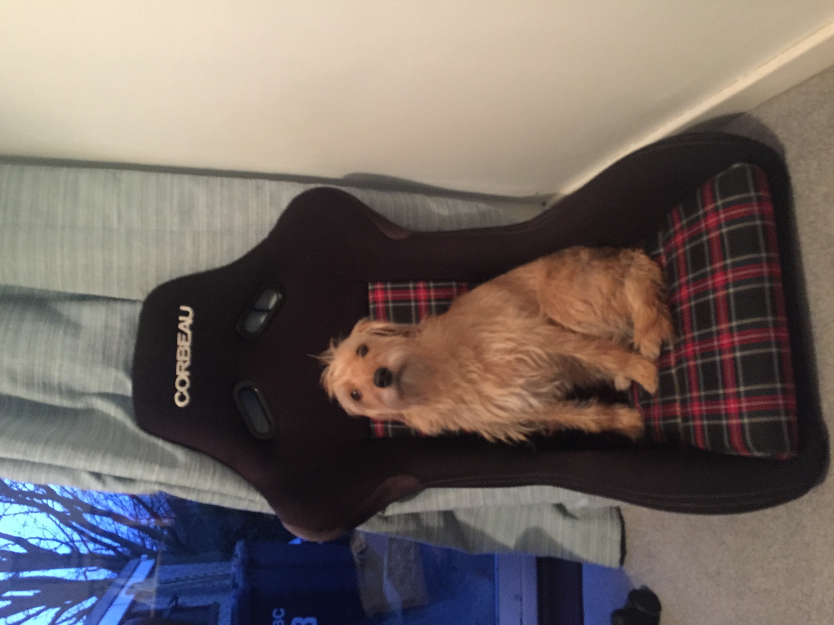

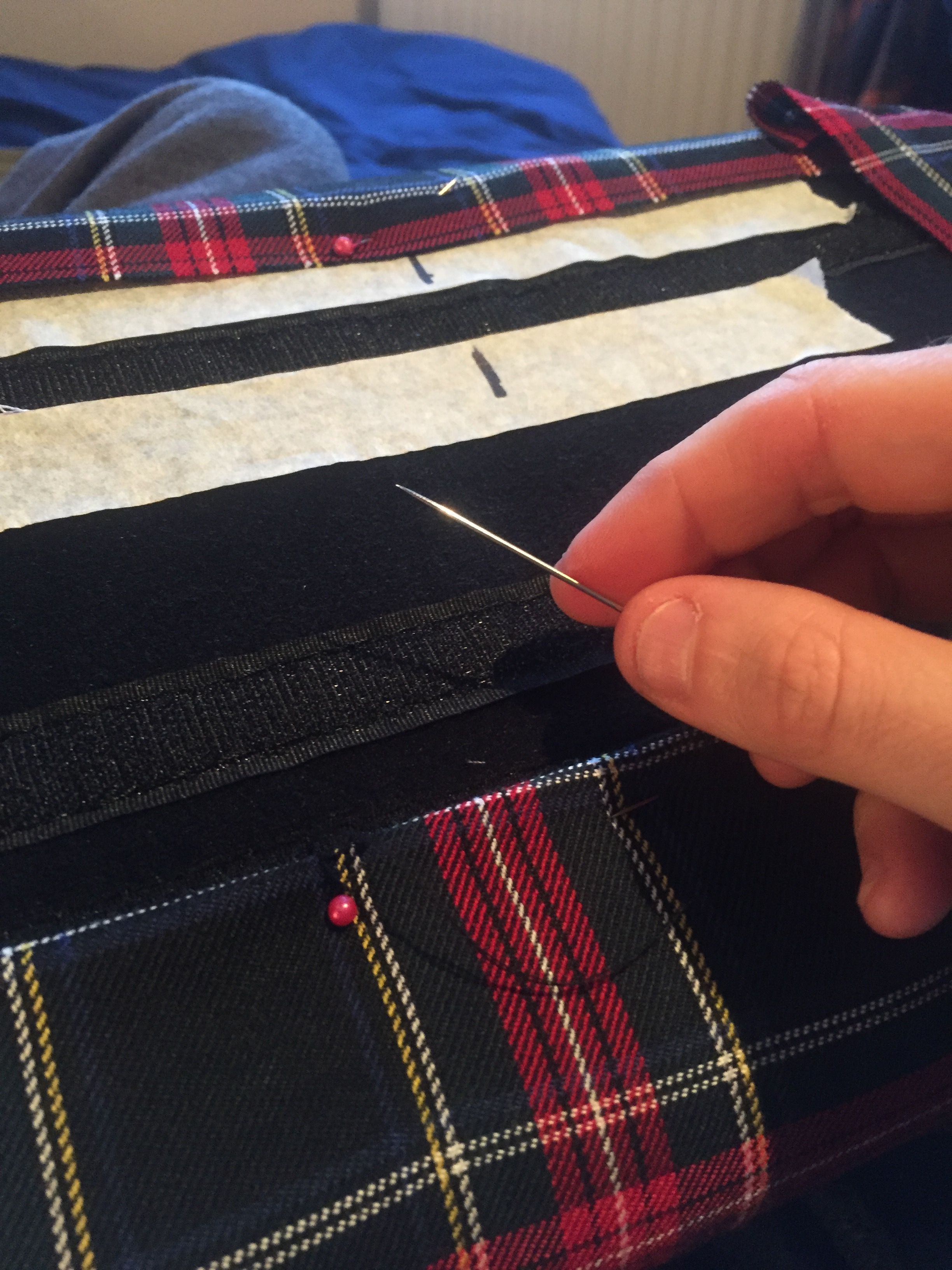

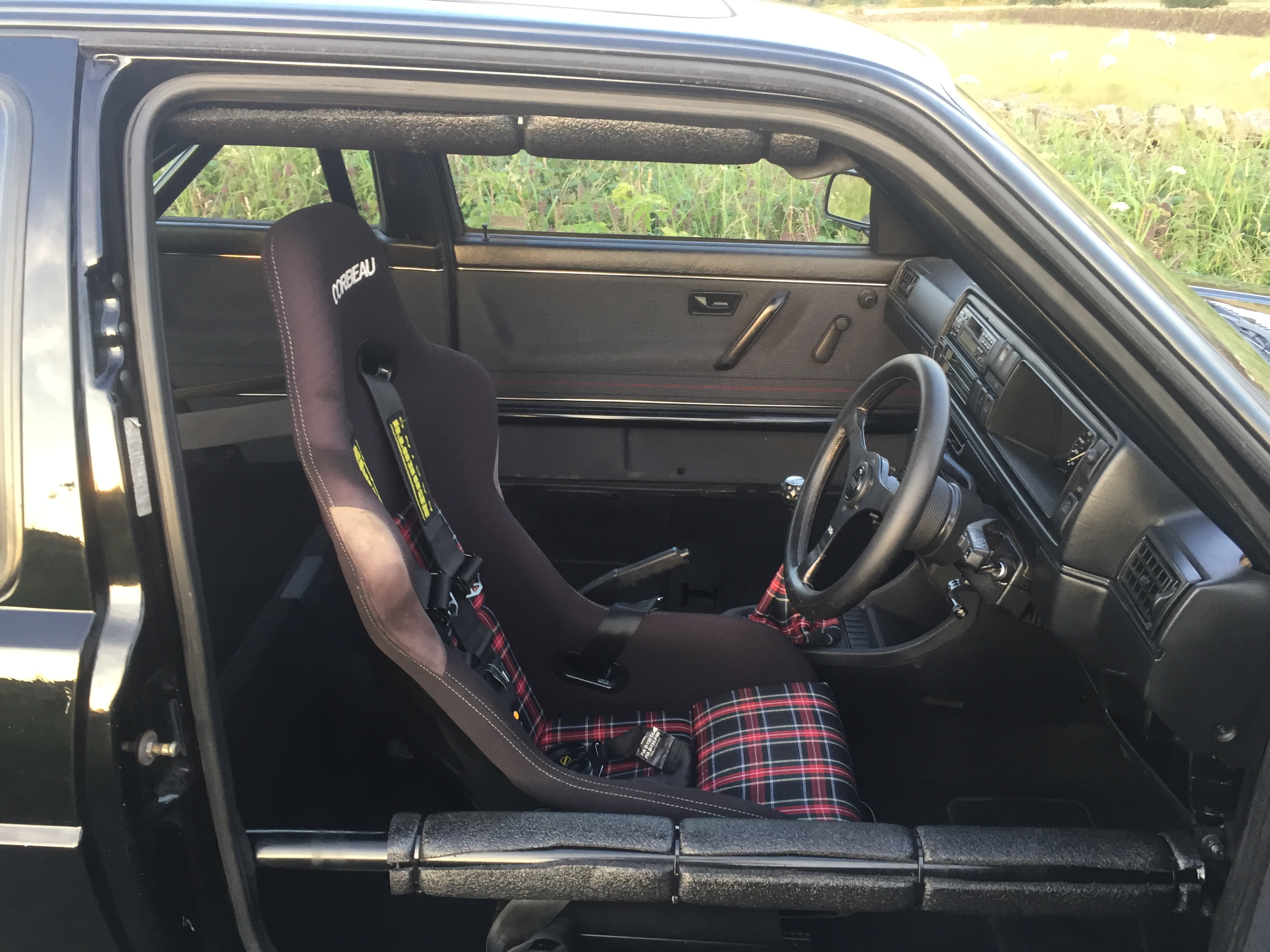

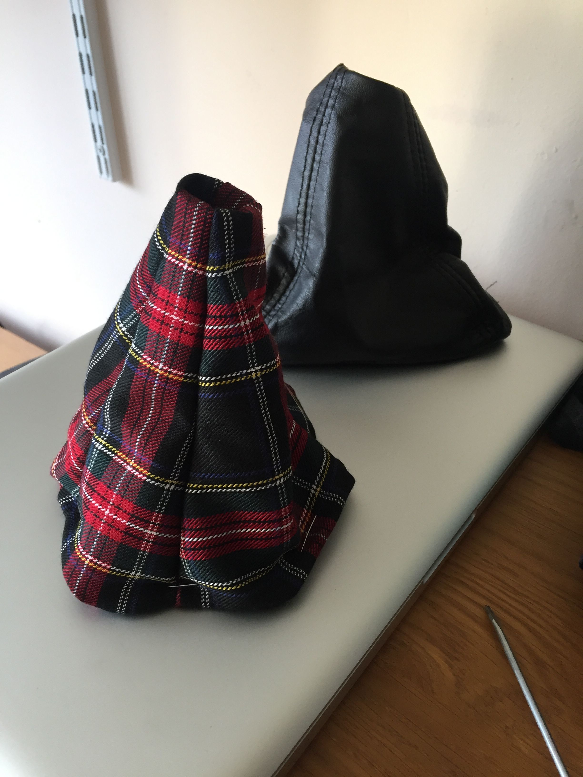

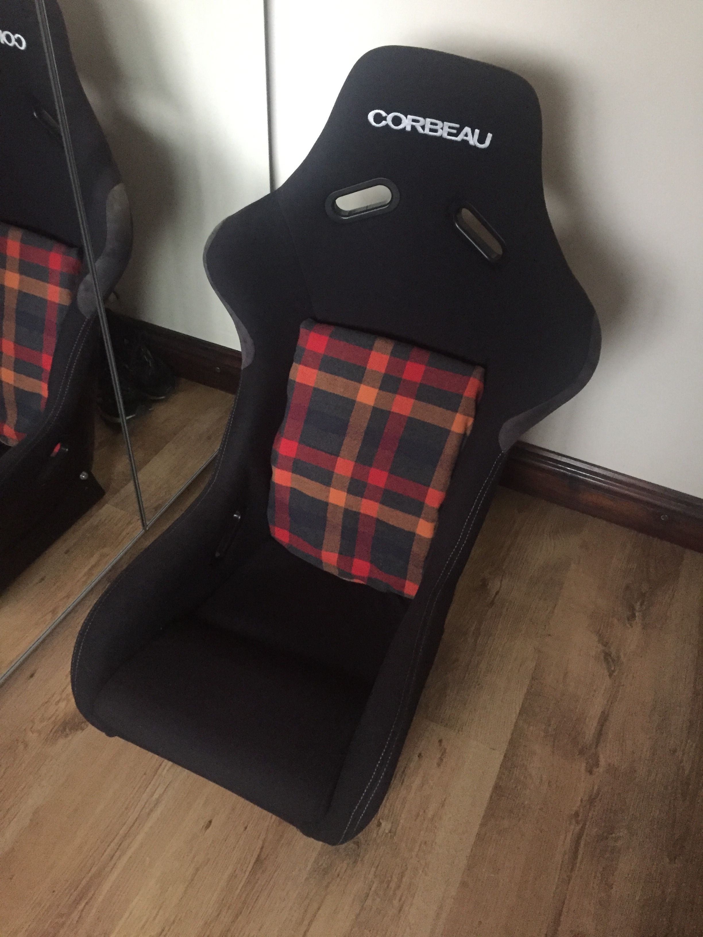

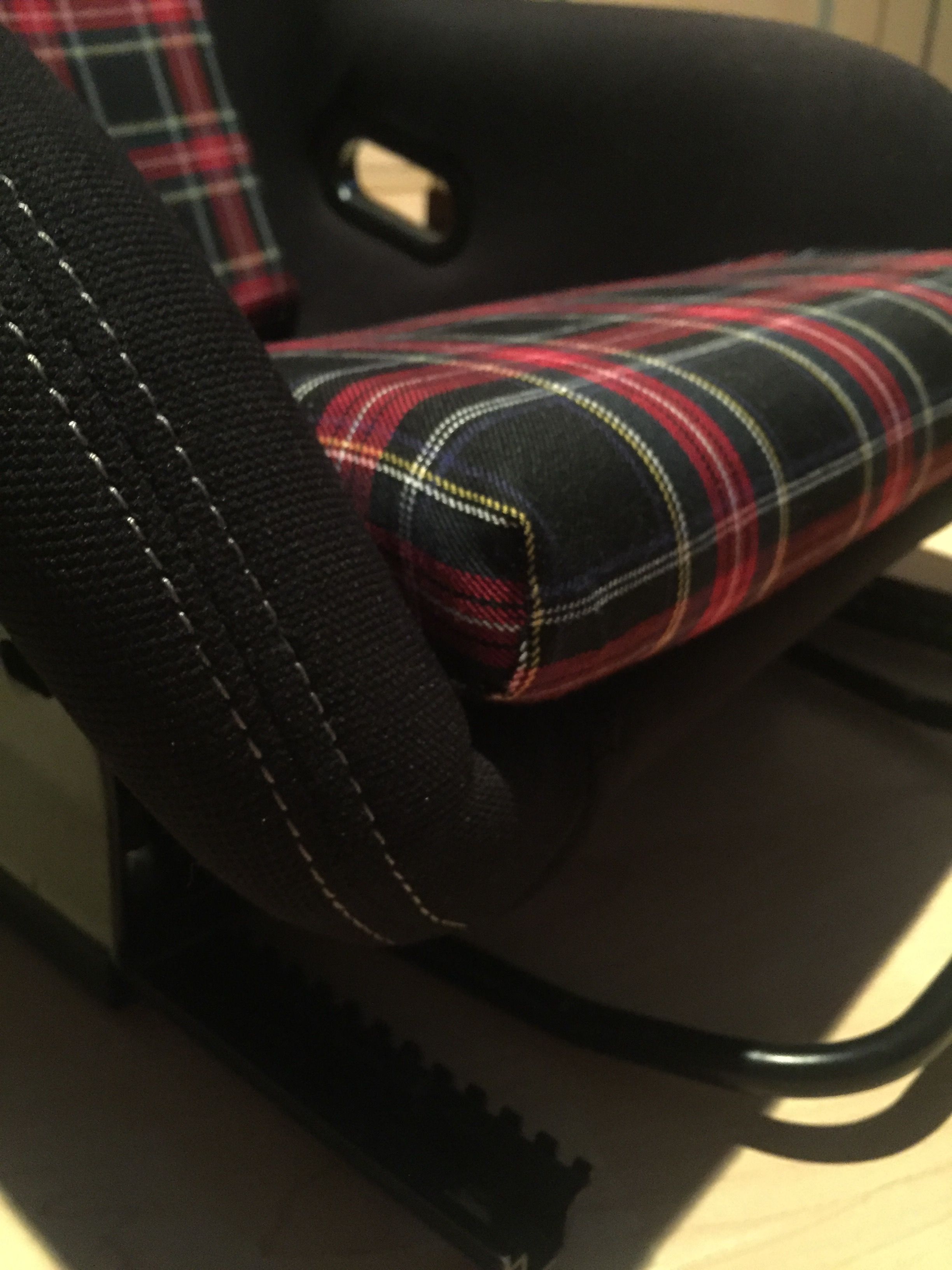

I can’t leave anything alone... So I decided I’d spruce the seats up. I wanted to retrim the centres in GTI tartan but the more I looked at all the VW tartan range I didn’t like any of them.
I started by wrapping some of my check shirts around the fabric to give me some idea.
With my MOMO steering wheel being signed by Jackie Stewart I thought it might be nice to do a little homage to the Stewart Clan, using Black Stewart tartan.
Something different but a nice touch in my hunt for “clubsport” perfection [:D]
Yes, I trimmed them all by hand – took bloody hours. Pricked my fingers more times than I can tell you. Turns out I’m a dab hand with a sewing needle!
Must get that tartan lined up!
Then Sh*t just went too far!
Very very pleased with the outcome! [:D]

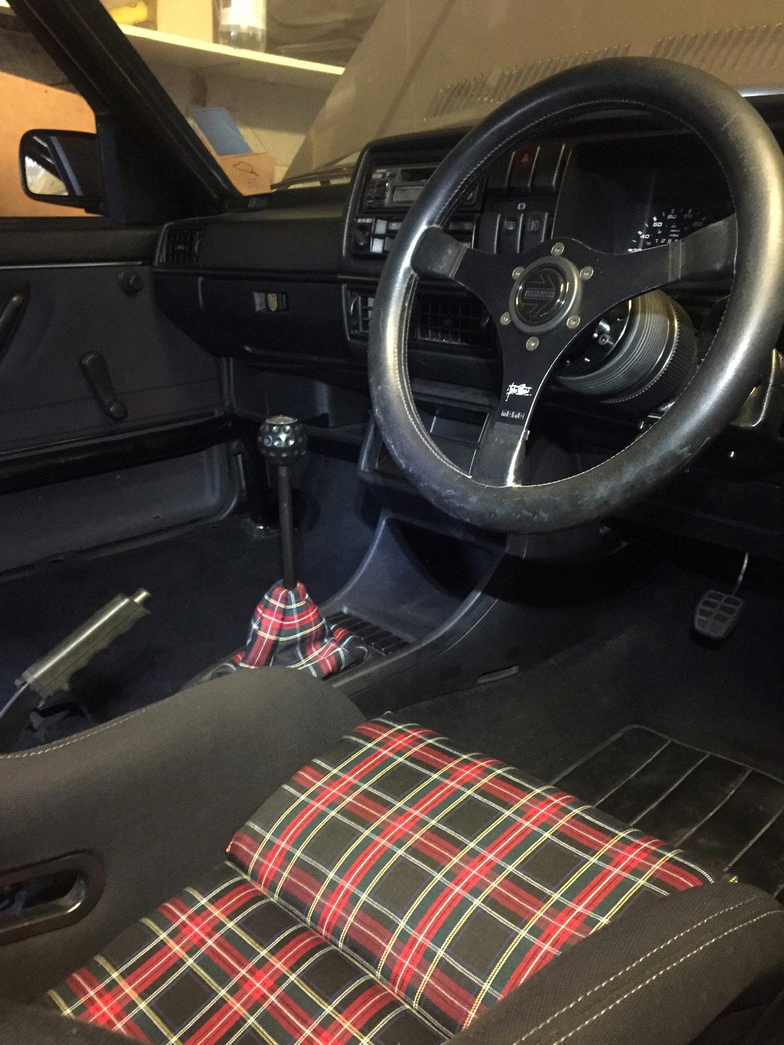

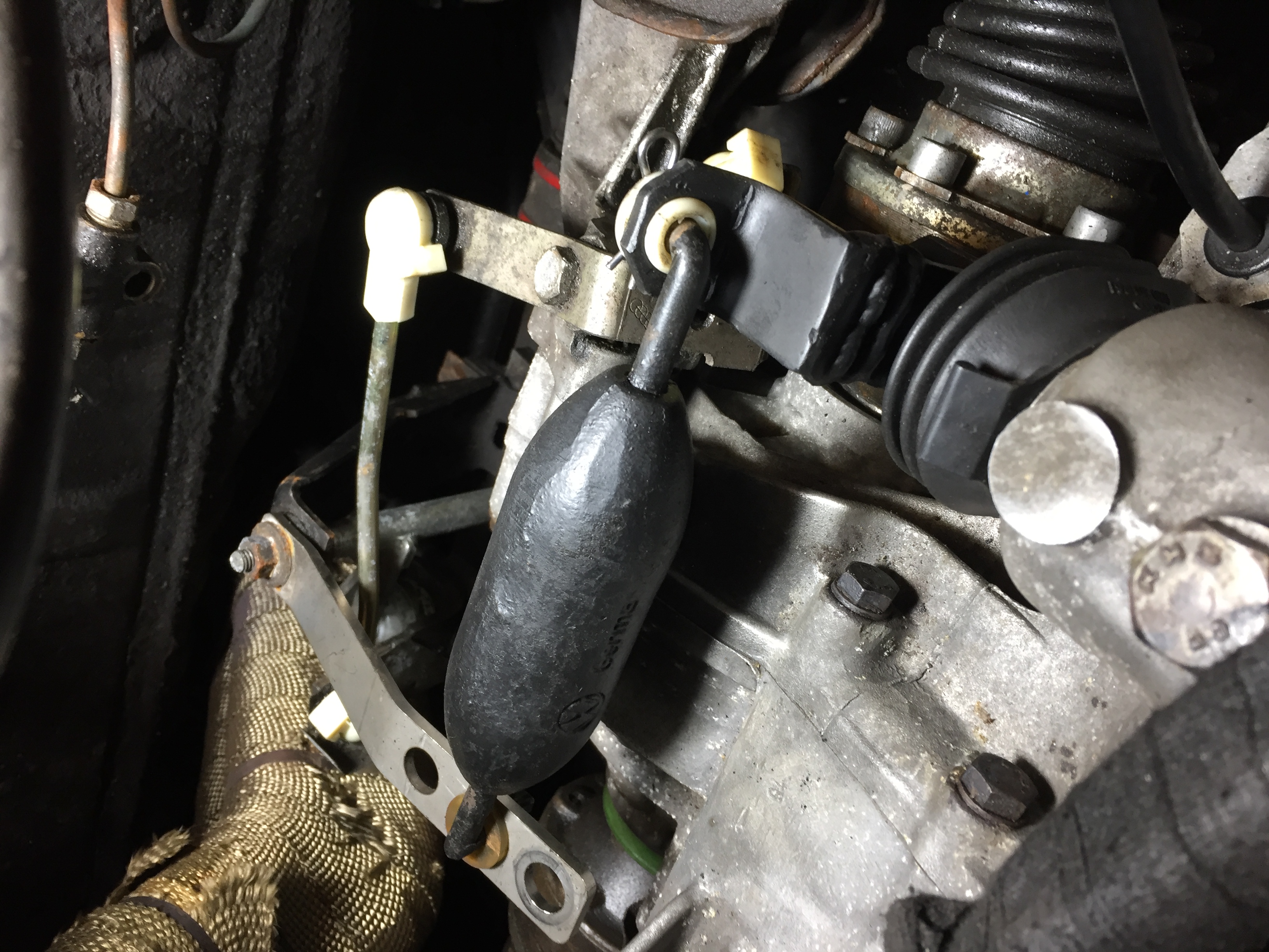

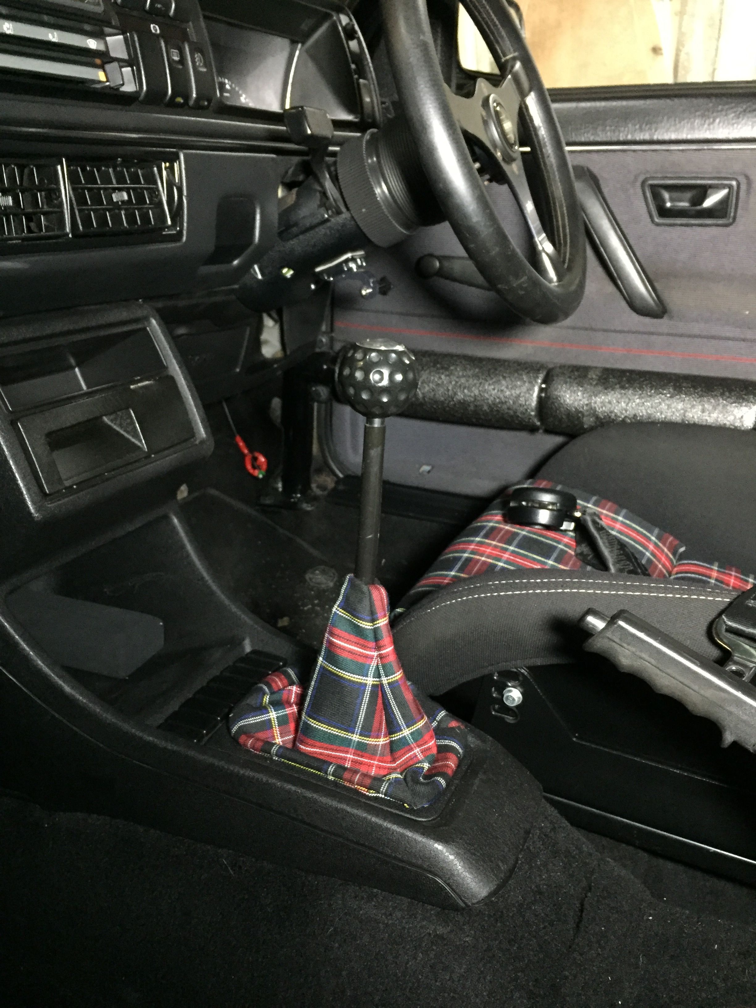

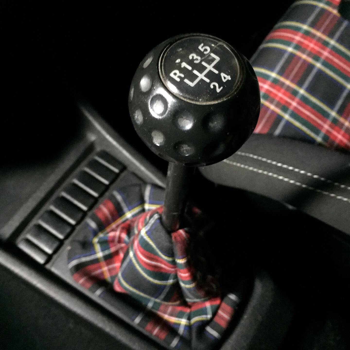

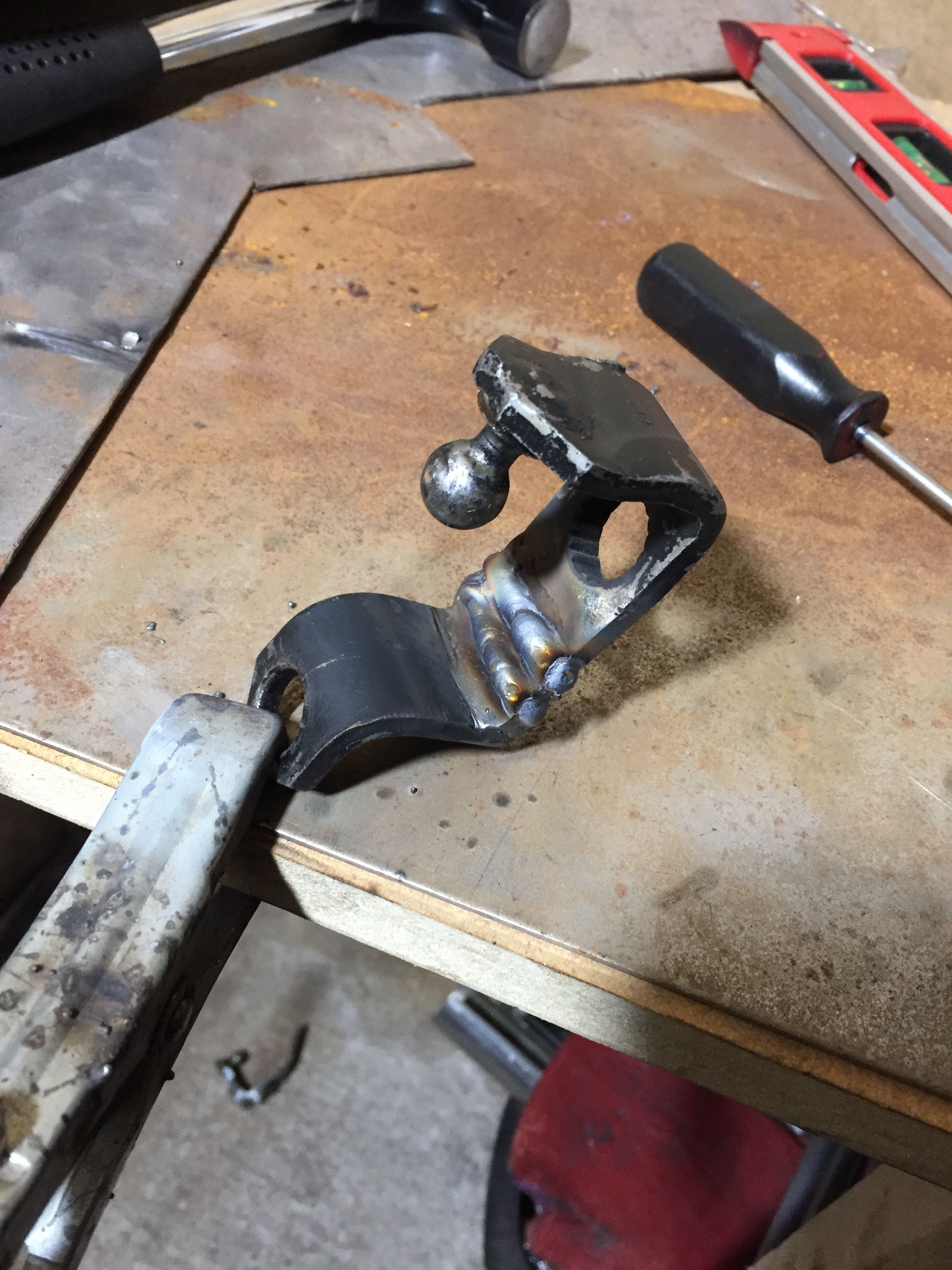

Those beady eyed among you may have also noticed the gearstick…
Yet another of my “great” ideas – as always it was a pain to make but well worth the effort.

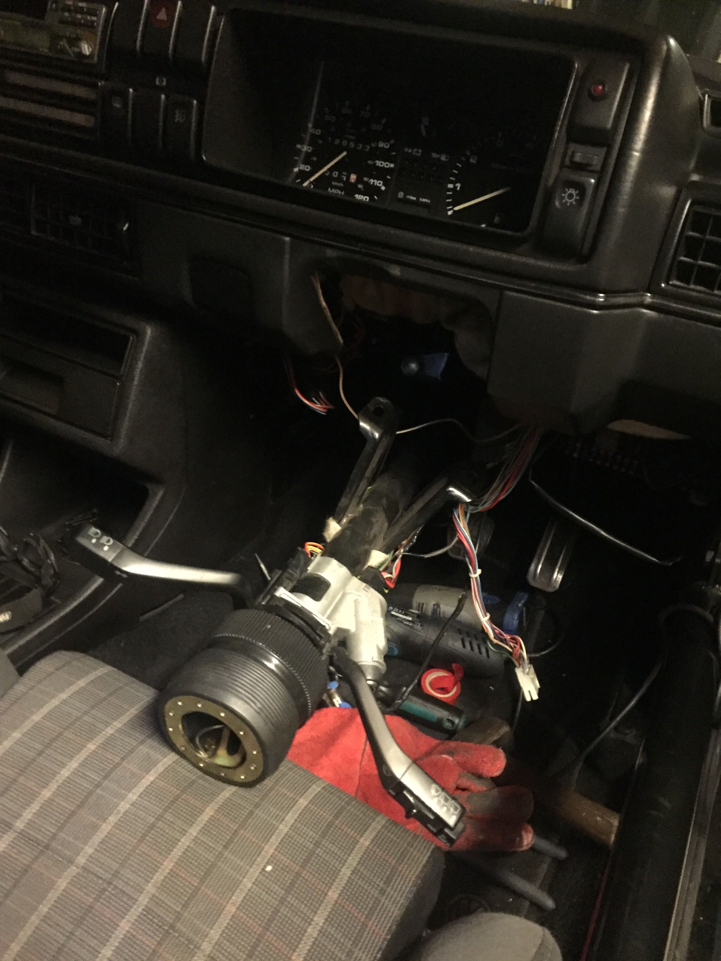

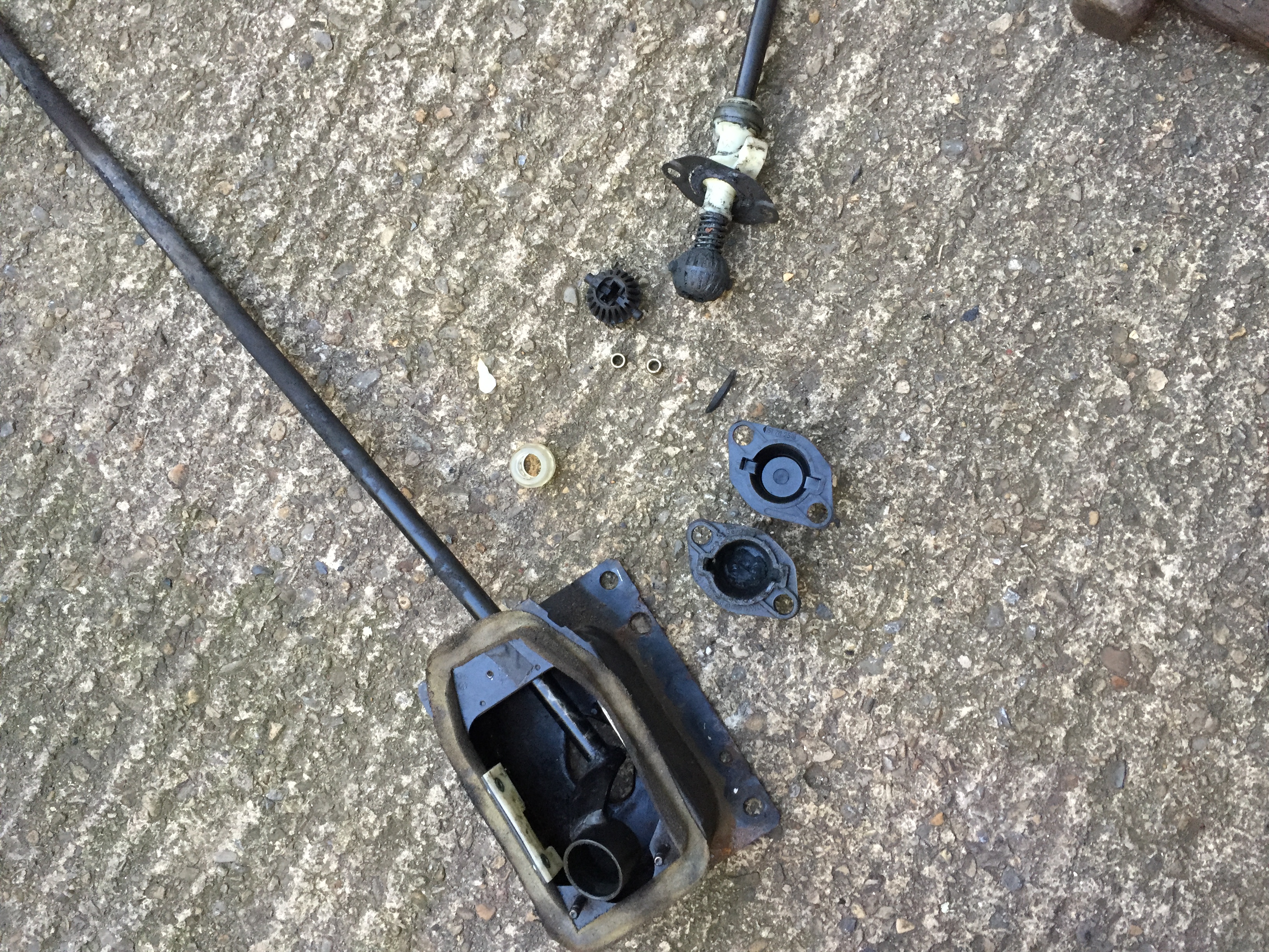

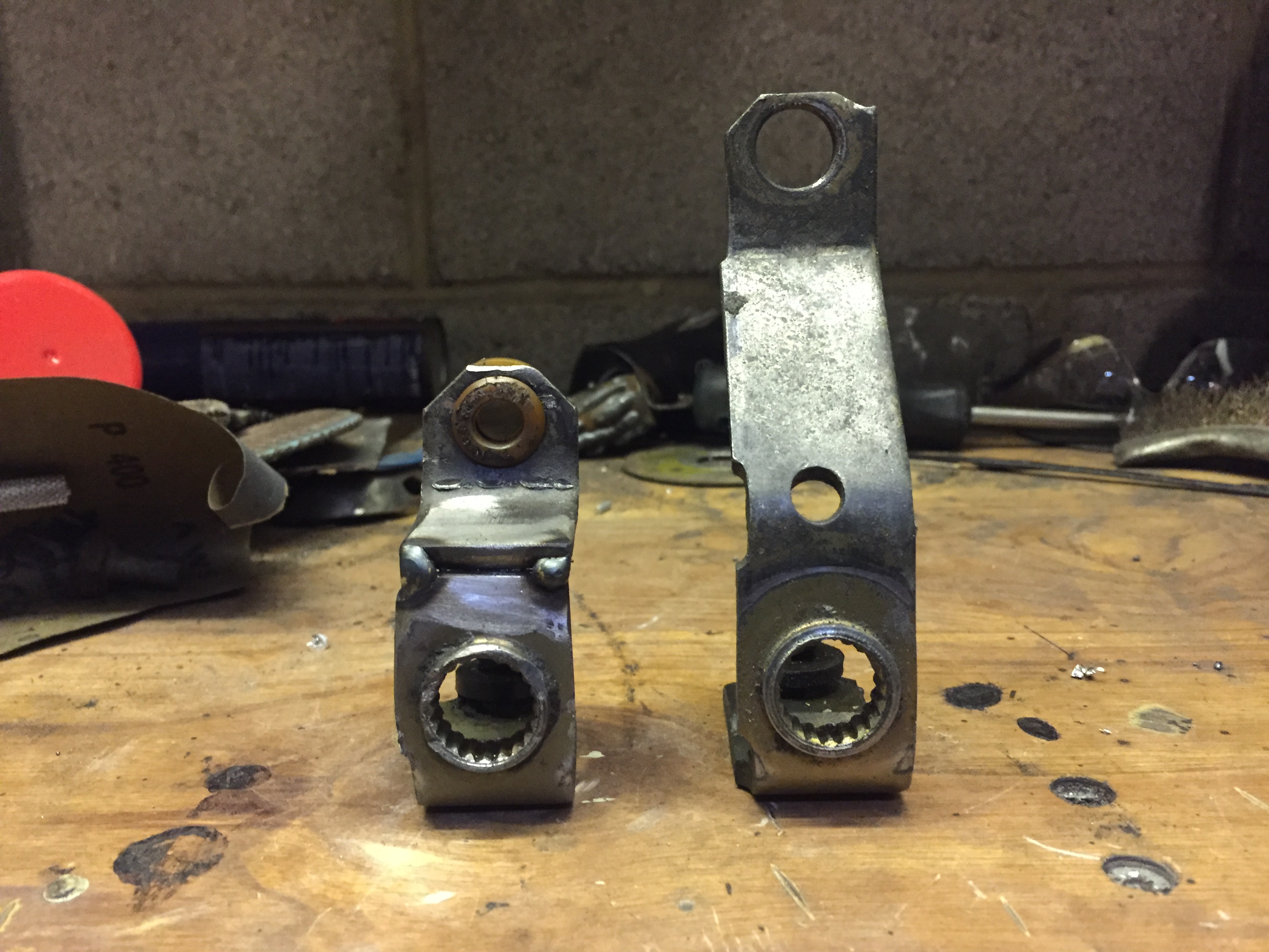

With the seating position sorted I wanted to bring the “shifter” closer to me also. With my 020 box being a rod shift this poses more problems. The main one being that even with my short shifter and the poopr raised up in the cabin the throw was HUGE, felt like a truck.
Back to the drawing board.
I started by rebuilding the shifter box with new bushes to give me half a chance
I then focused my attention on the selector shaft, I’d only ever heard of this being able to be done but hadn’t physically seen it done. I had a spare shaft so used that to chop up.
This had enabled me to raise the shifter inside the cabin by quite a lot and keep the short throw on the lever. It’s no CAE shifter and it might not do my synchro’s any good, but only time will tell!
Re: Cope's GTI
With the seats and harnesses sorted :)

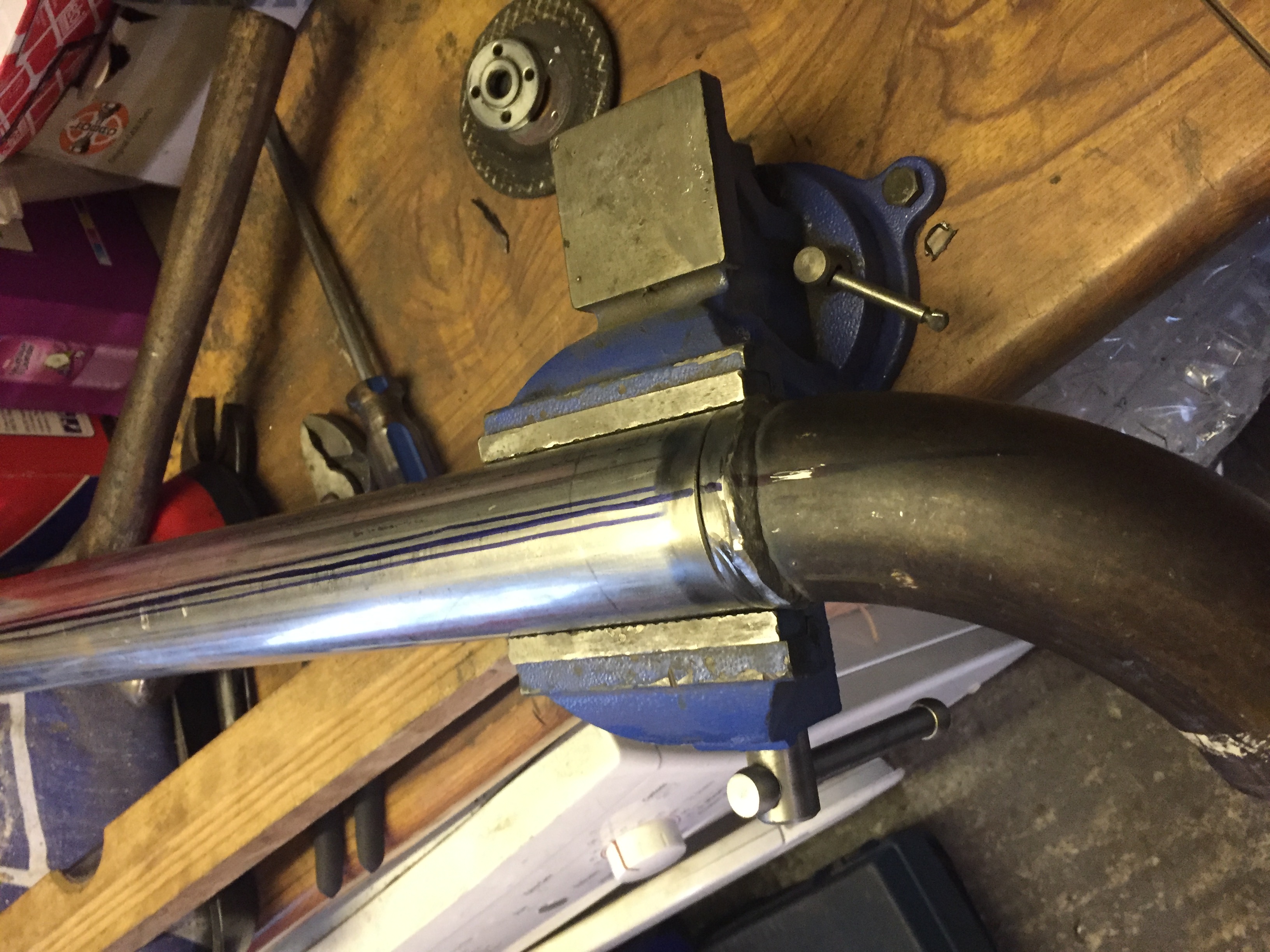

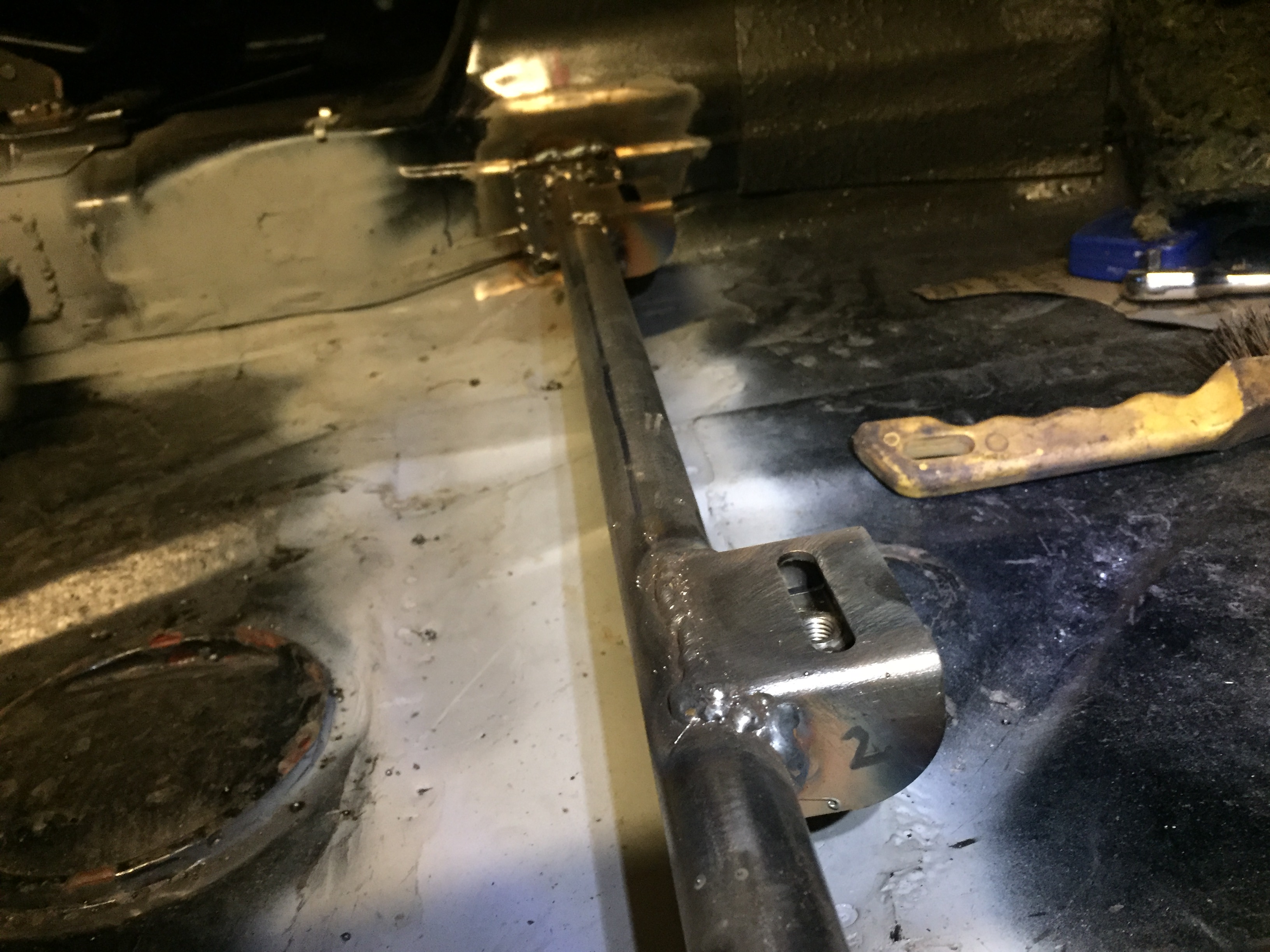

Next up on the list was the exhaust. For years I’ve had the same issue with exhausts, in that they never sit or hang right even with new hangers. Plus I could never stop the rubbers melting and/or falling off.
So, I decided to cut all the brackets and hangers off the car and off the exhaust and start again with a new more modern design.
I started by getting the exhaust where I wanted it on some industry spec materials. A washing basket, drill box, coolant container and some wood….
I then started to mock the new hangers up using some stainless rod. (I’ve already replaced the silicon hanger for a stock rubber part, with the same dimensions)
I designed them so all the hangers on the exhaust and the car face away from each other, meaning the rubbers should never fall off…
Substantial… ;)
With the exhaust in place, sat up nicely in the tunnel and plenty of clearance over the rear beam, the backbox would tilt upwards and cause the back end of the box to hit the floor pan.
I made a few cuts and slight tweaks before welding it back up

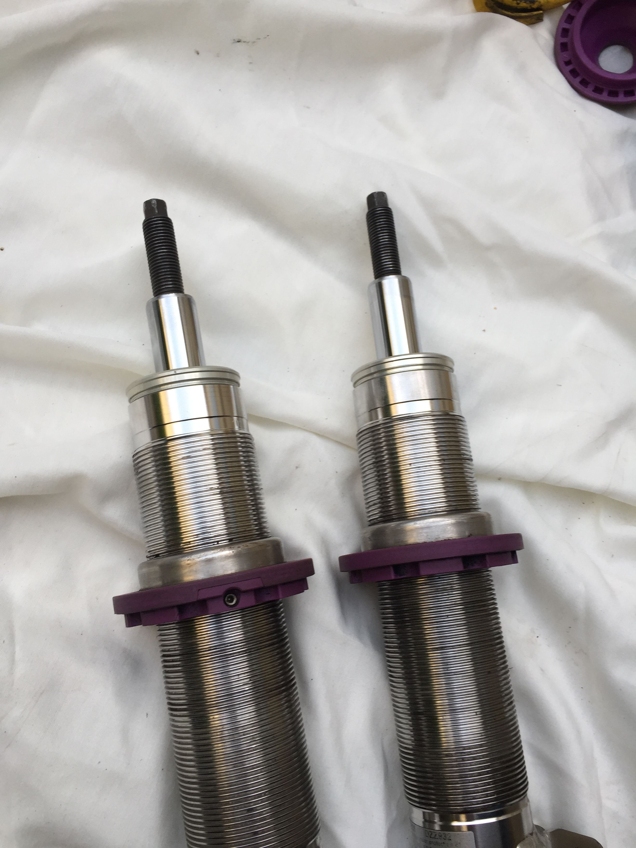

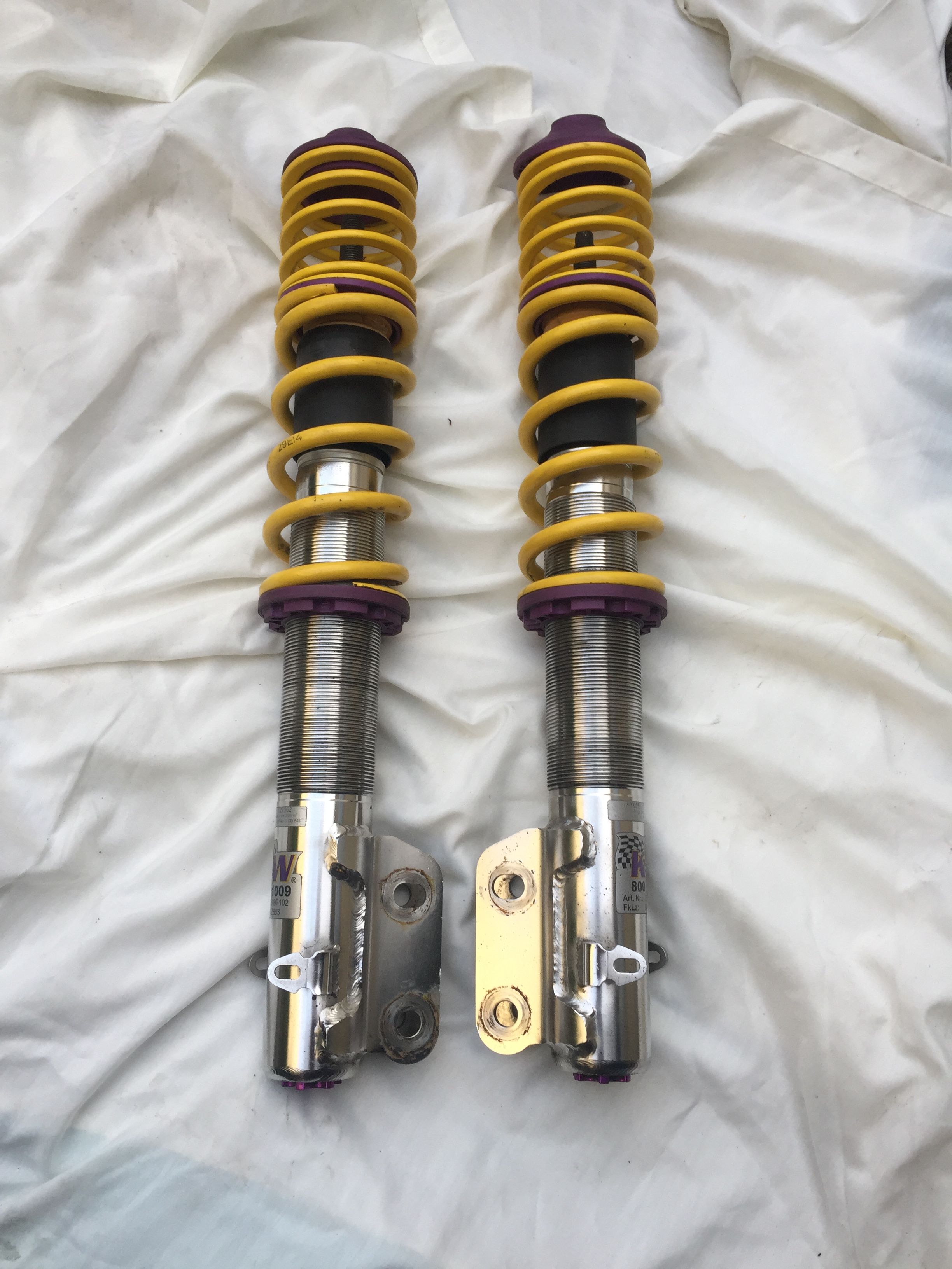

I’d noticed the last few time I’d driven the car some oily residue on the passenger side front wheel. I took the coilovers off to make sure they were okay. I’ve had waterproof coilover socks on them since new, so its nice they still look that way! Best £20 I’ve spent
Although they looked fine I noticed the dampers weren’t keen to expand back to normal, so I sent them back off to KW to see if they could dyno test them for hairline cracks.
They came back and said there was a slight imbalance, so they gave them a refresh but they had tested them and didn’t find any leaks. So something to keep an eye on!

This was the first time driving anything with a proper fixed bucket seat and harness. One that has been totally tailored to me in every respect – From the seat position, to the seat height, to the steering column height, to the steering wheel spacing and the gear stick position.
After all the hard graft and countless hours overthinking every detail, I have to say it’s been well worth it.
On the road the car felt fantastic. No more play in the seats, no more having to keep yourself in the seat by gripping the wheel tightly and pushing your thighs into the seat bolsters – Just totally solid and confidence inspiring.
Perfect!

The only thing I wasn’t happy with was the short shifter I made still wasn’t quiet there, 2nd was really hard to find, which proved a pain on track. But that was a job for when I got home.

The 2nd gear issue at Curborough was rectified with modifying the input shaft again. Many iterations, finally landed with the most ideal solution.
The shifts now feels silky! 

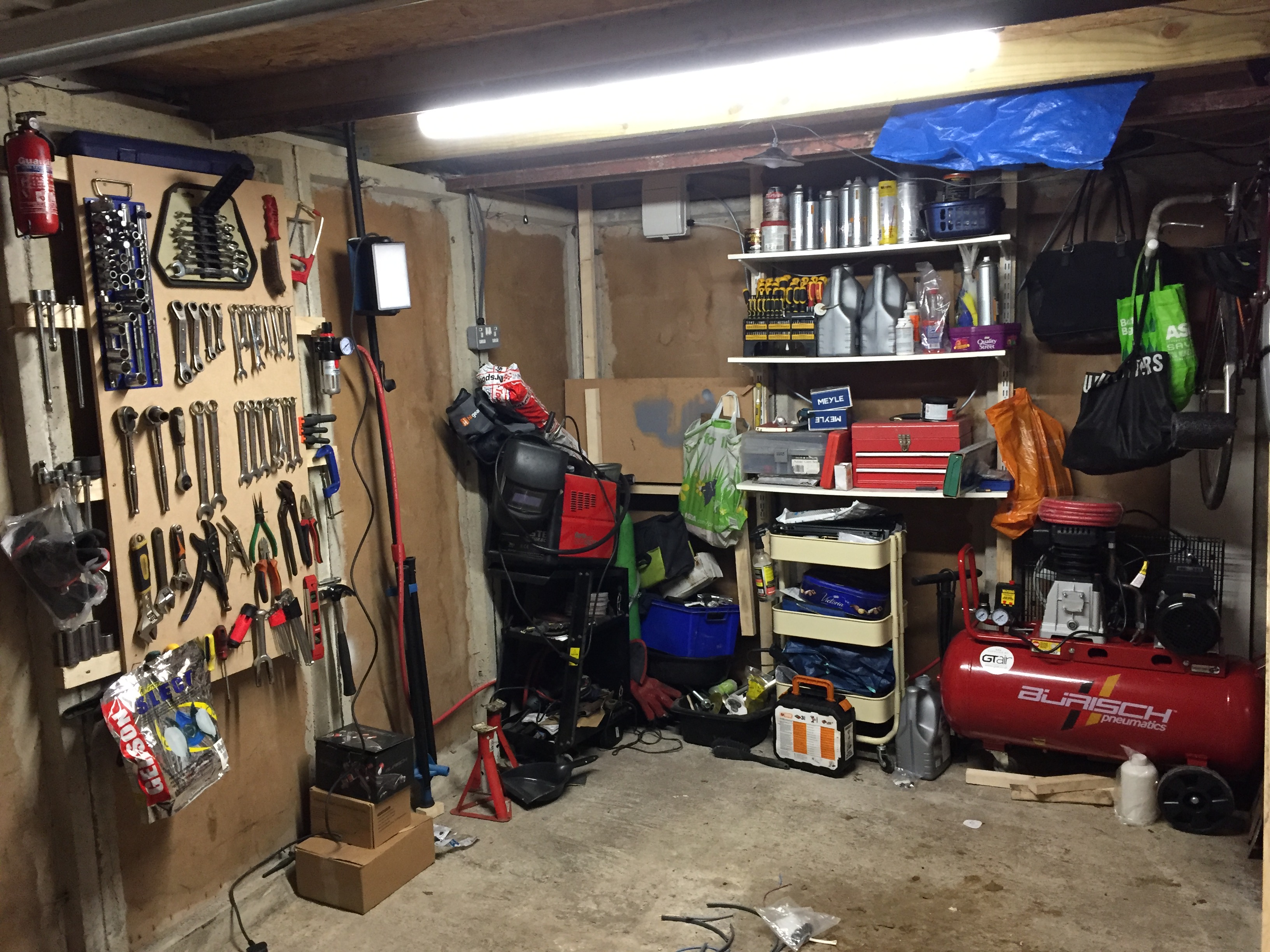

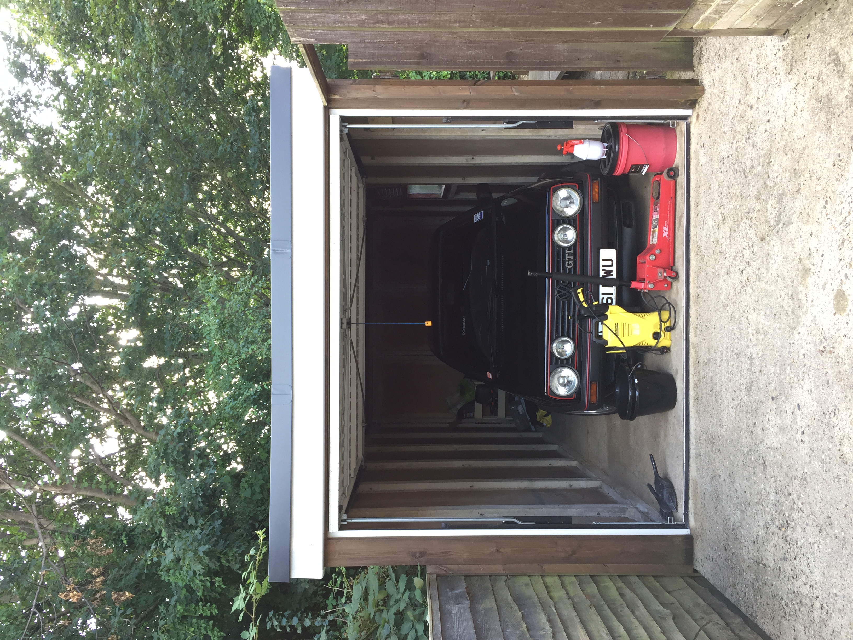

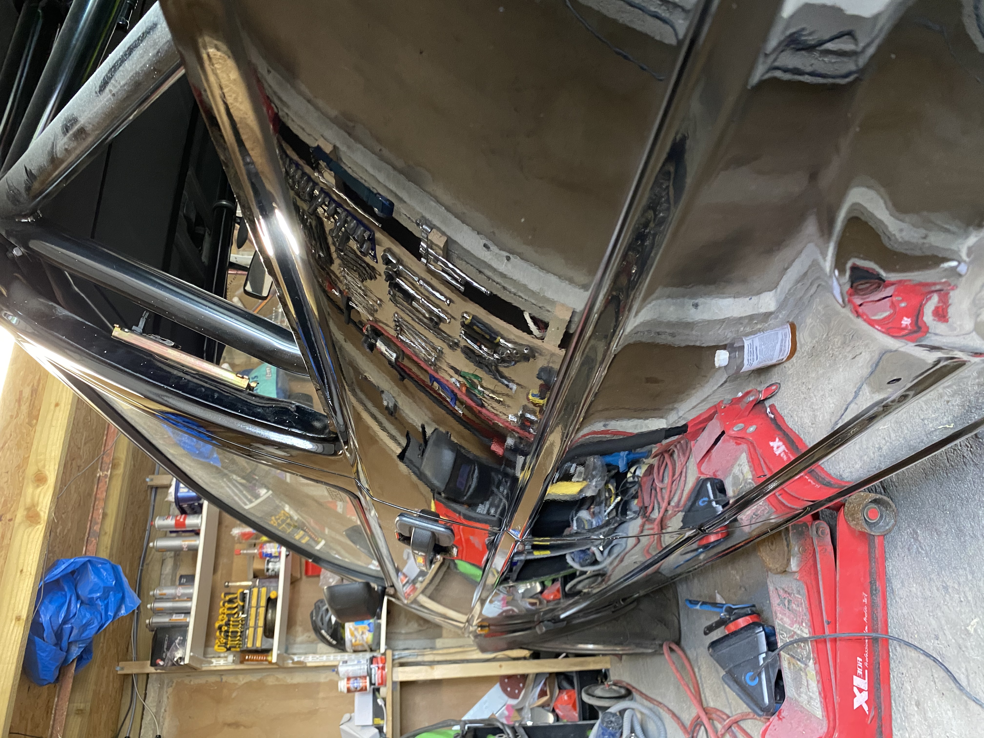

In the process of all this I’ve moved into a little house, has a decent driveway although its tight and a little garage which is really tight! But its somewhere dry which I really appreciate!
Finally got all my tools organised which feels great and my mate put some leccy in the garage which is a huge improvement!!
You might notice my nice shiny compressor sat at the back, that’s new! I’ve decided I’m going to give this painting lark a proper go. Cans have been fine for me for years but the finish soon dulls and it always needs redoing every year or so…
I’ve bitten the bullet with the Birsch 90l Belt driven compressor. They do a spray kit on ebay with all the lines, water trap, GT Air gun etc for a reasonable price.

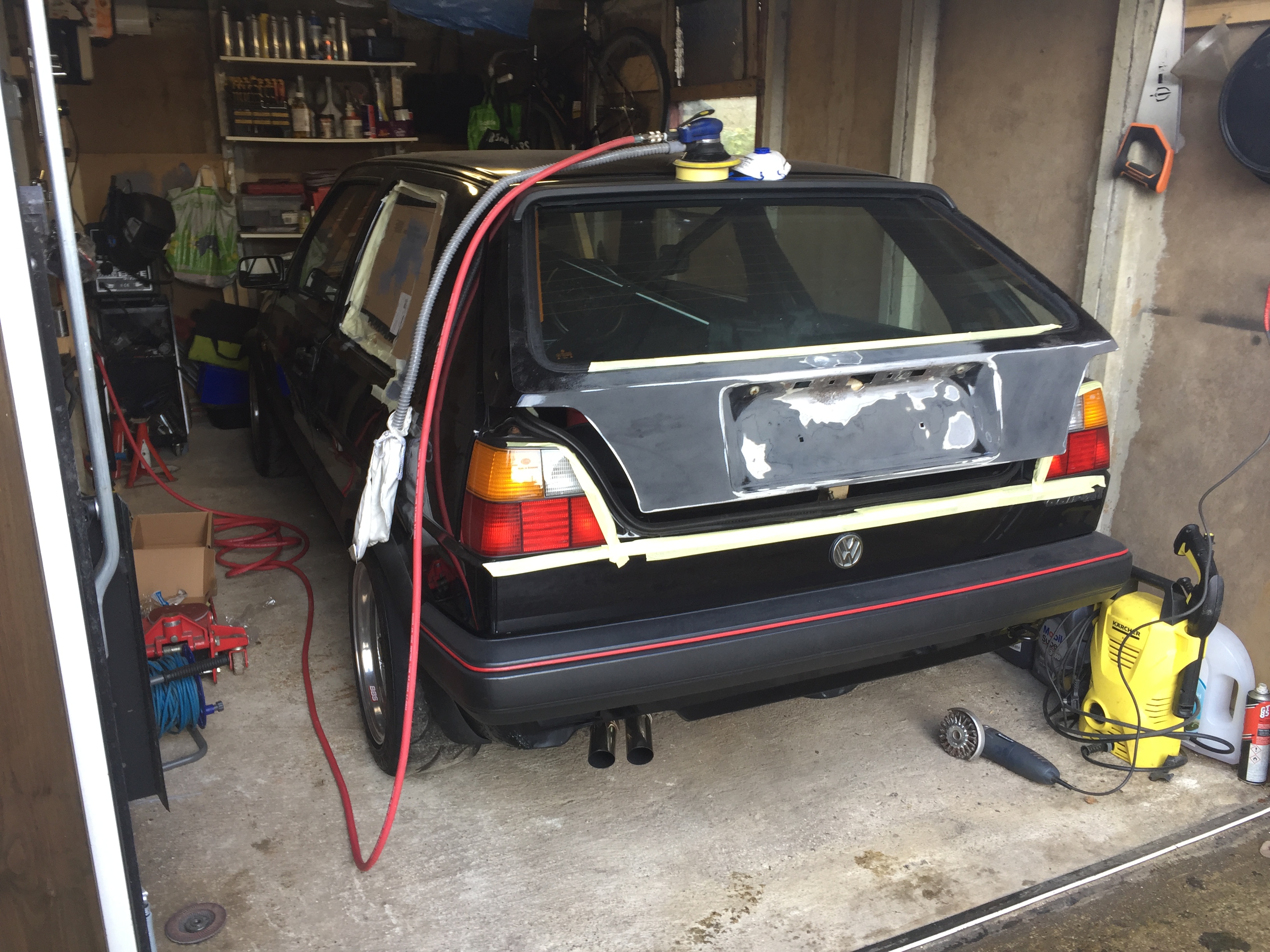

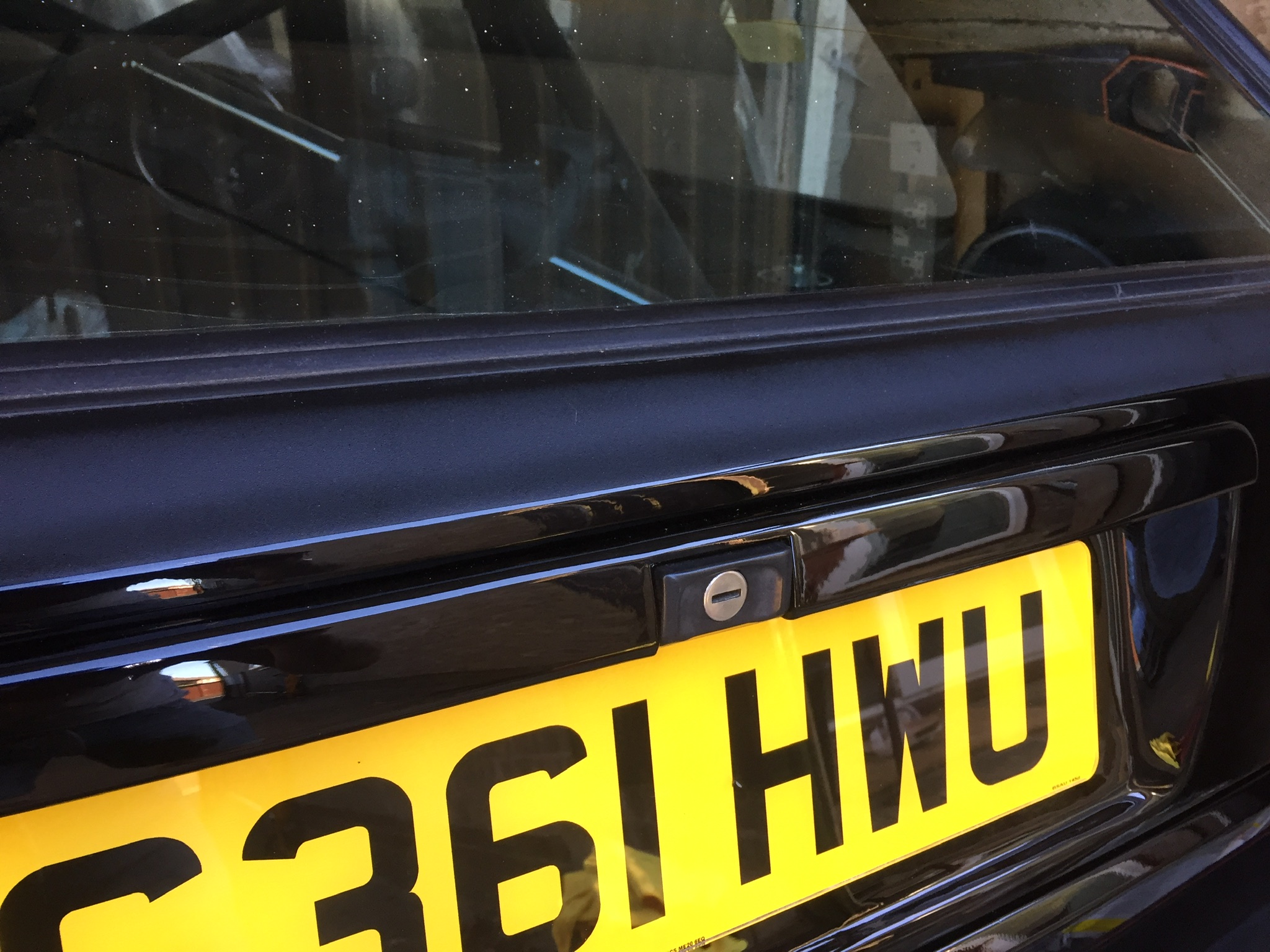

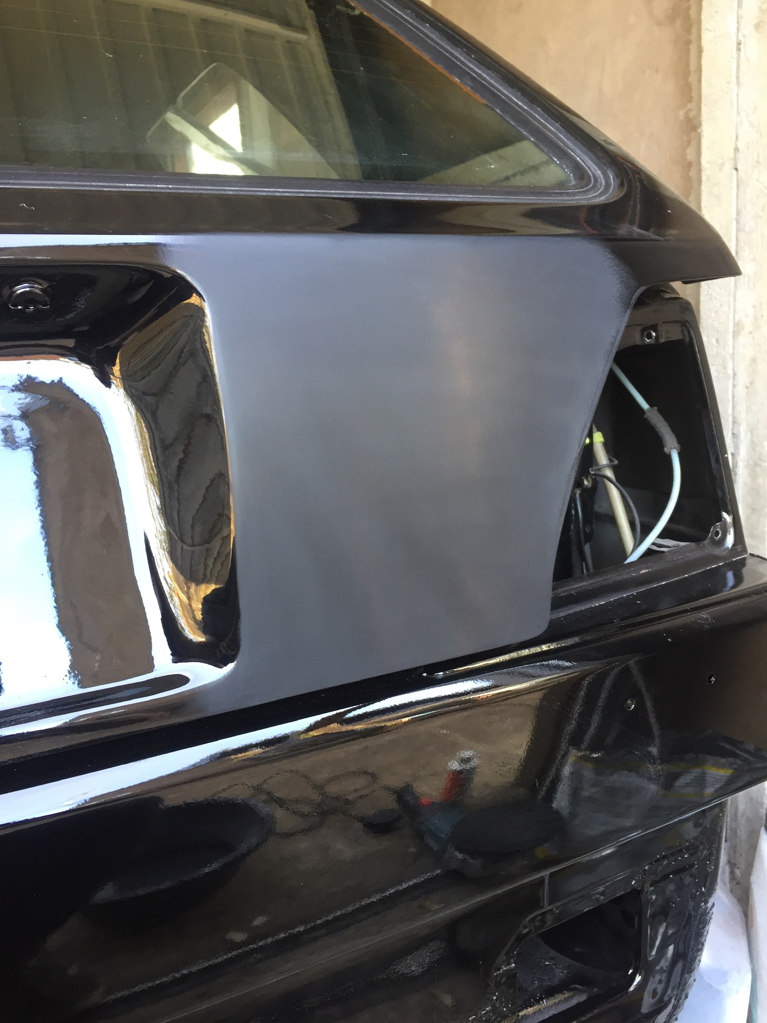

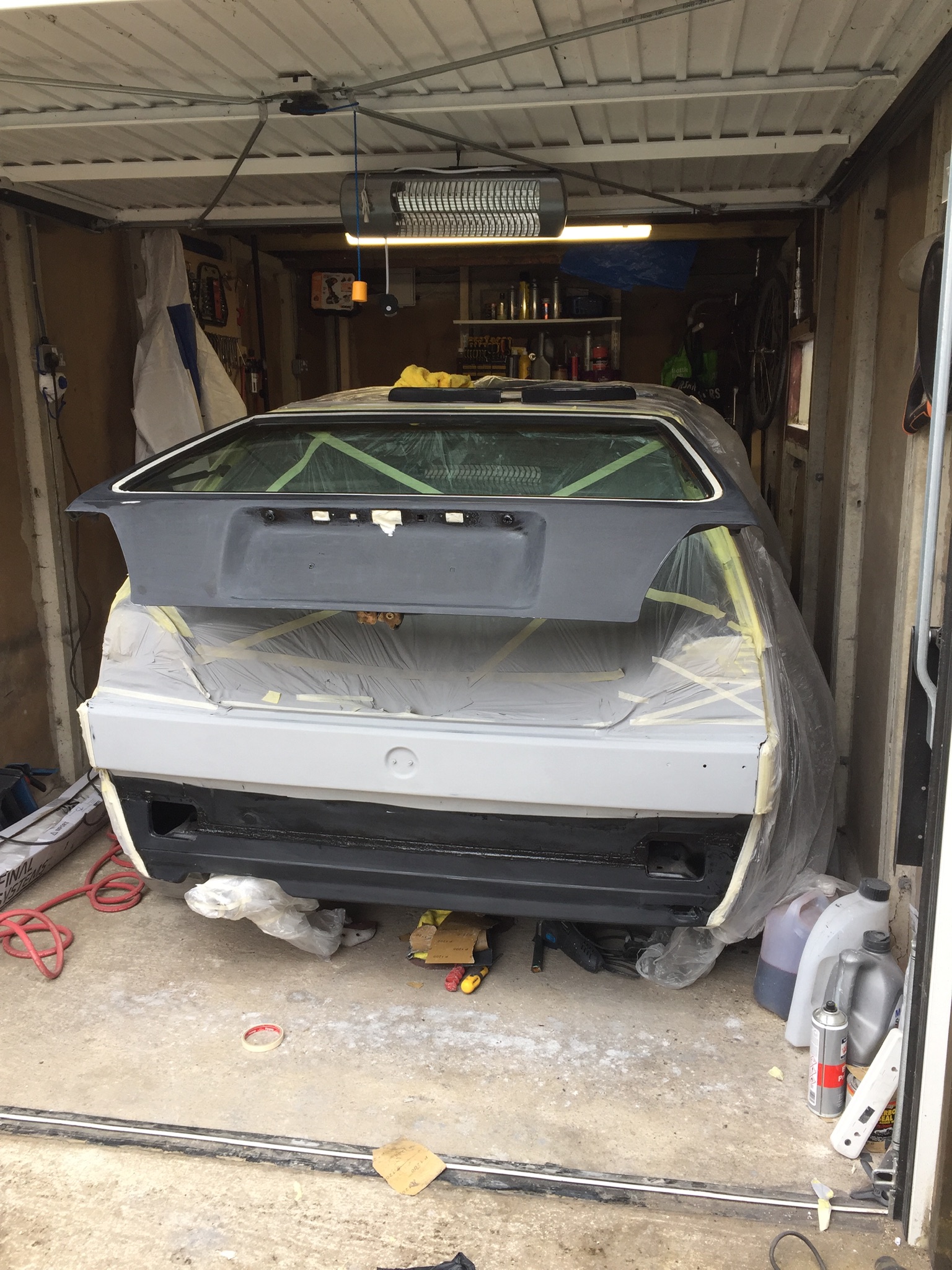

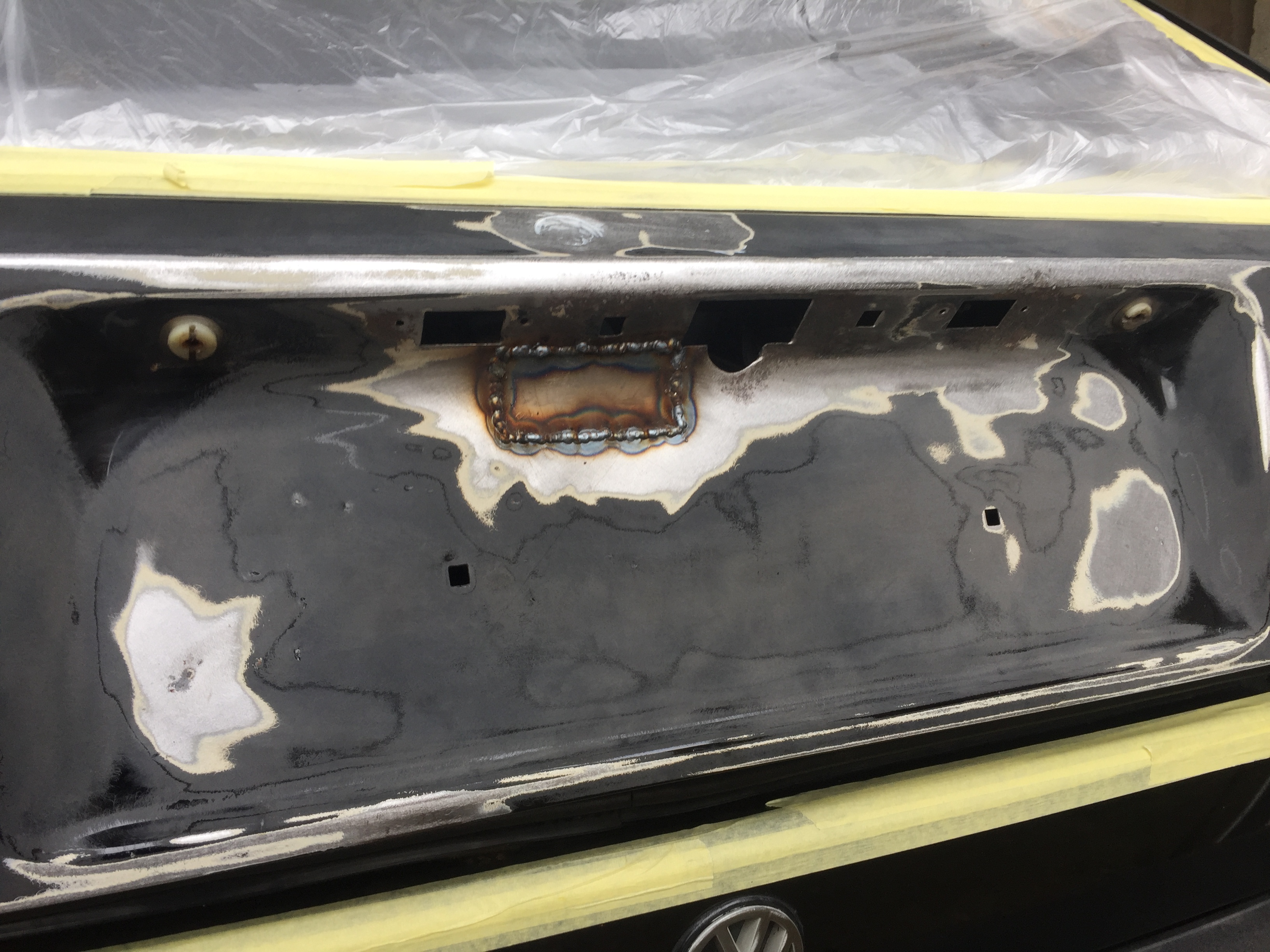

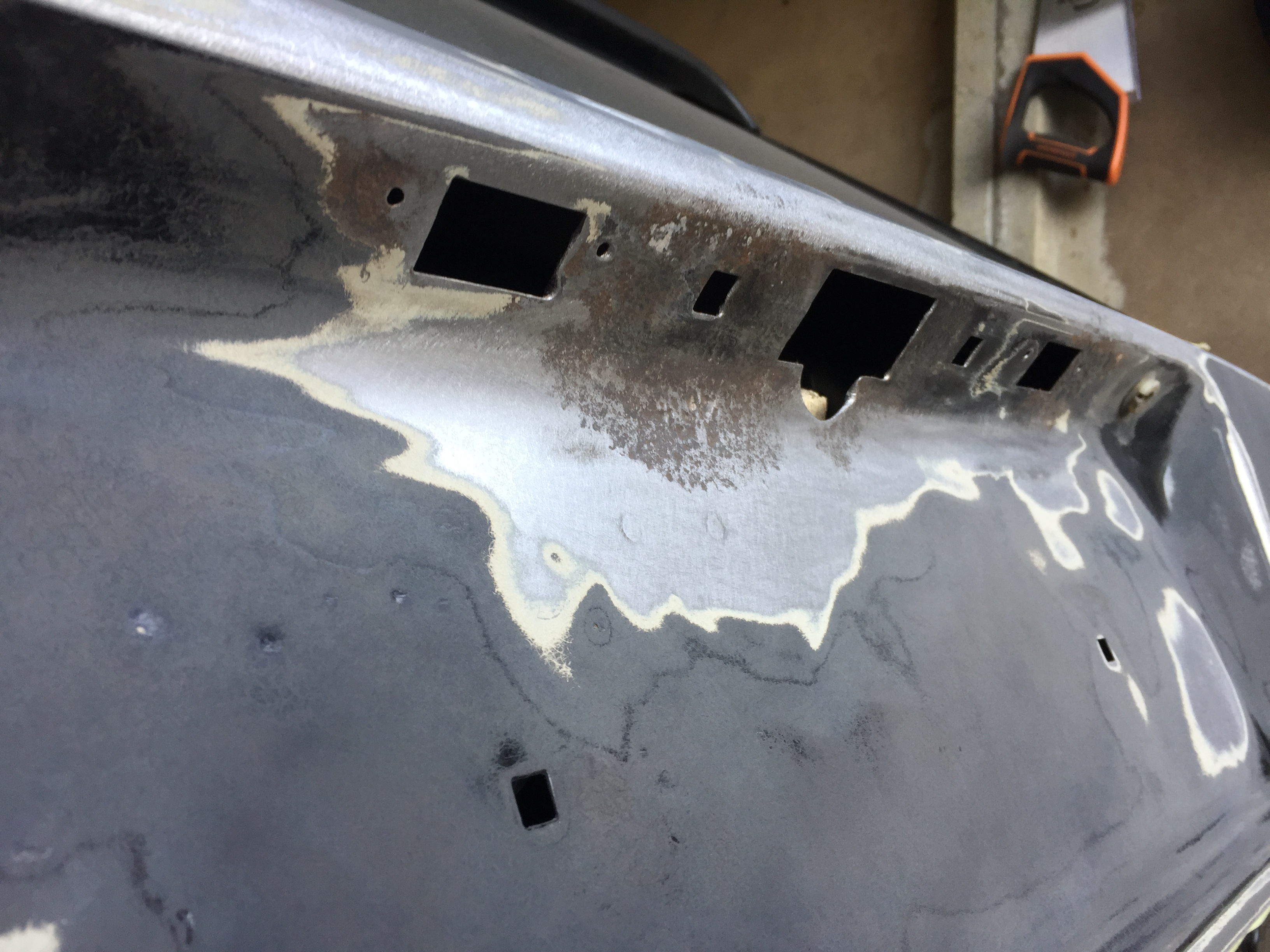

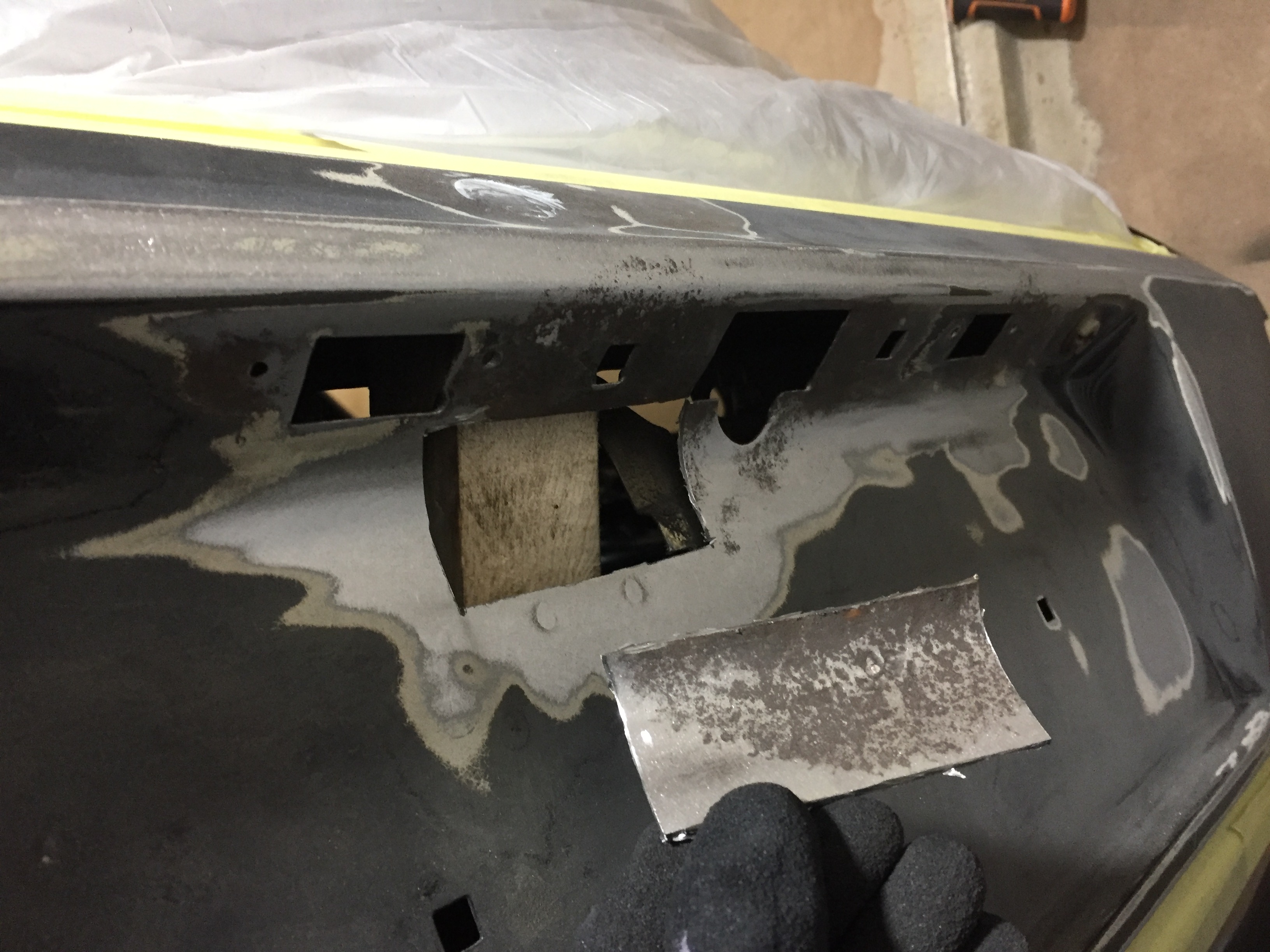

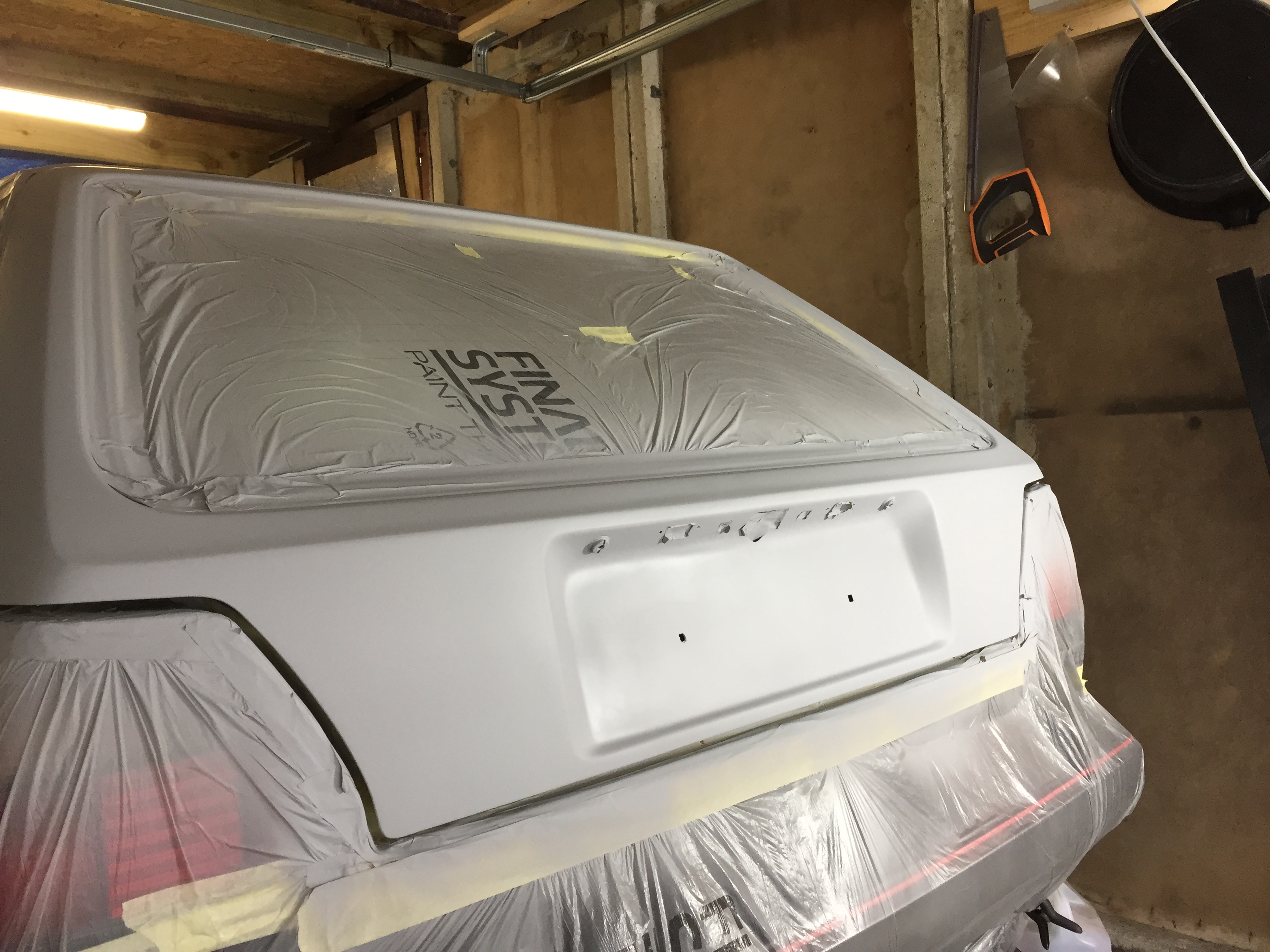

I decided to start with the tailgate, some rust was starting to come through under the boot lock and I wanted rid of the rear wiper, for 2 reasons: 1. I never use it and 2. The wiper sits at a different angle to the X in the cage, which bugs me. I also have a pretty strong hatred for de-wipered cars with rubber bungs, if I was going to do this it had to be properly.
I’d sourced the black vinyl boot trim without the wiper/washer holes, so I set about welding up the holes.

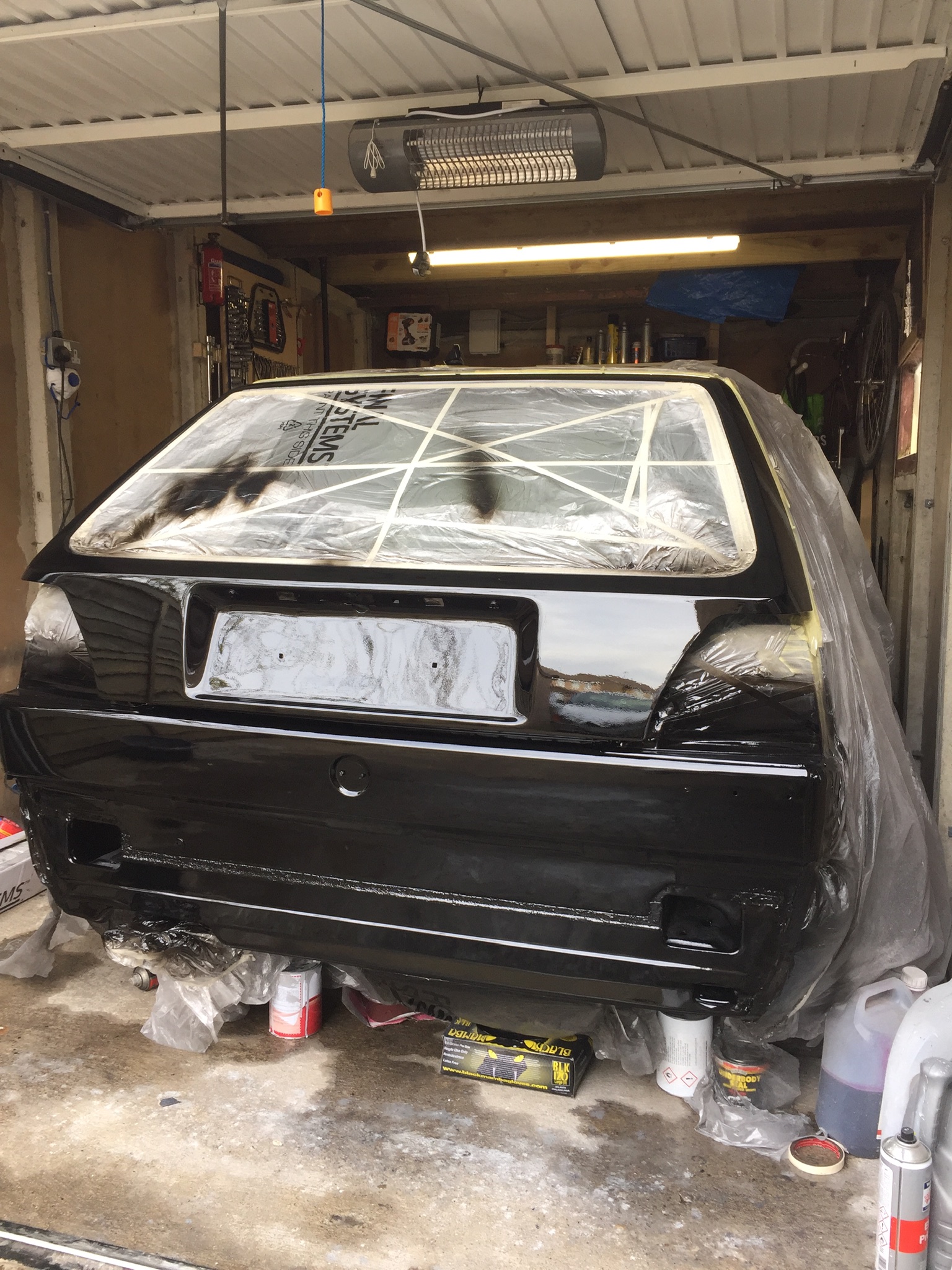

Made myself a spray booth…
Got fist coat of primer on
At this stage you are probably thinking… no way, don’t paint in there, the space, the dust, the bugs etc etc… and you would be completely right. But whats the worst that could happen!?

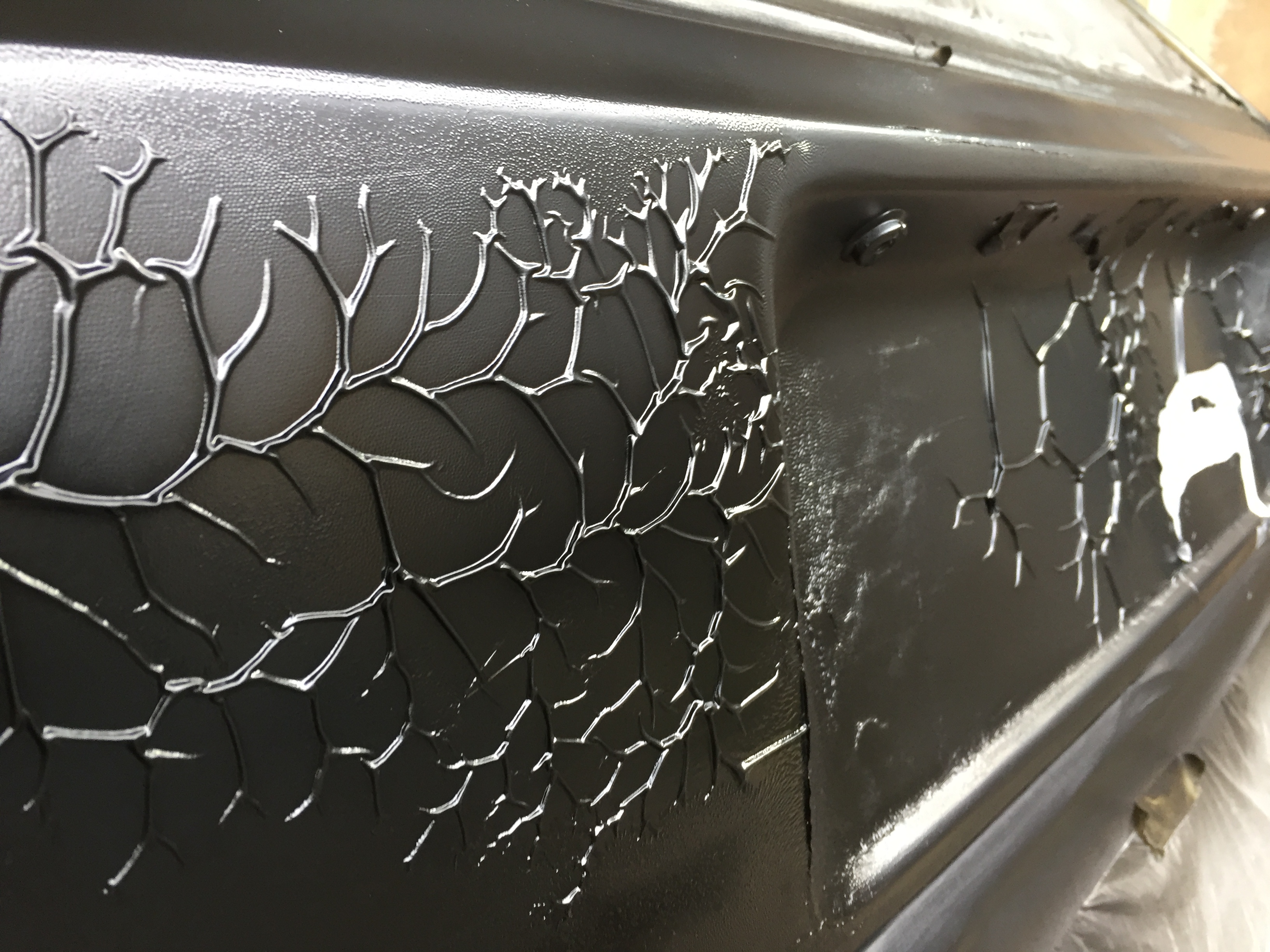

Yep the worst happened…
You’ve got to laugh.. or cry. Now what I’ve learnt here is I’ve banged on too much base too quickly so the solvents couldn’t escape. I’ve been watching a guy on Youtube called the Gunman, he’s from Australia and paints in a booth set to 35 degrees… ahhh that’s where I went wrong!
So back to the drawing board. 2 days later I had the boot lid sanded back to where I first started, at that point you’d think I’d just get it painted and be done with it, right? Wrong… I decided I may as well give the full rear end a refresh. In for a penny in for a pound!
This time I went easy on the base coat. The clear went on really nice, it’s the most exciting and stressful point of painting, if anything goes wrong at this stage, its back to the drawing board.

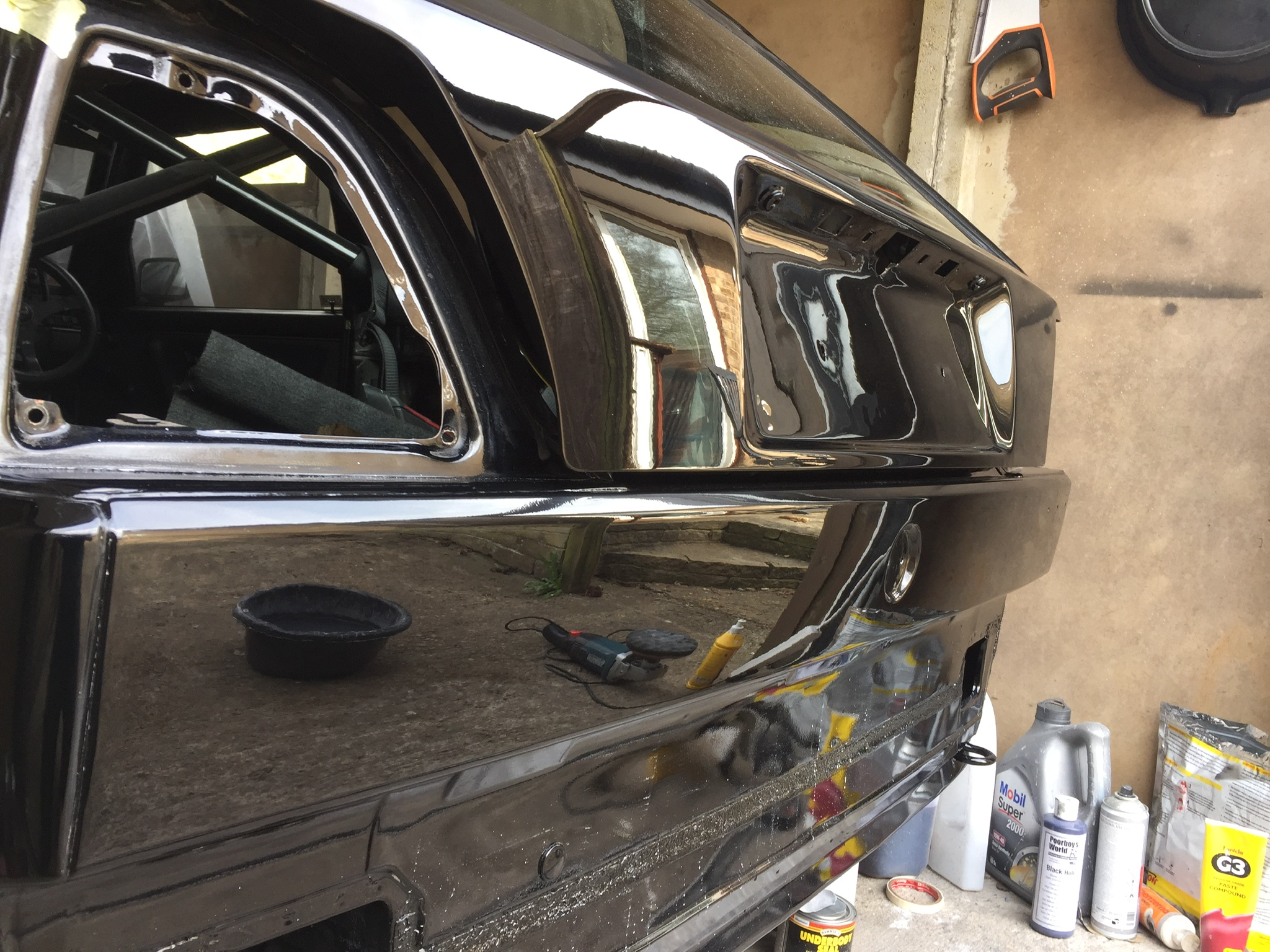

This is out of the gun, ready for wet flatting
Wet flatted with 3M 3000 Trizact disc by hand, then used G3 compound and 2 different Menzerna finishing polishes.
I have to say I’ve surprised myself with the outcome! The only unavoidable thing was dust settling in the clear coat, it wasn’t a huge issue because you can wet sand them out but its more hassle and you end up with less clearcoat!
Got the vinyl trim on, very happy with the factory look of this!
With the rear of the paint done, attention shifted to finding a passenger seat, trimming it and welding in the seat frame for that side.
More to follow [:D]

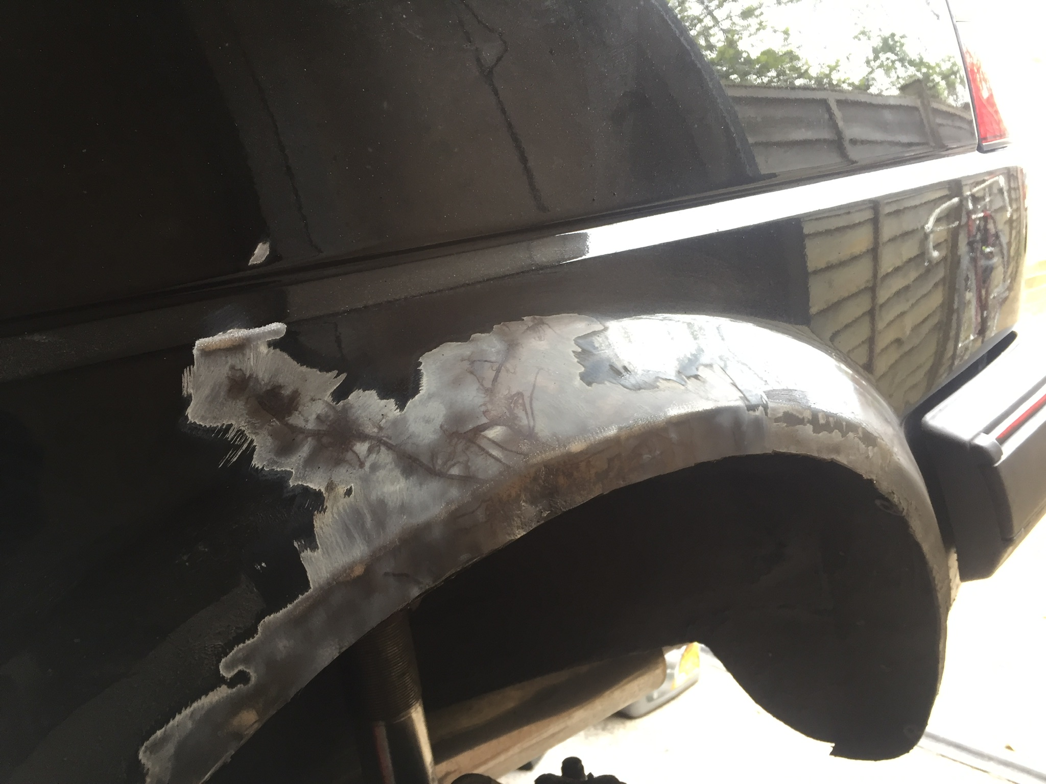

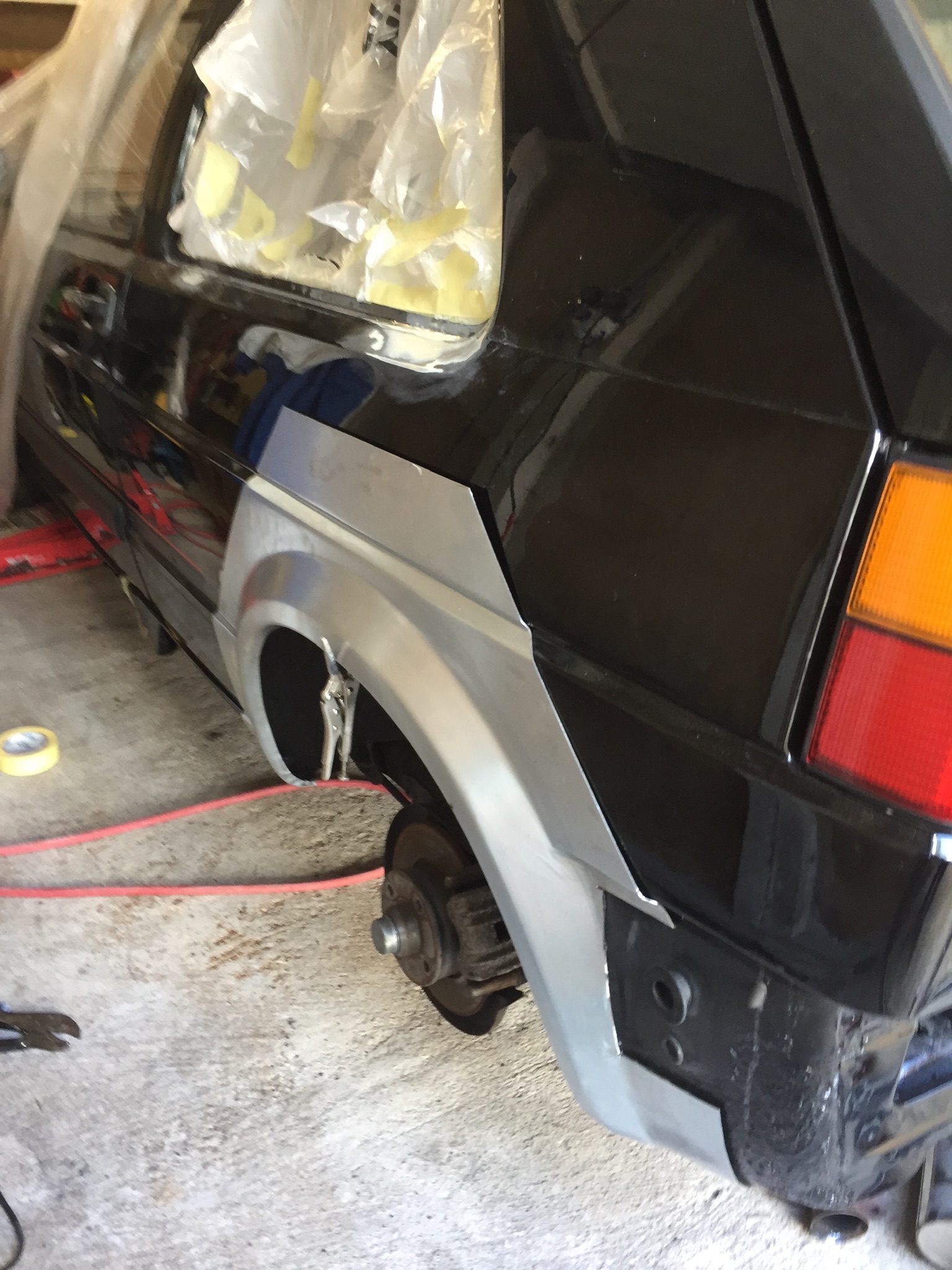

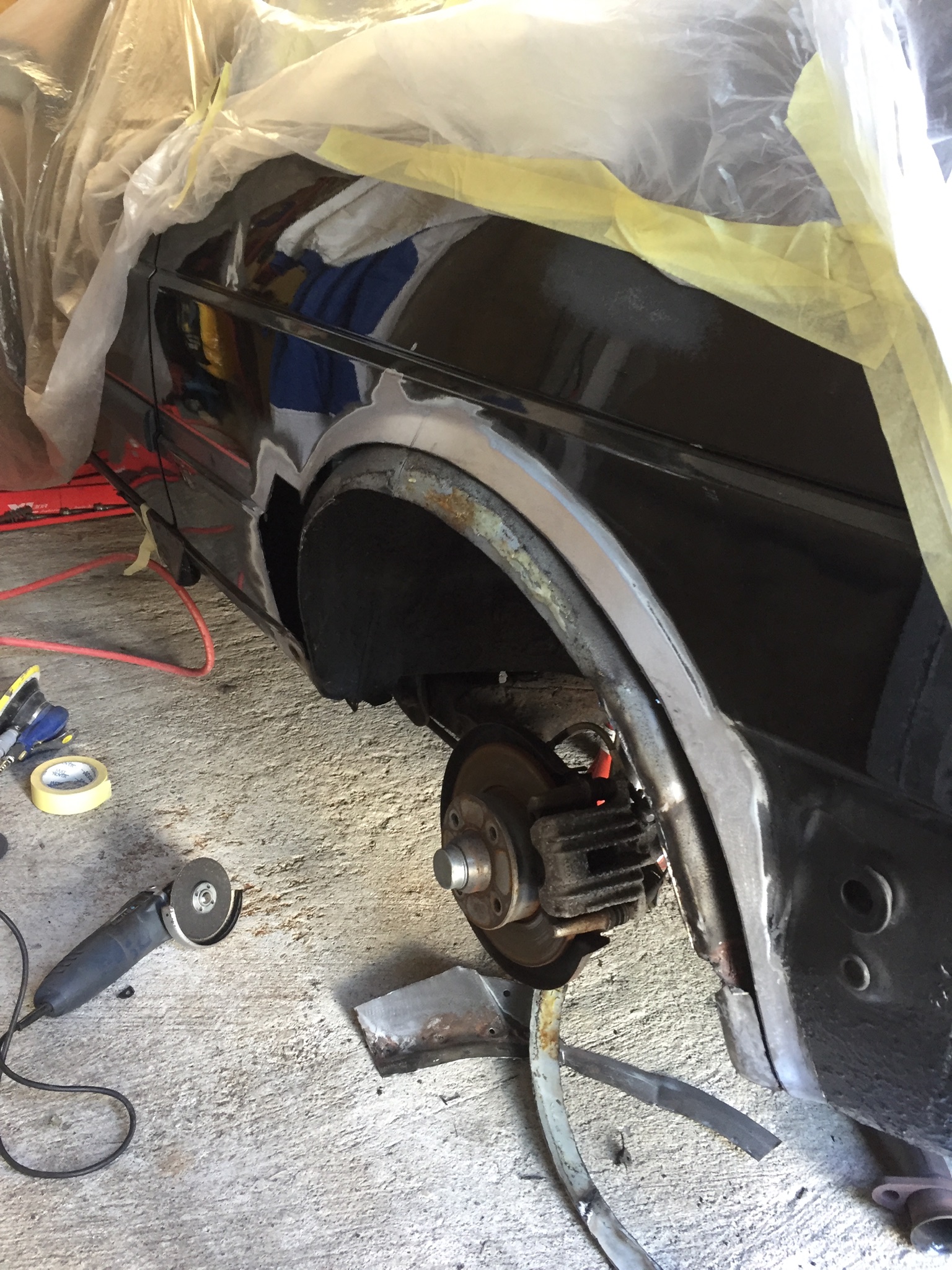

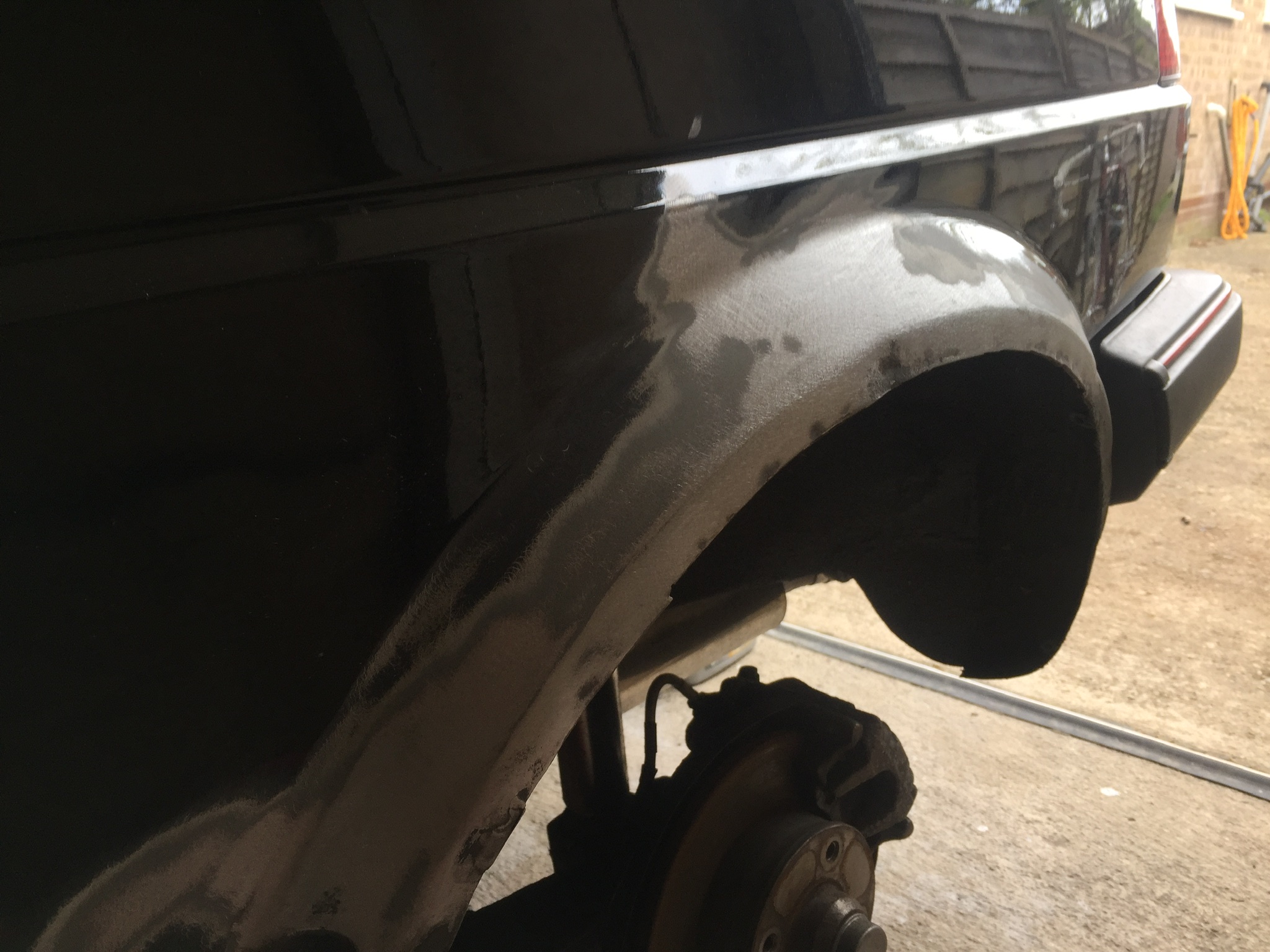

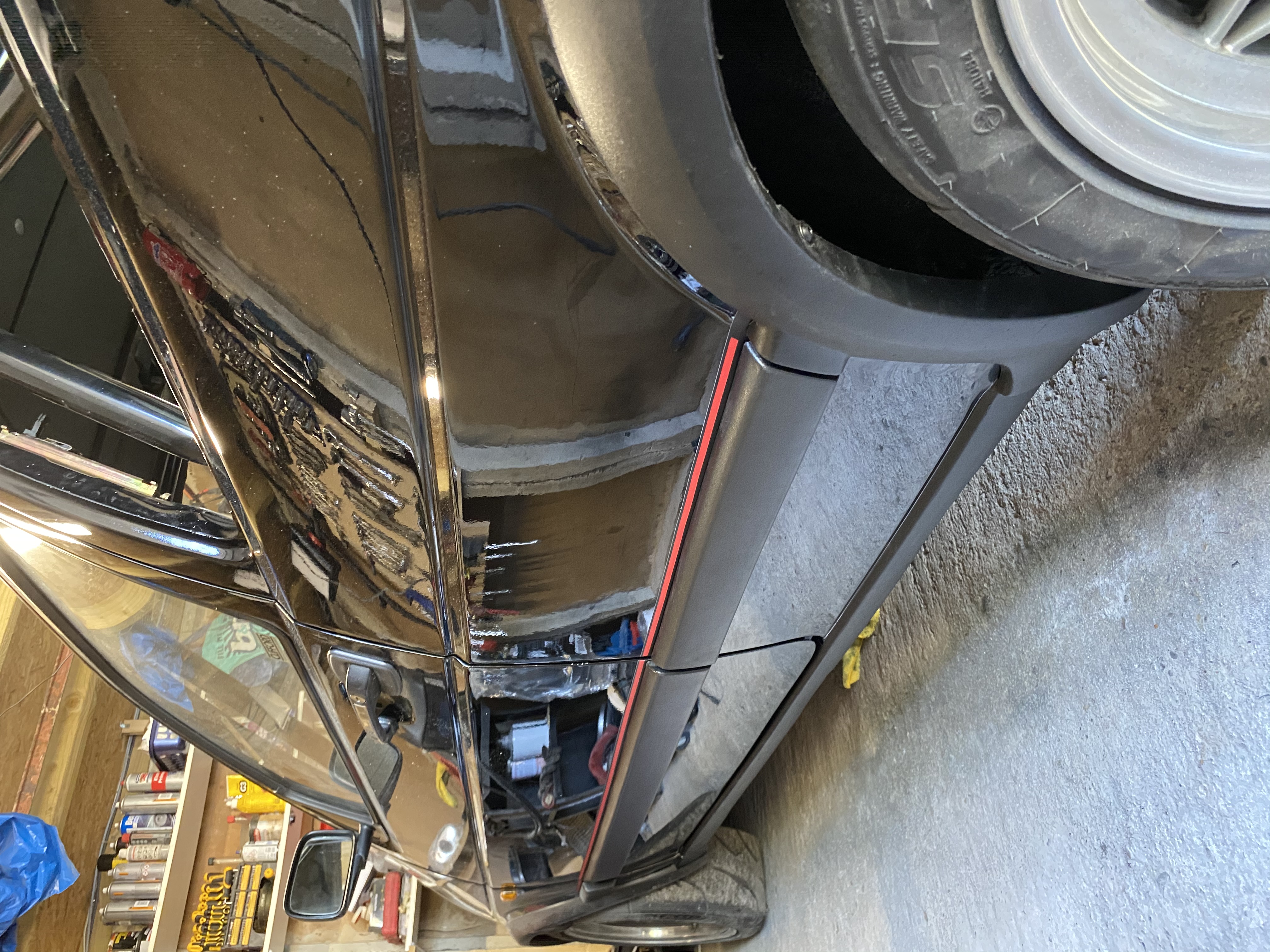

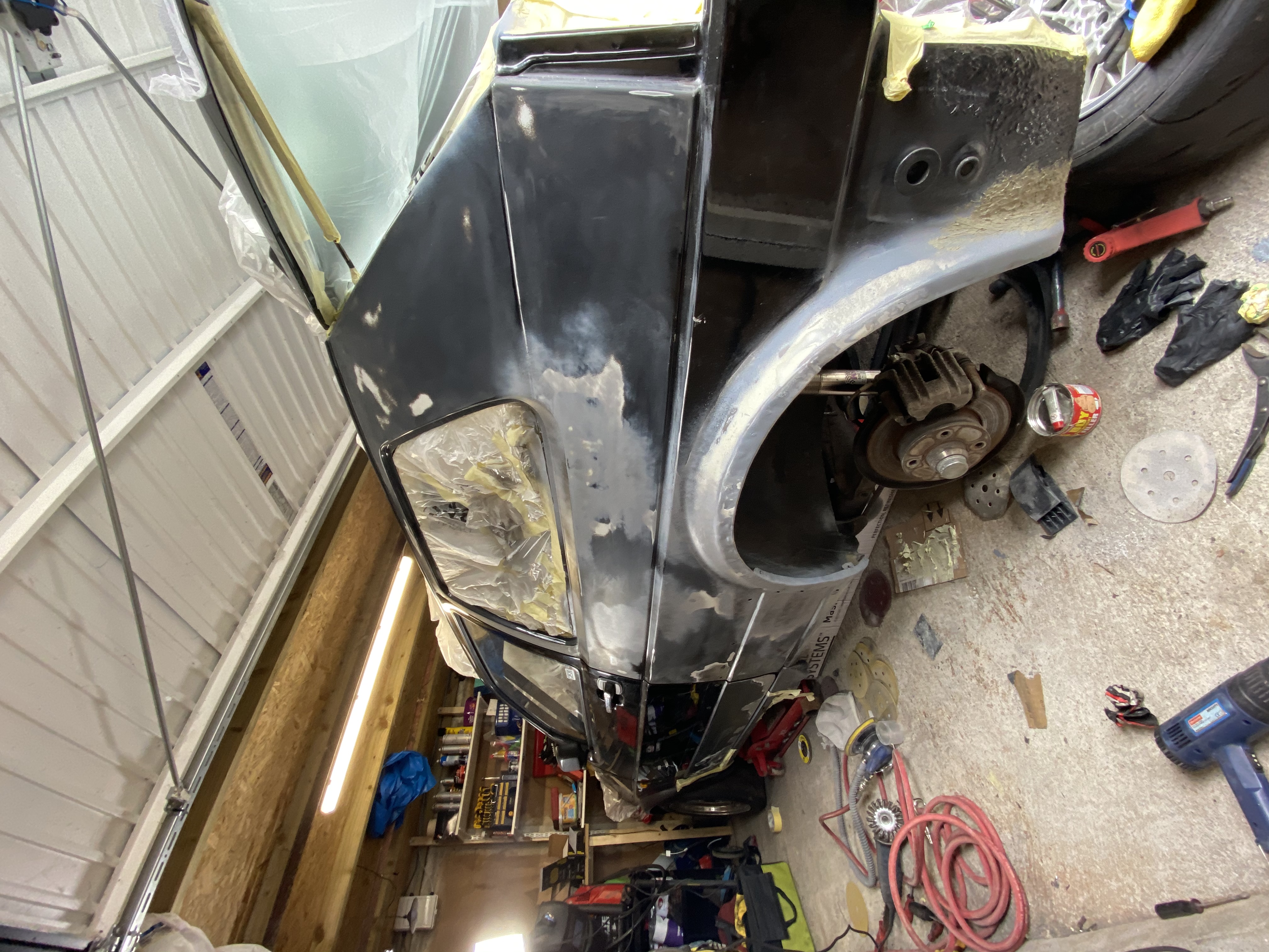

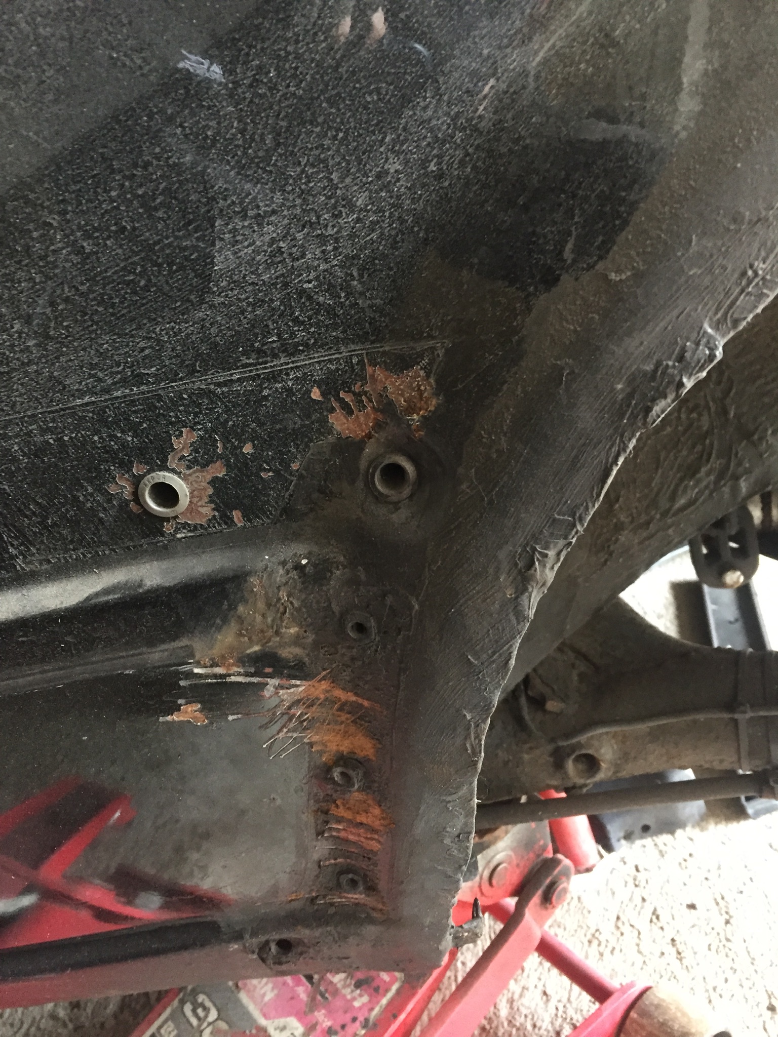

With the success of the rear end, it was time to tackle the crusty rear arches (or just one of them for now) again this was meant to be a “quick” job, lick of paint on the lower half and be done… I eneded up painting the full rear quarter and lower door.
First job assess the situation
Not too bad, but definitely needed some work.

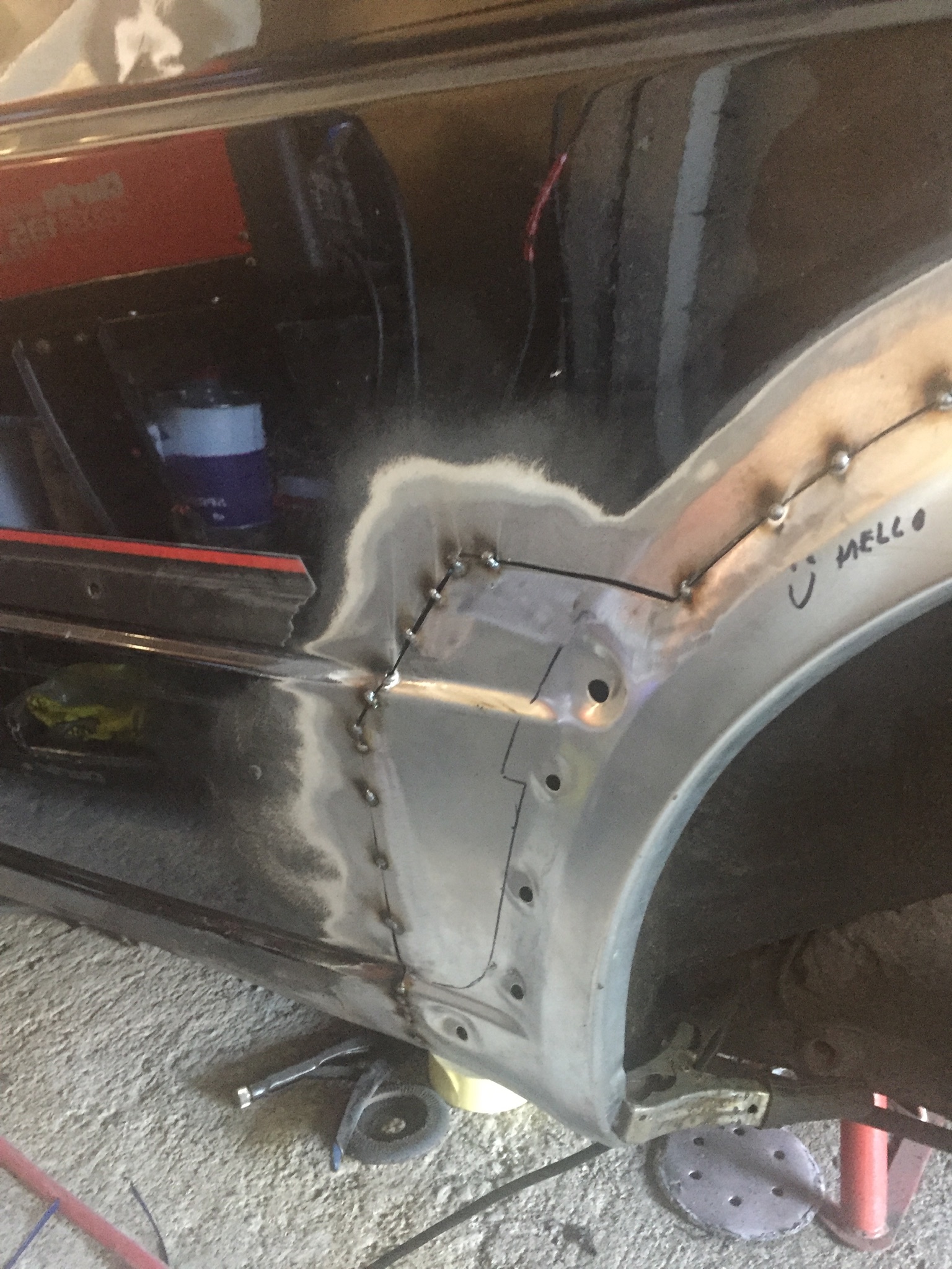

No going back now…

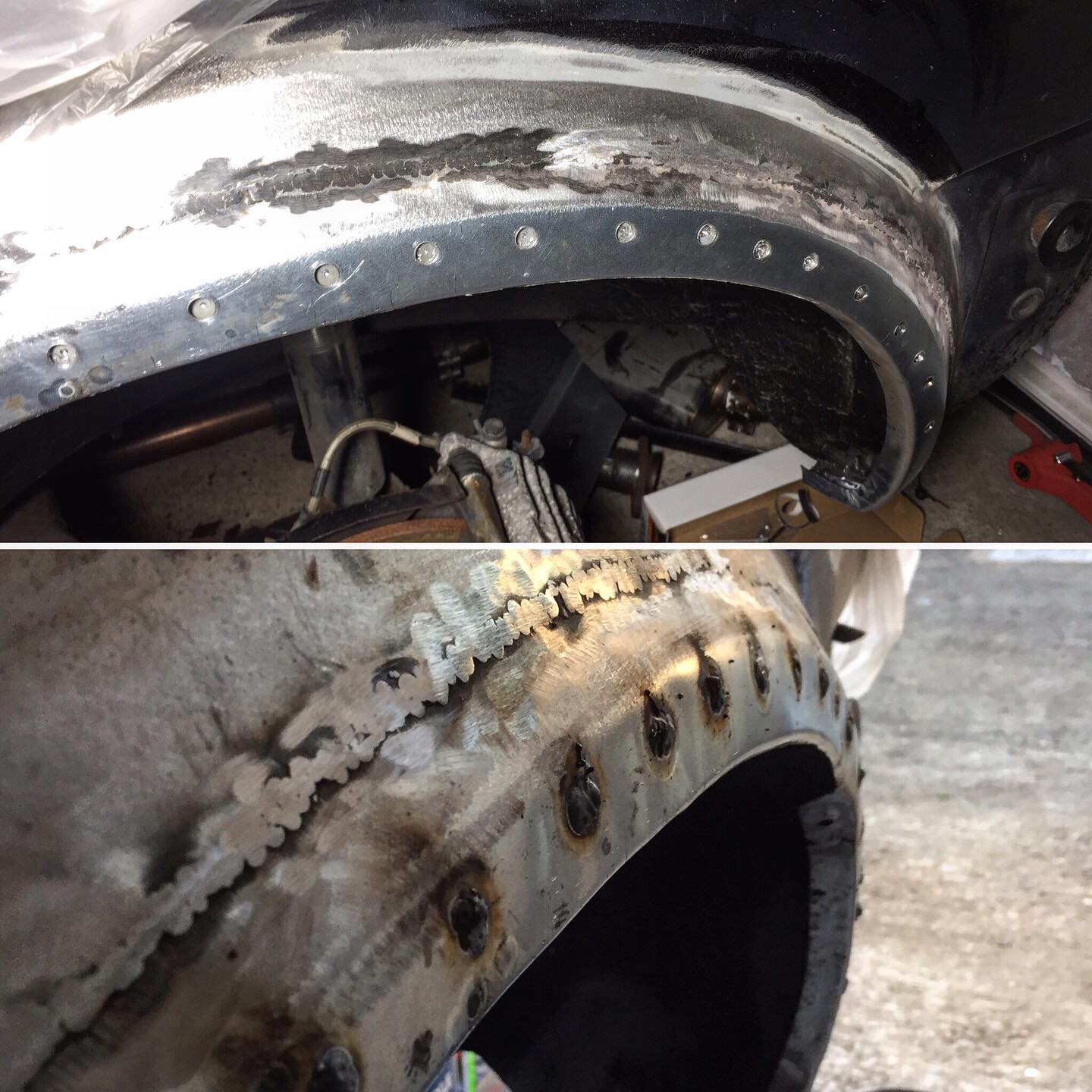

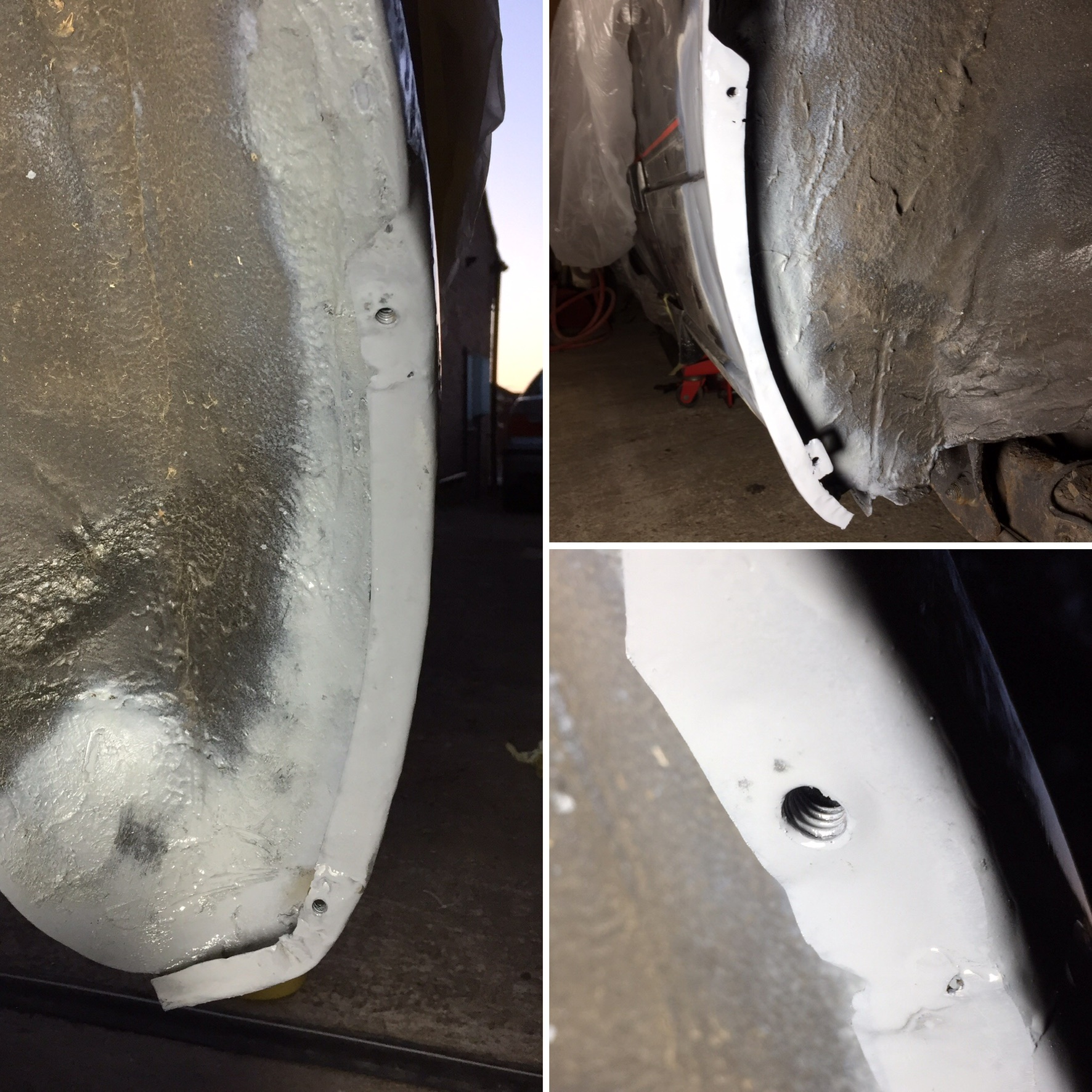

Got it full welded in making sure not to get too much heat in and warp it. Made sure the arches still sat nicely.
To secure the inner to the outer I drilled holes all the way along the front edge, this will be getting covered with the GTI arches so I’m not fused if they don’t come out perfectly level.
The inner lip as then seamsealed, painted and undercoated to prevent any water getting between the panels.

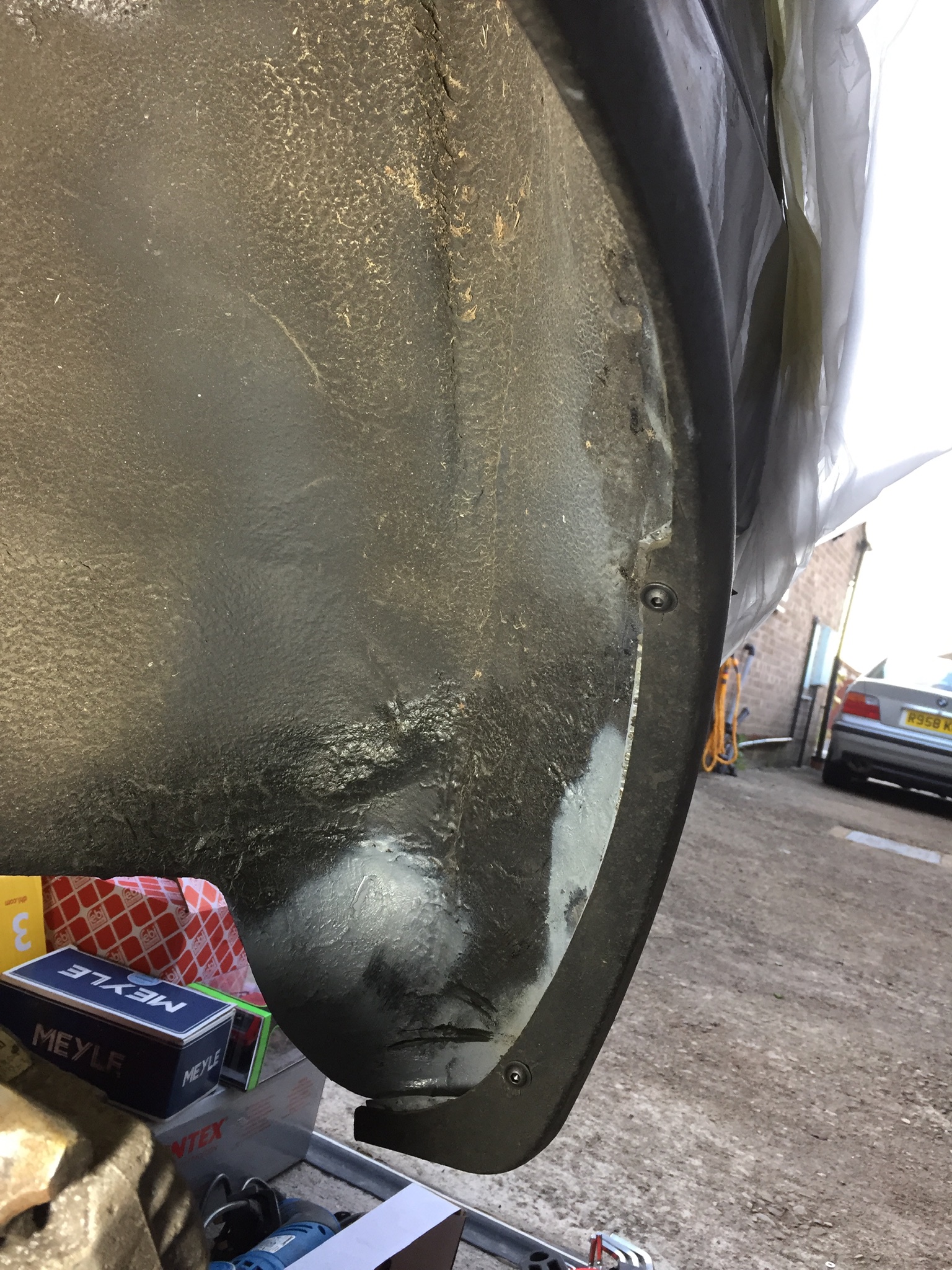

For the inner arch I totally got rid of the lip and brought both inner and otter arch out to the same level as the plastic covers. This just future proofs the arches in case I do get bigger/wider wheels at any point.
Previously I’d welded tabs on the inner arch to secure the covers with cable ties, but the arches never sat exactly how I wanted them to. So to overcome that Ive welded some captive nuts on the lower lips. This means I can now secure the arch with some really nice little M8 flanged bolts.

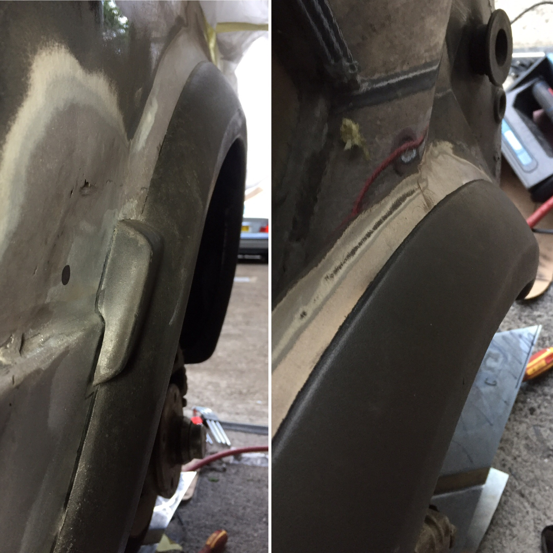

With the arch in the body work could take shape. I had to weld in another little patch under the rear quarter window seal.

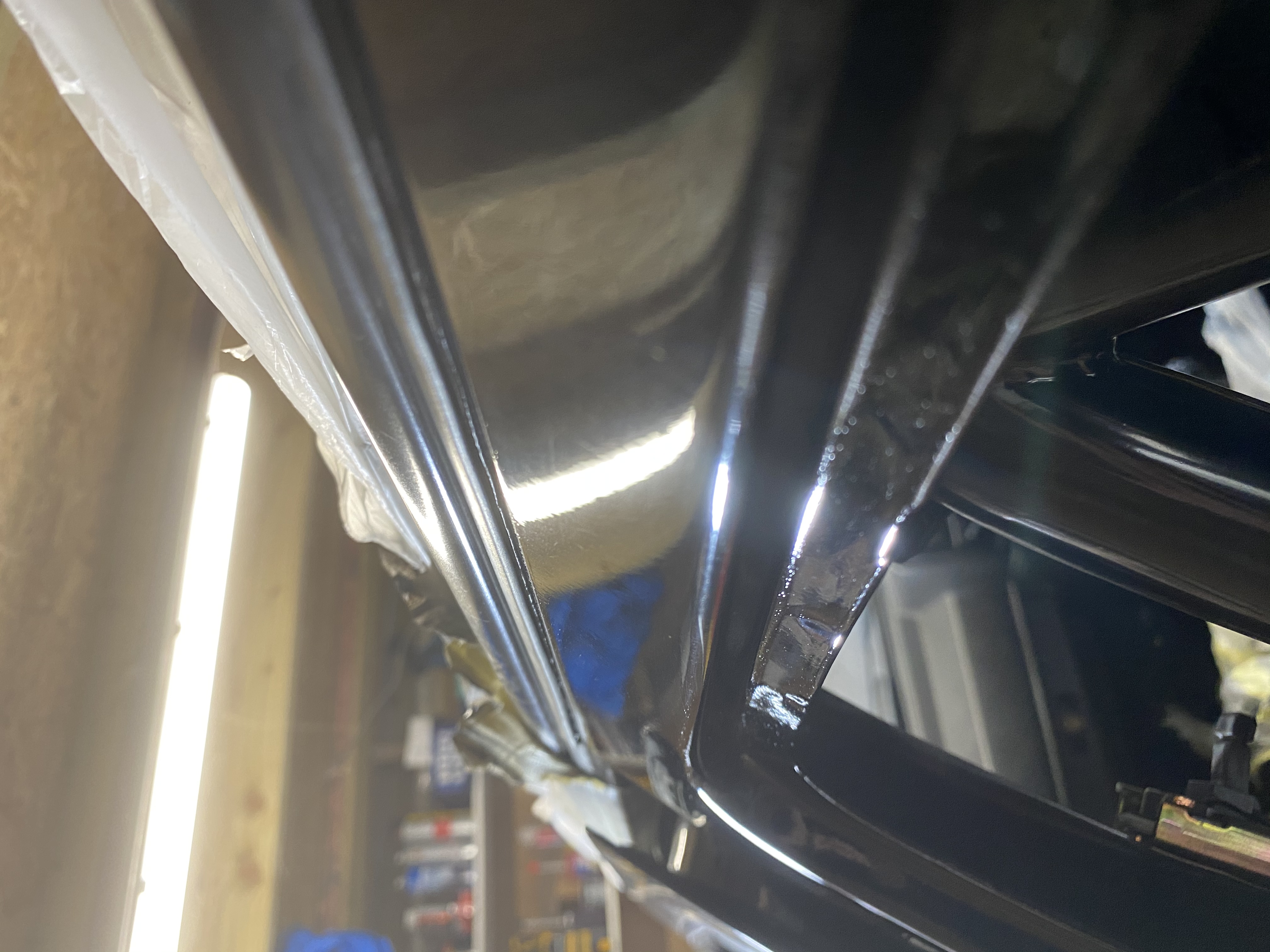

At this point my concern was how was I going to paint up to the roof gutter? I know they are a massive pain and never look right when they have been off, mine are perfectly straight so I didn’t want to touch them.
Theres more updates to come so I’ll share my little pikey tip with you in the next update! [:D]
Re: Cope's GTI
Another lengthy update, apologies.

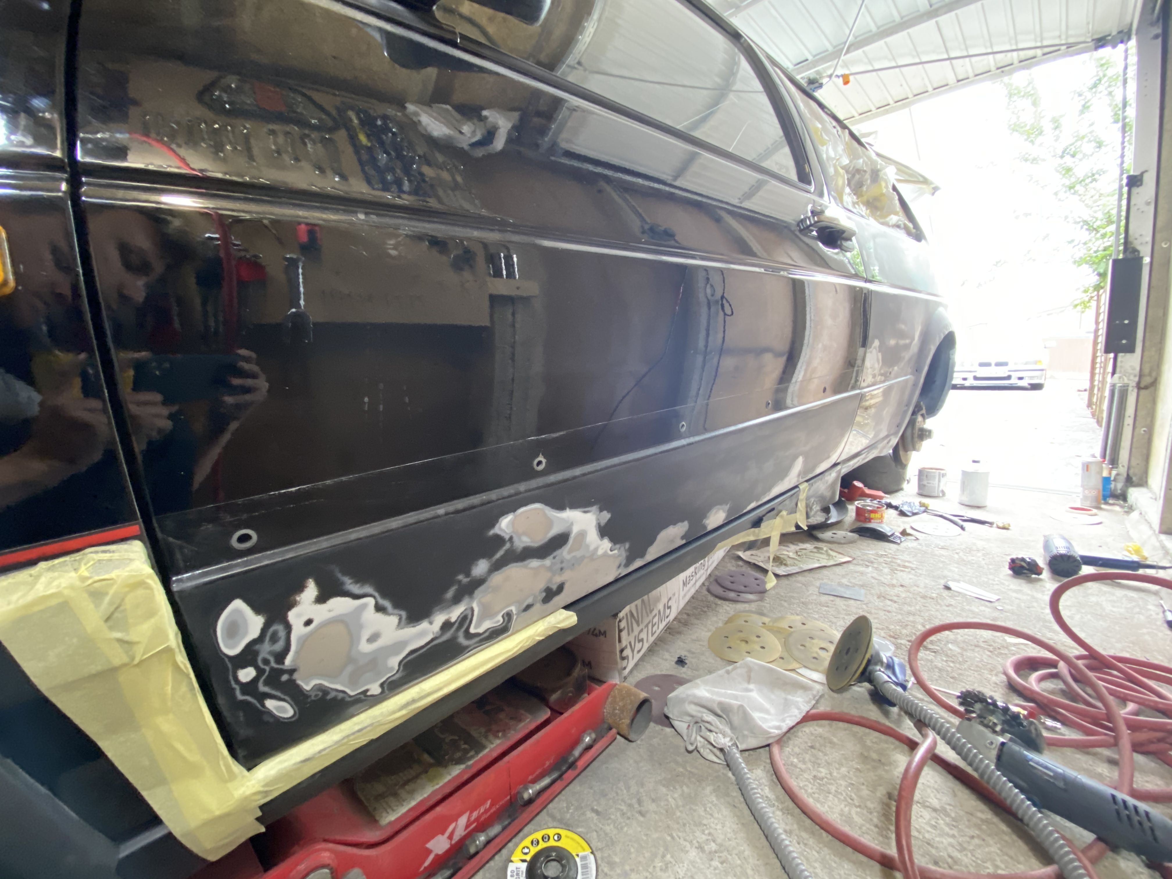

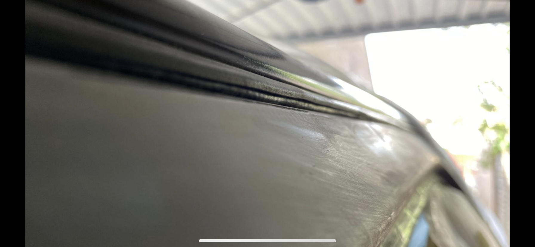

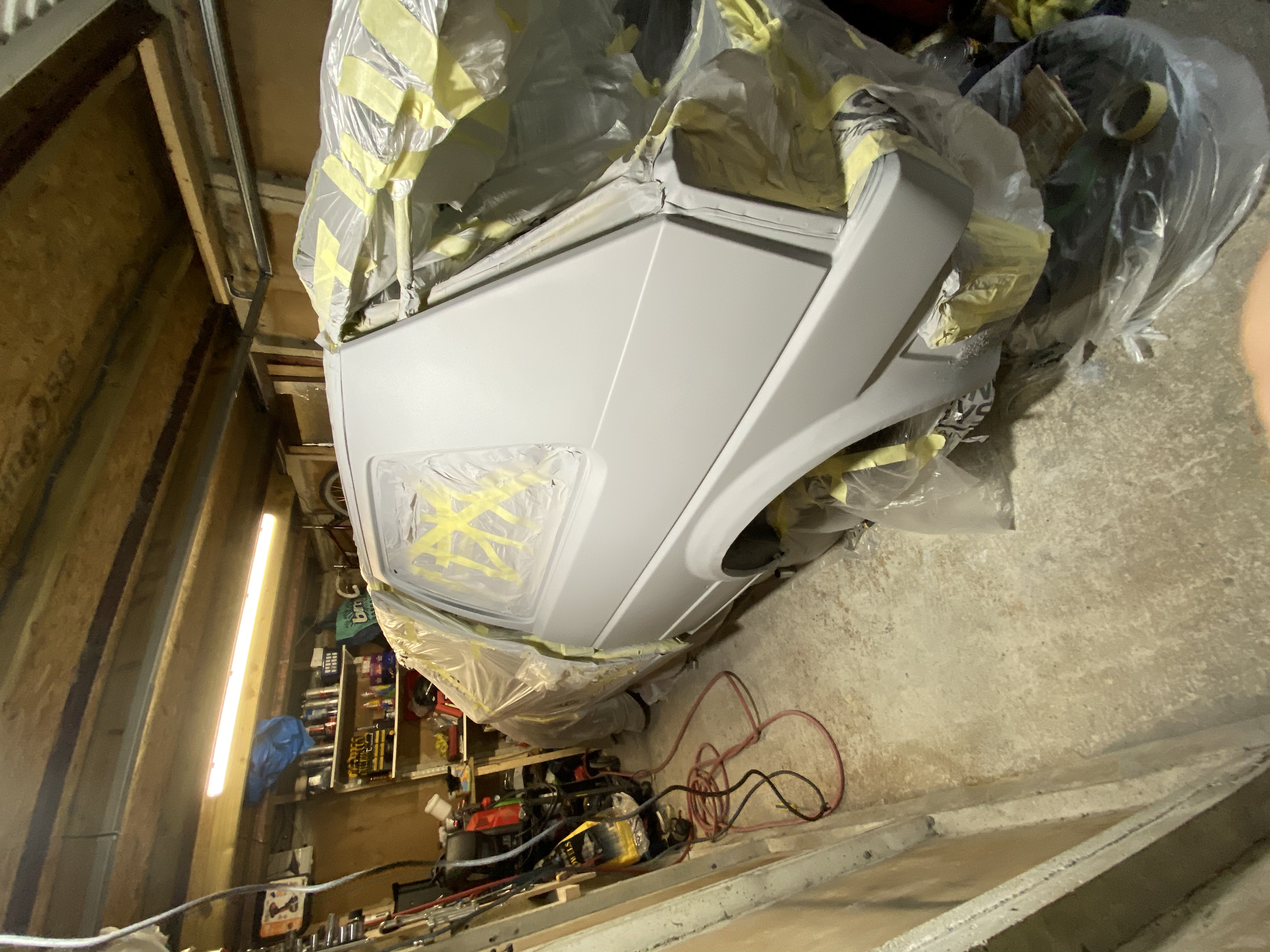

So back to the painting, what’s the little dodgy tip for painting up to a roof scuttle I hear you cry, the answer is an old USB cable with the ends cut off.
Once stuffed under the seal it pushes right back and pulls the lip of the seal right up, meaning you can paint underneath it, then remove the cable once its all done and dry.

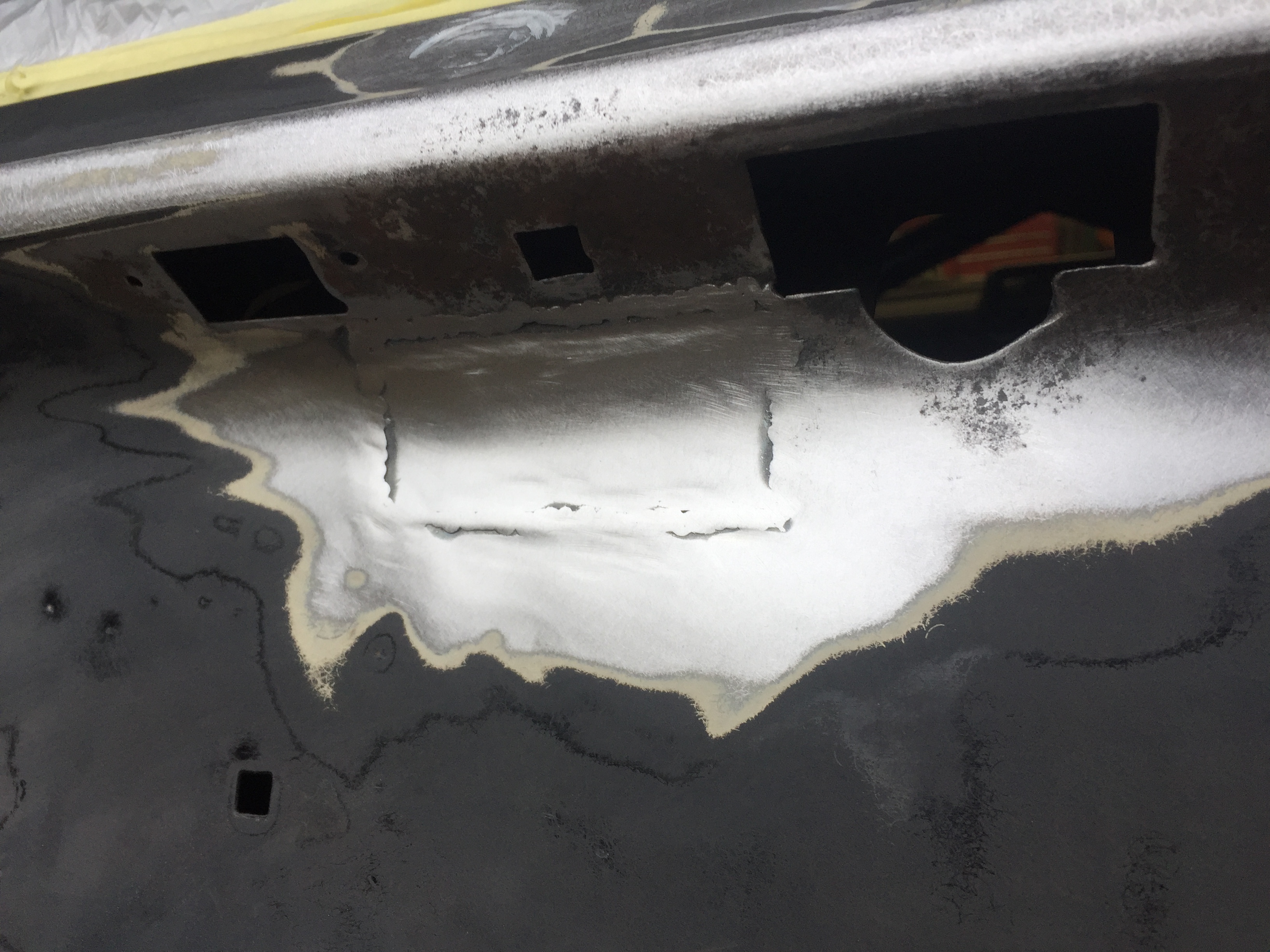

This paint wasn’t without its problems, one of which was the room I had, some areas I physically couldn’t fit the spray gun into the correct position. I again had some funny reactions with the primer. But I sussed out what was going on. It was reacting on every area I’ve painted with cans, which makes sense as the primer must be reactivating the solvents in the old paint. That meant a quick flat down and dust back over with primer.
At this stage, I spent quite a lot of time with a block and some 600 paper, making sure everything was as flat as possible and any low/high spots taking care of.
Here I came across another issue, where I’d welded the patch under the rear quarter window seal I’d got too much heat into it and warped the metal. This meant every pass with the block the panel would spring in and out (a little bit like a coke can, if you push opposite sides) After some reading up I’d found an old hot rod thread online. They suggested getting the area really hot then rapid cooling to reform the metal back to shape.
So I set to with the heat gun, got the area extremely hot then a blast with the air line, and “ping” it went right back to shape! And solid as a rock when sanding :) the old tricks always work the best!

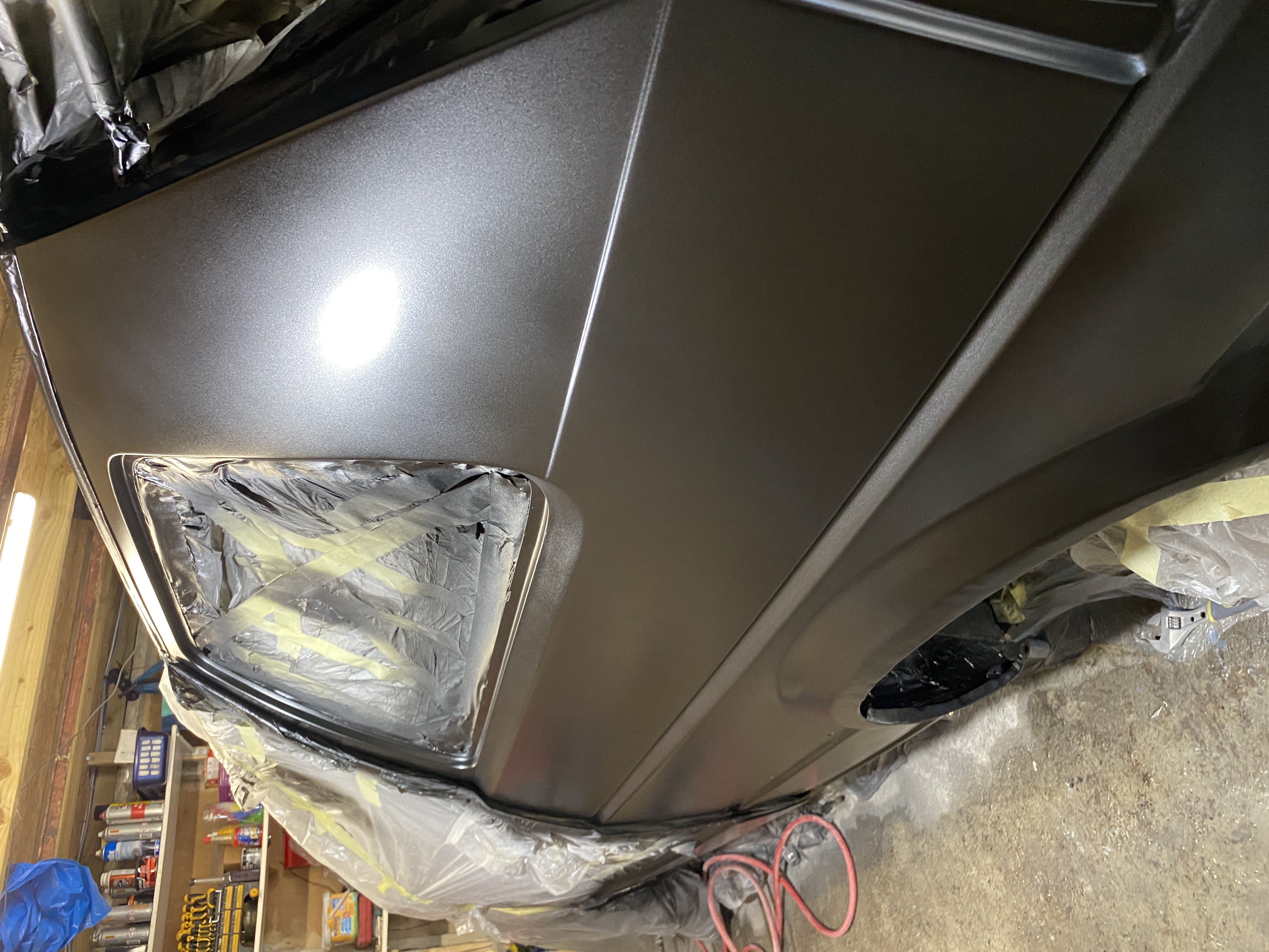

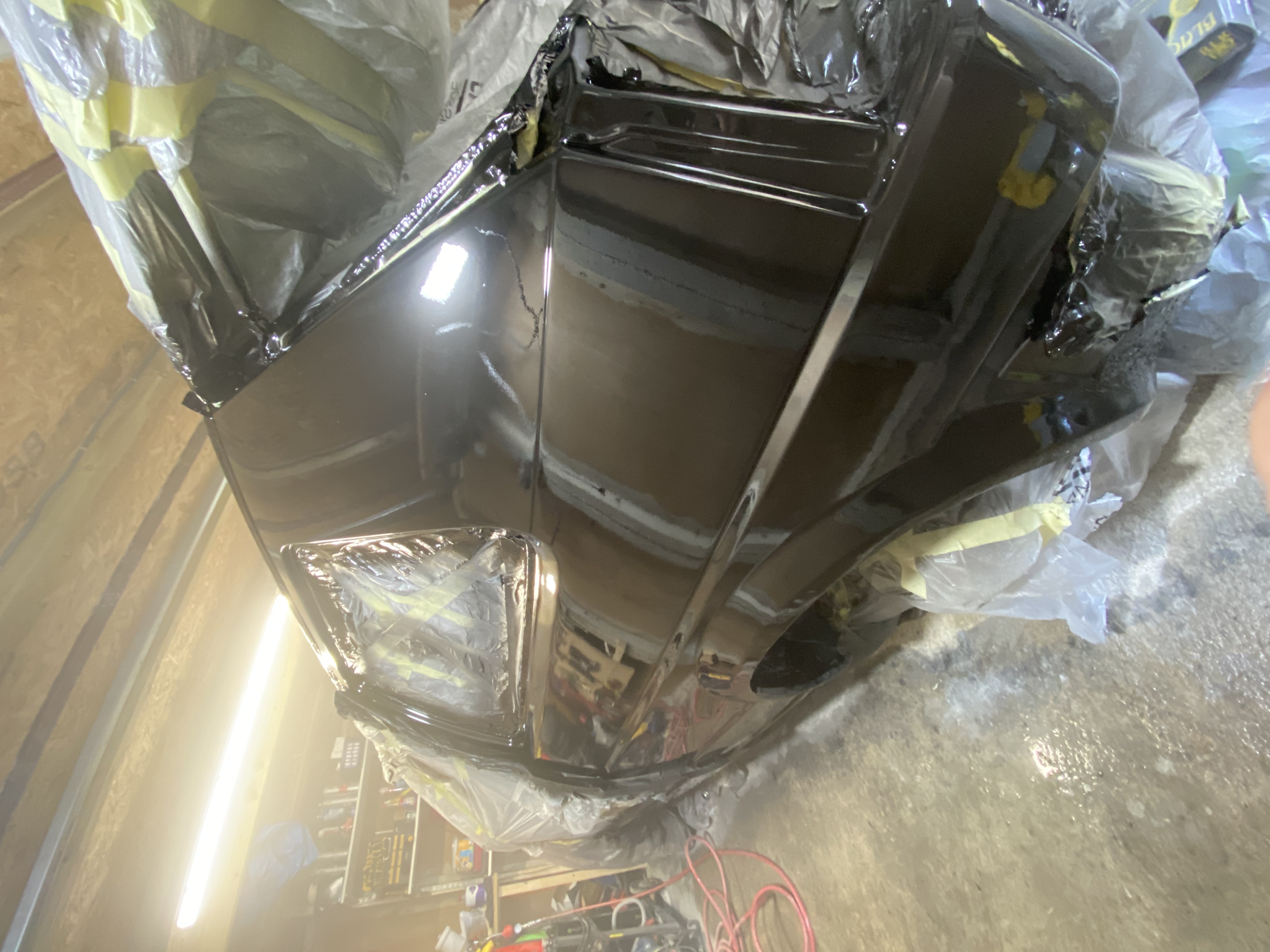

So now I could get onto base coat.

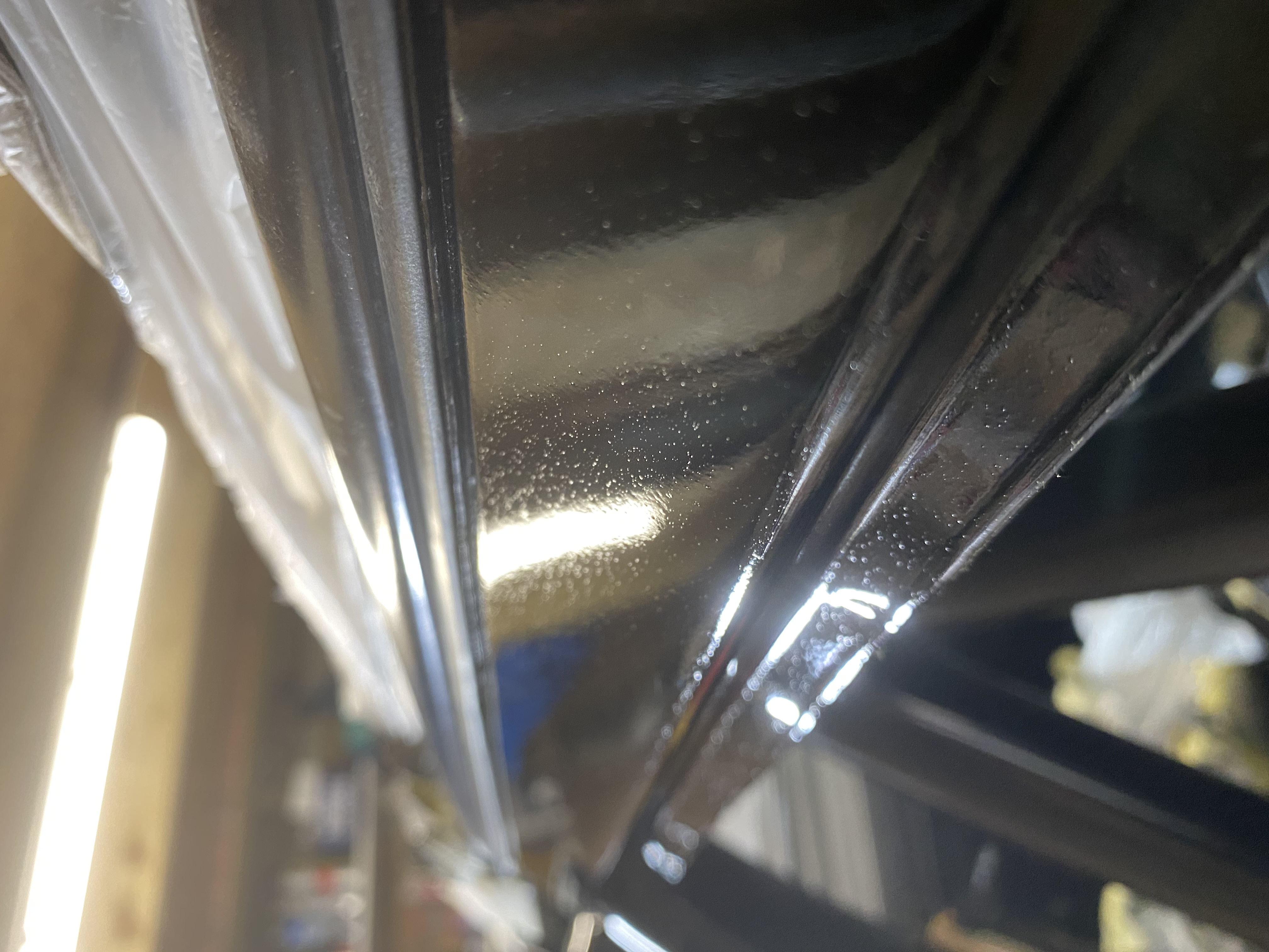

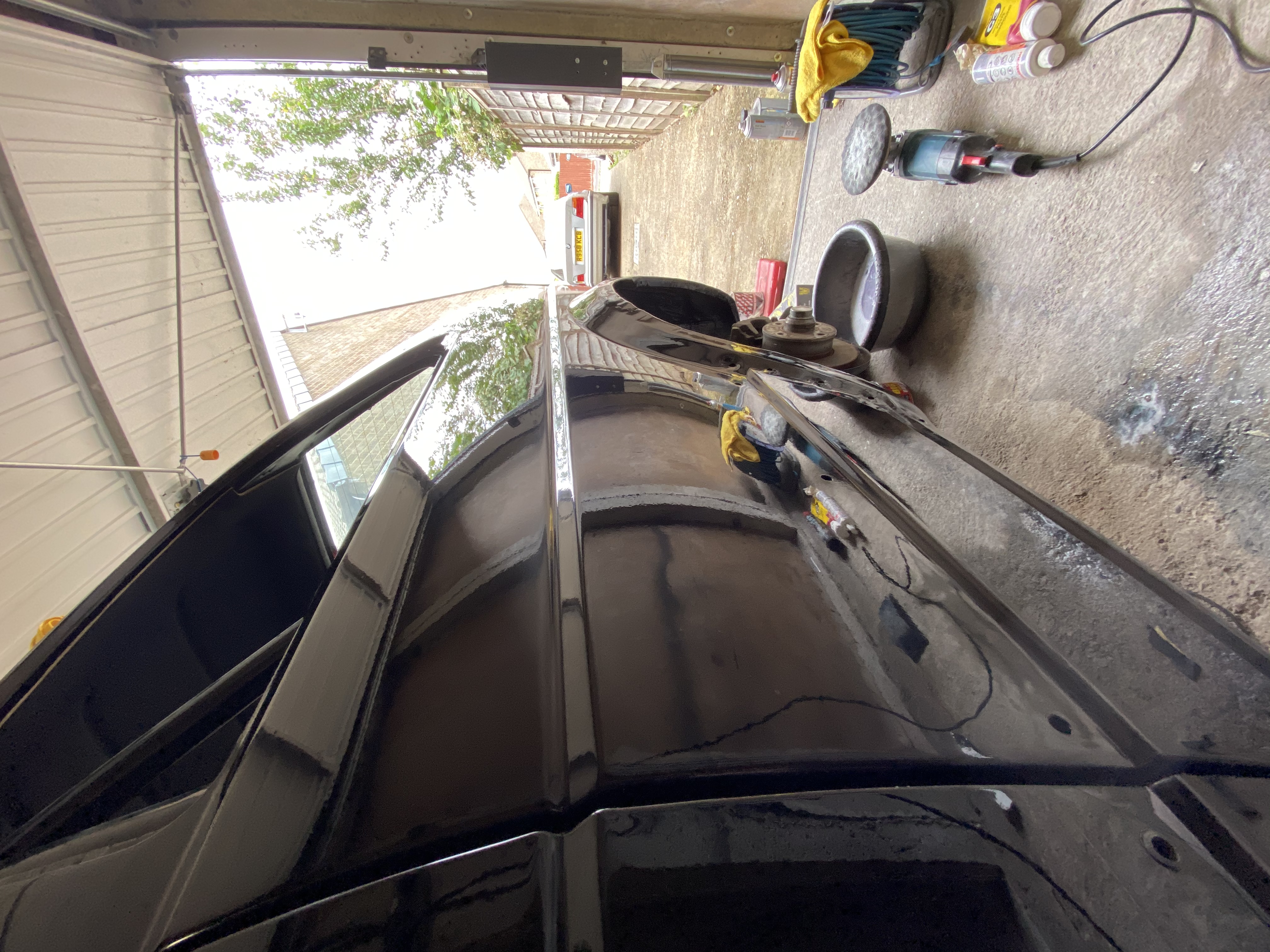

And then onto clear. Here are the results.
Straight from the gun
:) very happy with that. I found the process much like painting with cans, prep is key. And its best to get the clear coat on with full paint flow, full fan, and nice and thick to give the best results.
I did get a fairly hefty run in the lower panel, but this was sorted with a razor blade and some wet and dry.
I did have a moment of panic. Once the paint was dry I have these little dots in the paint surface.
I had a feeling this might be solvent ‘pop’ again.
But luckily it was just overspray – if you look at the pictures above out of the gun you will see how hazy the garage is, I painted with the door shut to reduce dust and had no means of extraction, which meant the overspray was just landing on the fresh paint.
Once the paint was left for 3 days to fully cure
It was easily rectified with the flatting and polishing process [:D]

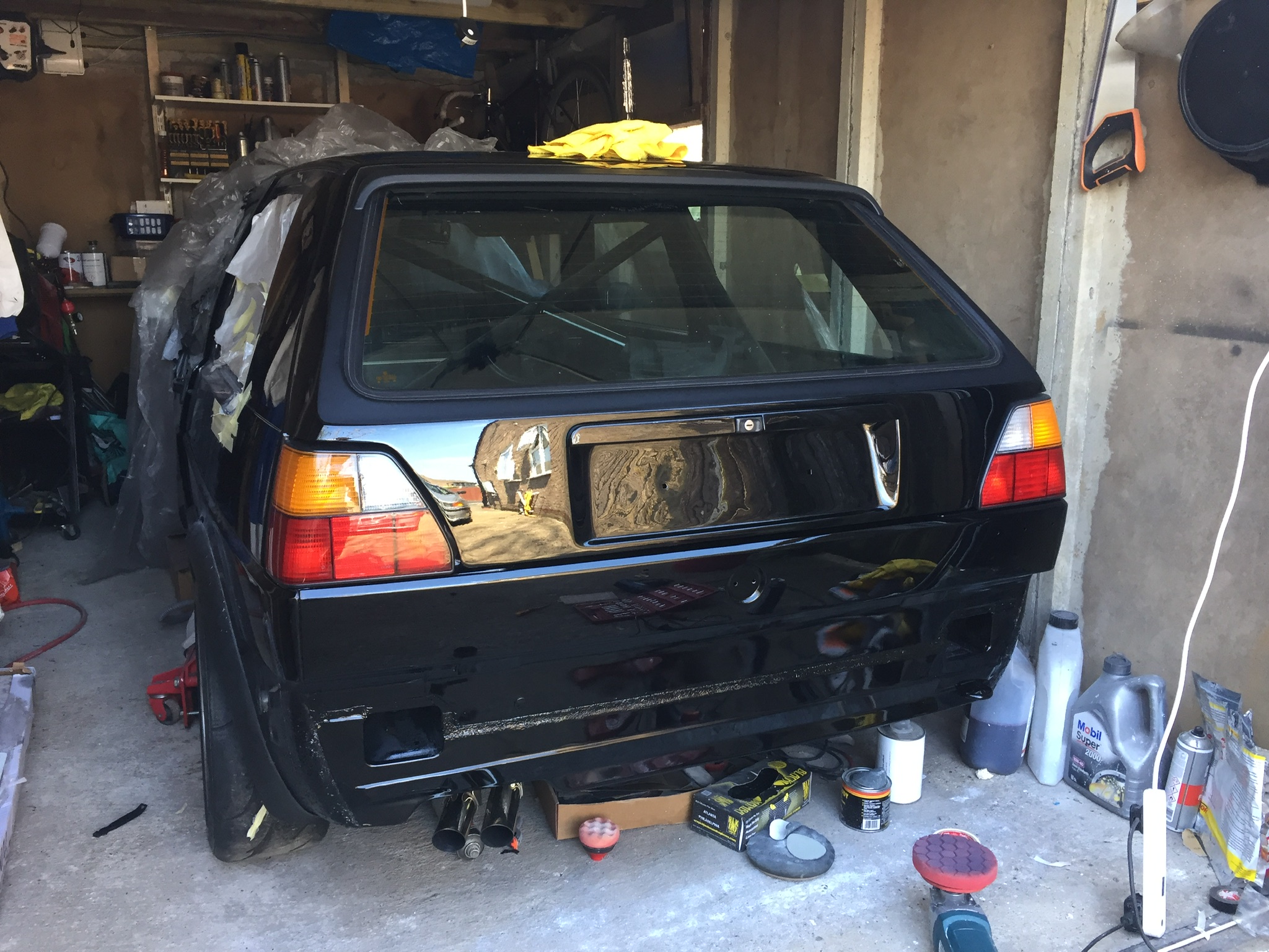

Then the car could be put back together, along with some new red stripe vinyl which I design and produce to factory specs.
And that’s the paint complete! Bloody stressful process! Very glad its over (for now) Theres plenty more that needs painting…

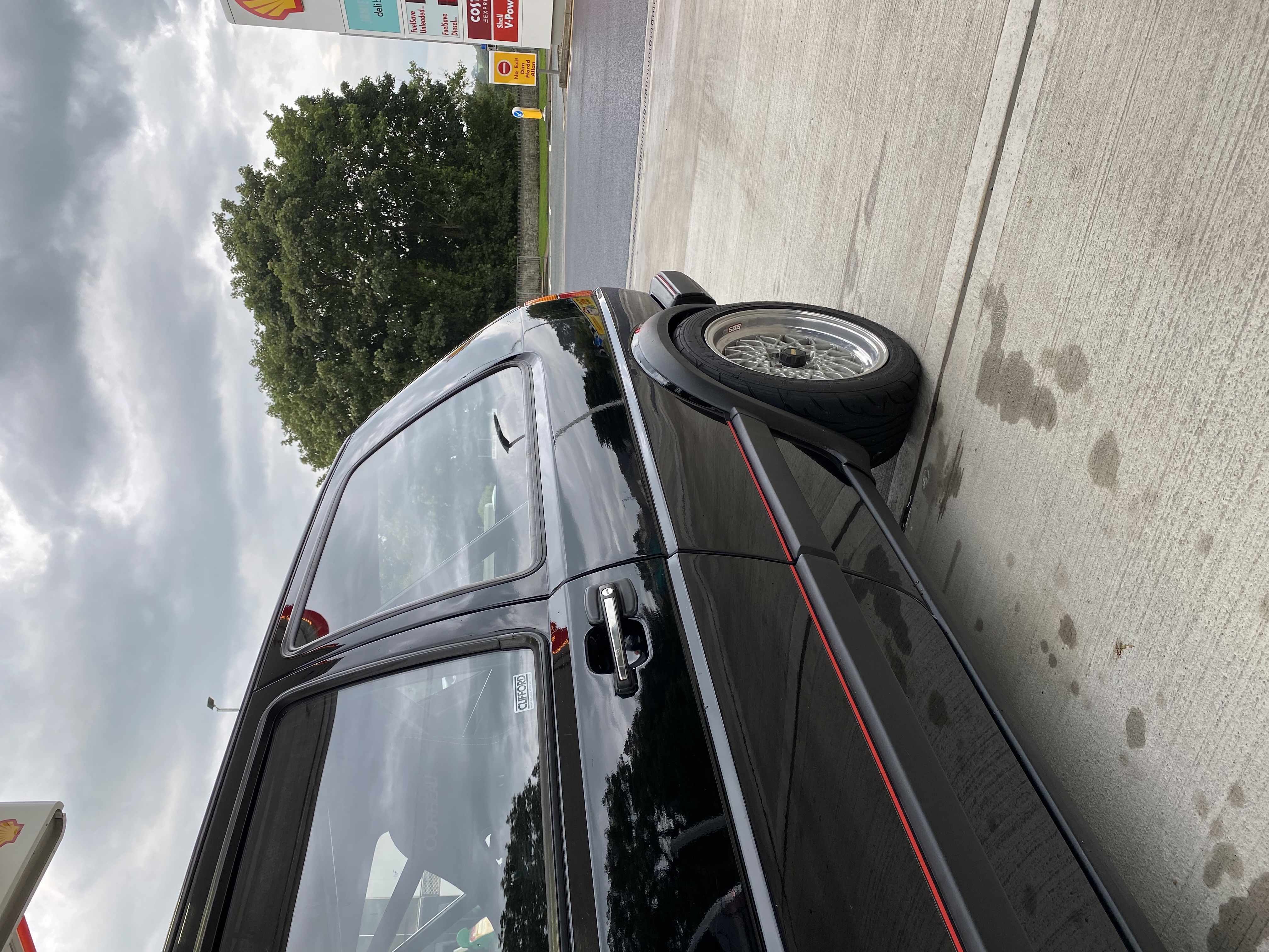

The car drove really well, I always forget how good it is. my daily is a silky smooth e36, but this trumps it by far! We sat at 85 most of the way and it was effortless, well ahead of its time.

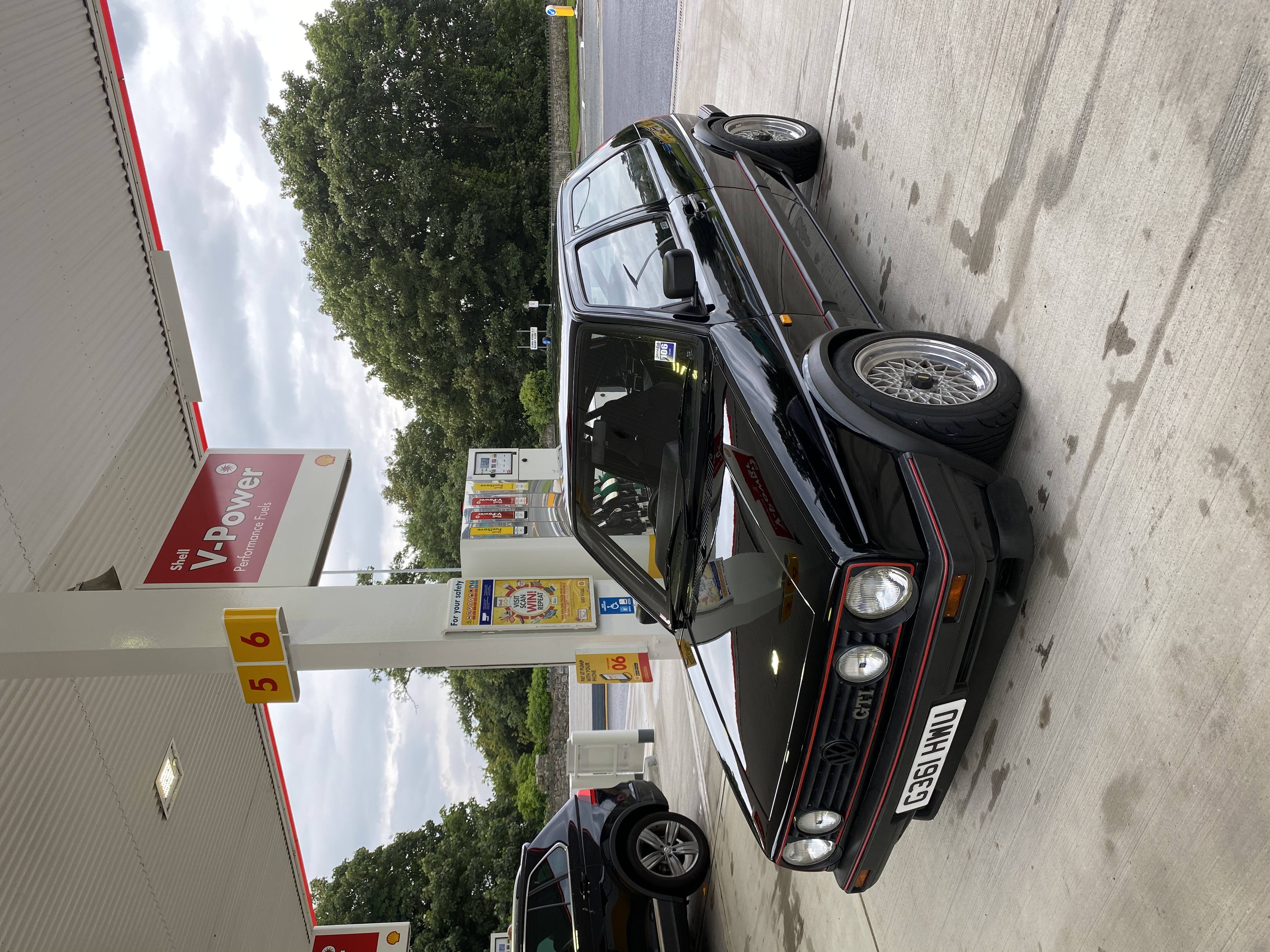

Got some photos and better photos of the rear quarter whilst grabbing some V-Power
Lovely spot!

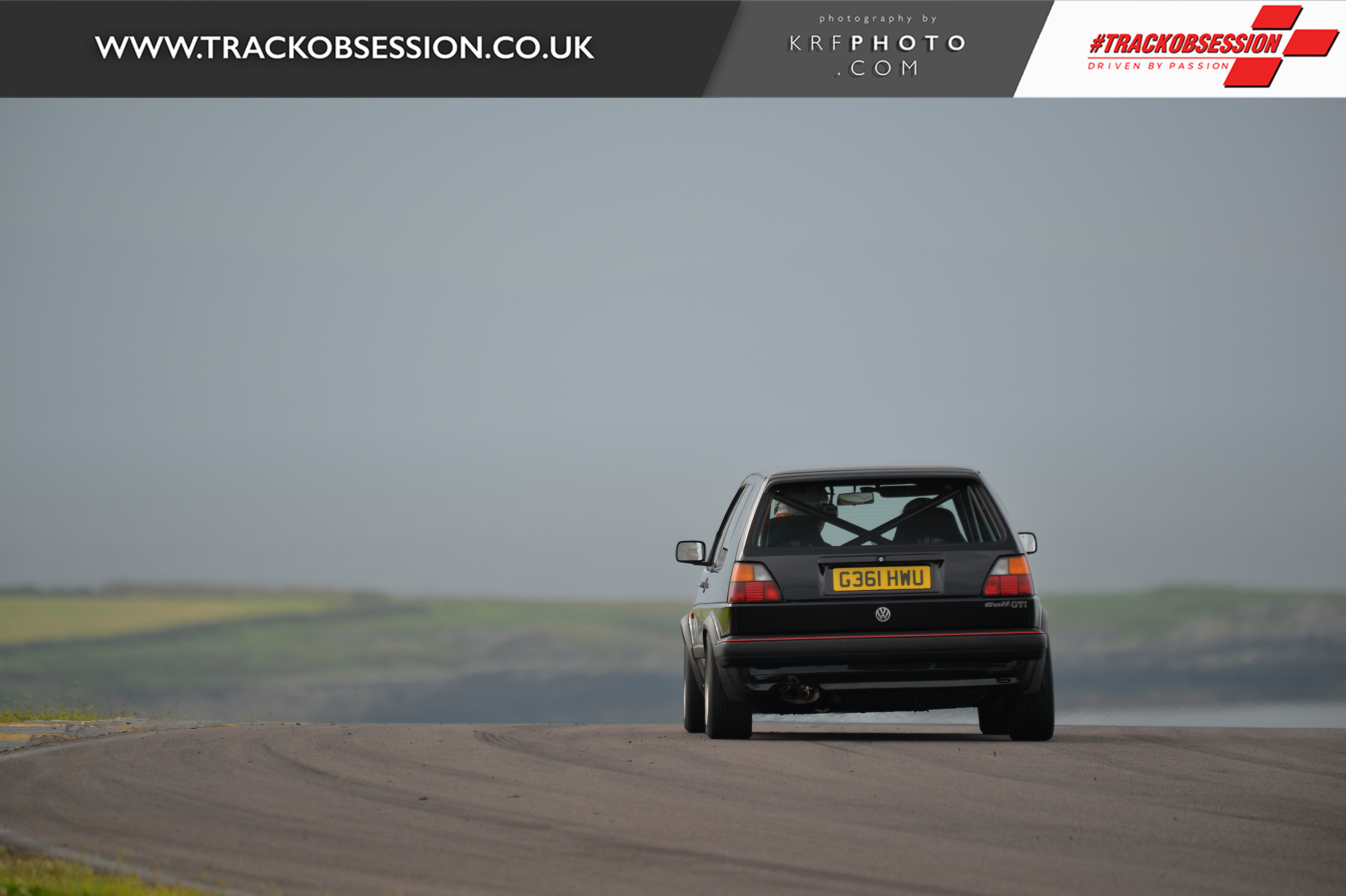

The day was organised by Track Obsession, I have to say they did a bloody excellent job!
Free bottle water for drivers, free photography to name but a few touches!
After the sighting lap I got myself out, this is the first time on track since fitting the seats and harnesses and instantly I was smiling ear to ear.
Christ it goes well! You really cant simulate on the road how fast you can actually drive on track, and it blows me away every time!

I was finding I was locking up the rear inside wheel on heavy braking zones, so it may be time for a proper bias valve.

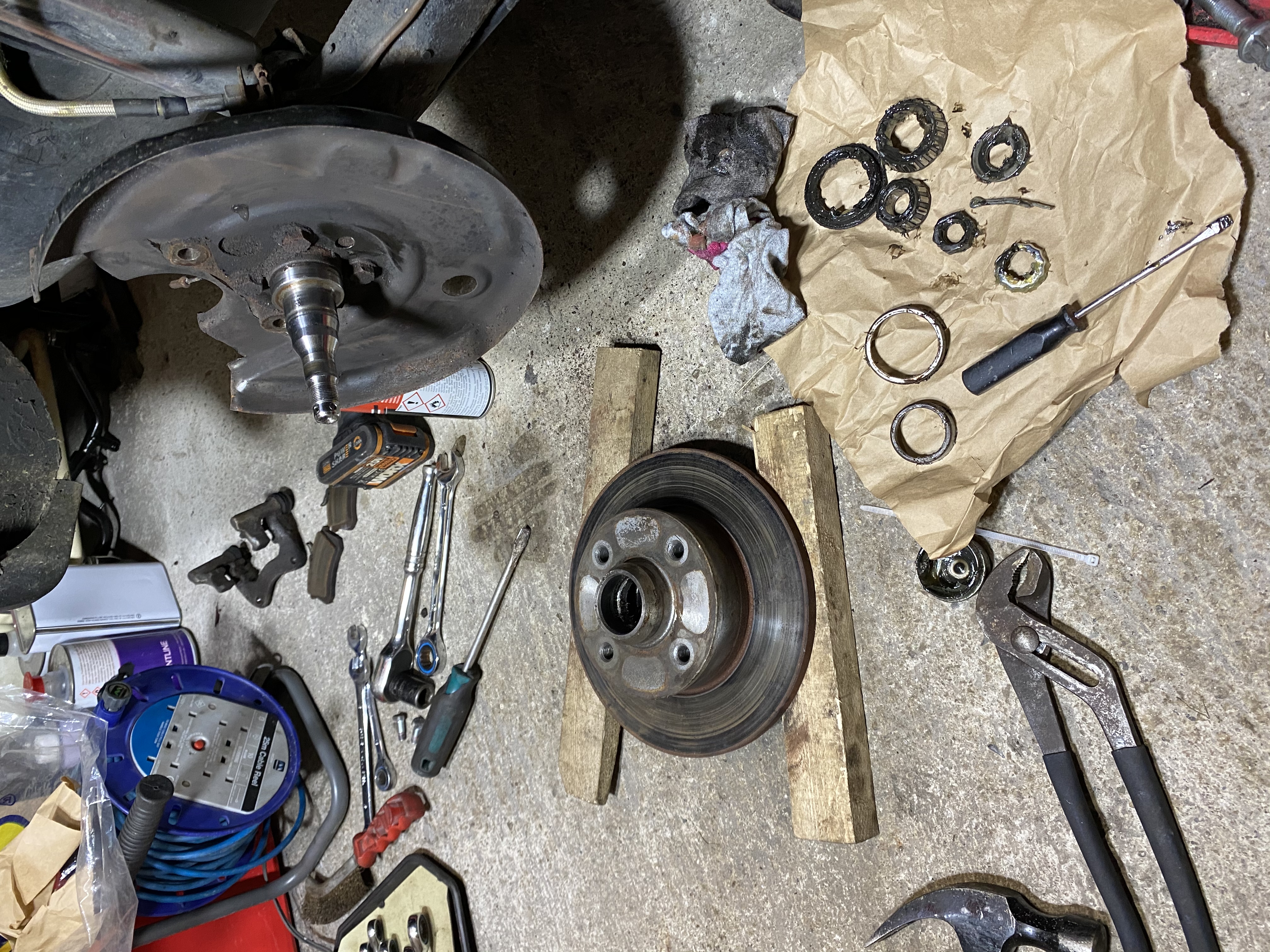

If you watched my Anglesey video, you might notice a humming noise when cornering hard left, I decided to replace all the wheels bearings for peace of mind. Once the hubs were off it was easy to hear it was OSF with the issue, and you could also see a build up of grease around the back.
I'd bought some SKF bearings for the front.
Then stripped them all down, and rebuilt with Redline CV-2 high temp grease, this should hopefully give them some future protection.
I started on the rear bearings last night, just got one side done. Same grease, this time with FAG bearings.

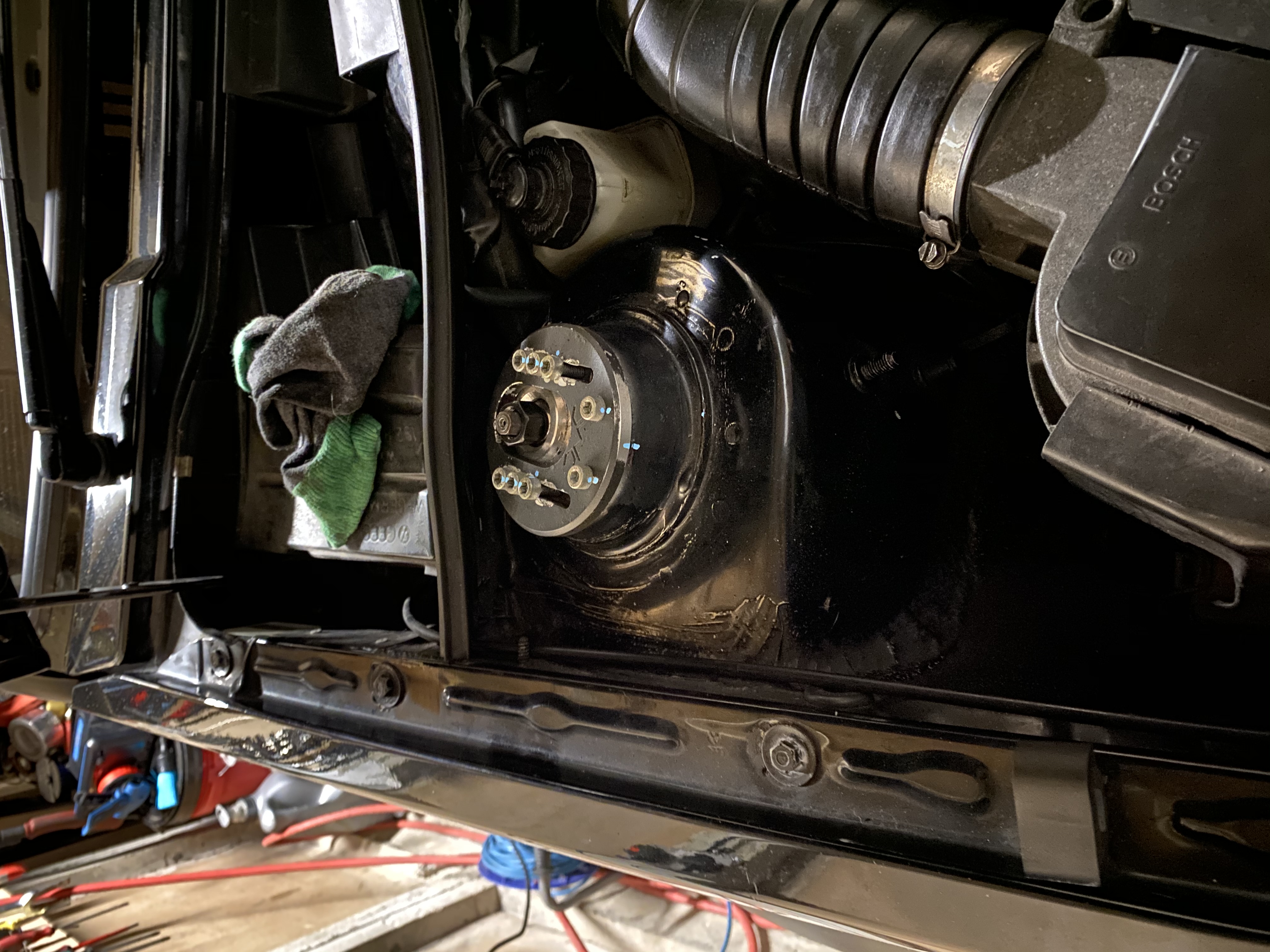

While the front hubs were off I decided to add as much caster as I could onto the top mounts. I measure a 20mm increase at the mount, no idea what that is in degrees. But it's off for an alignment this Friday :)

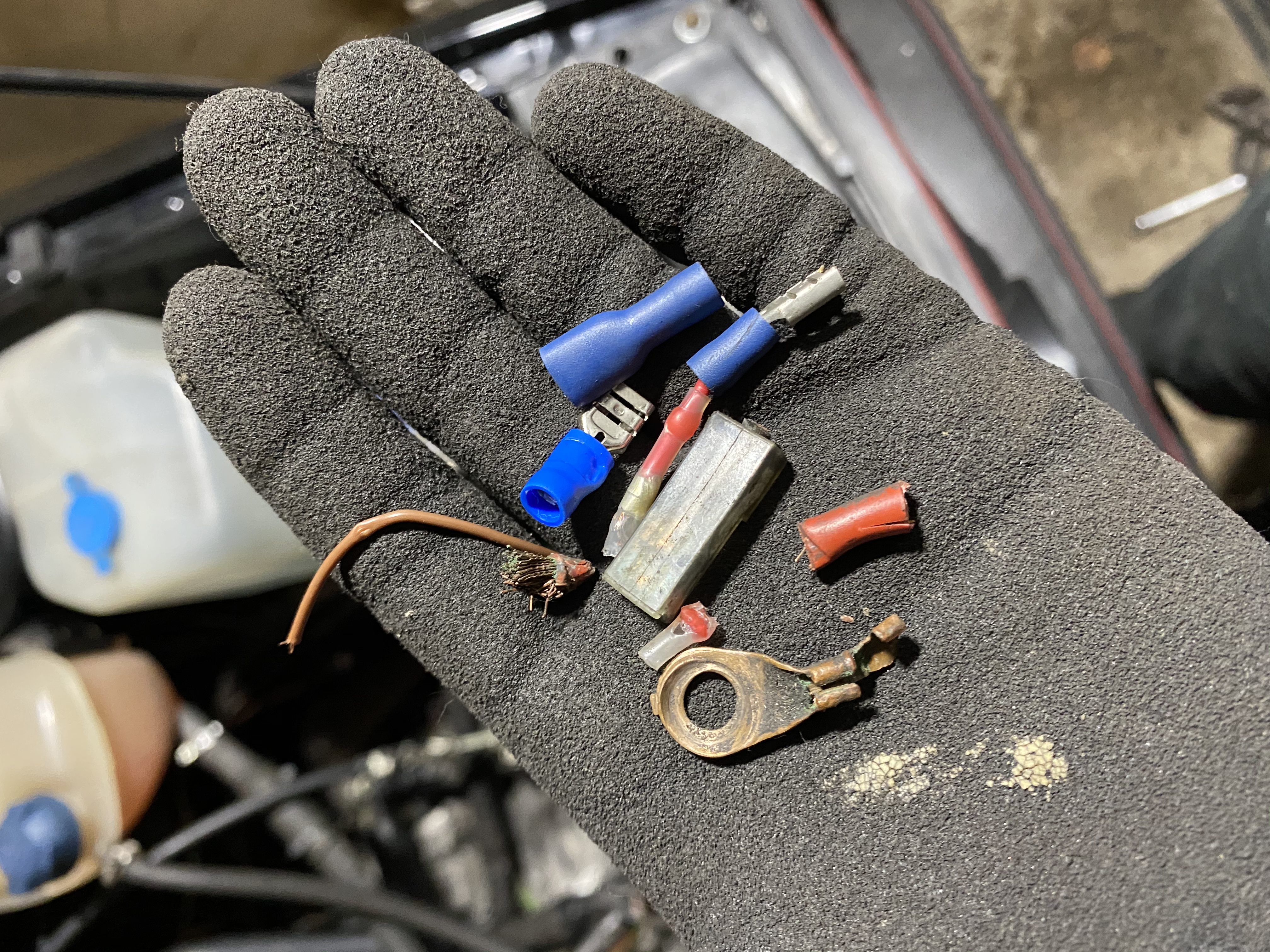

I did plan to go for a test drive yesterday, but the car died on my drive and wouldnt restart. I track it down to no spark, then to a dodgy connection at the coil. Its the wire that feeds the hall sender, so the rev counter didnt jump while cranking.
While I was there I went over the bay and cut off any shoddy connectors a redid them.
