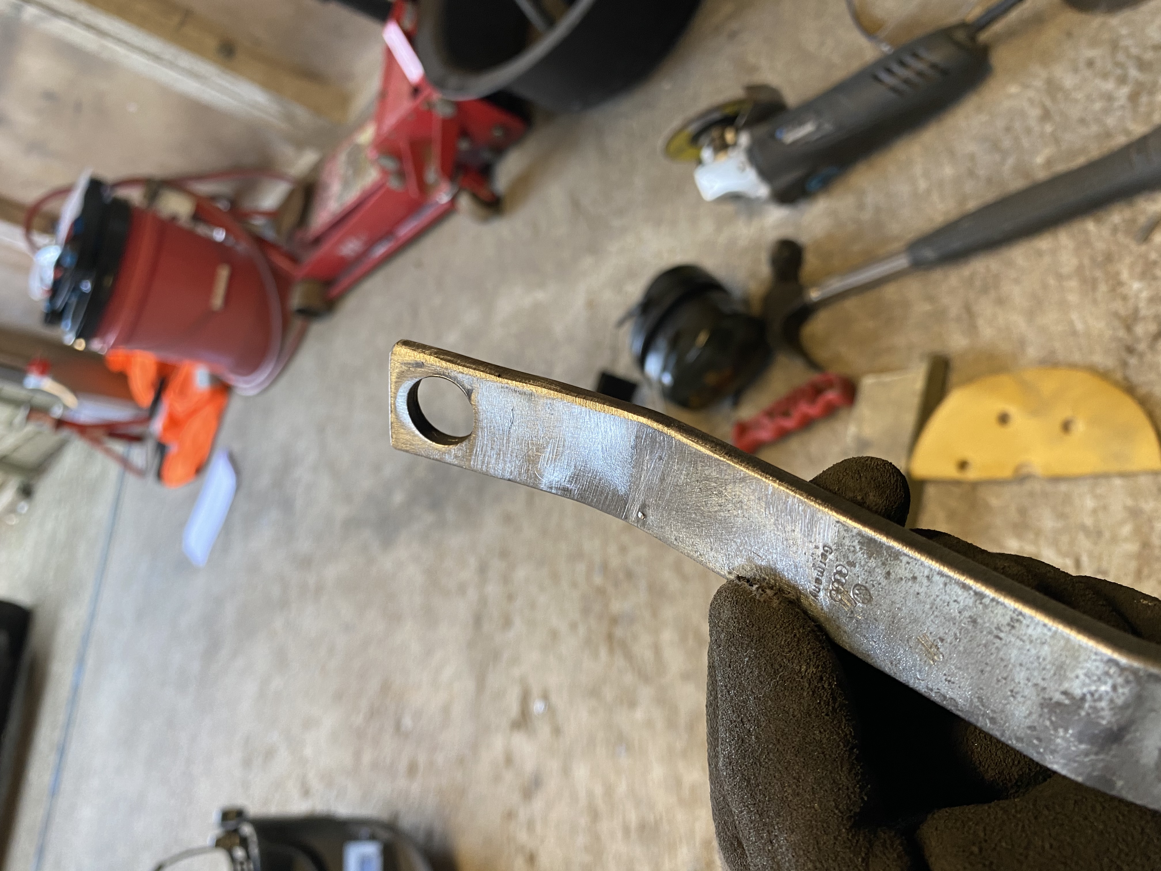

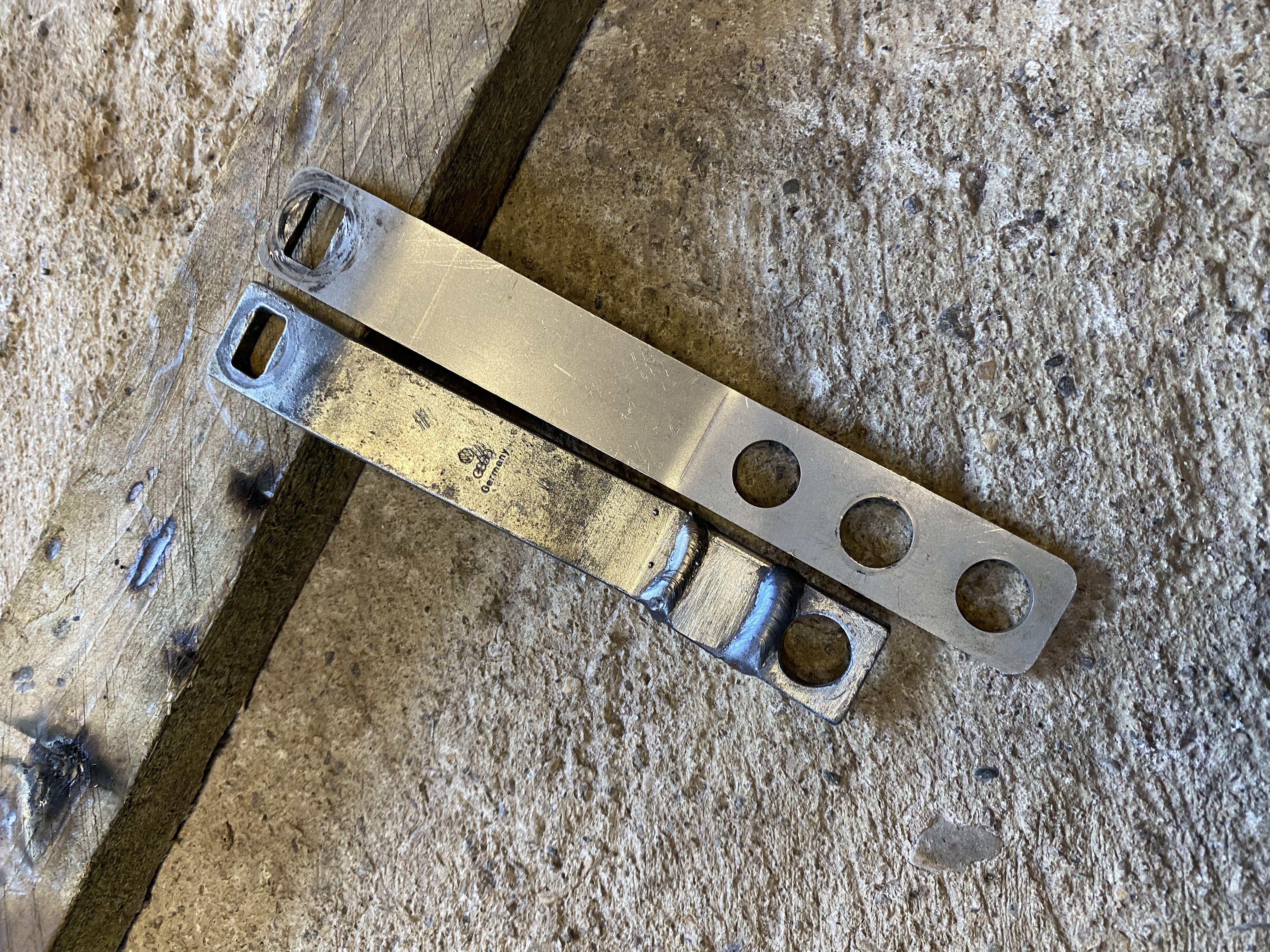

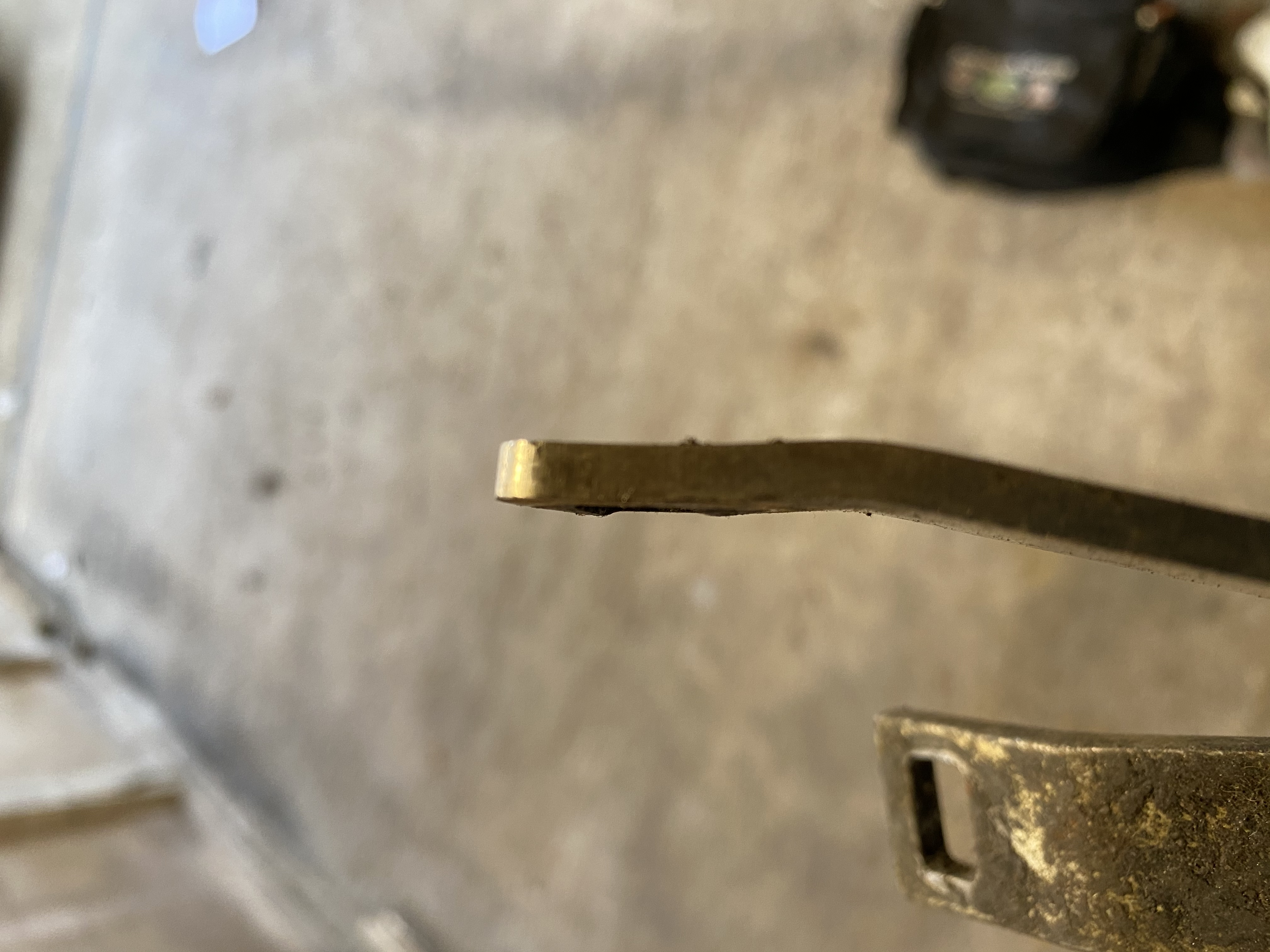

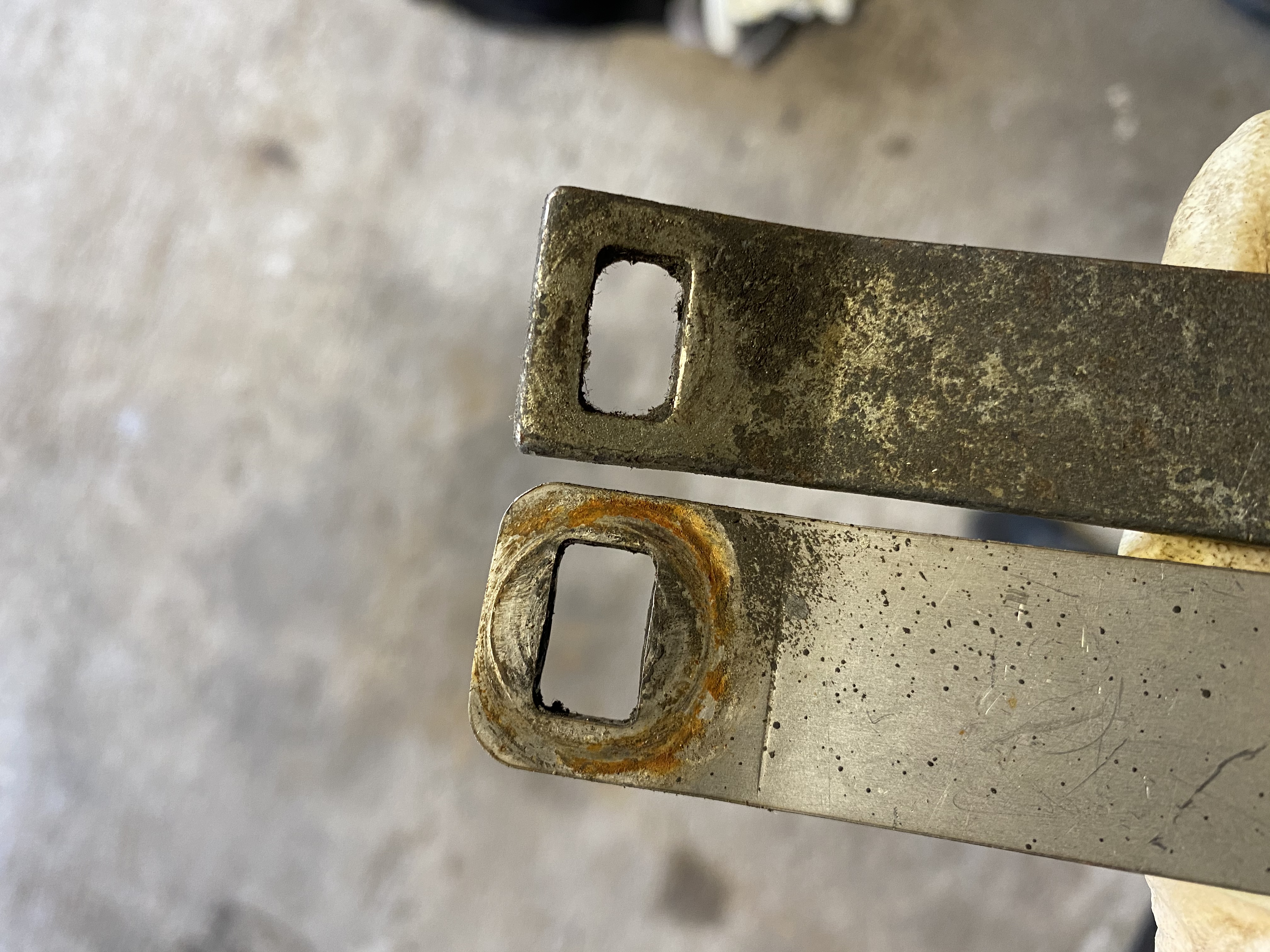

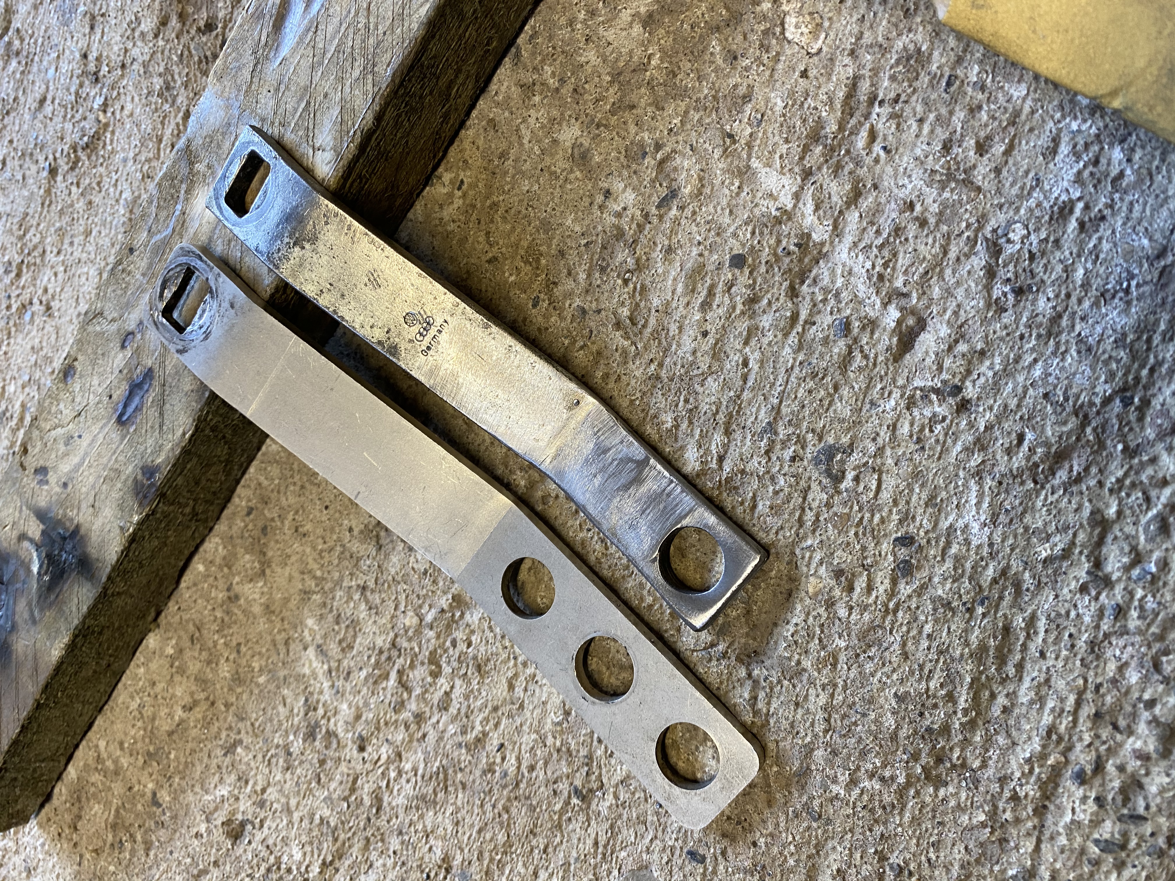

Stripped all the linkages down once I got back and found that the nut holding the aftermarket short shifter on was loose.
Aftermarket on the left, Genuine VW on the right
You might be able to just make out, but the ali short shifter has worn over time, the slot the relay shaft sits in has elongated and the metal deformed with it being so soft.
To overcome this and ensure no issues in the future, I decided to extend the original VW item, which is made of much stronger stuff.
choppy choppy
Buzzy buzzy
Grindy grindy
Happy with that.

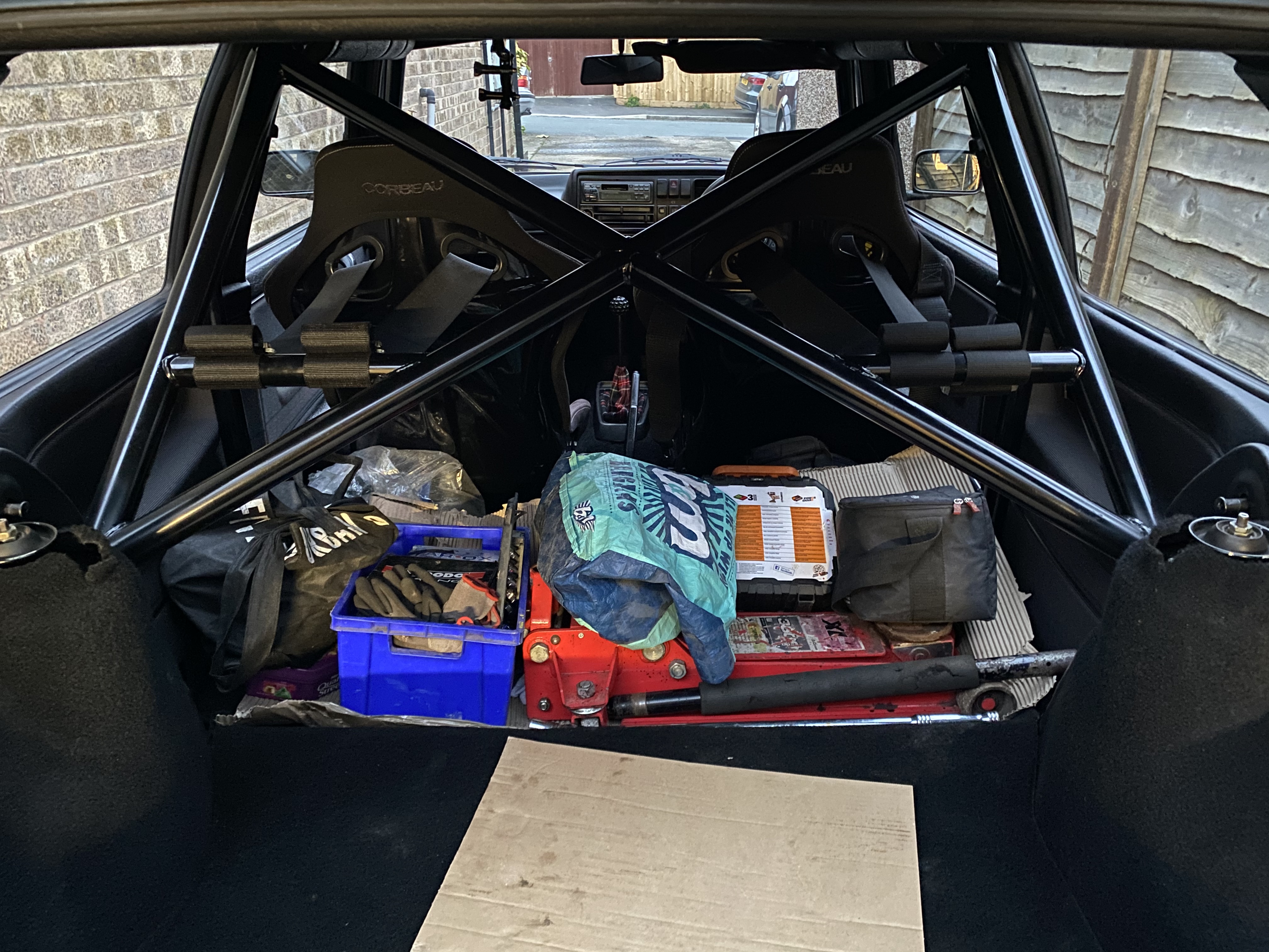

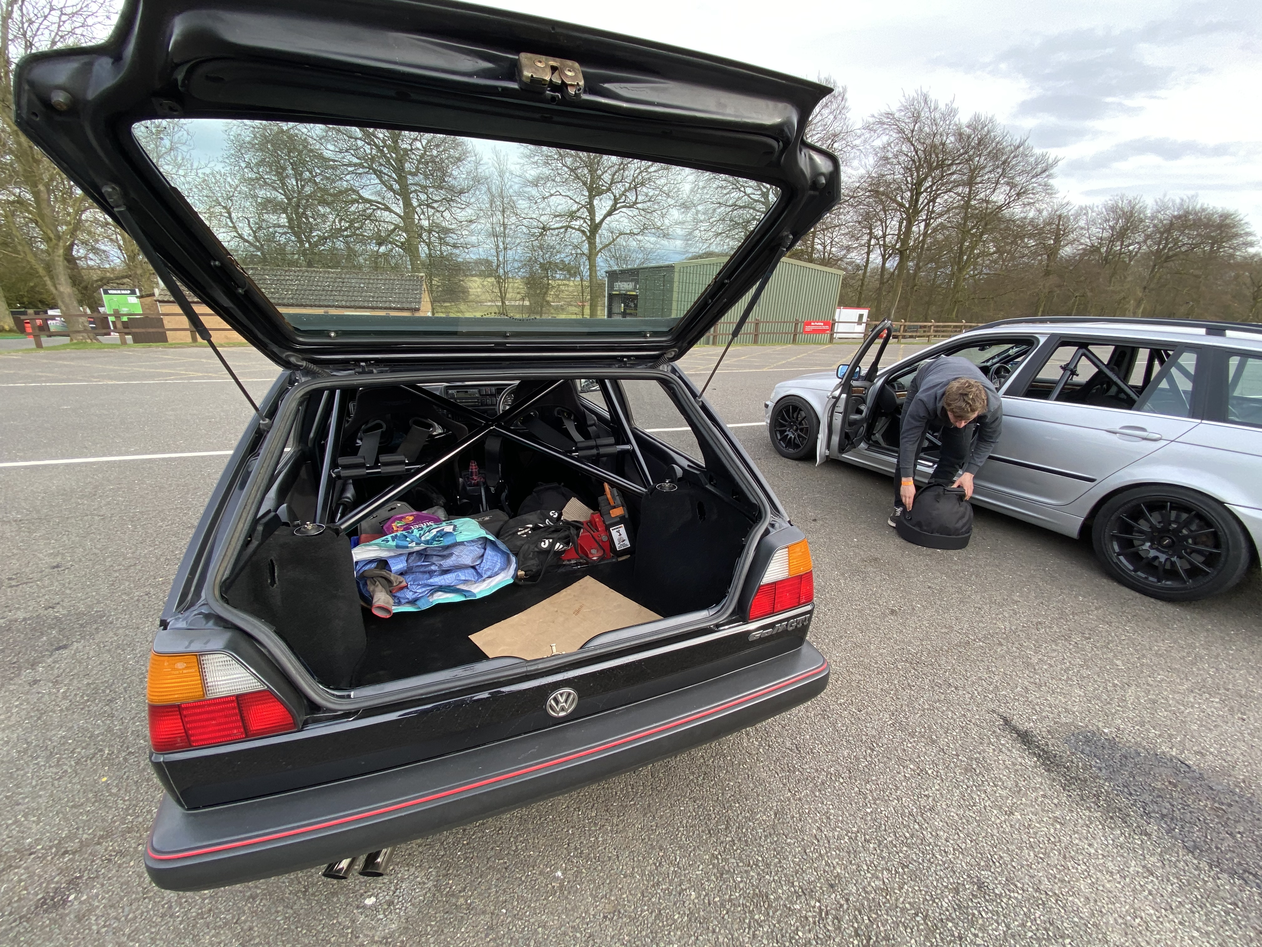

Got the car loaded up ready for the 2.5 hour drive to Cadwell. I went down with my pal with his e46 330i touring and we has some great lapping together.
I always pack heavy, but I’d rather that than be stuck and not have spares/correct tools with me and waste track time. – This trip that decision paid off!

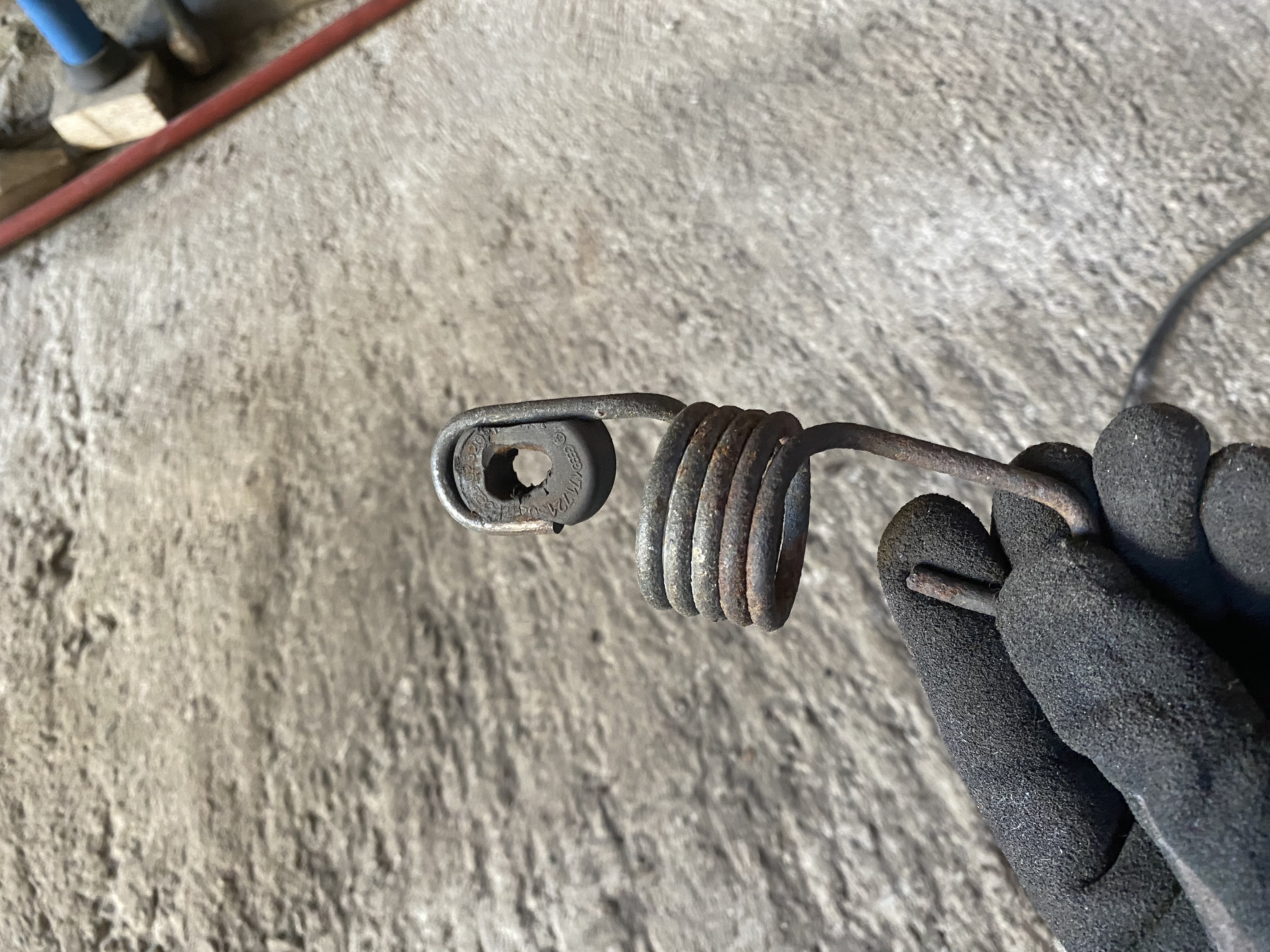

After having some tail happy moments in the wet at Blyton, caused by the rear brakes locking up, I didn’t have time to order a manual bias valve before Cadwell. With this track being dry it wasn’t so much of an issue, or so I thought. Brooke told me I was locking a rear wheel before almost every corner – unbeknownst to me.
I had read on an old CGTI thread that Gurds had suggested removing the rear bias spring in the compensator valve. So at lunch time I gave that a go.
After lunch the difference was quite unbelievable, no locking from the rear at all and a new confidence on the brakes. It really did feel like I’d fitted bigger brakes on the front, so I’m pretty chuffed with that, the spring is staying off.

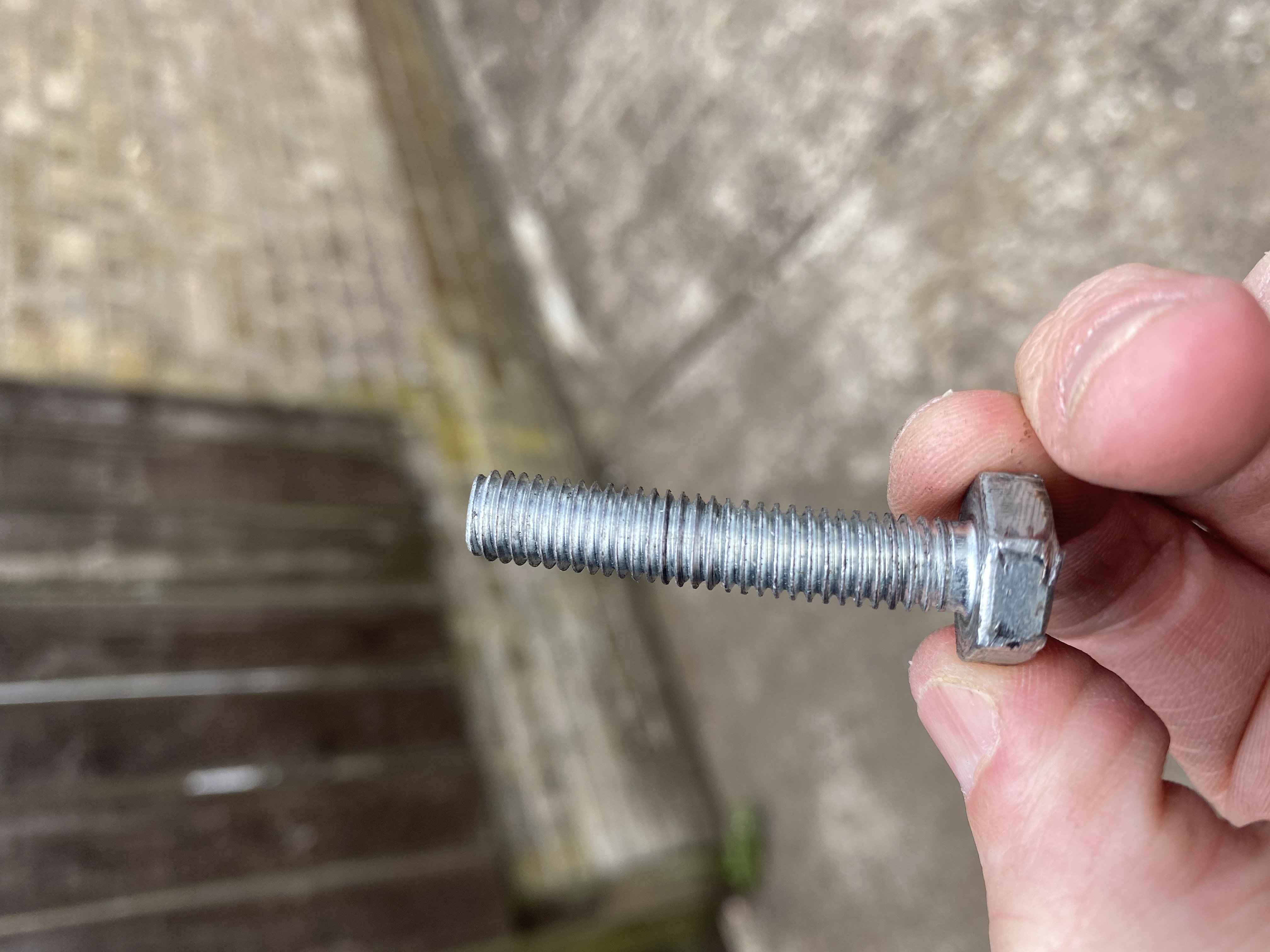

A quick rummage through a quality street tub full of random nuts and bolts I took with me, I found another bolt. It was too long but I put a flanged nut down the bolt first to effectively shorten it. That coupled with some high temp sealant and we were good to go! Stayed inplace and sealed all day. Result J! Its pays to take everything but the kitchen sink to a track day!

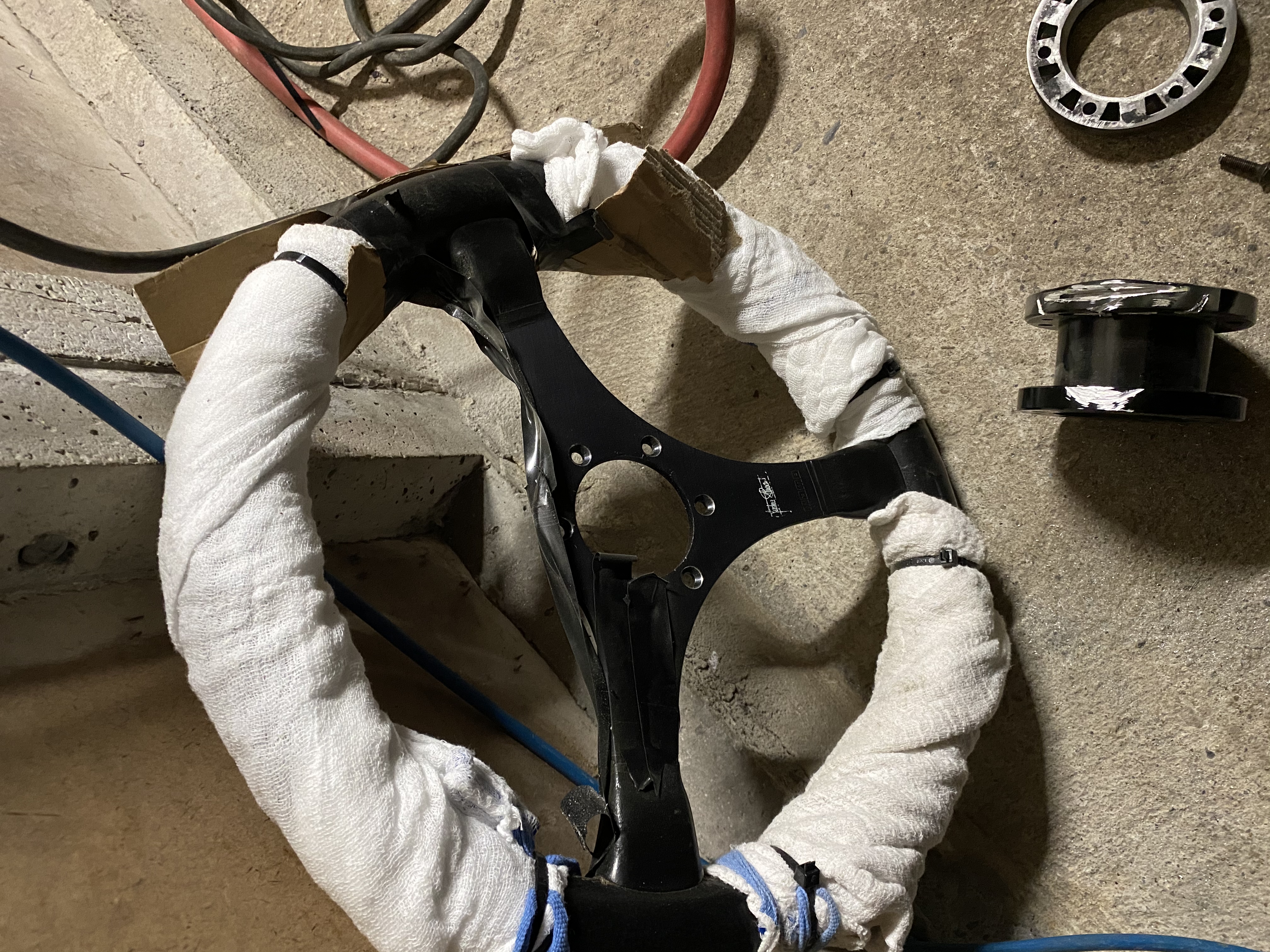

After Cadwell I wanted to change the seating position slightly. I still felt like my legs were too close and the wheel not close enough to me.

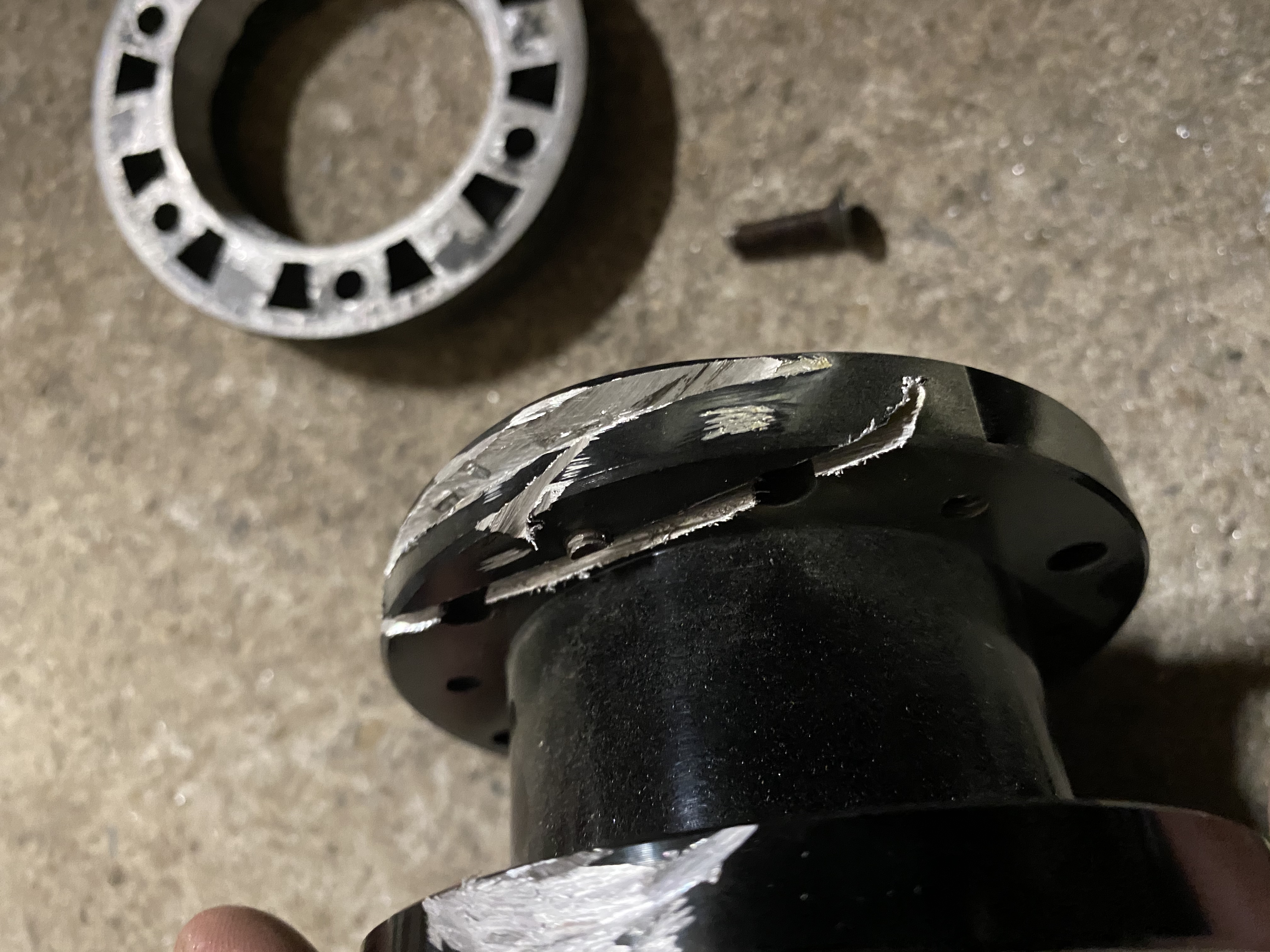

What I thought would be an easy job turned out to be a bit of a pain! 3 of the bolts holding the wheel on had rounded, and id snapped the ball end off an Allen key in one of them!
I tried making a cut with my Dremel to get it out with a screwdriver but couldn’t get deep enough without potentially damaging my wheel!
 Drastic action was needed!
Luckily it went smoothly!

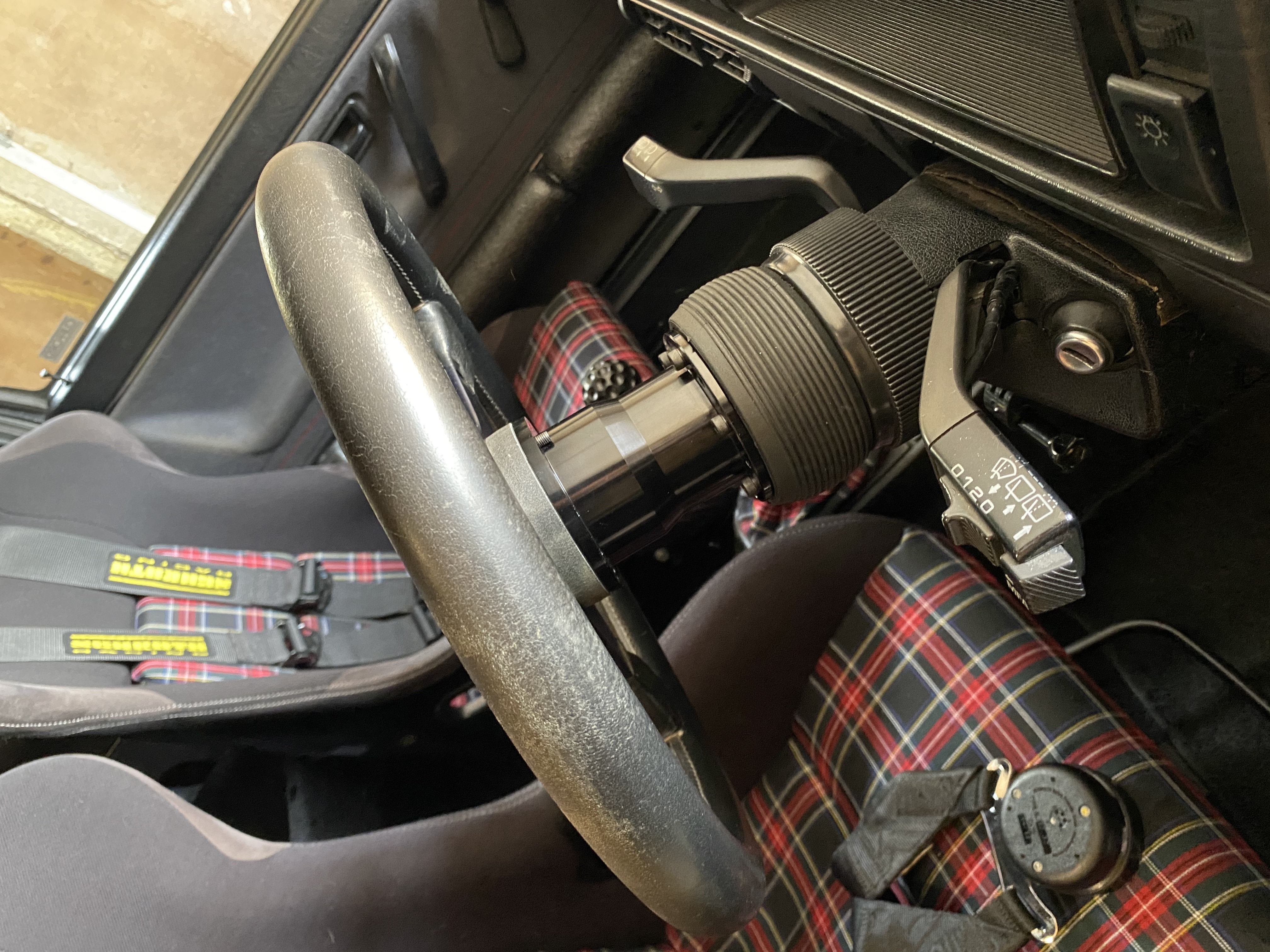

I’ve fitted a new spacer so the wheel sits 95mm further out than factory, herein lied another problem, I couldn’t see over the steering wheel!!
So I set about lowering the steering column some more. I went to Ripon Engineering to pick up some new m8 bolts because I’d found the old ones were only 4.4 grade and had bent! YIKES!
While I was there I found some m10 connectors, which I cut down to the right size and used as spacers for the column.
This has worked really well!
Its meant I’m another 2 clicks back on the seat rail and I can still see over the wheel, my wrist sits comfortably ontop of the wheel when I’m harnessed in and I can still reach the gearstick/control nicely.
Result :)

If you imagine, as you put more weight in your car, the rear axle will move up, putting the rear wheels into the wheel arch.
The spring is connected between the axle and the car body, as the axle moves, the spring puts more pressure on the bias valve and increases the flow to the rear brakes.
This is to help as in theory, if you have more weight in the back, you'll need more braking there.
However, if you have lowered the car, it'll also think you have loads of weight and over brake the rear.
You don't usually notice this unless your car is particularly low, or as in Mr Copes case, you're driving right on the limit.

Well explained Monkey! Even though Id bled the brakes with the compensator fully clamped and adjusted the spring there was nothing else I could do, there was just too much braking on the rear. I use a Tarox strada rear pad, which gives the same bite as an OE factory pad but they can cope with alot more heat. So I dont have the option of using a lesser pad.
Removing the spring has made a real difference! I was contemplating a manual bias valve, but i really dont think I need one.
