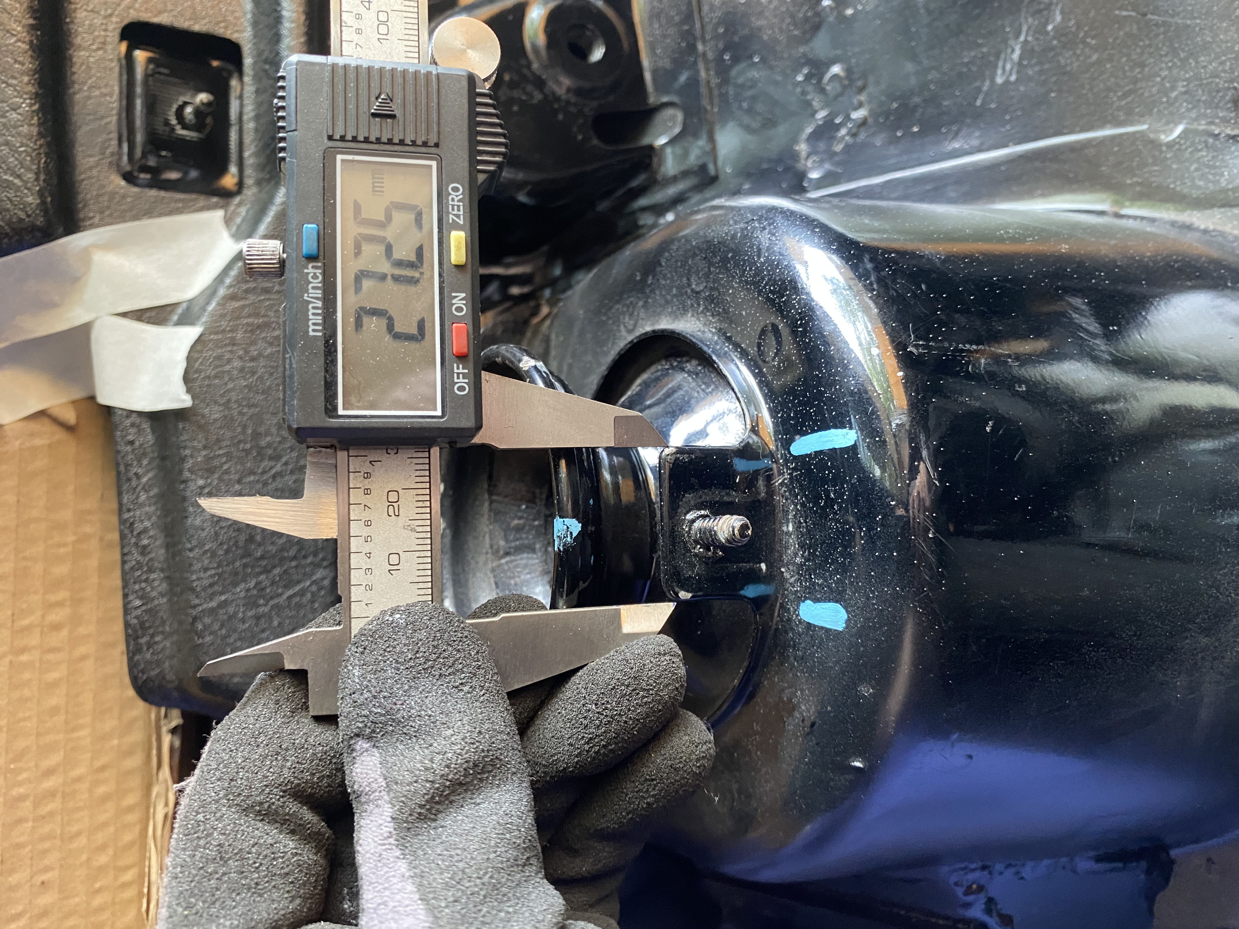

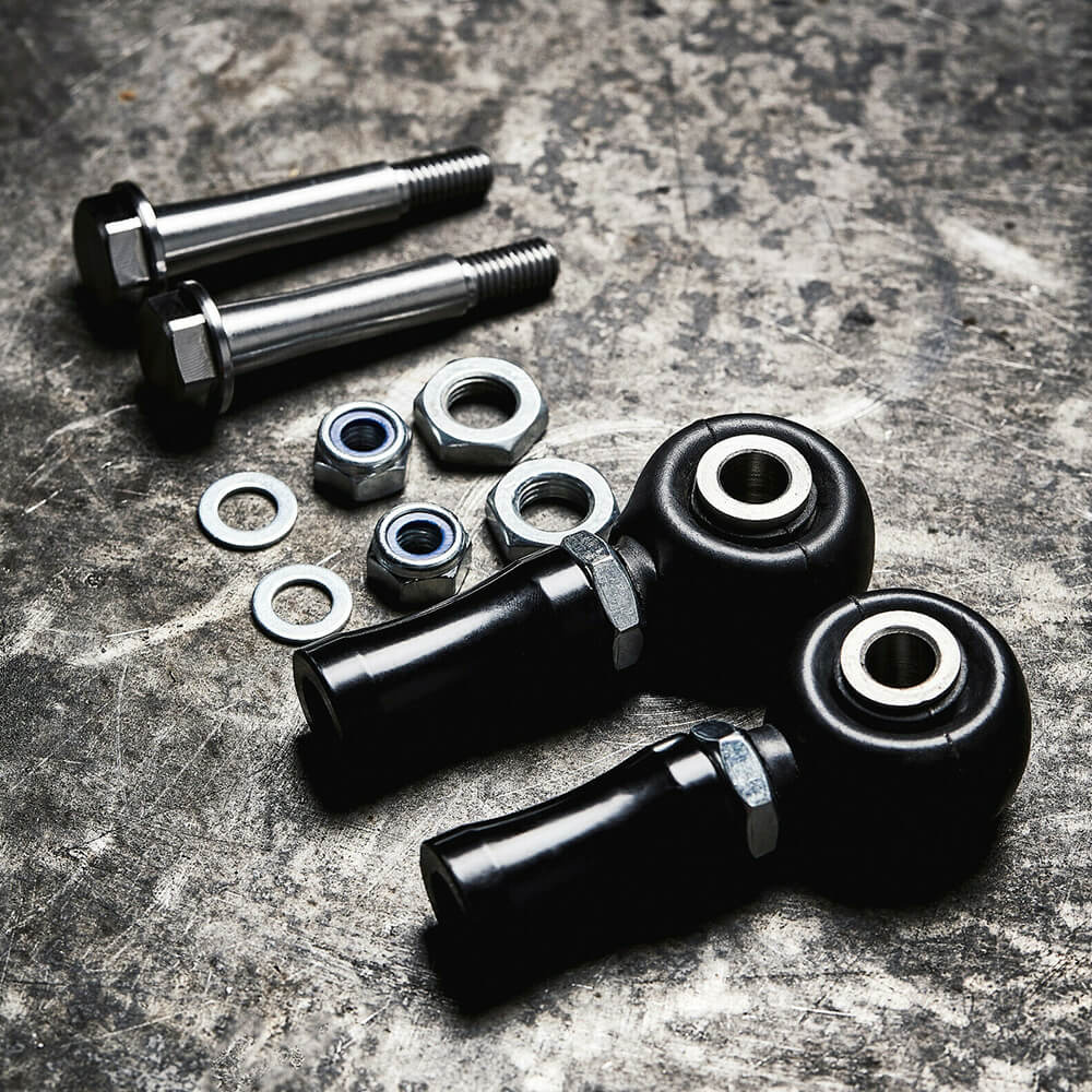

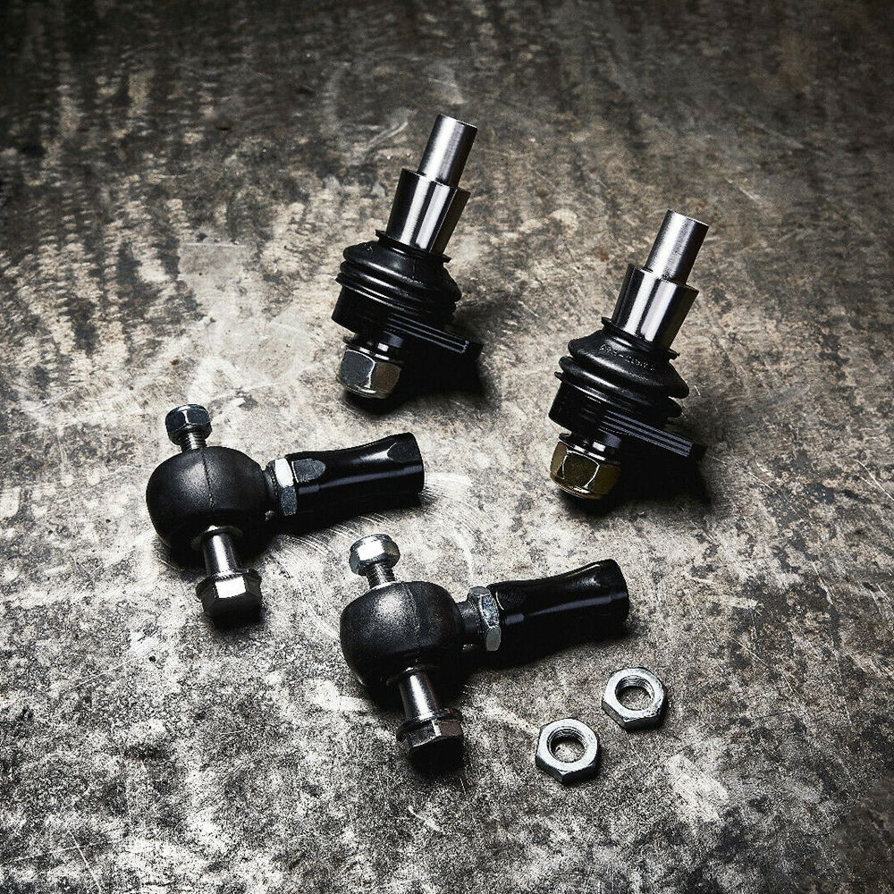

First off I've ordered a set of extended ball joints and rose jointed rod ends from Noath Engineering. I'm still waiting for them to arrive, but hoping to have them in before Oulton
Before fitting im going to attempt to measuring the bump steer to work out what size spacers I need for the rod ends.

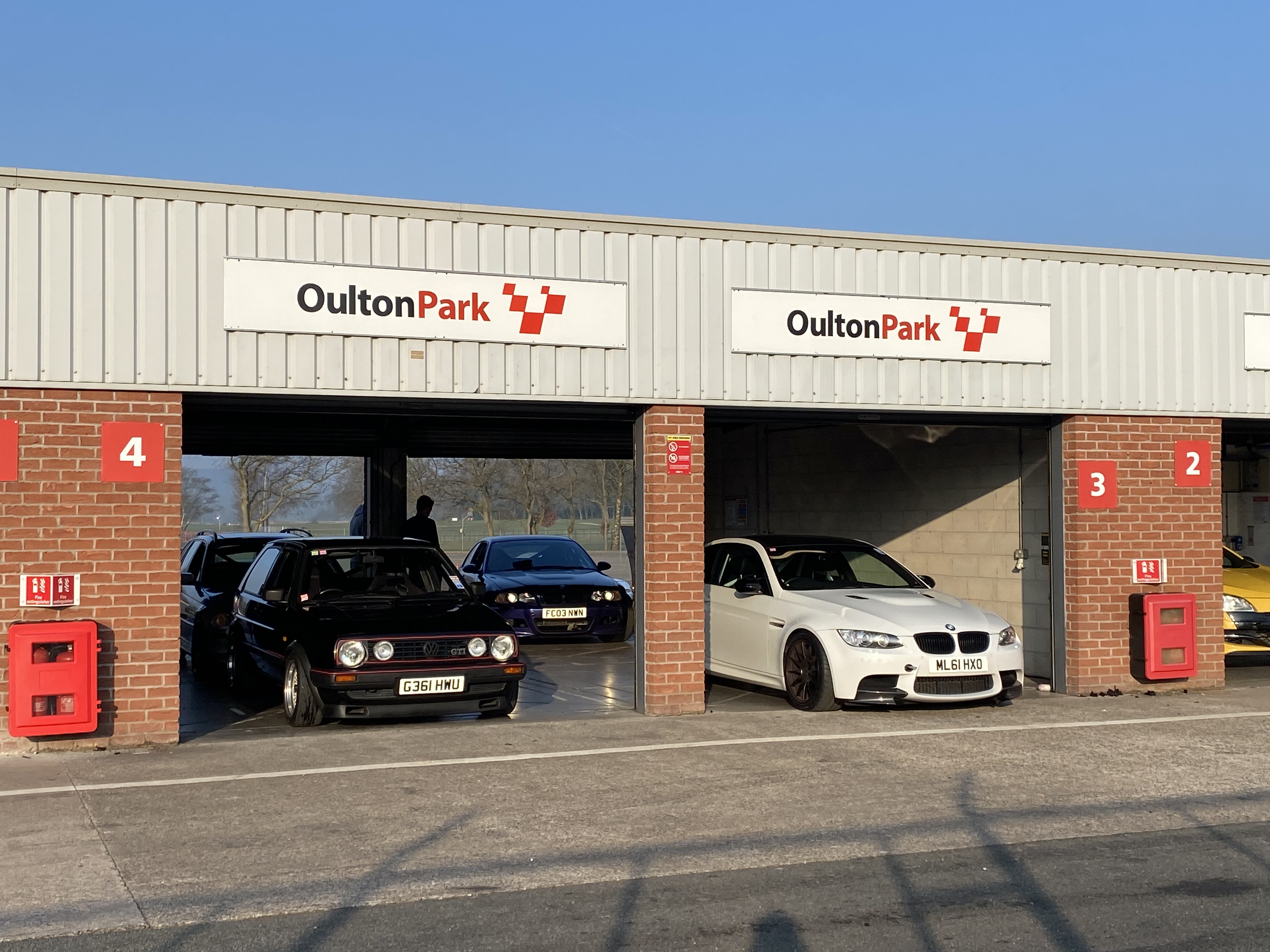

Oulton Park 2022
Oulton came around quick and I didn’t get time to check the car over as much as I’d like to.
Just did the basics, see if any of the paint pen on the bolts has moved, check brakes and fluids.

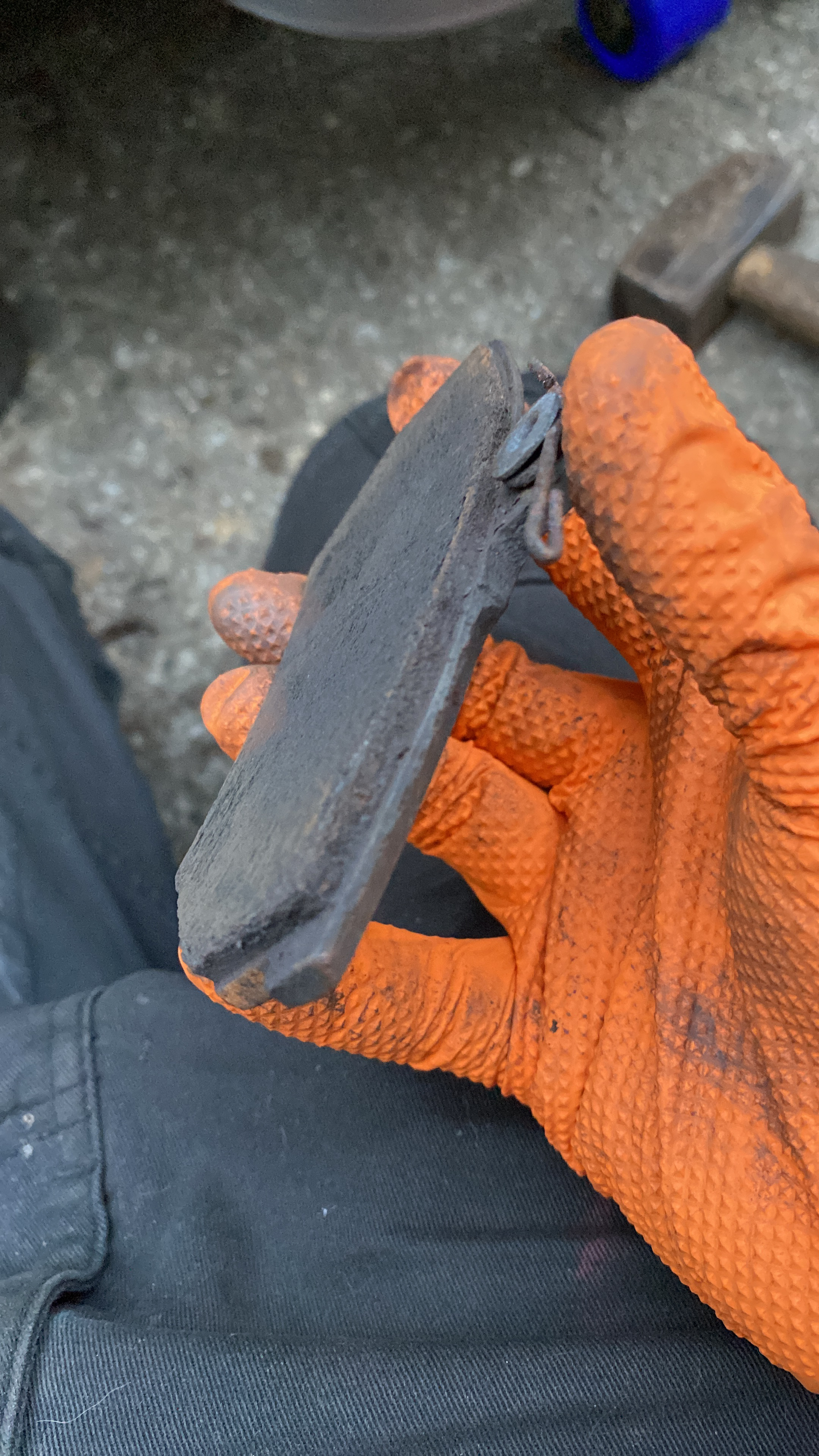

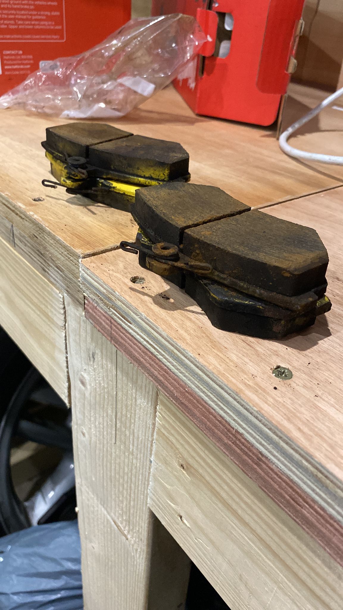

Unfortunately this was the state of the front pads
After a quick dash round it turned out my mate around the corner had a set of almost new Yellow Stuff that would get me by! What a hero! That pretty much saved my trackday.

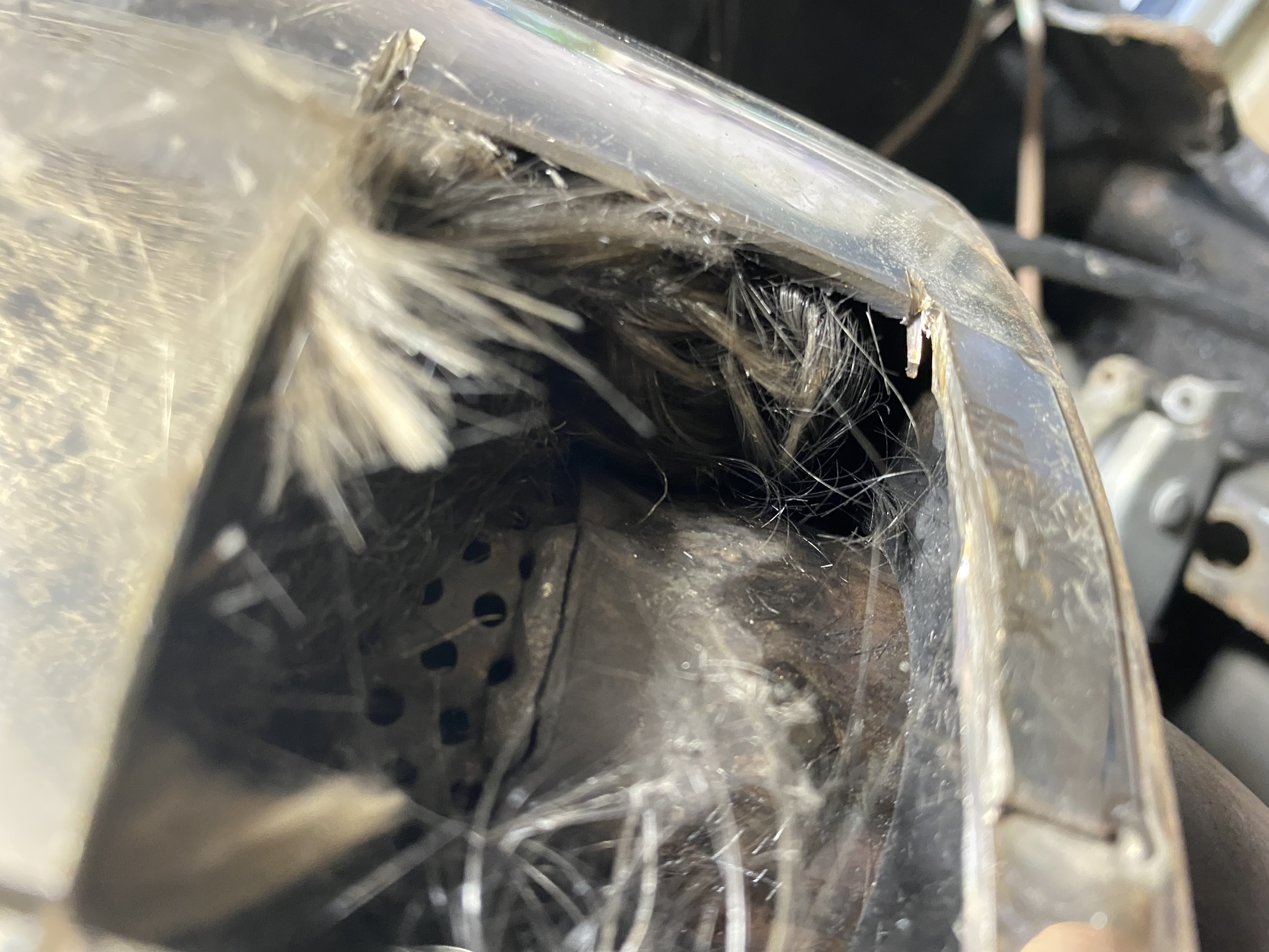

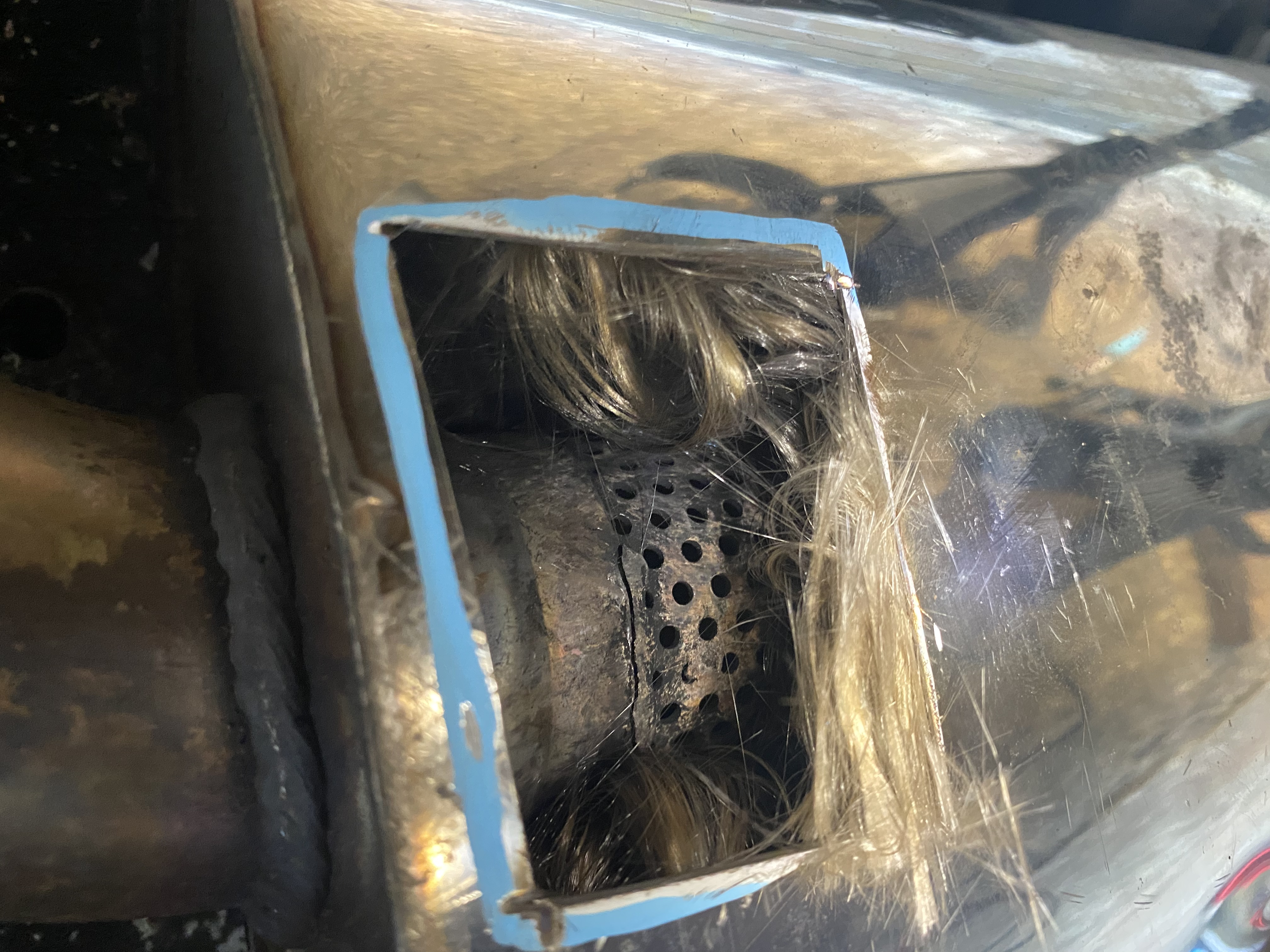

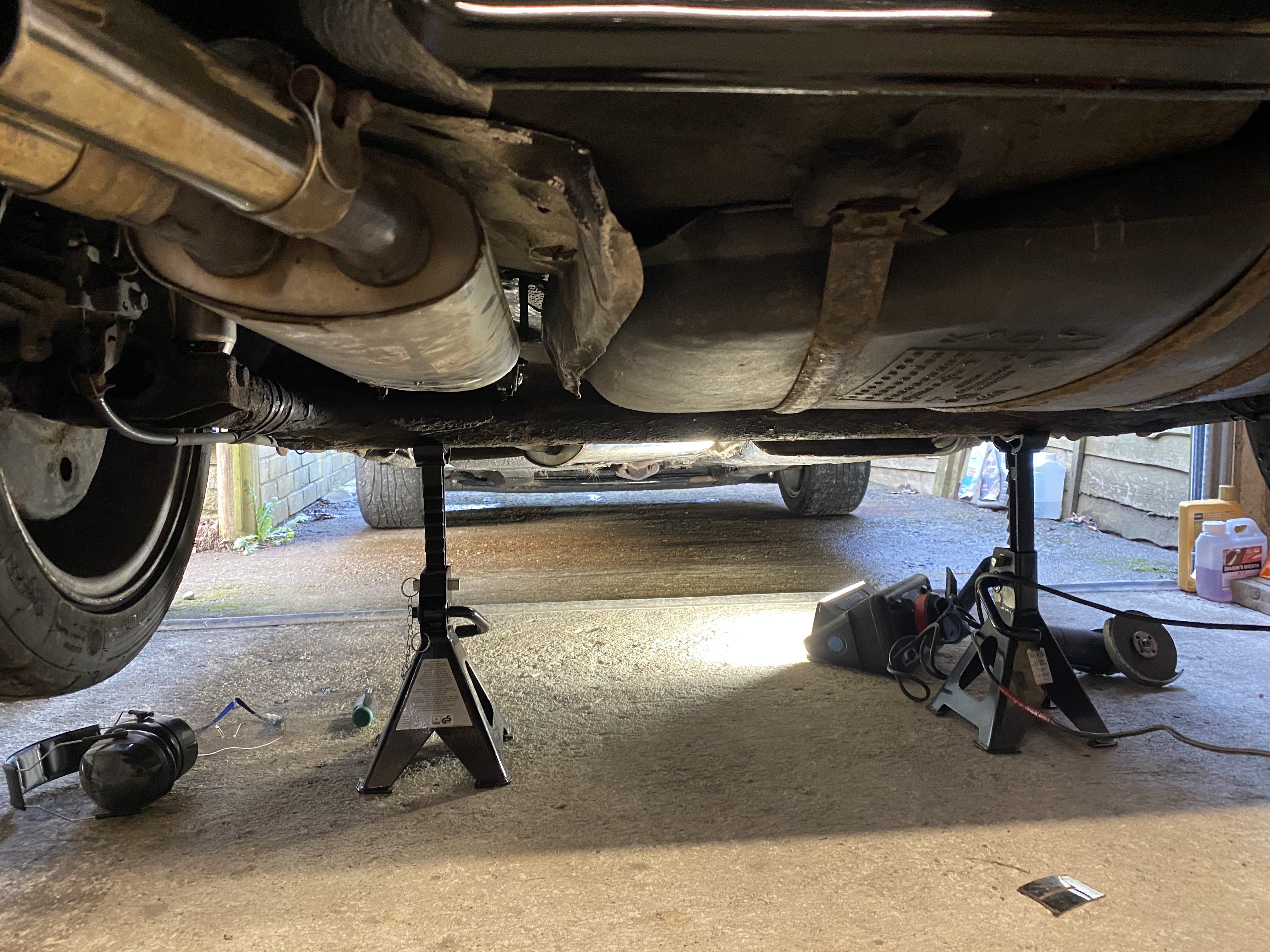

Got finished at around 8pm, started the car up to put it away in the garage and the exhaust sounded awful, something was loose.
After getting the car up on stands it was obvious that the Milltek had once again failed. There were 3 separate rattles, the only thing to do was cut the exhaust open and weld up whatever was loose. Not what I wanted to be doing the night before a track day!
I don’t know if you can make out in the pictures but the welds on baffles at both ends had cracked and caused the perforated tube to rattle around. Last time I emailed Milltek and they sent me a new box straight away, which was very good of them, so no complaints there.
With those all welded up, the boxes welded back up the car was purring nicely again.

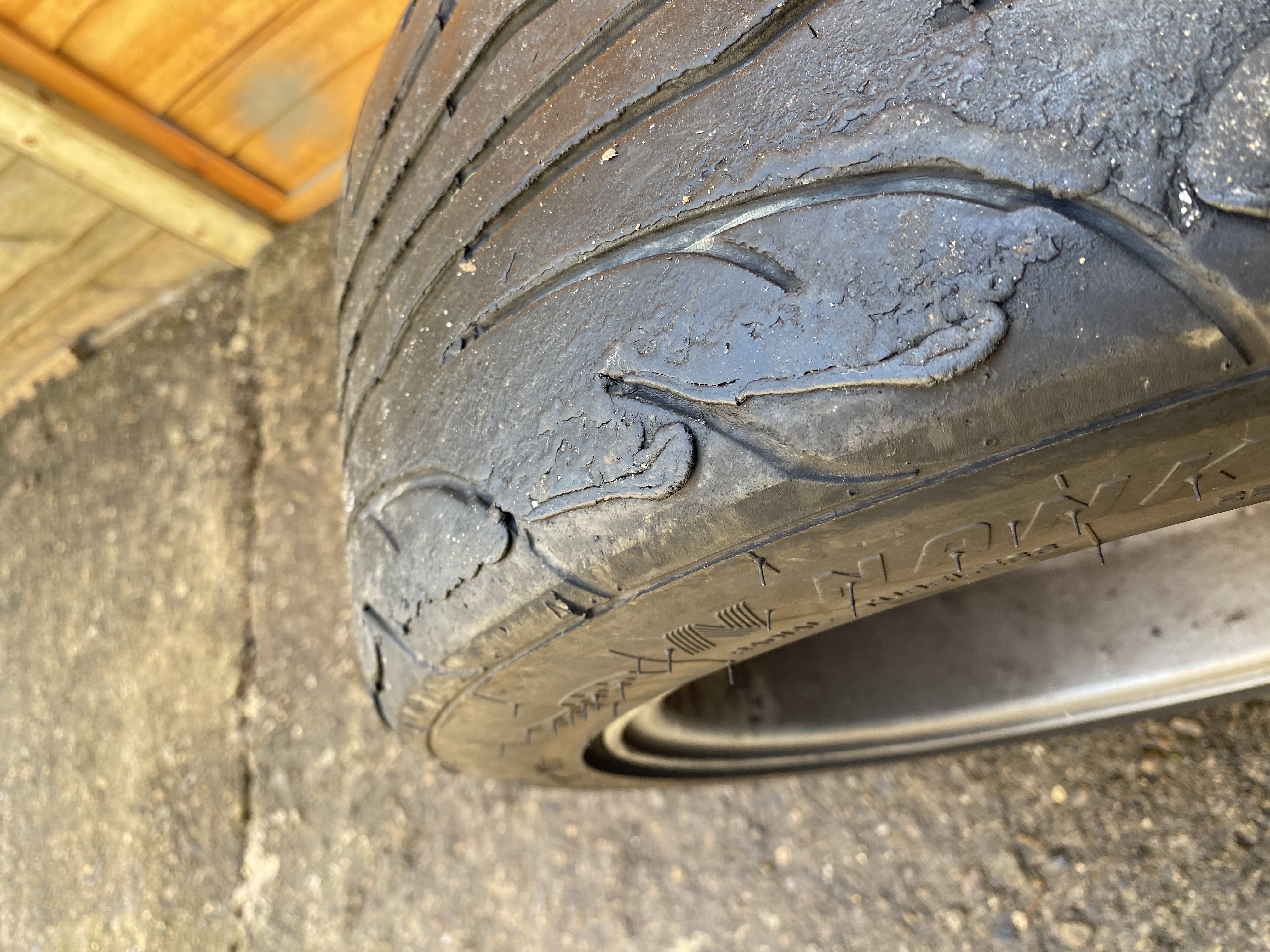

My tyres had seen better days after the trackday! these were rears.
I need to get some camber shims for the rear stub axle, After speaking with Nige and the lads at Cornering Force, we came to the conclusion that the I could do with -0.5 degrees more on the rear and go from there. :)

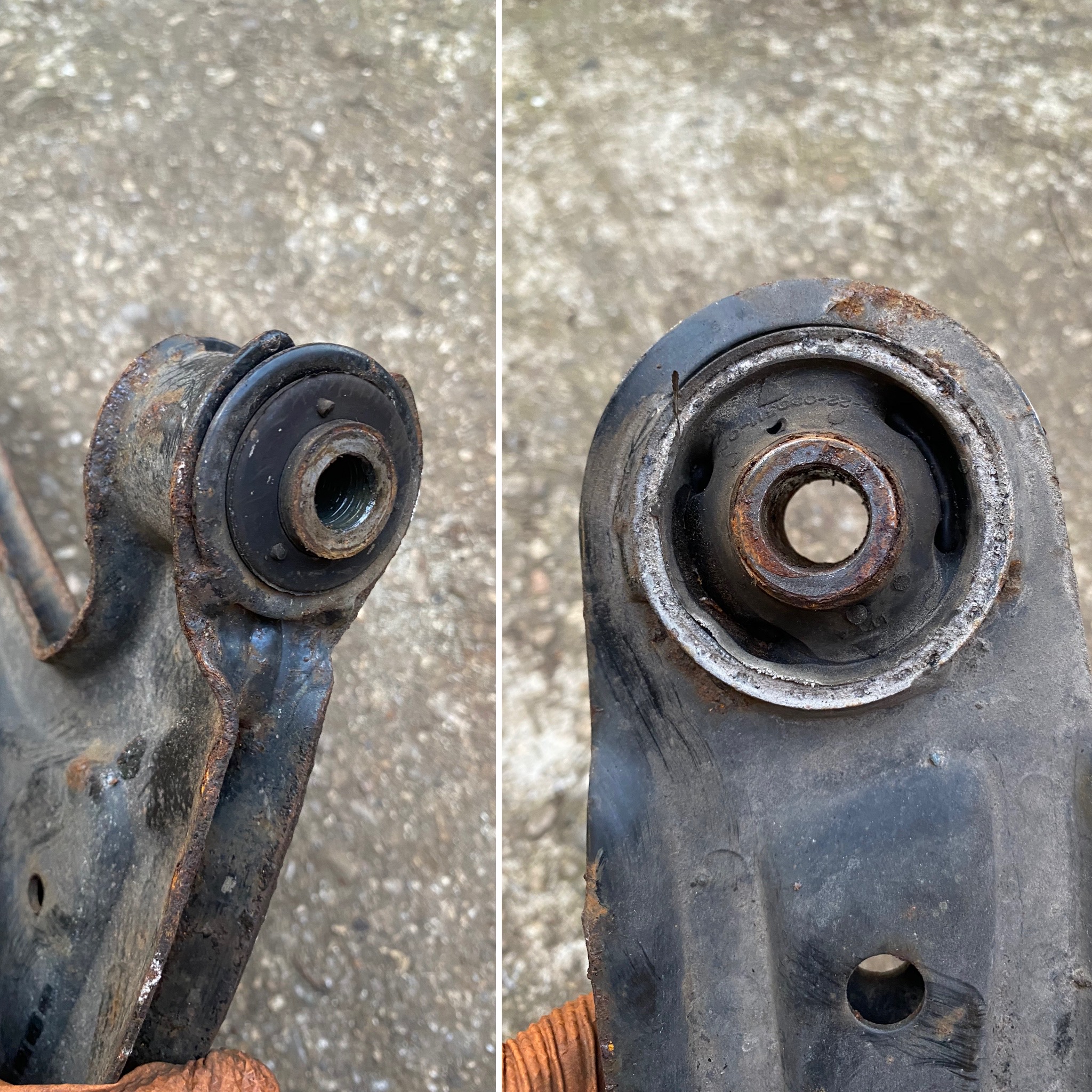

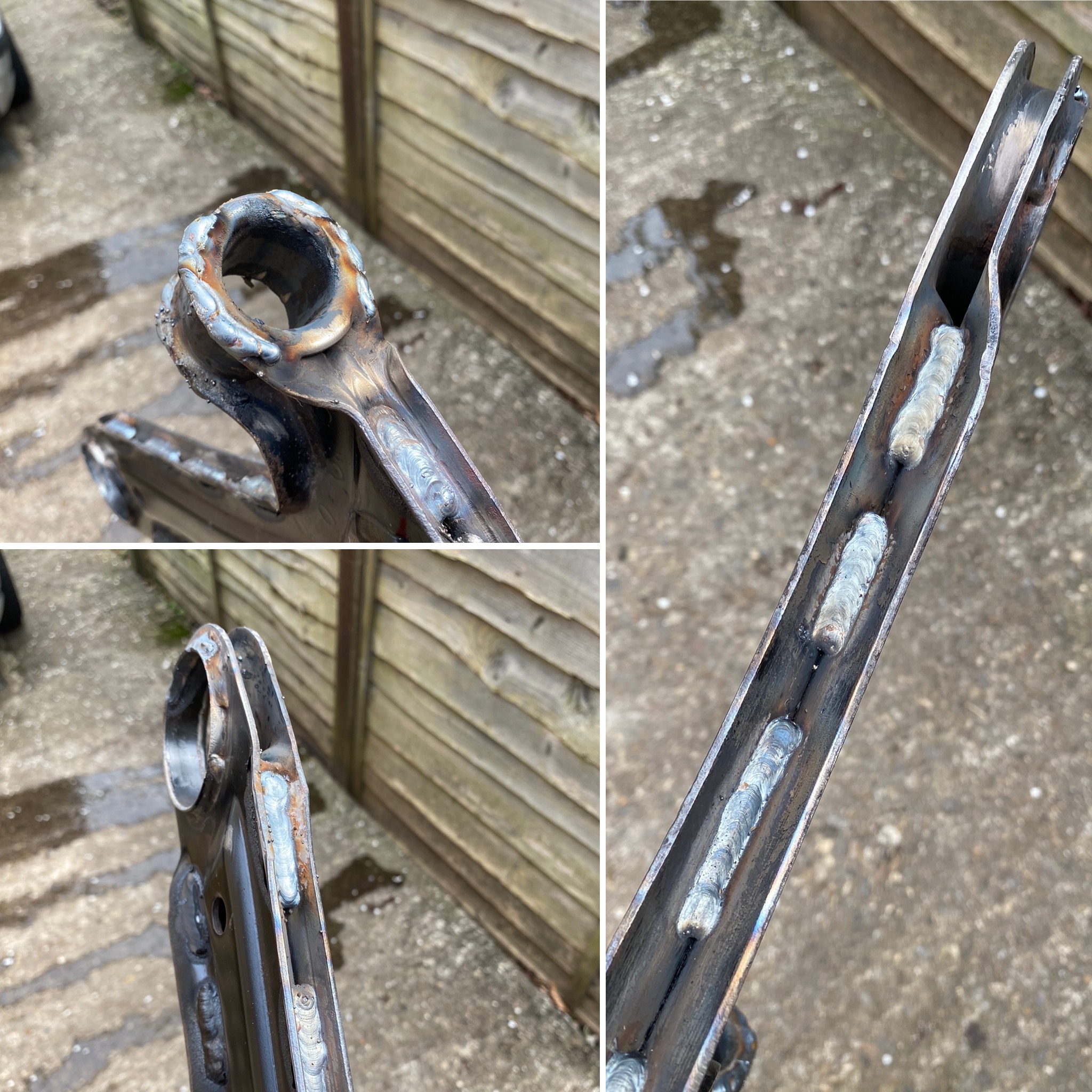

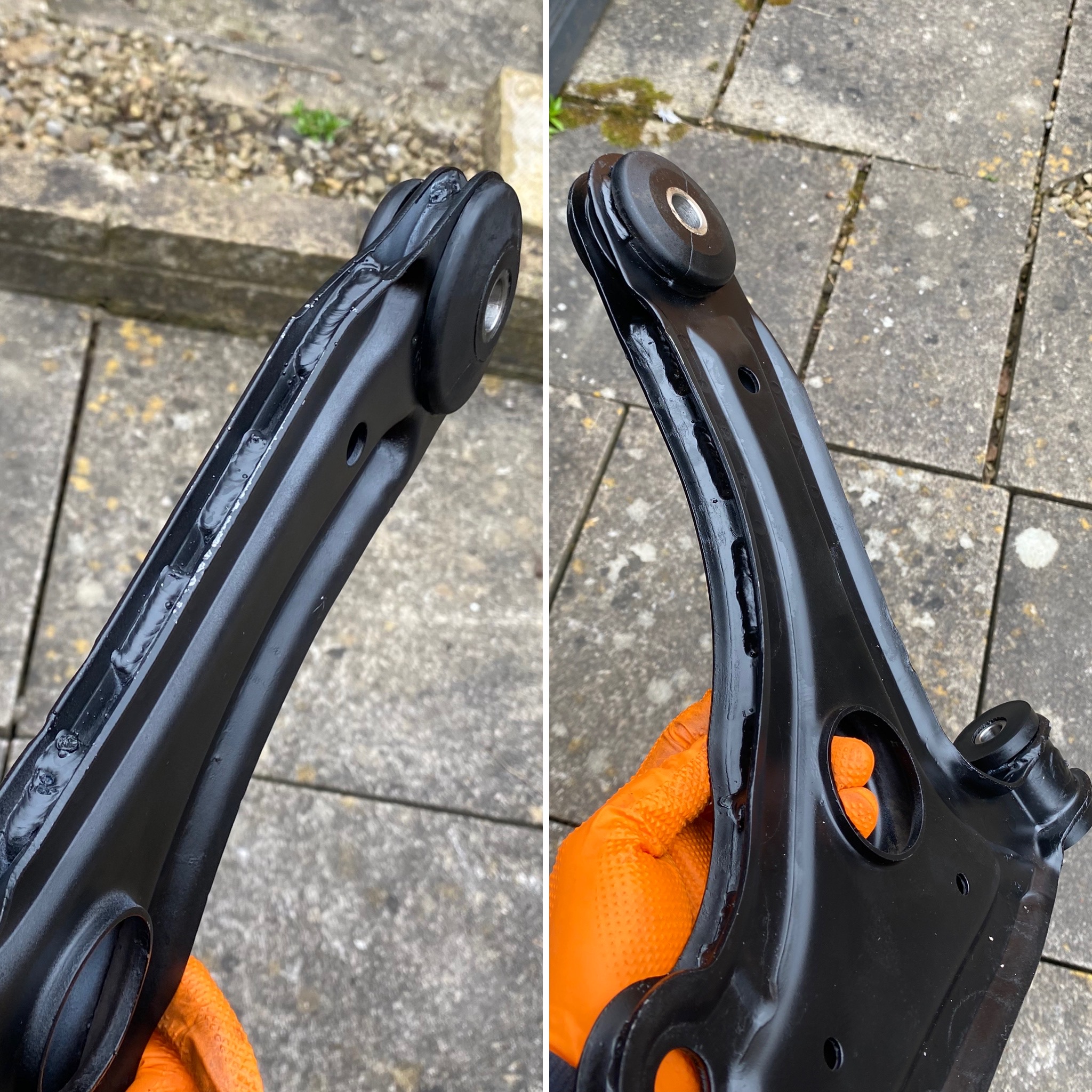

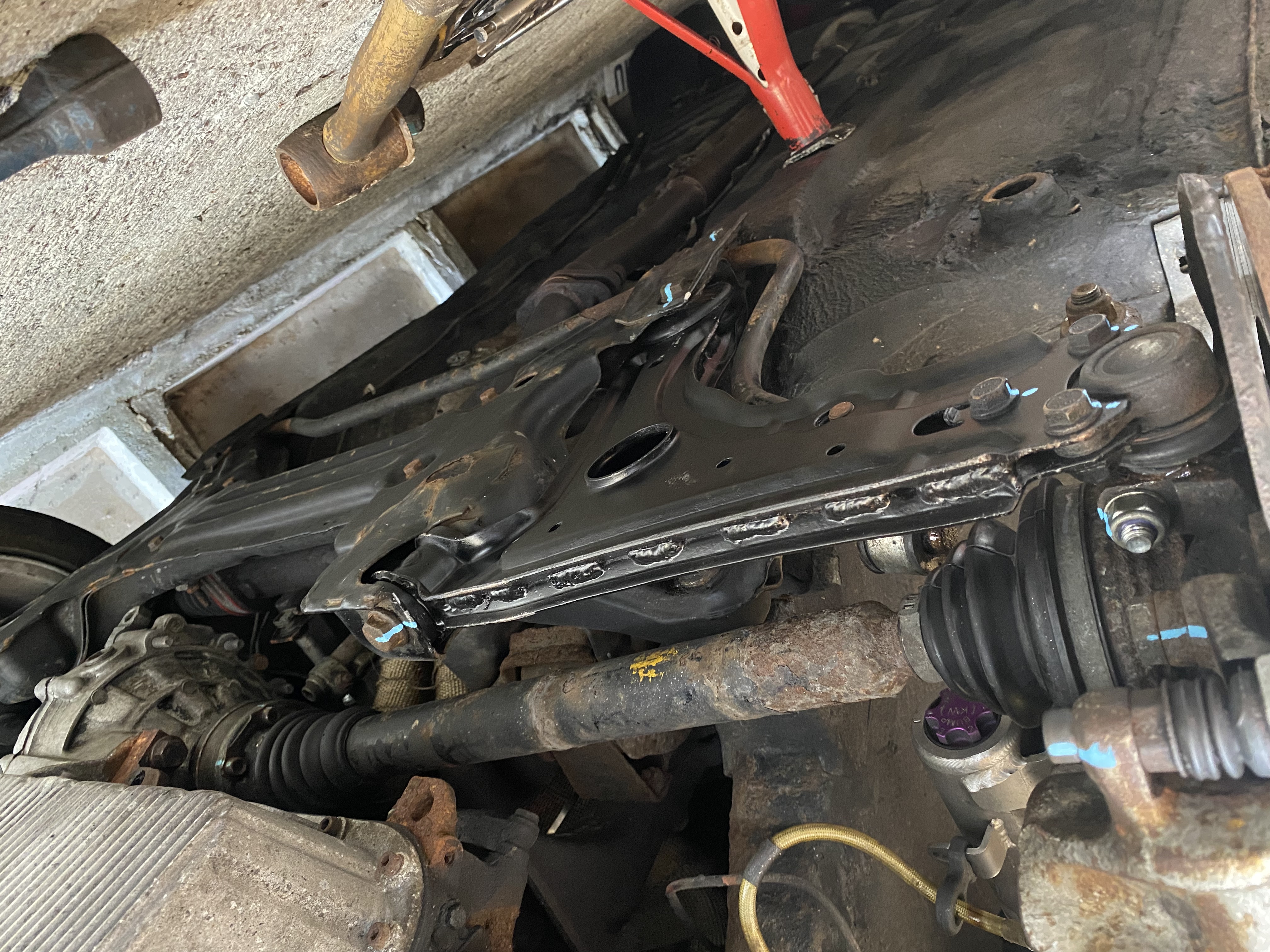

My first job to tackle was the wishbones, I’d replaced the original wishbones with Lemforder items about 5 years ago and not touched them since.
The original bushes were looking okay to be honest.
I decided on PowerFlex black series as I wanted to minimise any movement. I can confirm they are rock hard!
I cut/pressed the bushes out with some home made tools, and then set about welding up the wishbones. The wishbones are in 2 halves which are then spot welded, so this should help stiffen them up.
Painted up with the bushes in
Very happy with how they turned out.

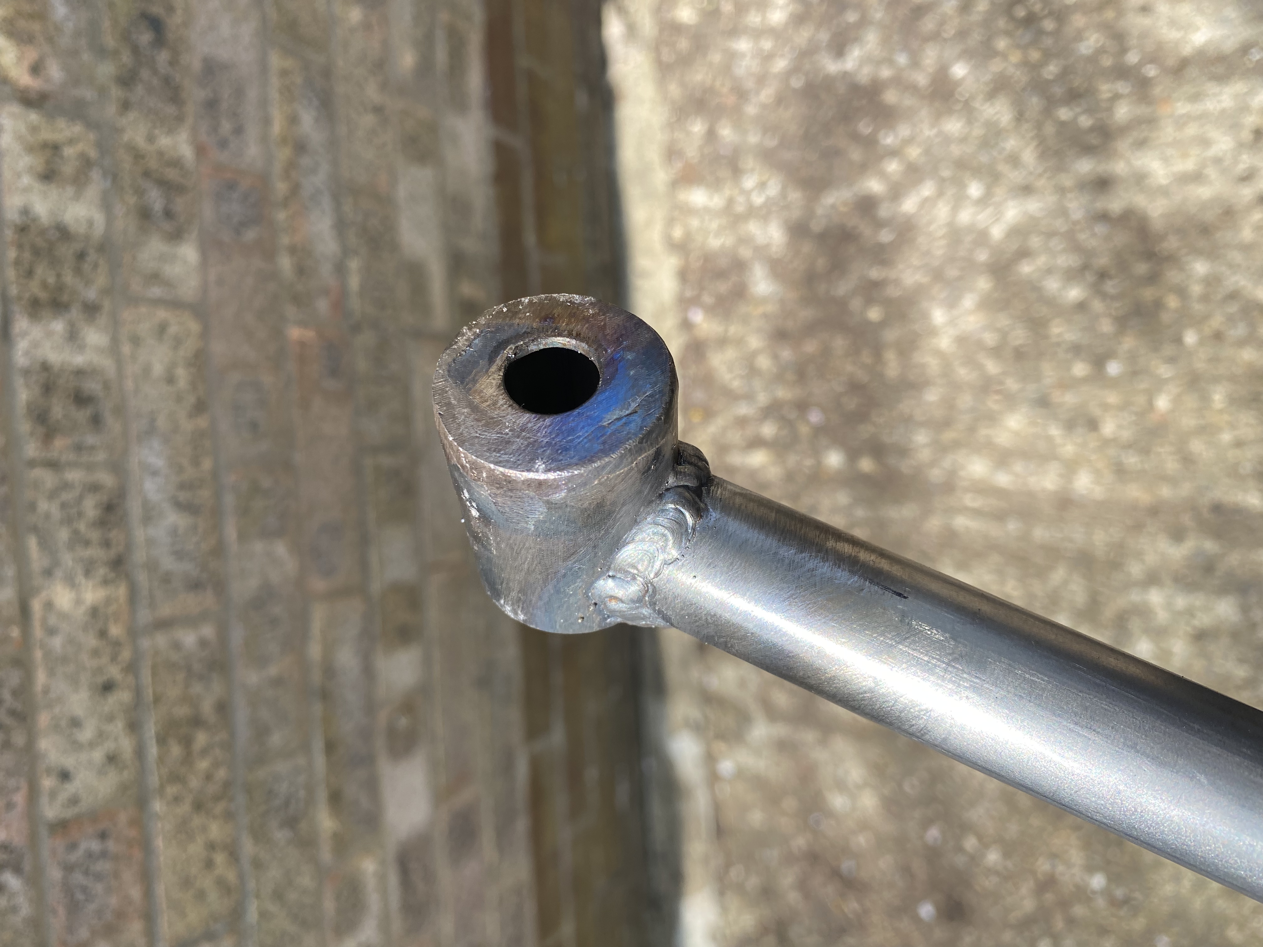

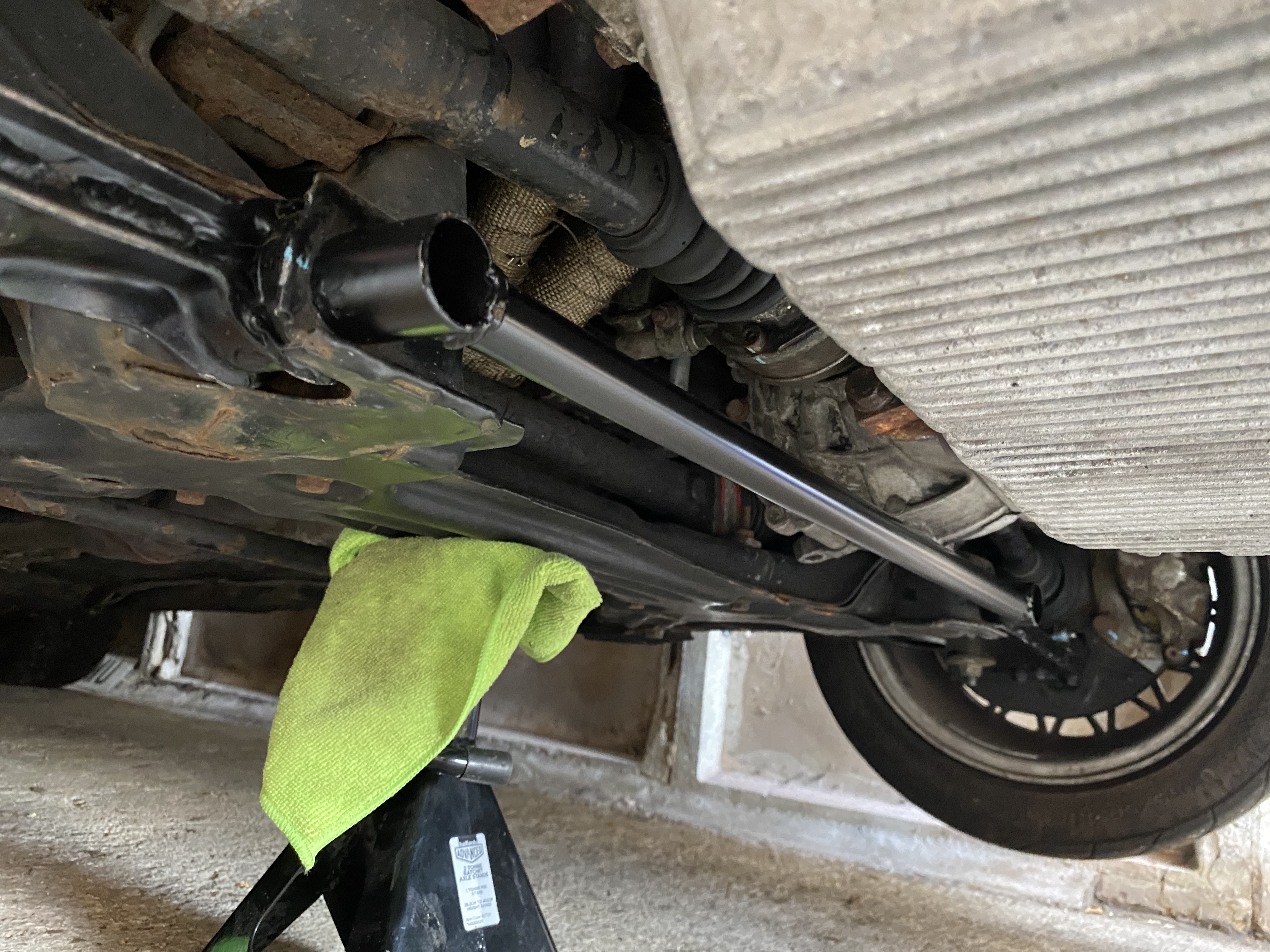

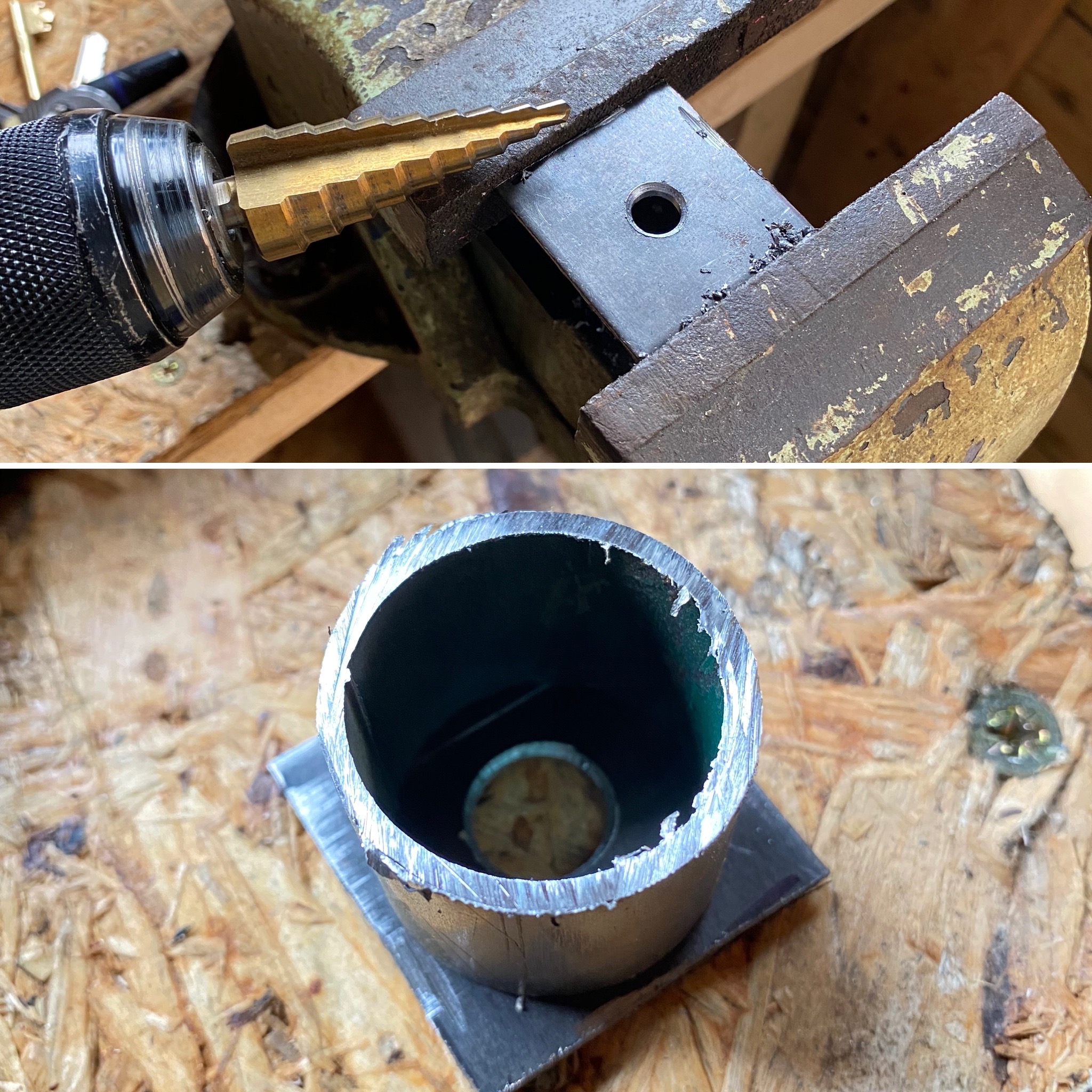

First up was a lower front brace to tie the two wishbones together. I’d seen these for sale online for around £80. After pricing up I could make one for 1/3 of that, so I ordered some metal and gave it a go.
Started by making the tube ends, these would be the parts where the bolts would pass through into the subframe.
I wanted to make sure I could still get a socket in, which I could but this meant the bar fouled the gearbox, so these were cut off and remade longer for the final version.
A tight fit to the gearbox, but doesn’t make contact when under load.
And after a coat of halfords finest satin black.

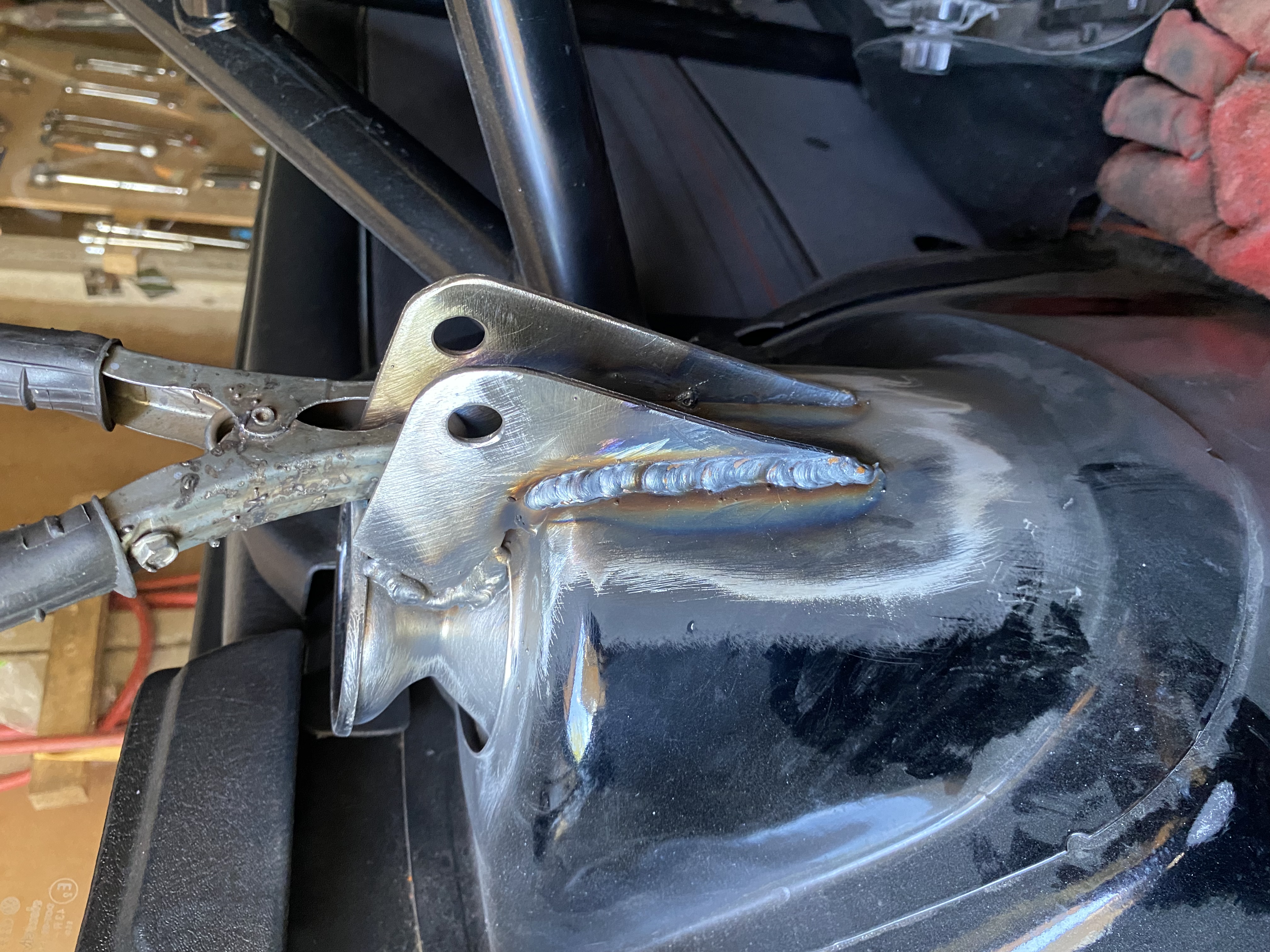

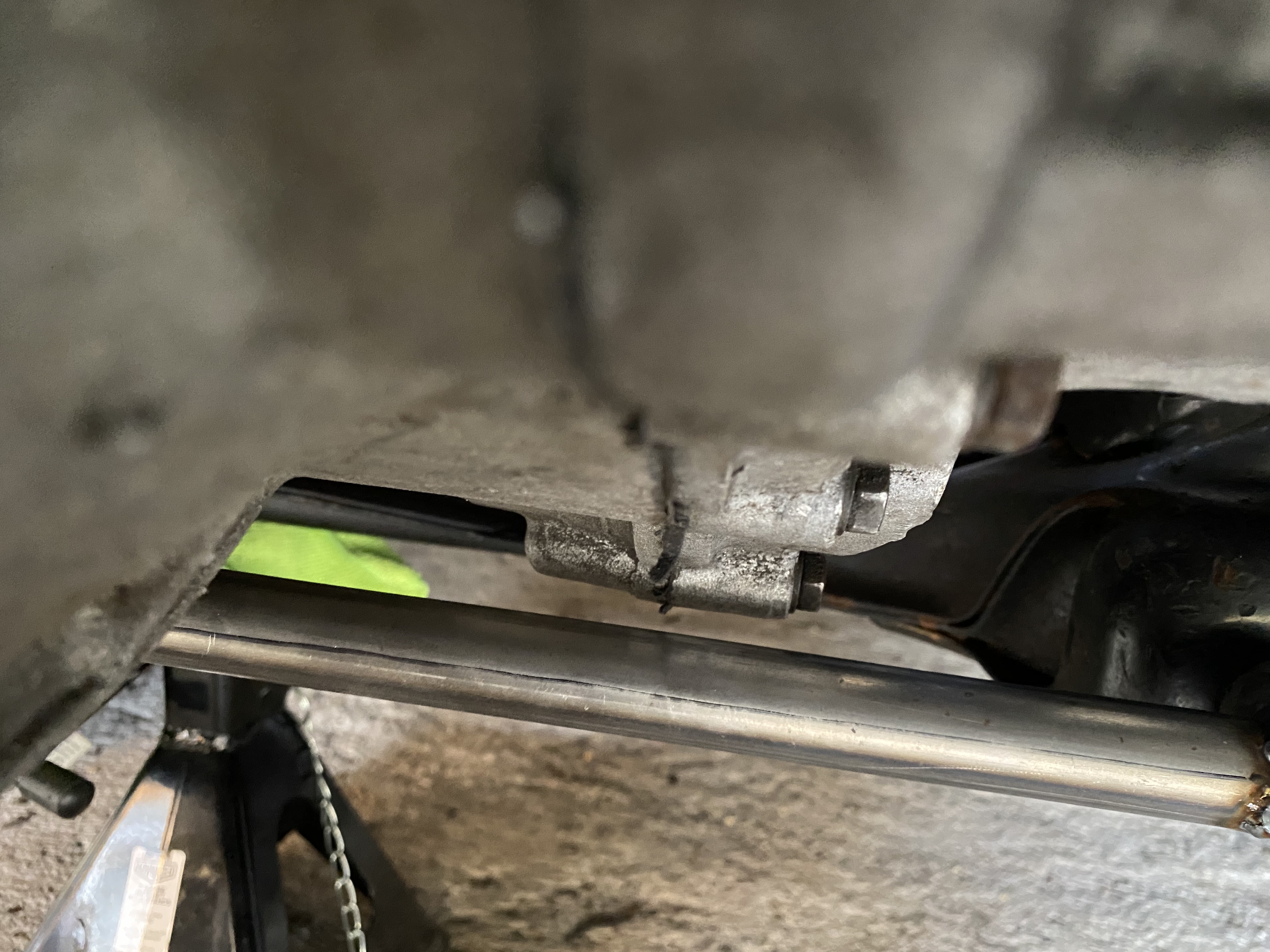

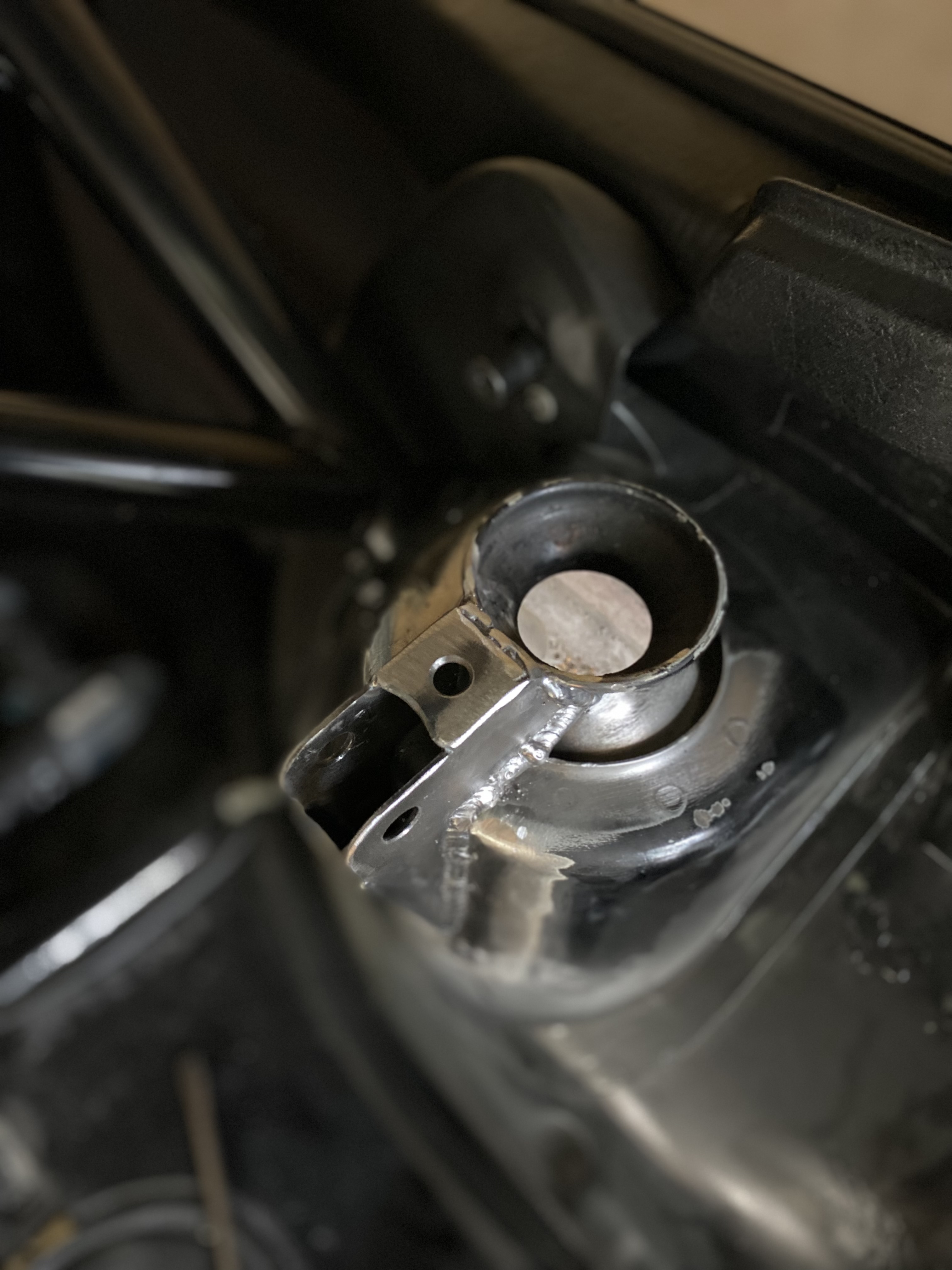

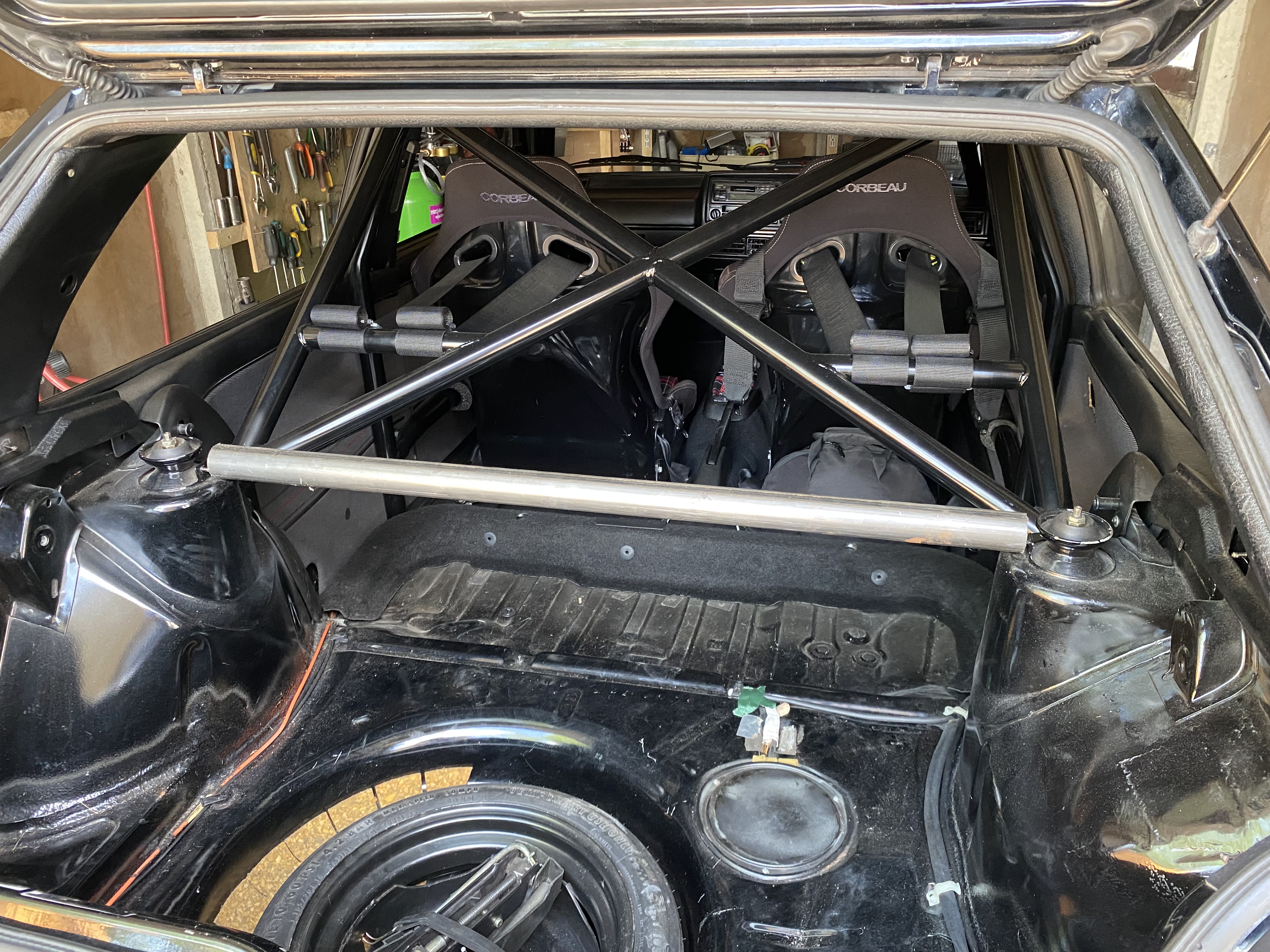

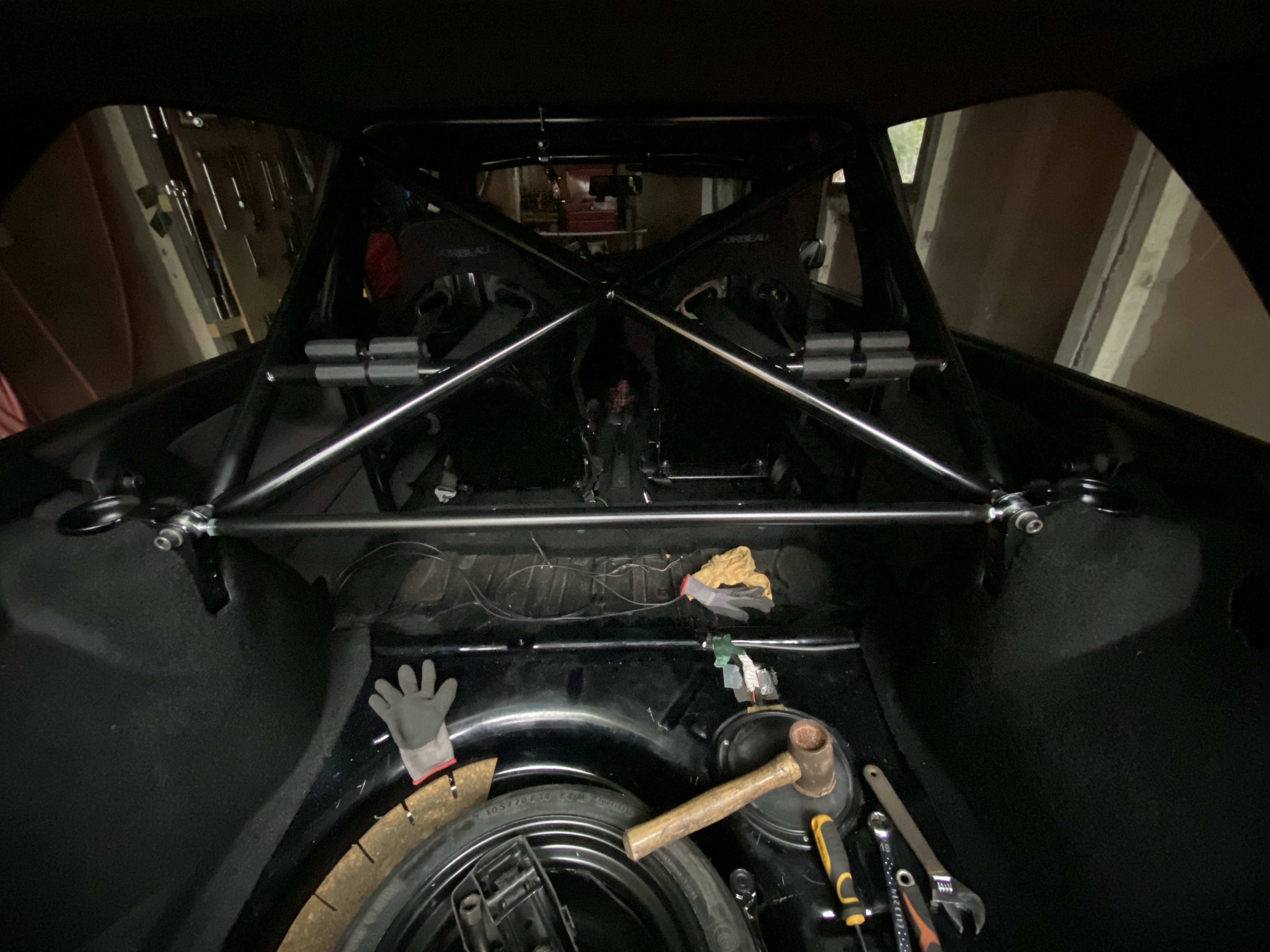

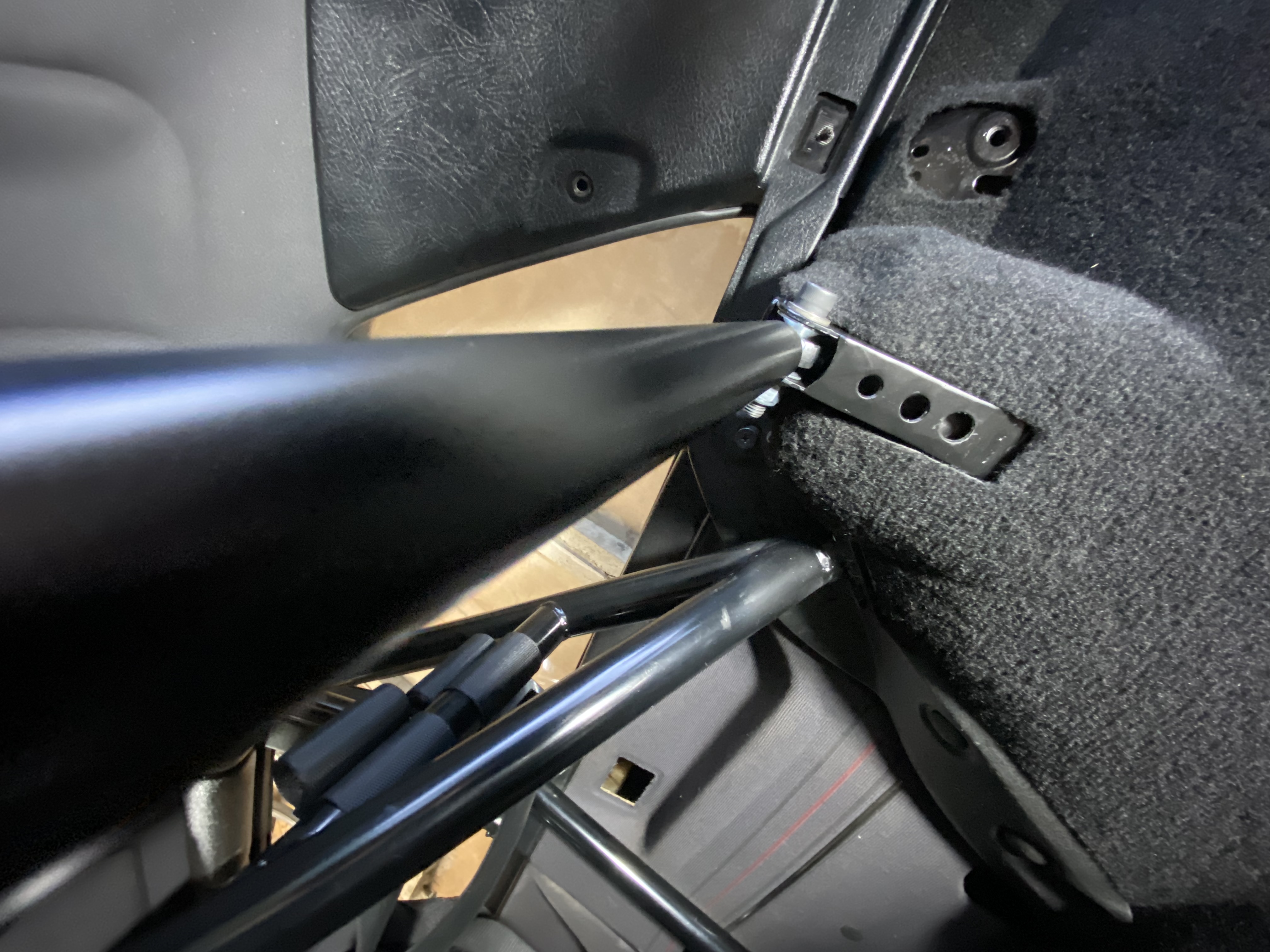

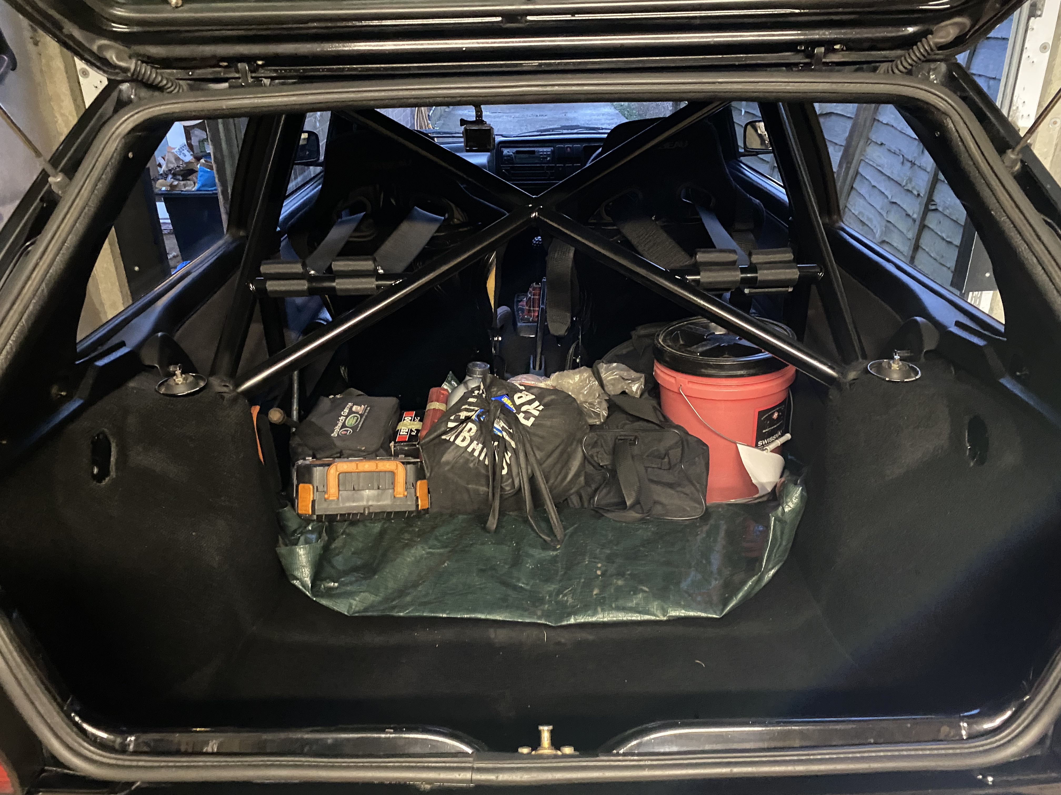

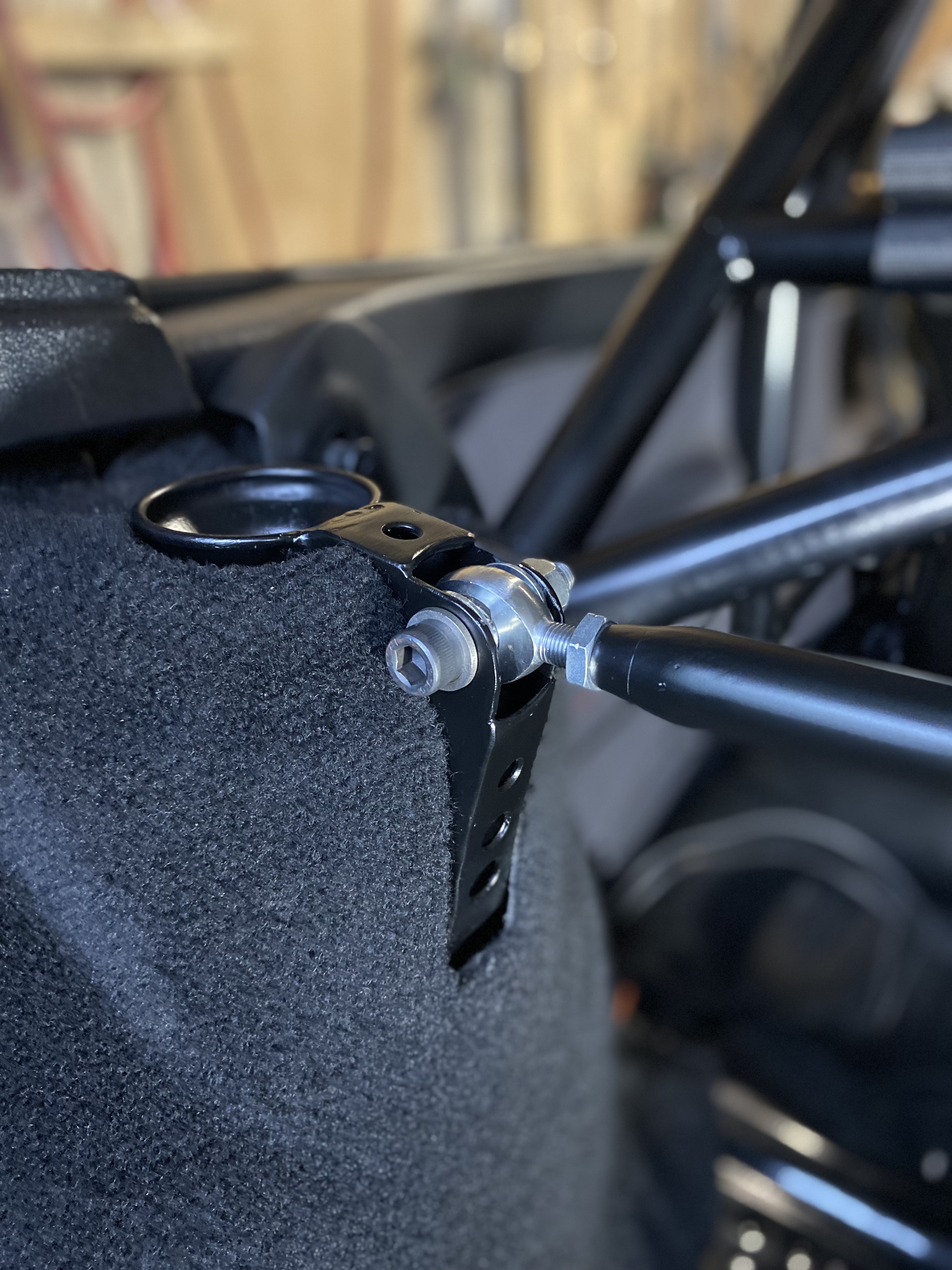

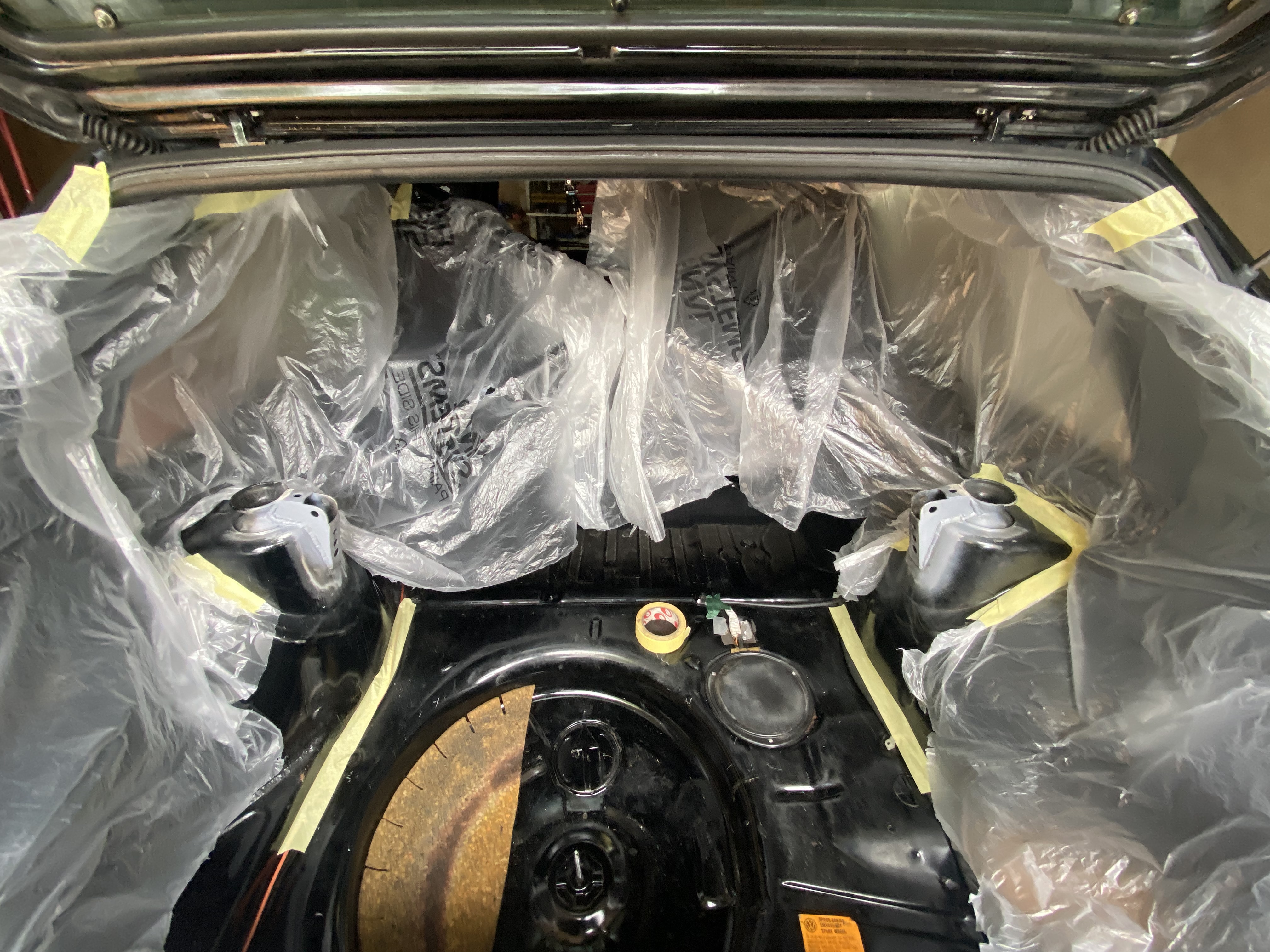

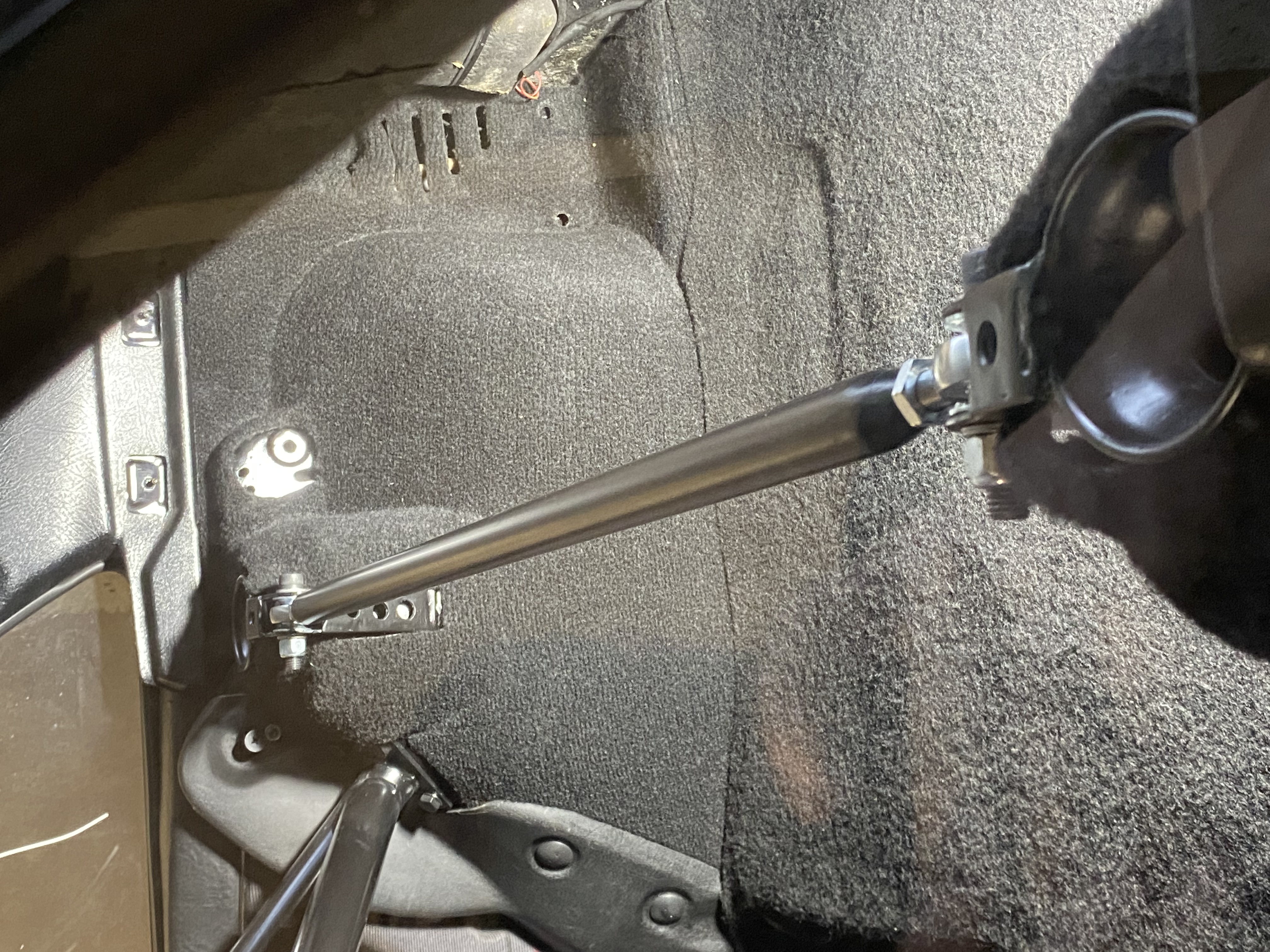

Next up on the fabrication/brace list was the rear turrets. Realistically I don’t know how much movement there will be here, and we will have to see if I notice a difference on track.
I ordered some tube the same 45mm as my cage tubing, offering it up I thought it just looked a bit out of place, and the tube actually weighted a fair bit. With the car being fully carpeted etc keeping weight to a minimum is a must! Or should I say adding to it is not something I’m keen on.

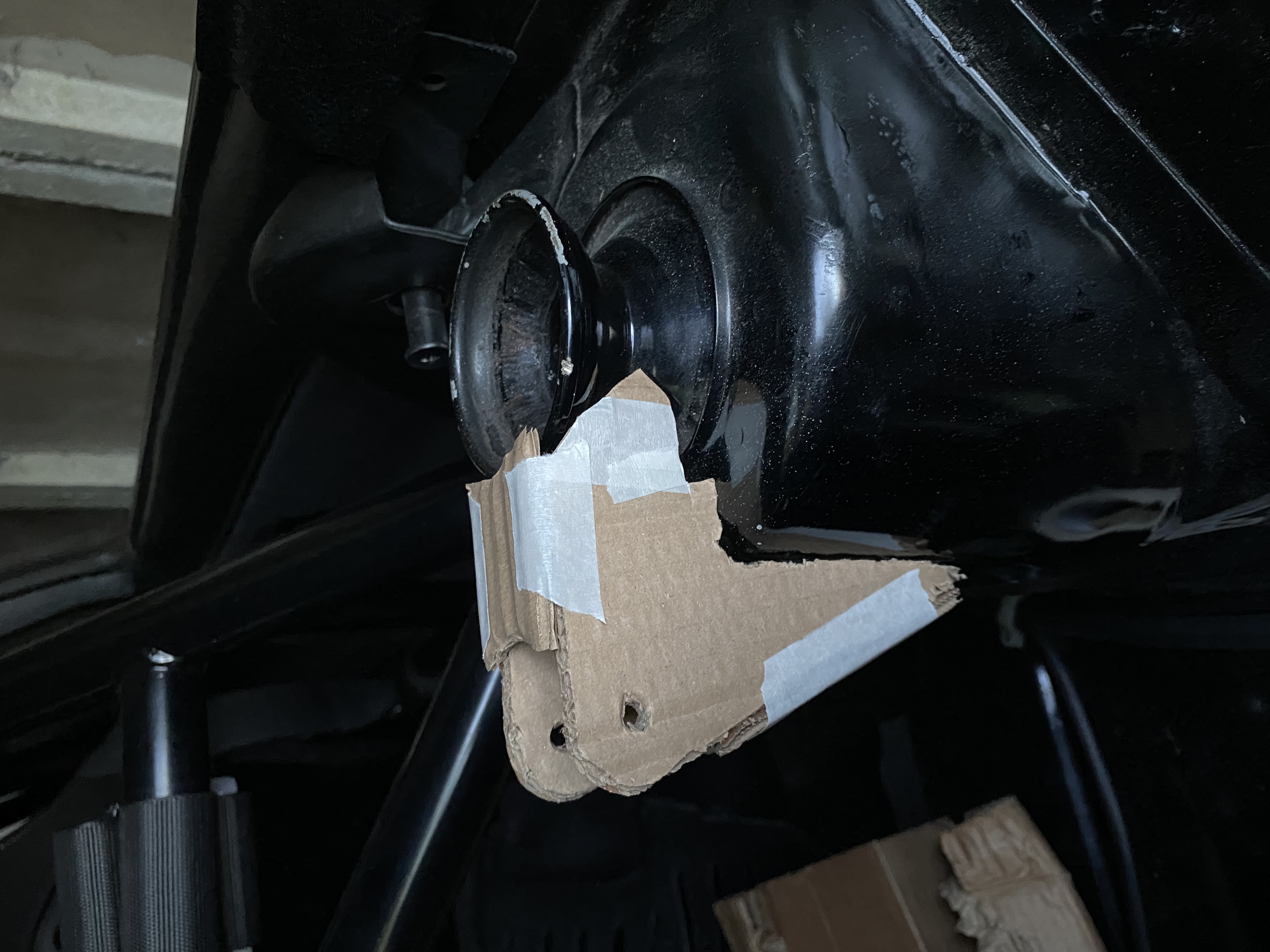

So I started to think about a lighter solution which would still be strong enough and not flex under load. After loads of thinking and sketching, I took some inspiration from this Porsche, which uses a rose jointed rod to brace across the turrets.
I liked how the brackets extended down the turret to maximise its function. I could have easily gone from turret to turret, but I wanted to also tie in the rear topmount. My view is the higher up the turret/topmount I can brace the better leverage there will be to actually make it effective.
Another benefit was that I could use a thinner tube to try and keep weight down.

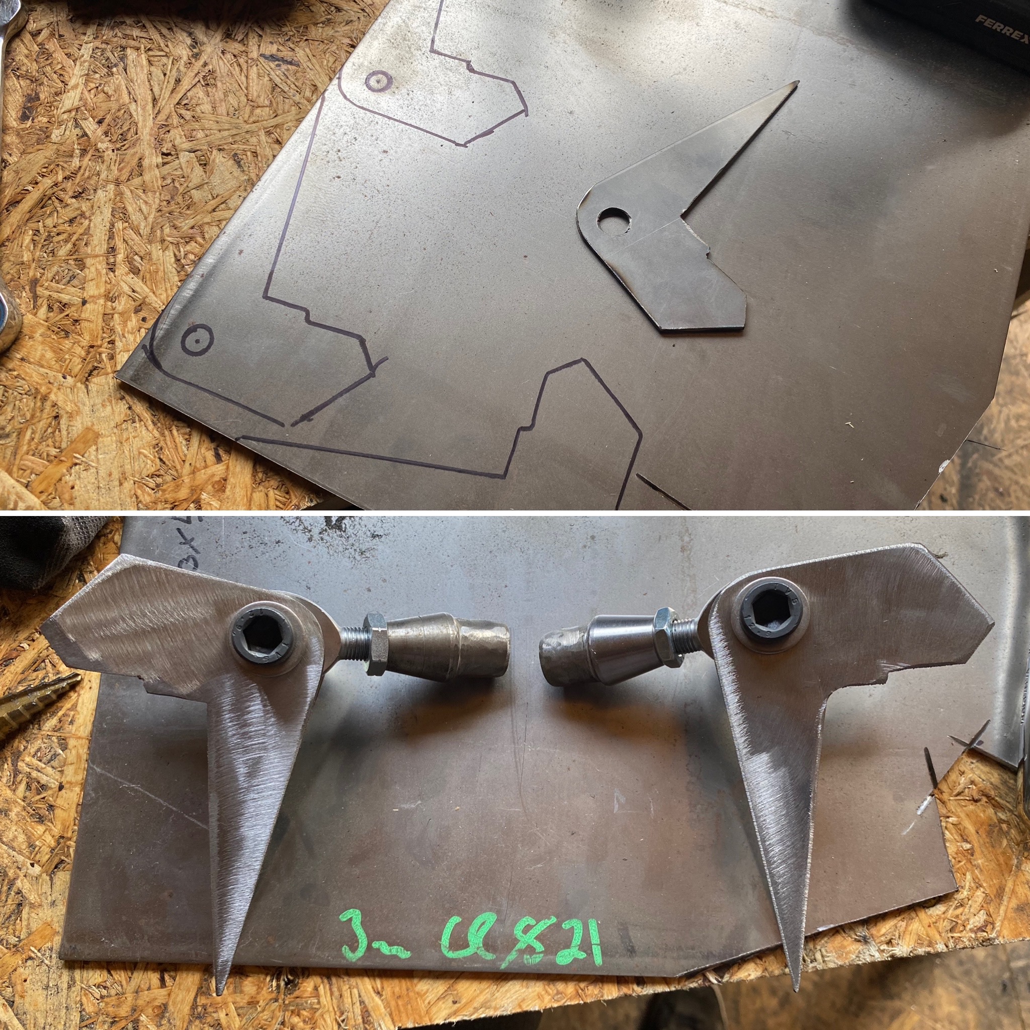

After some sketching I came up with this.

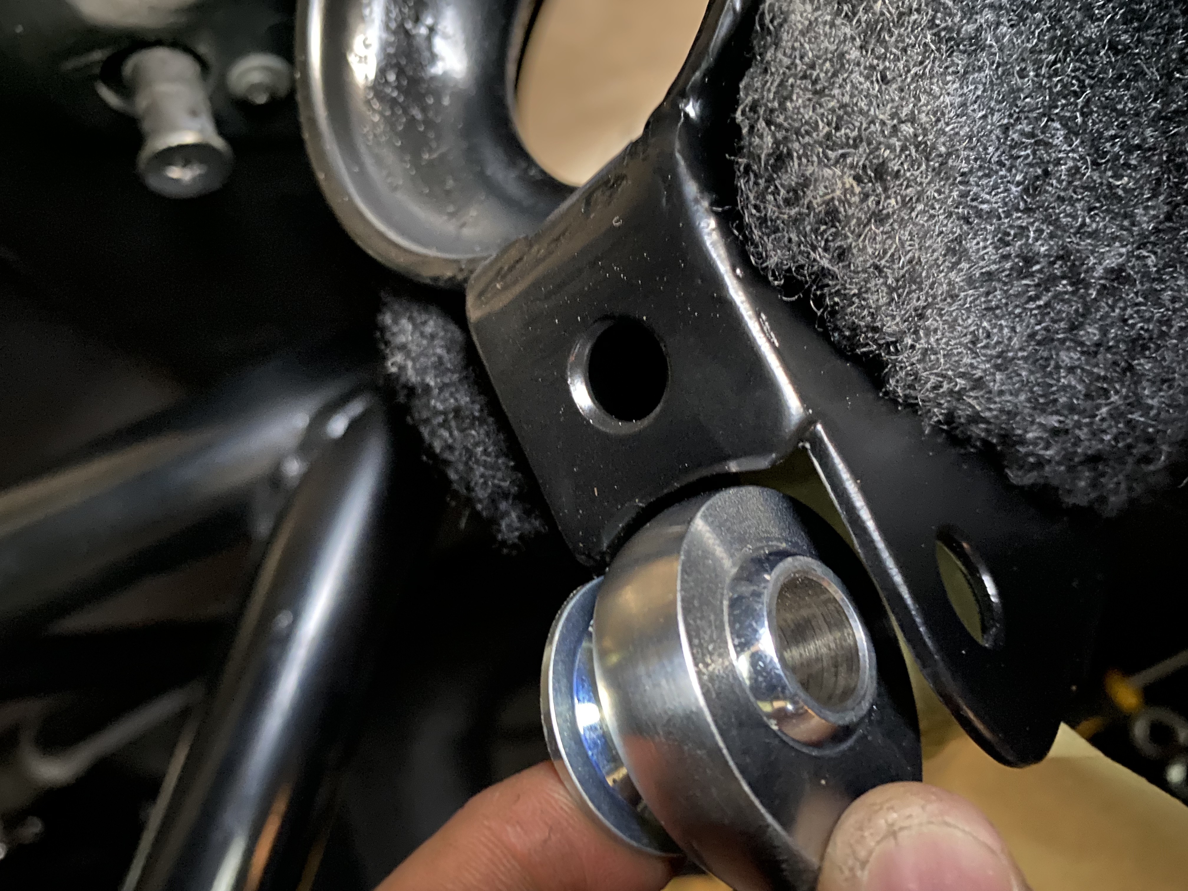

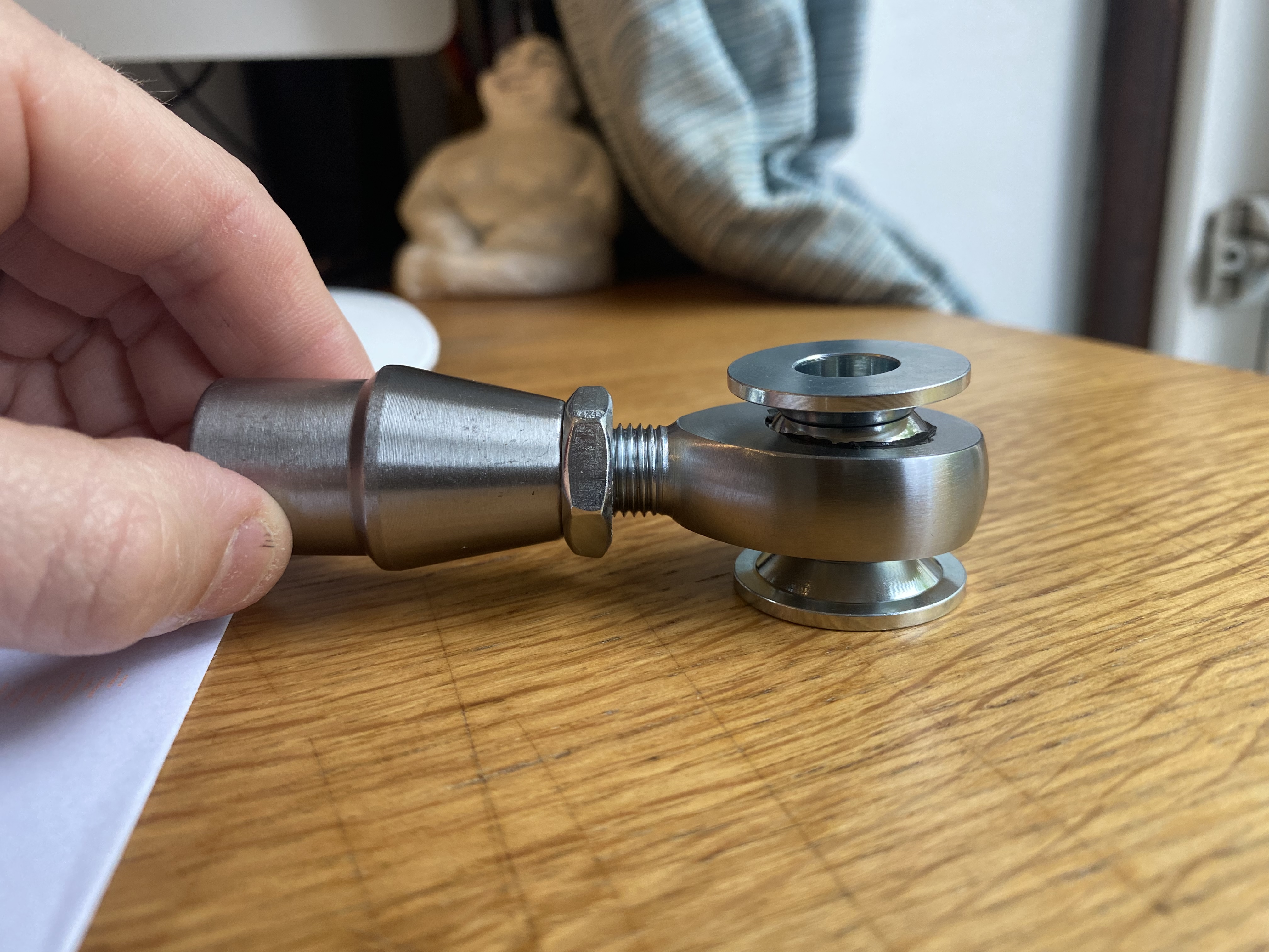

I ordered the rose joints in M12, along with some tube bungs, misalignment spacers and half nuts, one side was right hand thread, the other was left hand thread, so I could then use the tube to add tension before locking off each end.
And by complete coincidence, when offering it all up the bracket would fit perfectly in between where the rear parcel shelf supports used to bolt on, giving me a perfect guide to getting it all square, result!

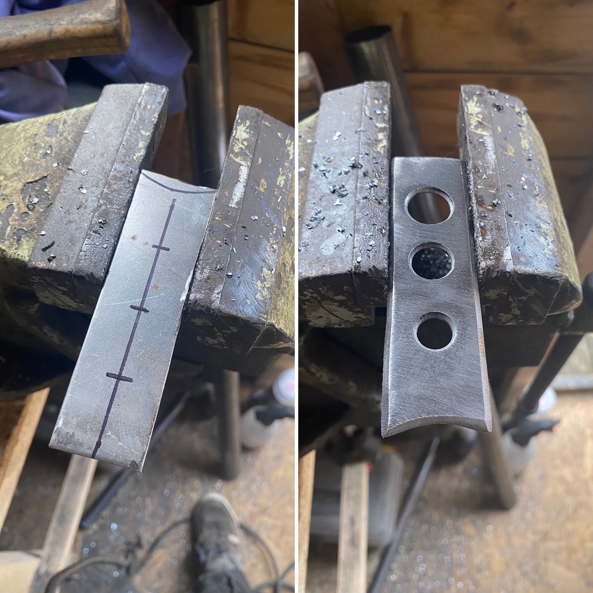

Made some templates
Once I was happy, I cut everything out in 3mm steel

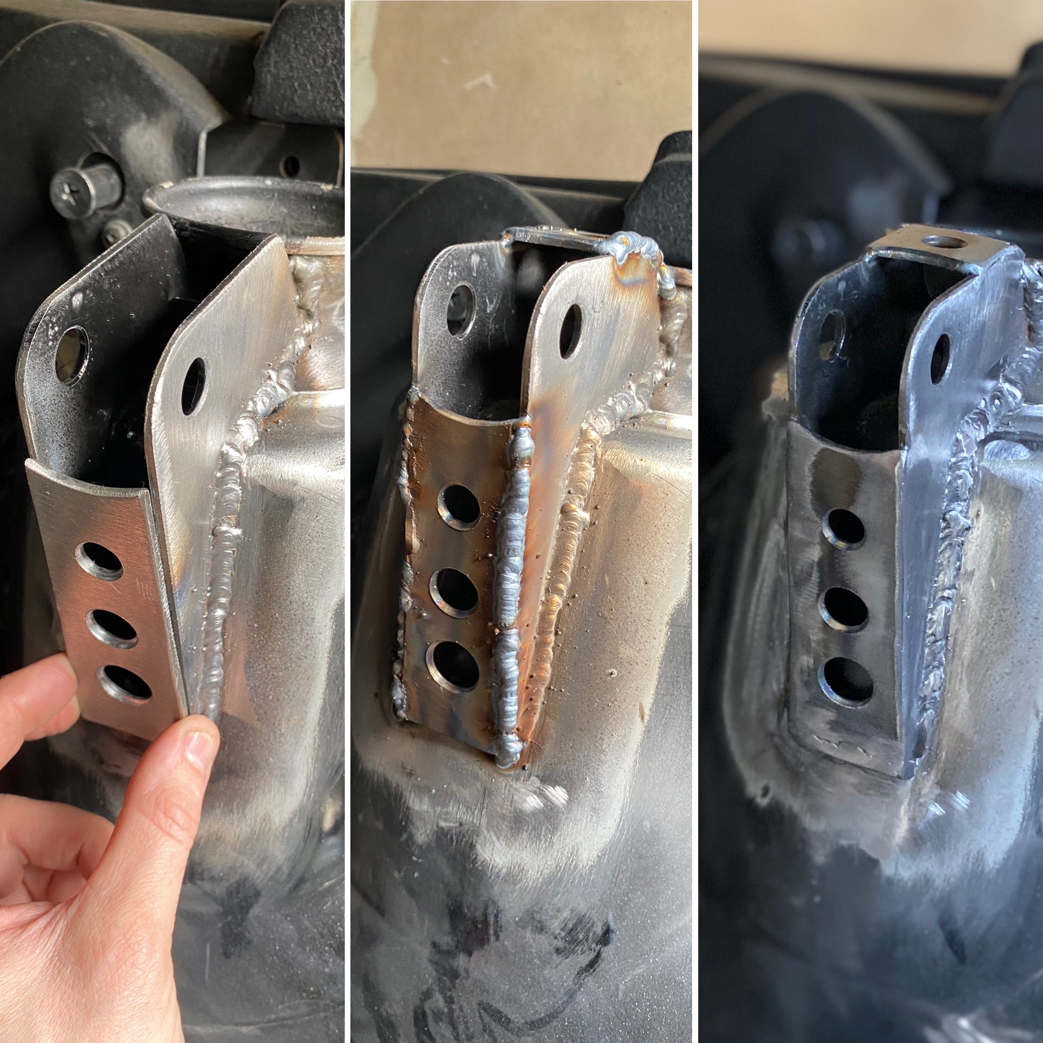

Got these welded in, you will have to excuse my welding here. I just couldn’t see to get going properly. I seemed to be in between settings on the welder, I have a dial for wire speed and 2 switches for volts and amps, I felt like I could have done with a dial for all settings. But I’ll stop blaming my tools and take ownership! It wont win any prizes but it will be strong…
Once these were in, I made some end plates with some speed holes to reduce weight.

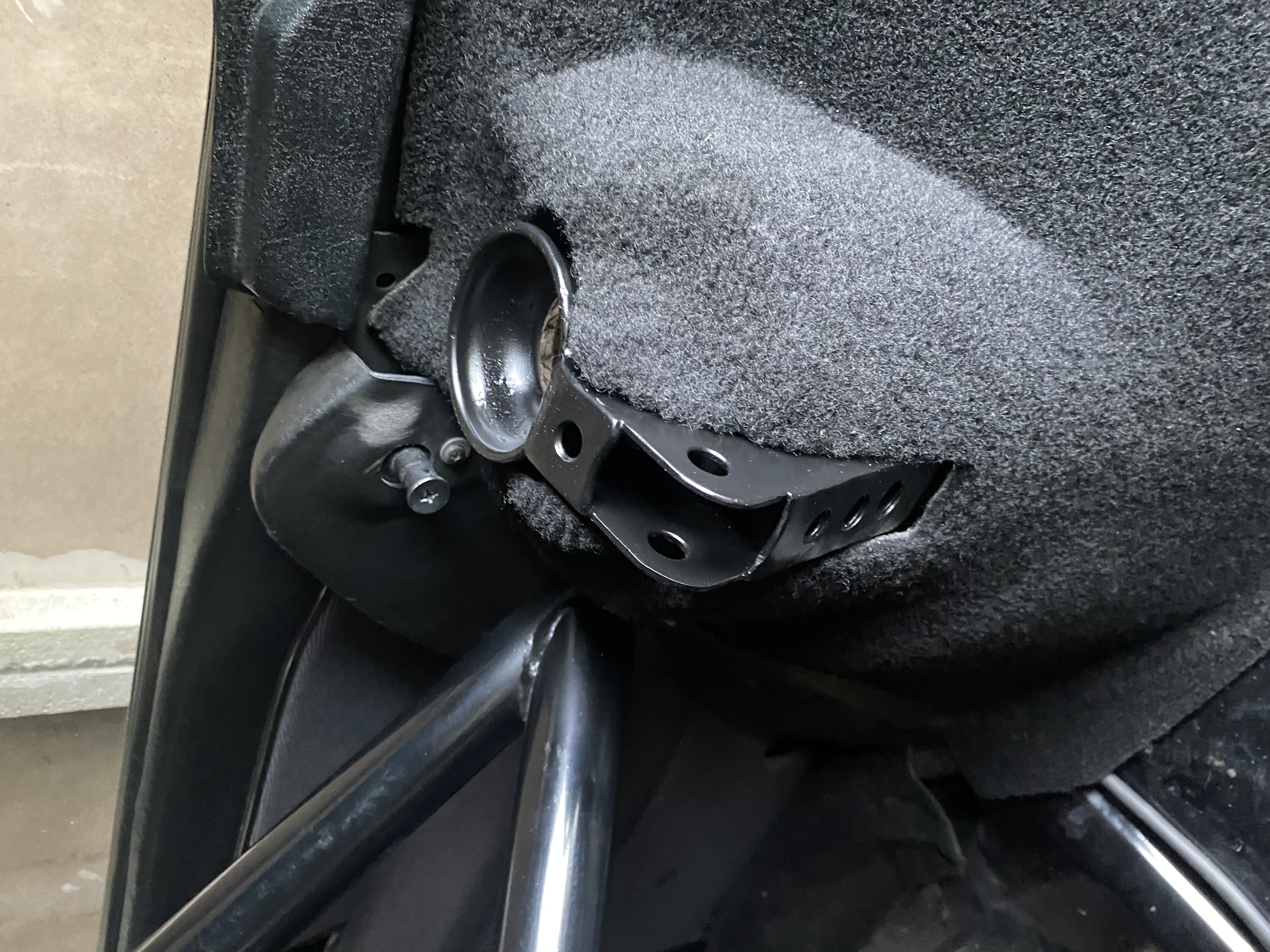

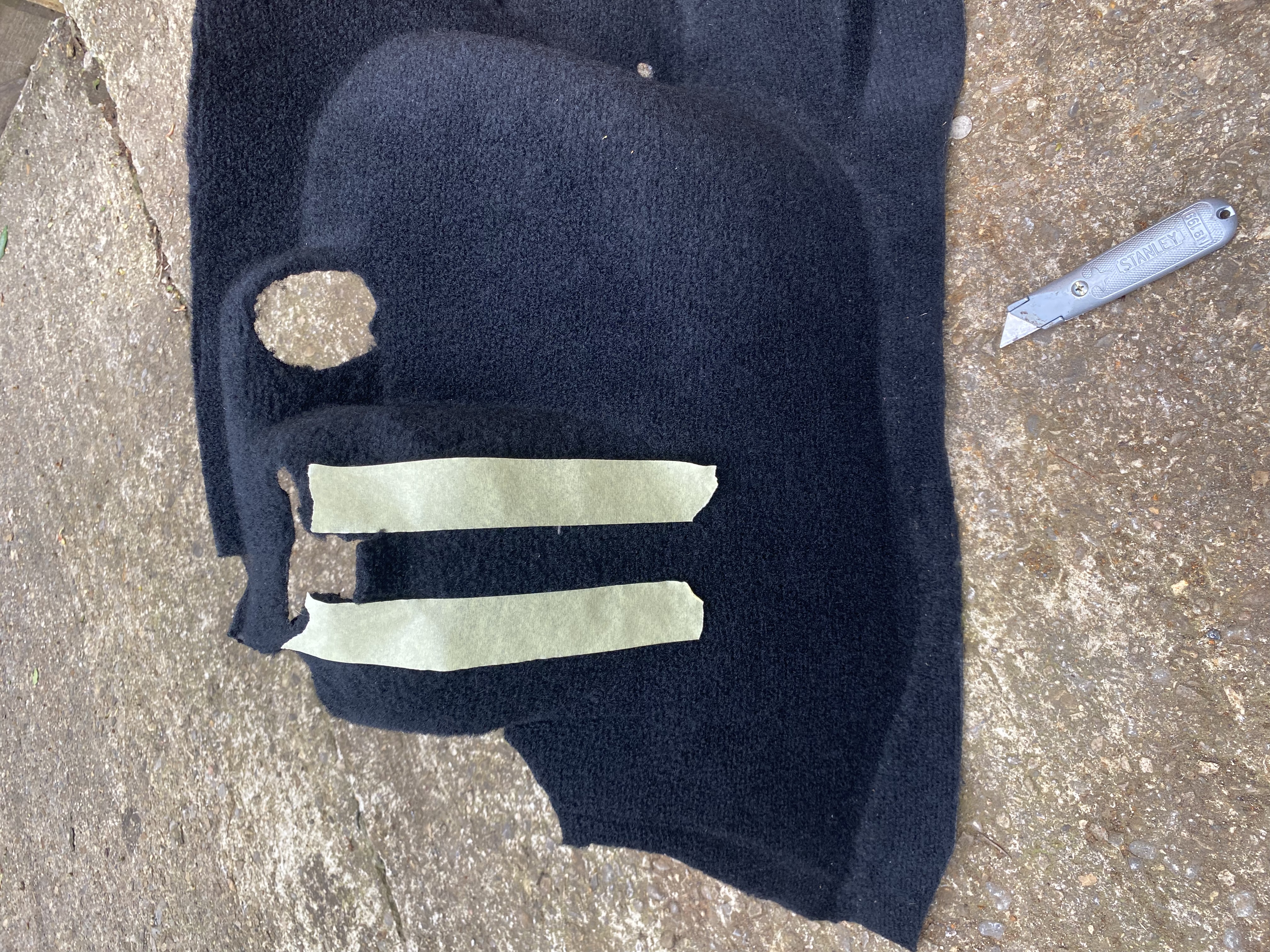

Once I was happy there, everything was painted up
The last job was a good vac out, and cut the carpet for the turrets.
Some finals shots
#engineering :D
Very happy with the final results! Really in keeping with my clubsport theme and a nice little project to get stuck into.

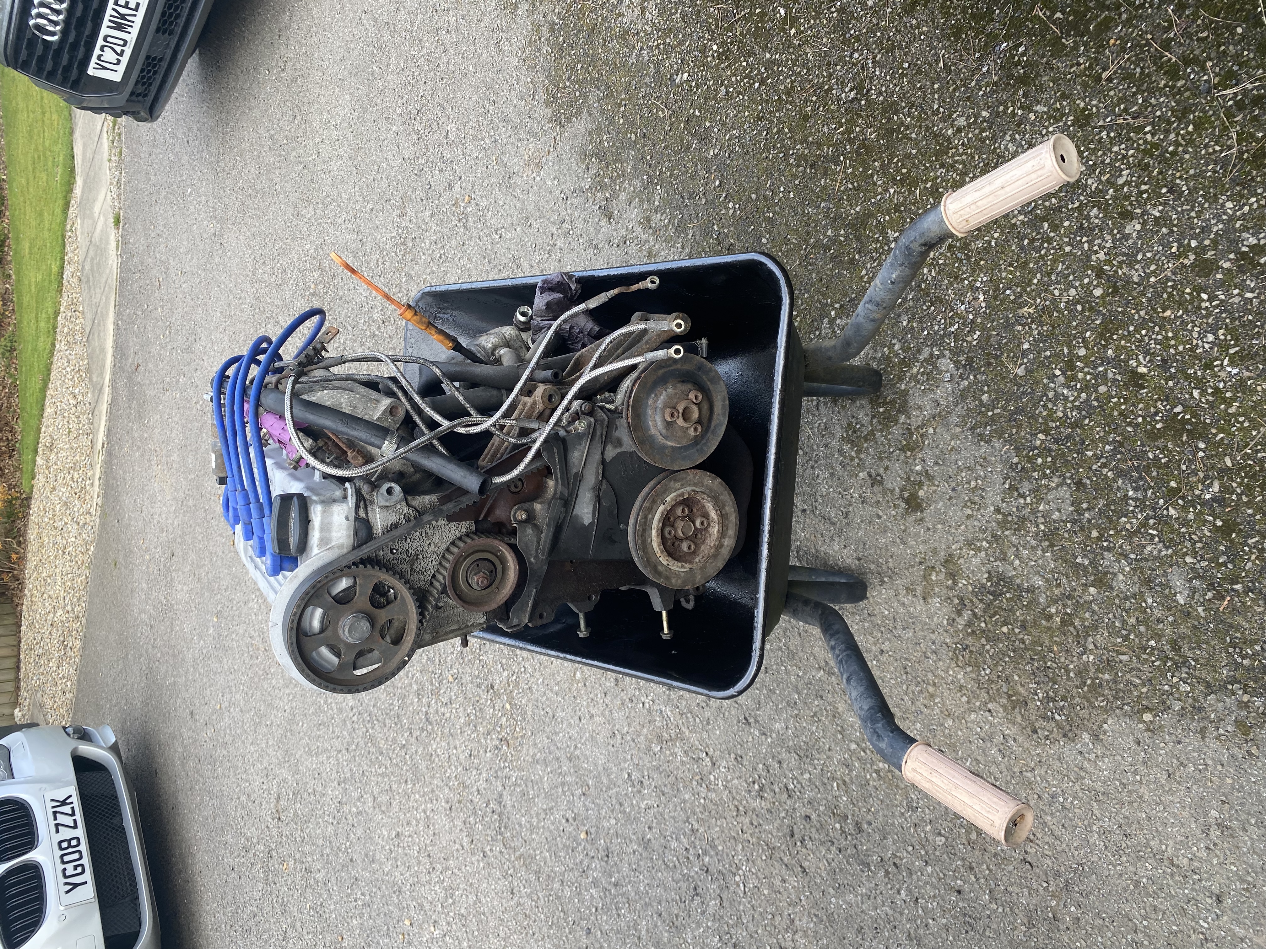

And lastly I finally got my new engine round from my mates house which we managed to wheel barrow round to mine!
That’s taking pride of place in my shed. I’d love to say that will be in soon, but it wont unfortunately, we are saving for our own place which will be taking up any spare cash.

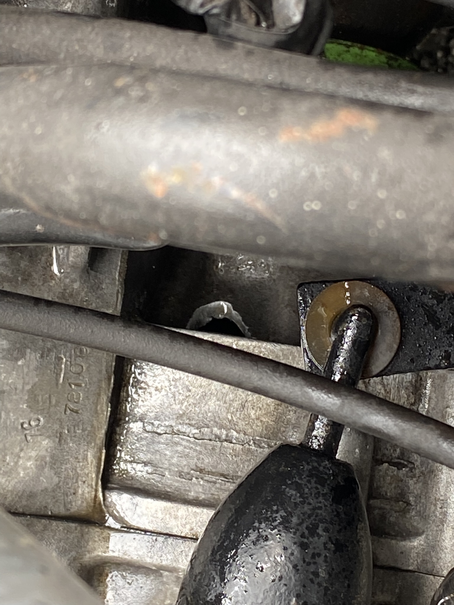

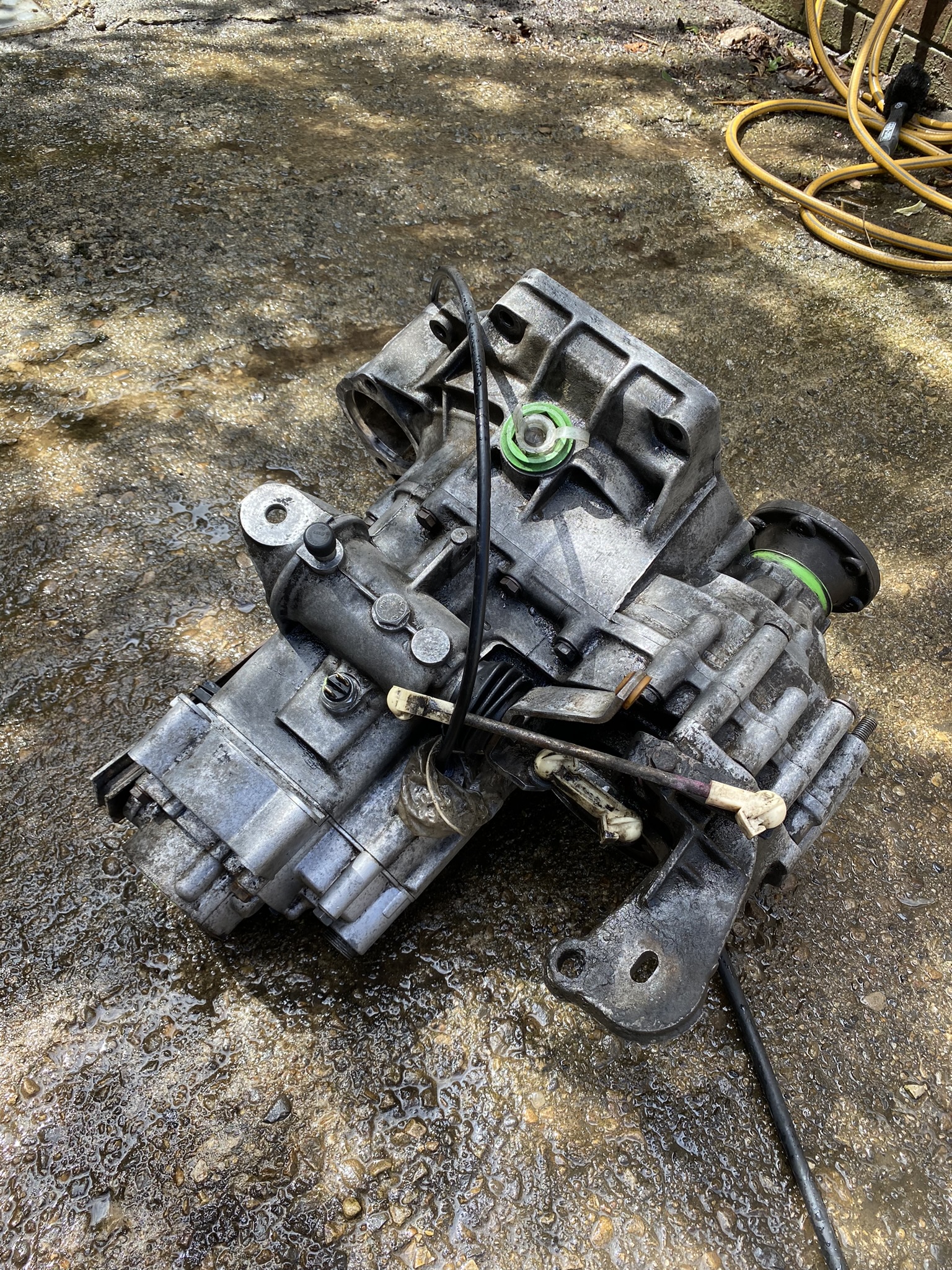

Correct. Another 020 has transitioned to transmission heaven.
This time it was the diff rivets which had failed, one of which shot straight through the casing of the box.
You can just about make out the hole here

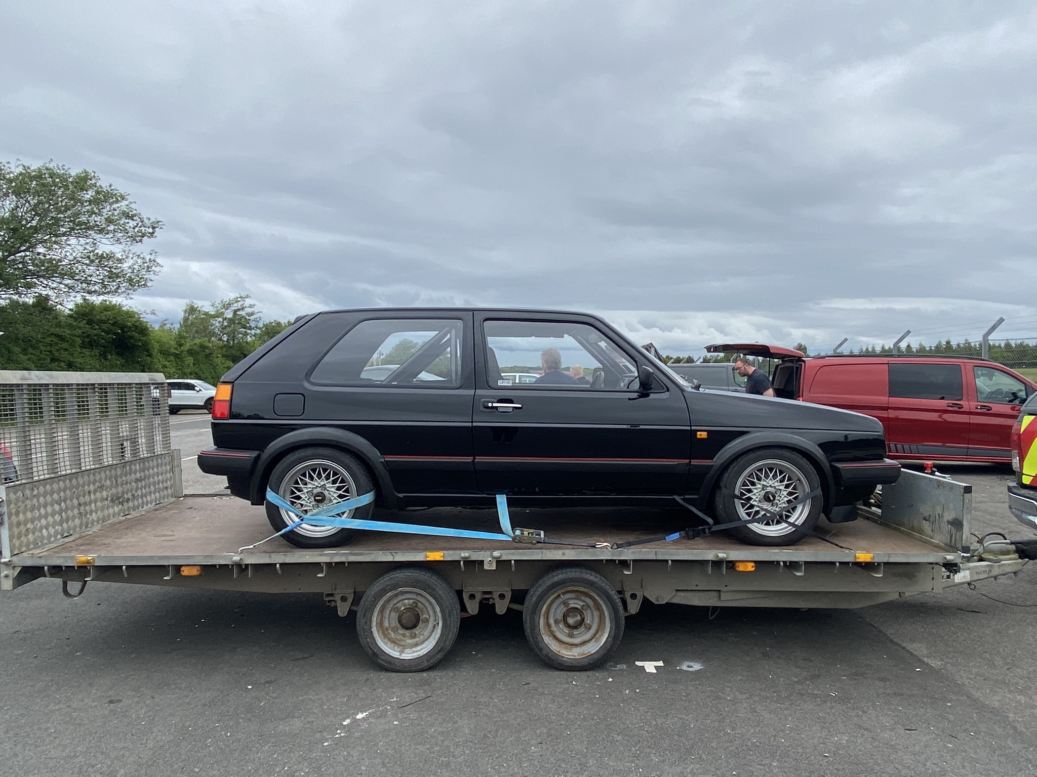

So that was end of play for me. I stayed until the end of the day with my mates and went out for passenger rides, all in all a great day.
Luckily for me one of the lads trailered his E46 M3, so the Golf took its place
That meant a drive back home in his E46. What an absolute animal it is, never been in anything like it!

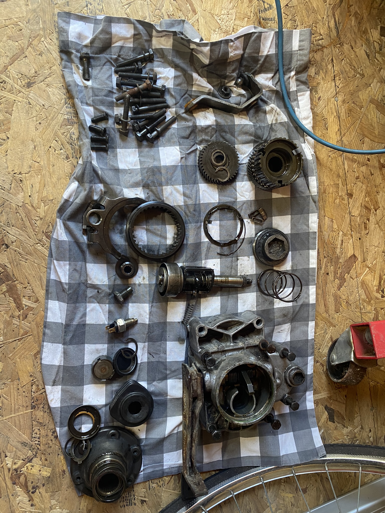

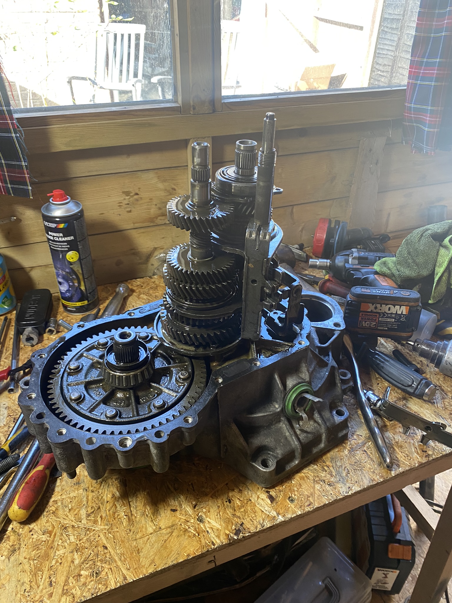

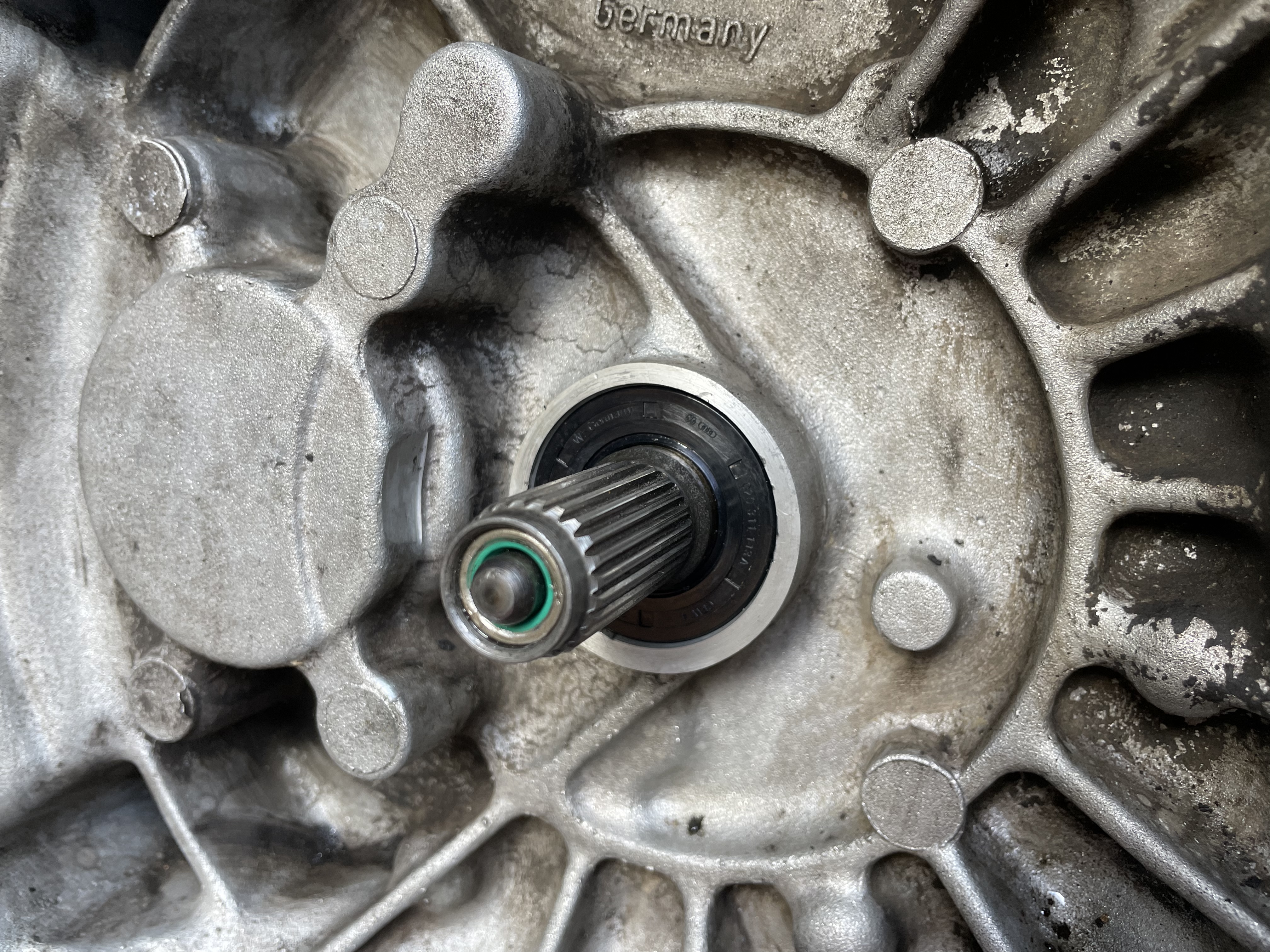

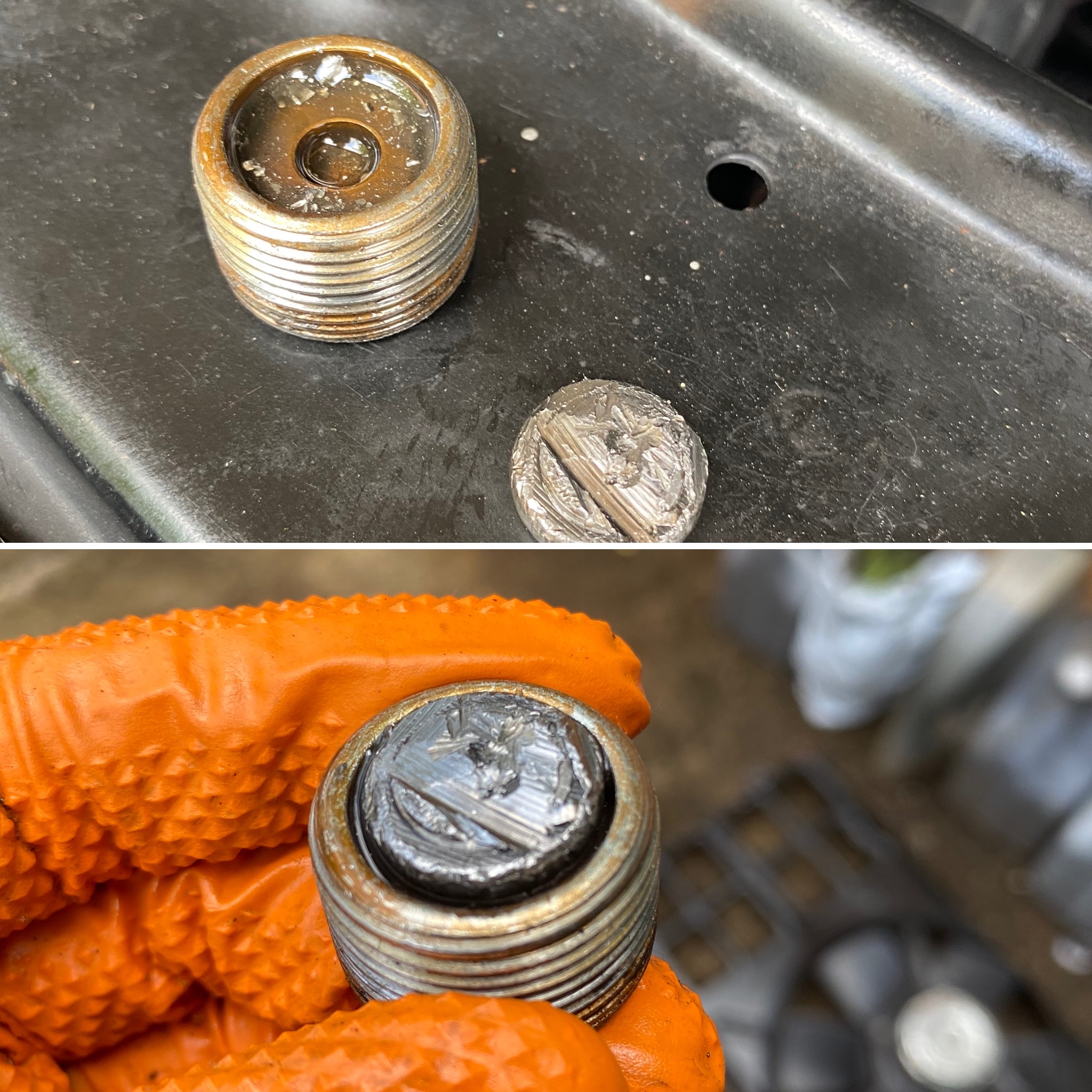

I had a spare 020 in the shed, that came with the new engine, so I began to strip the old one out of the Golf, whilst I tinkered with the new one. I wanted to swap this out for an 02a, but I didn’t have the time or the budget to do it properly and source the parts, as I’ve got a trip to Germany in a week, so the decision was made to crack on with what I had.
Looking at the gearbox I wasn’t sure if it had an LSD of not, both cups span the same way, so I decided to stirp it down and investigate. It was also a good excuse to learn a little bit more about how these things work, which was nice.
“you can only piss with the dick you’ve got” one of my favourite quotes. Adapt and overcome!
While it was off I put some new seals in it too
To my untrained eye, everything looked good, with minimal wear, unfortunately no LSD, it was just the springs behind the cups fooling me!

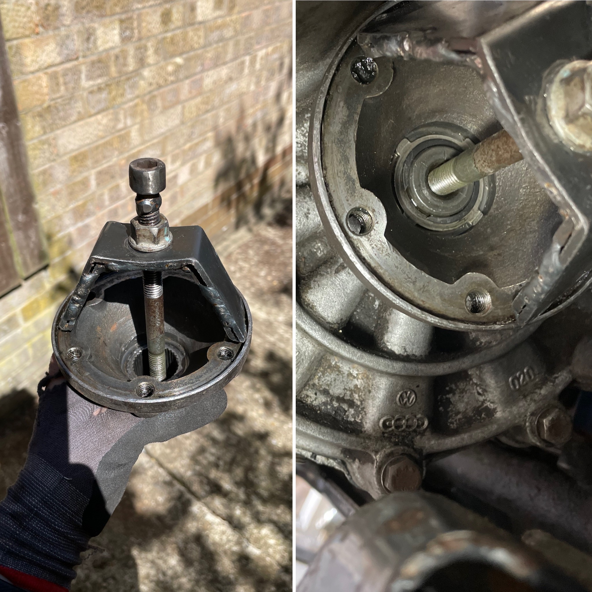

Which brings me nicely to the cups. For me this is the biggest blocker/pain when changing a gearbox, the are a pain to remove and you have to constantly be on guard waiting for the cup to spring off in your face. So, I decided to buy myself a set of long nose circlip pliers (these are a god send) and I also made a tool, which puts pressure on the cups to remove the clips easily and then you can slowly take the tension off – Result!
Surprisingly the gearbox still seemed to function correctly, a miracle.

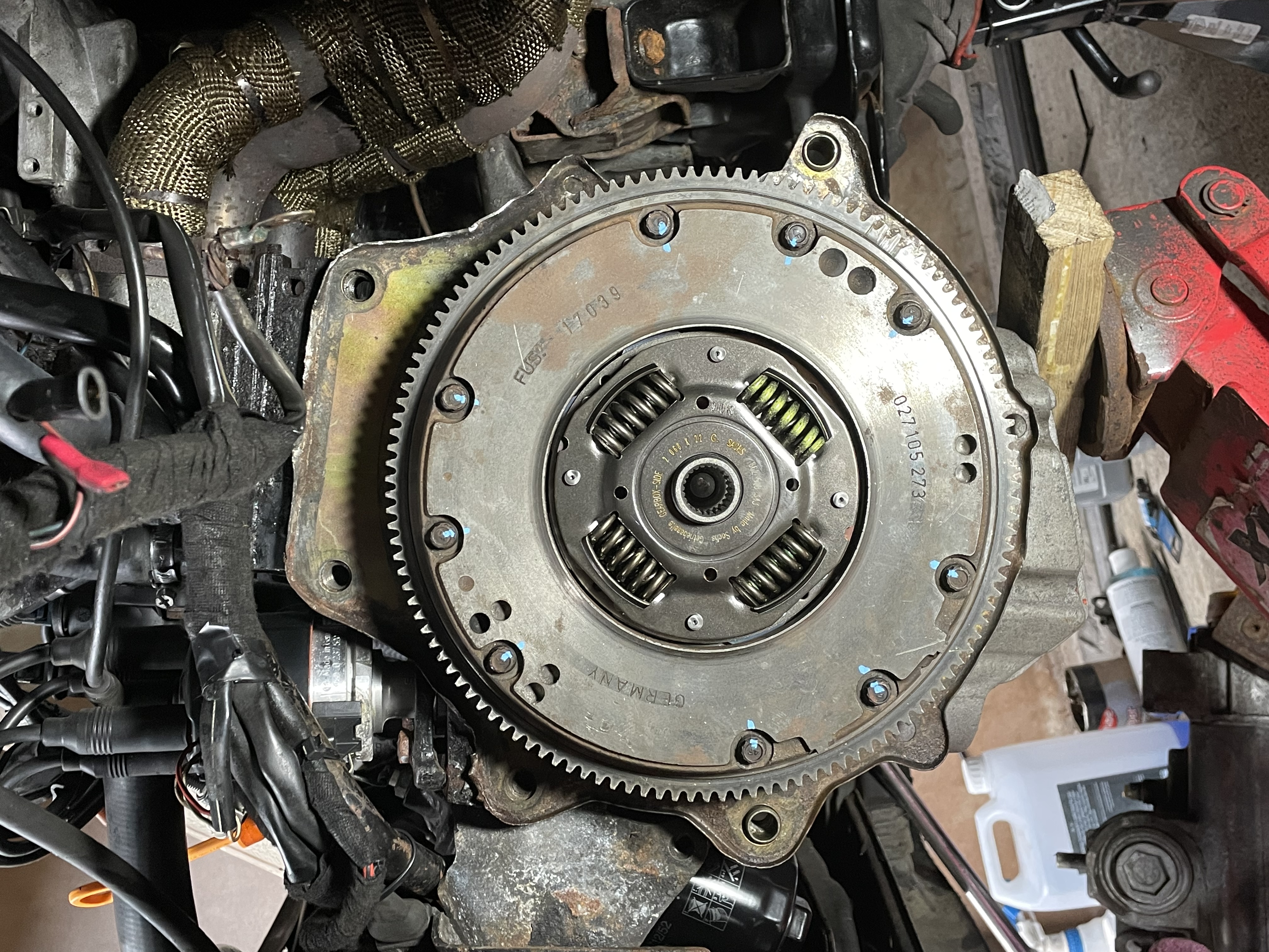

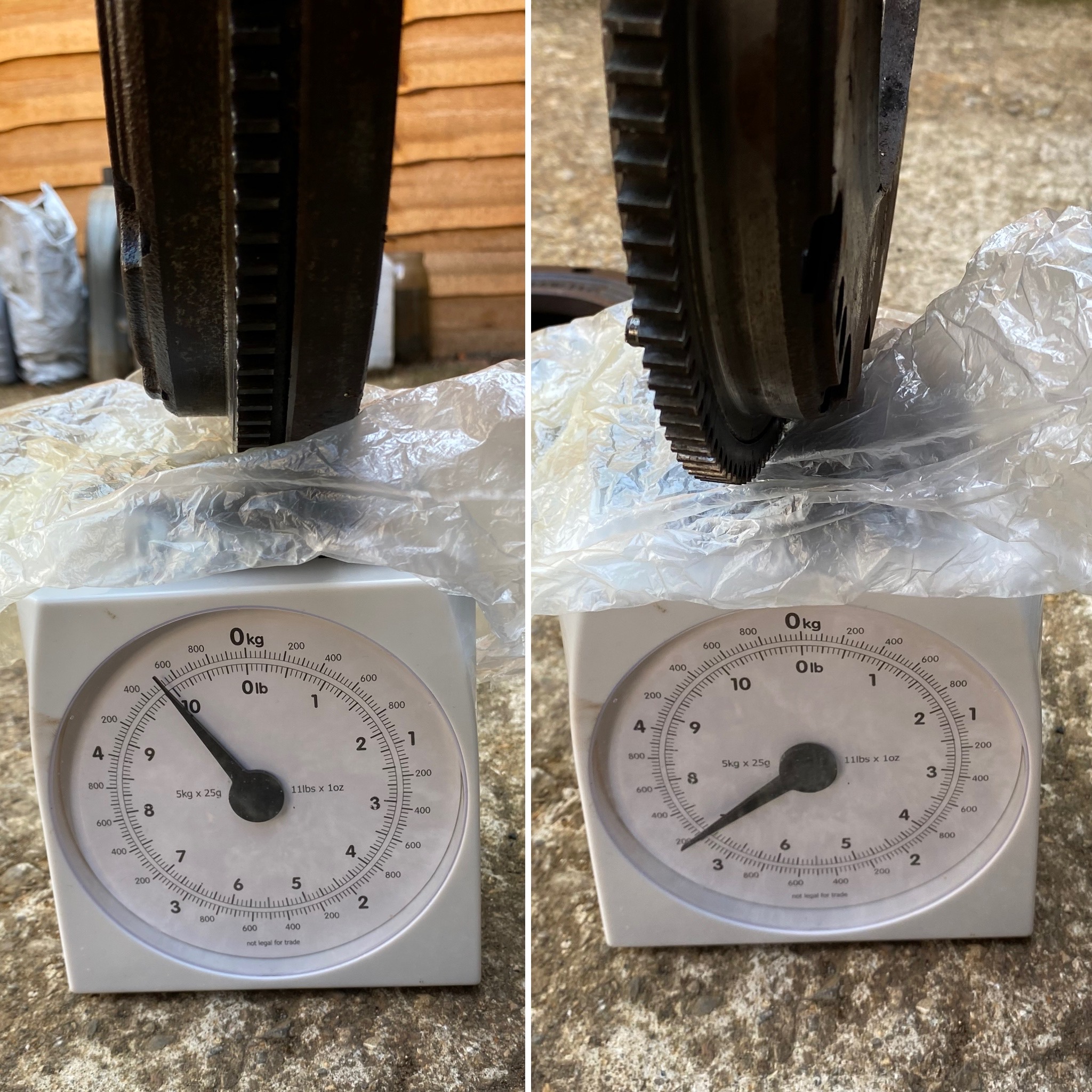

My new ABF was running an 020 with a lightened flywheel, so I decided to get this on at the same time.
Decent weight saving - 1.4kg

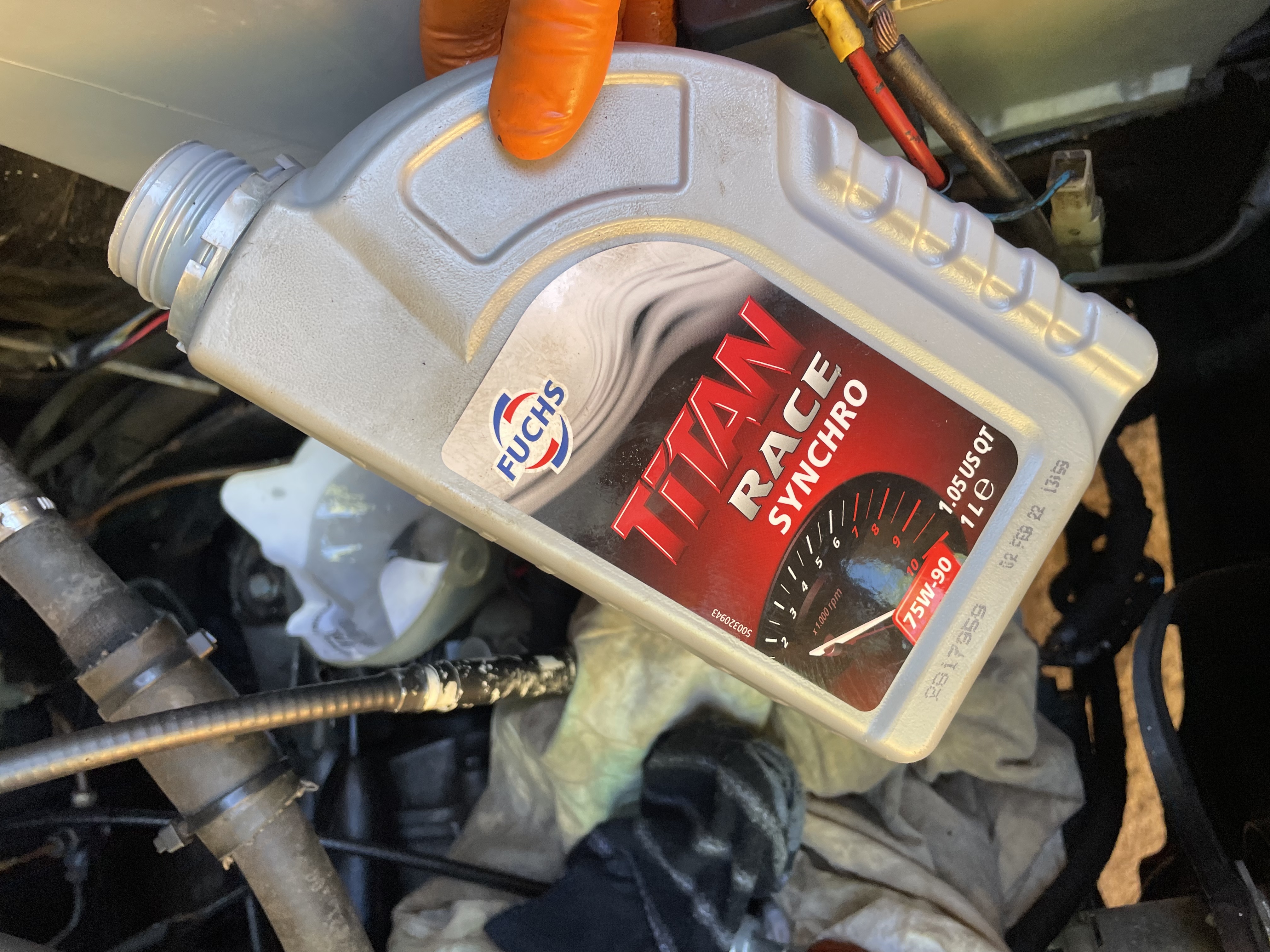

Refilled the box using some different fluid this time.
I had to also replace the friction disc, as the old one got covered in gearbox oil.

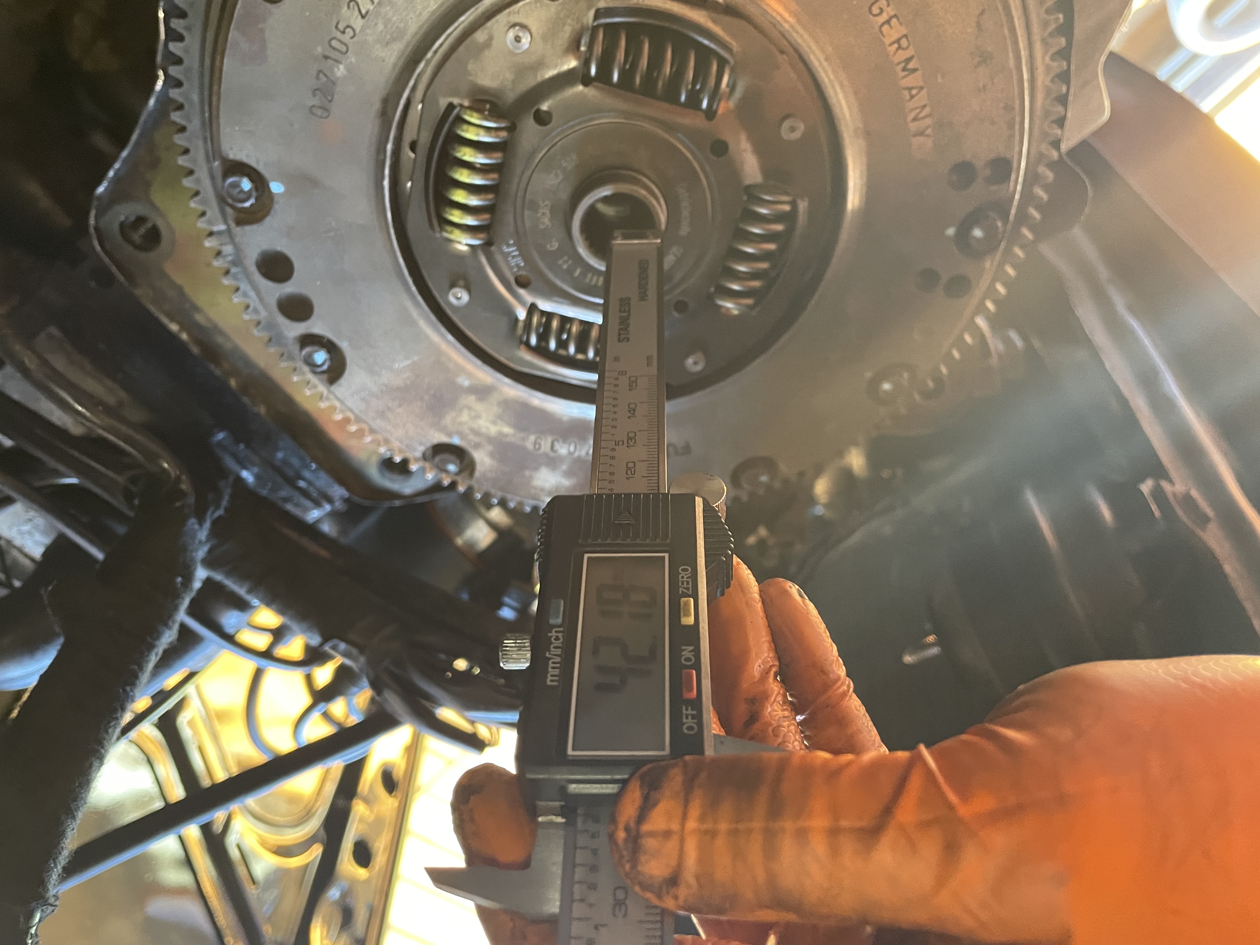

With the box back in, something was a miss. The pedal would just go straight to the floor. I toom the cap off the end of the box and inspected the fork, push rod and spring. All look good. The fork has some wear so I swapped this for a spare from my old box. Unfortunately I still had the same issue, so back off with the gearbox.
I check on brokevw ( a great source for anything 020 related) and he mentioned the hub face of the flywheel should be 36mm to the plate the push rod sits on.
I was getting 42mm. Night after night I was checking everything I could, had the flywheel off, the old one back on and vice versa, and finding nothing. It’s a very simple system so a problem should be obvious. In the end I just refit the box and put it down to the friction disc being new. After messing around with the manual clutch cable for a while, I found the sweet spot. The clutch feels good and the pedal returns and I’m sure as it gets some more wear it should improve.
I might rename this build “Cope messes with gearboxes” It’s safe to say I’m sick of the things.

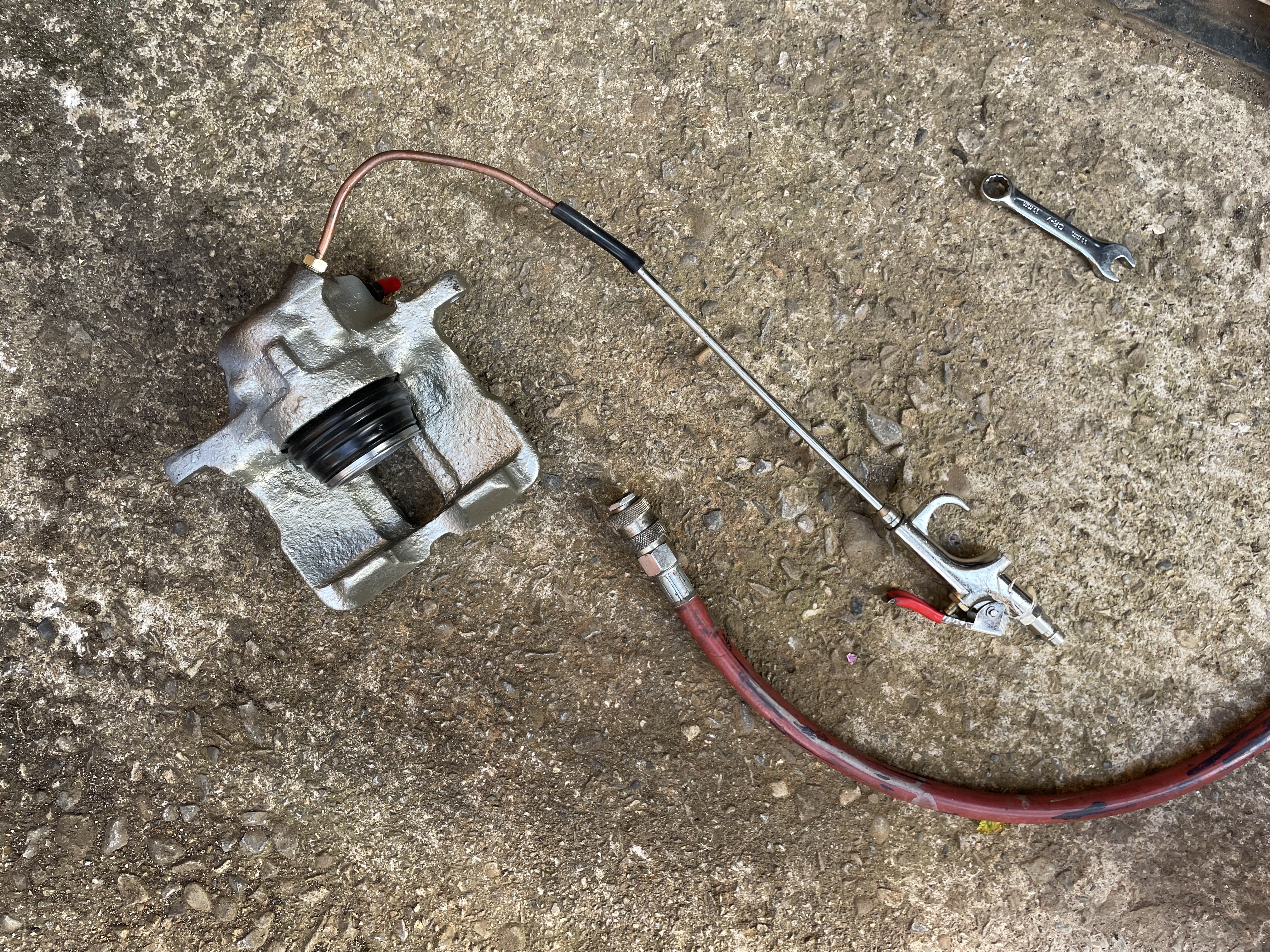

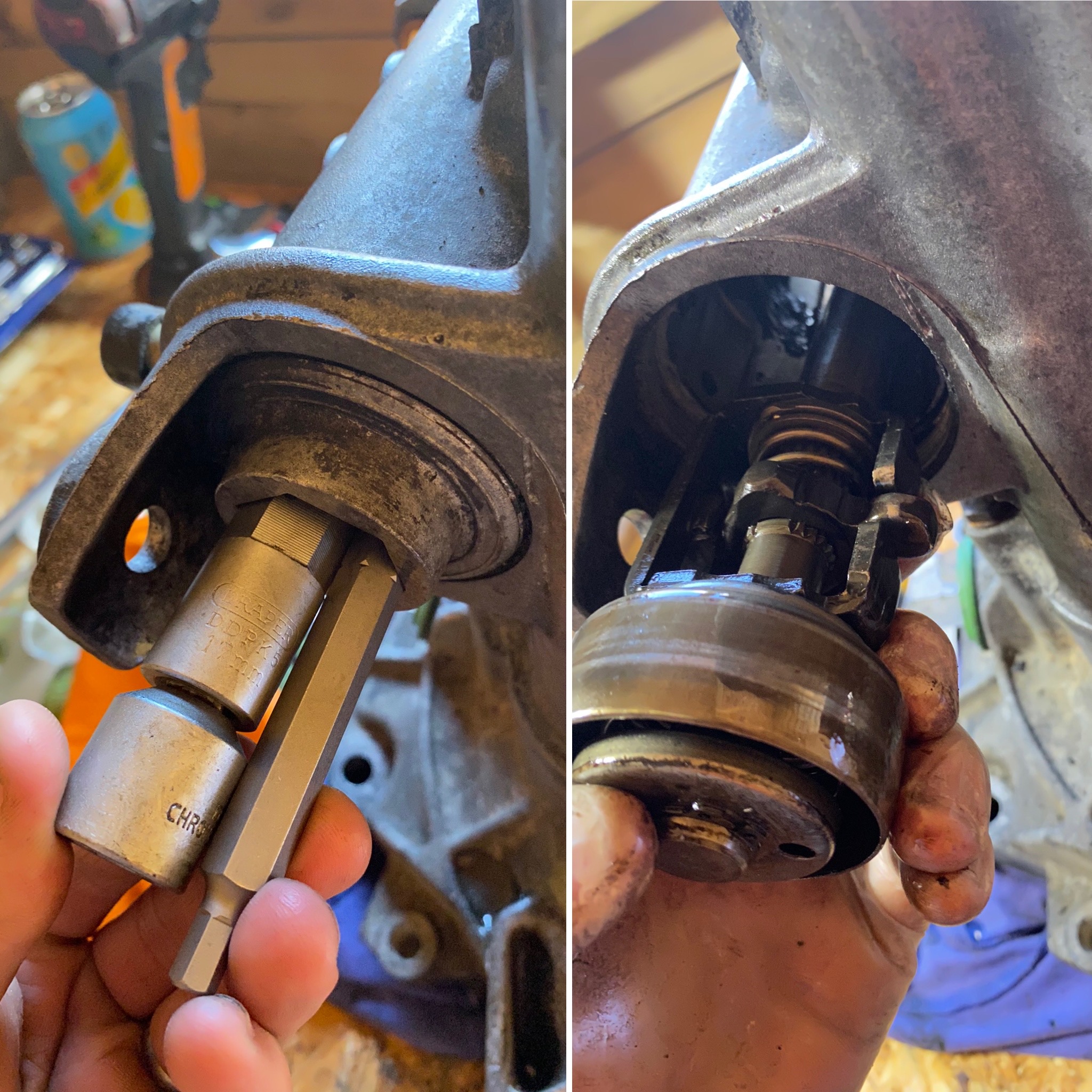

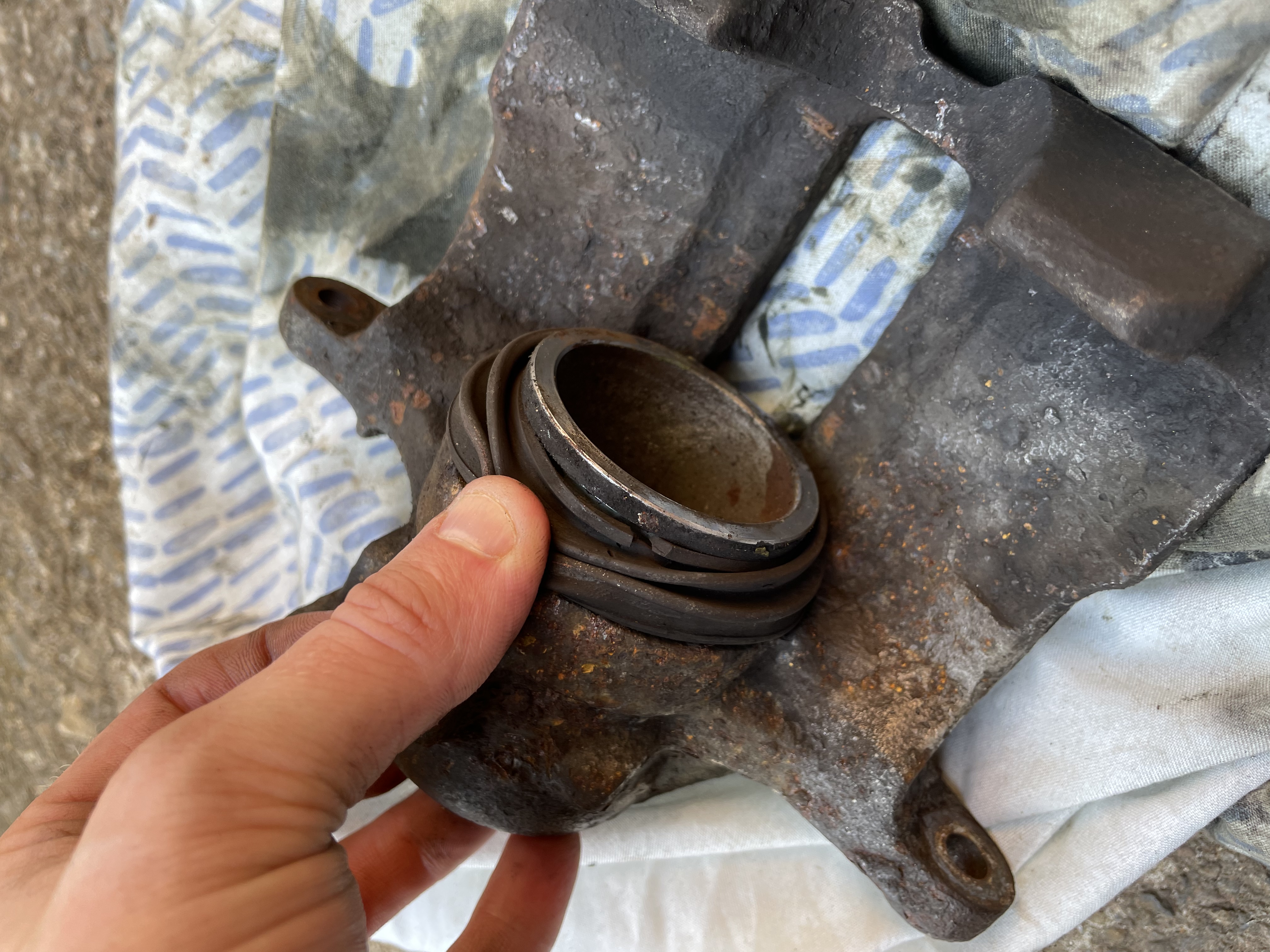

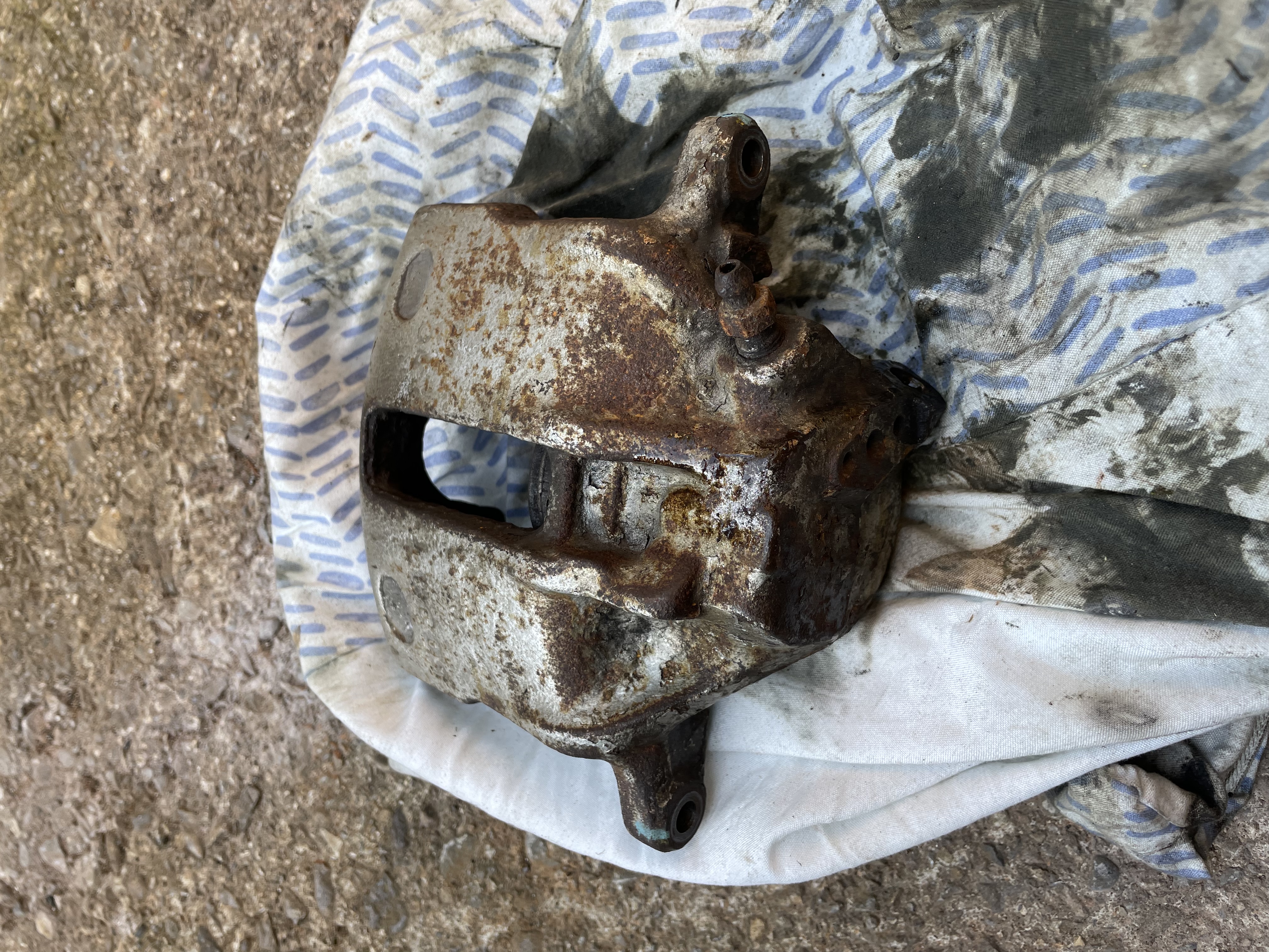

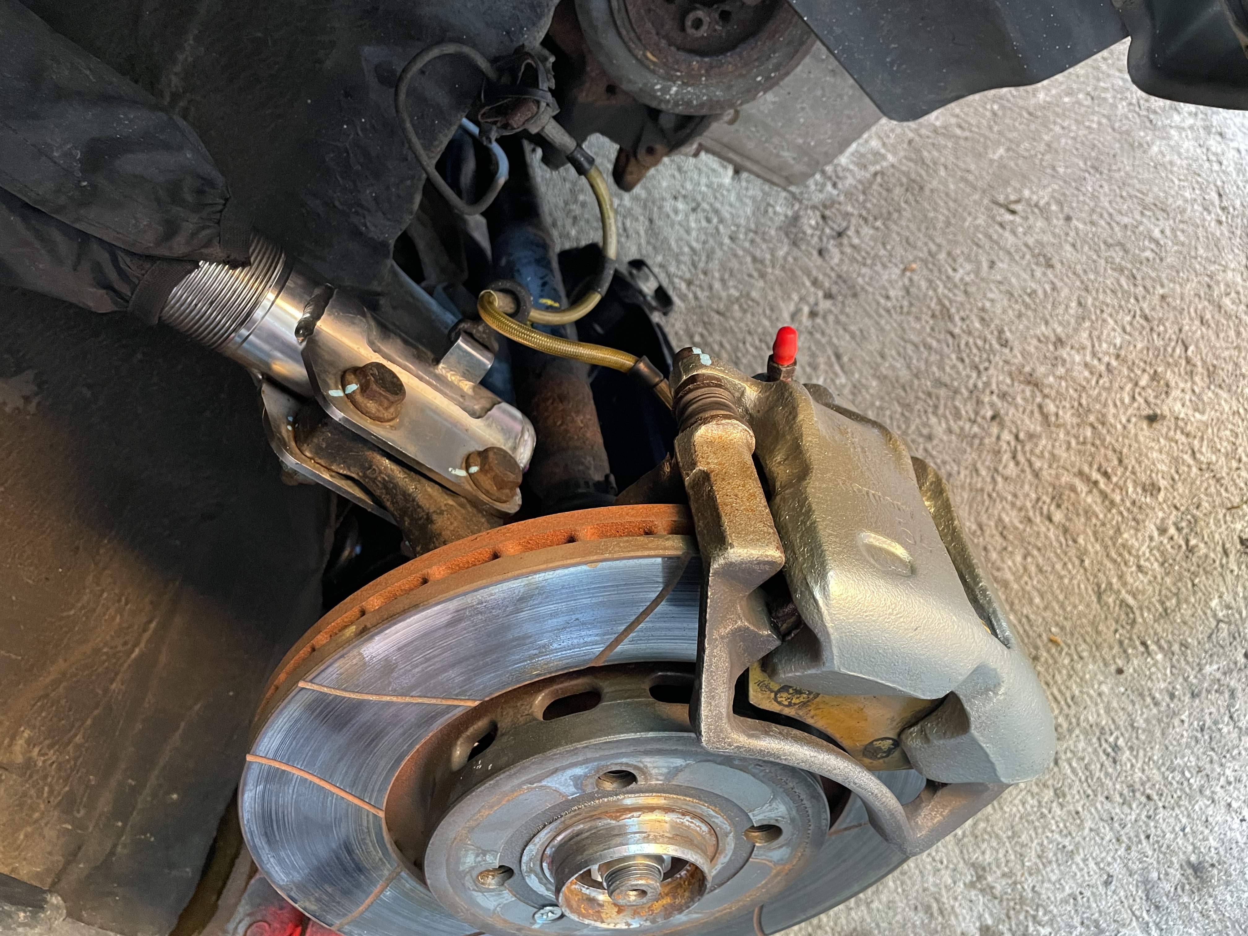

Next on the list was the brakes. I’d noticed when changing the pads in the last update that both dust seals had split as had the slider dust covers. I ordered a kit from big red, great quality and great price!
The old caliper
I use this little contraption for popping out the piston, made up of a brake pipe union, brake pipe and some silicone hose to attach to an airline, works a treat!
I’m glad I did this as the piston was starting to rust in places with the water ingress.
The caliper built back up with a new lick of paint

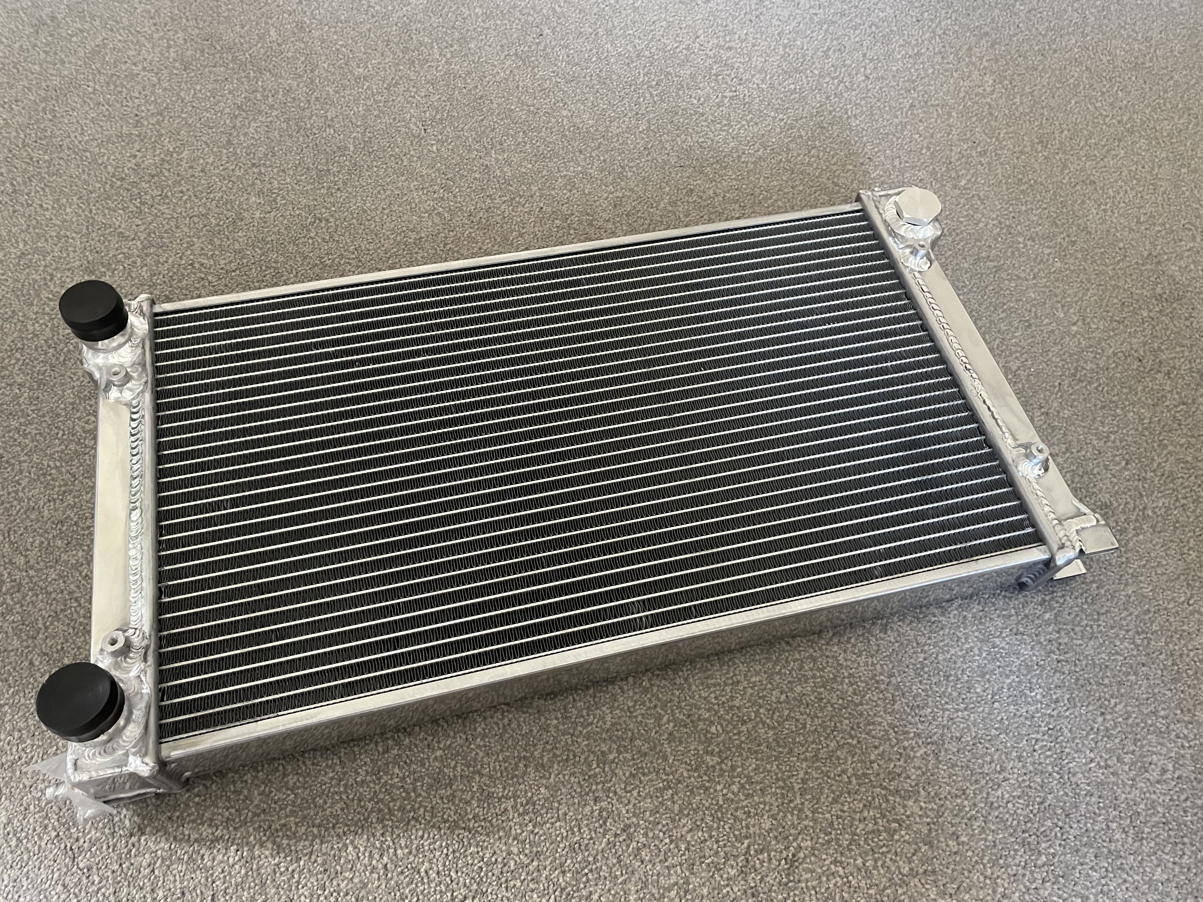

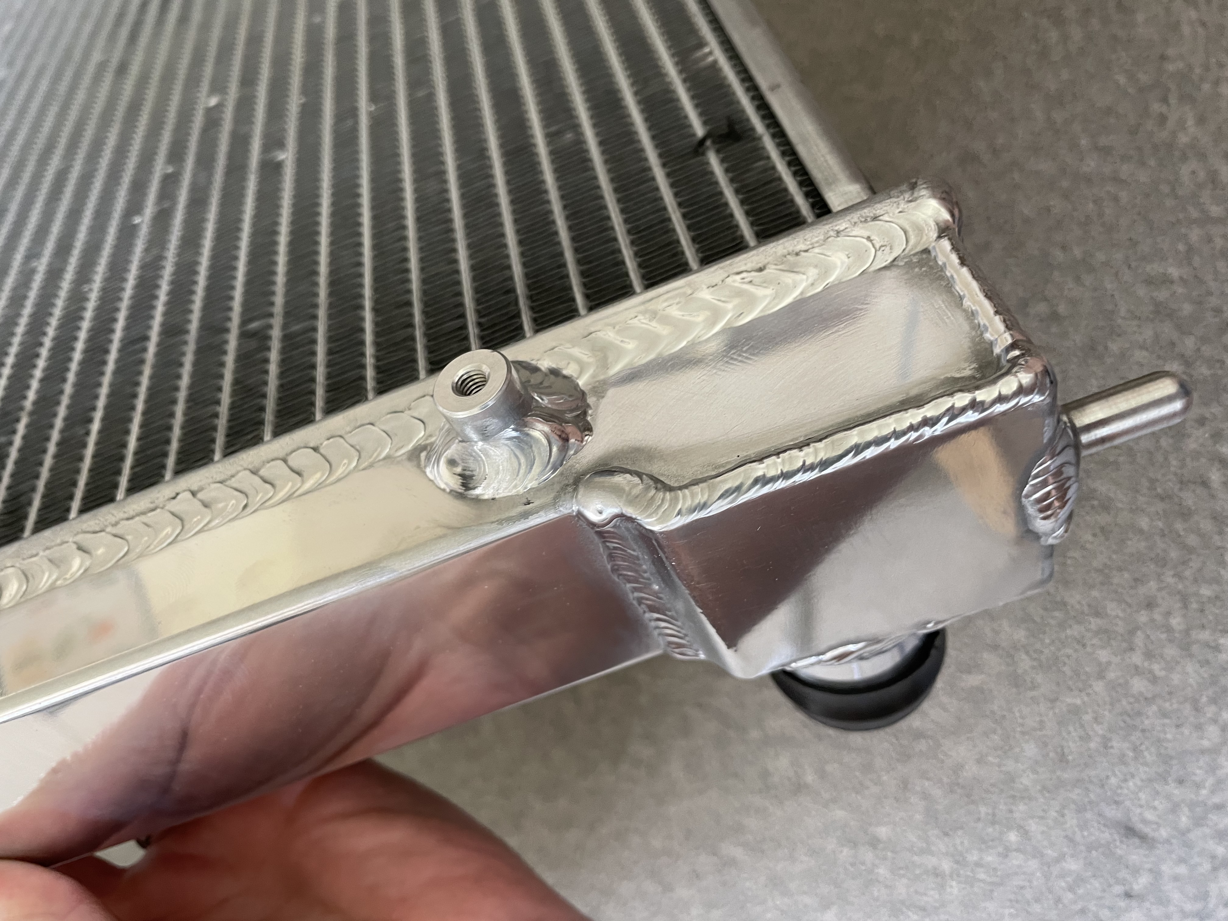

Next on the list was cooling, the old rad was looking tired and I noticed on track that coolant temps were at sat at ¾ on the gauge. I went for a true Yorkshire spec ali rad from ebay, for the total cost of £41! Yep bargain! It’s a 4 core rad, so should help the coolant temps.
I was sceptical but the quality looks bang on.
The rad was installed with the standard fan and cowling set up, new rad hoses, a new head flange and metal water pipe.
I also used Water Wetter instead of coolant, the benefit being if I happen to cause any spills at the Ring, its nowhere near as slippery as coolant and is very similar to just running pure water with some added lube for the waterpump.
I took the car for a test drive after spending hours trying to bleed the coolant, it was a real pain this time!! But got there in the end and touch wood no leaks.

Another great update.
As far as I'm concerned, gearboxes are made of magic!!
Nice to (briefly) catch up at the meet, shame I didn't have a little more time.
Love the fact you're taking a box to the ring with you!!
Have fun out there and watch out for the Porsches and BMW M2s, they're like Mondeos out there, bloody everywhere!!!
