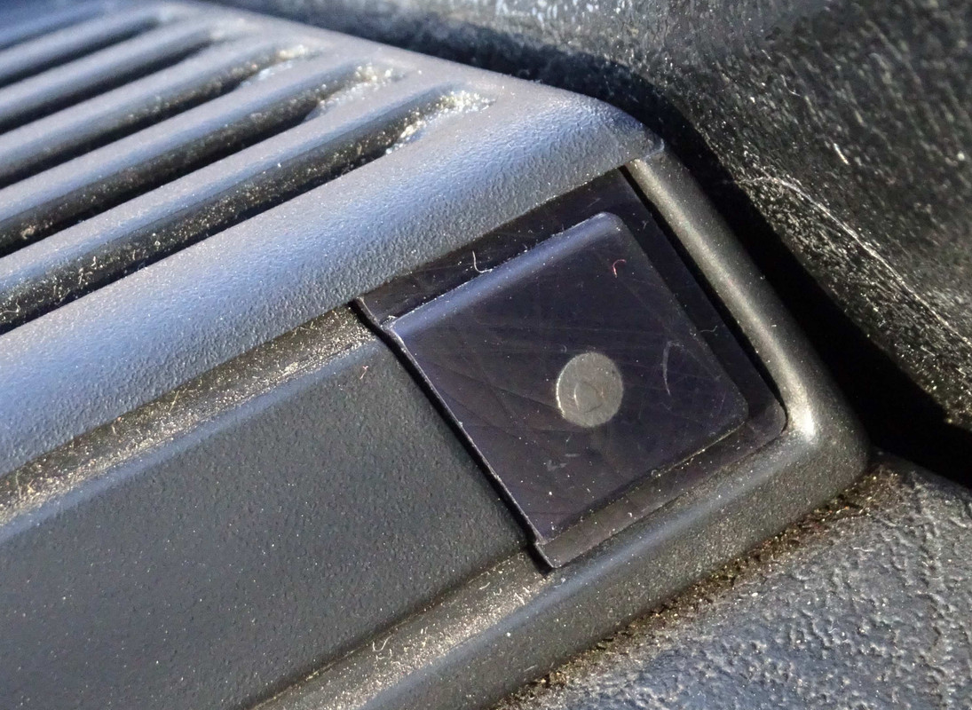

@L90E it's not in my links. i came across, but have not thought it would be needed.
i made a picture of my screwcap (first link of the thread):
unfortunately, the magnet shines through the black resin.
i tried painting the part, but this did not turn out that well
(too shiny and small bubbles on the frame).
is there a way for getting the surface right ?
