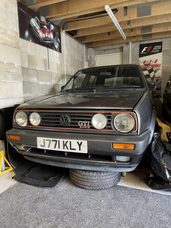

Managed to squeeze another car in my small unit ( 4 cars in a double garage ) with all this rain we’ve had I’ve noticed the golf was getting wet inside . So I’ve put it indoors to strip the interior , needs a new headliner anyway . Then before I sorn it at the end of the month I’ll take it outside to check where the waters coming in . Always so much easier with the interior out .all needs a good clean anyway .

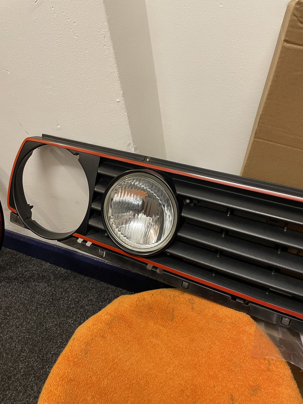

Took a few bits off to do at work . Seem to have been able to bring the red on the grill back with a gentle polish . Before
After
Did the spotlights as well

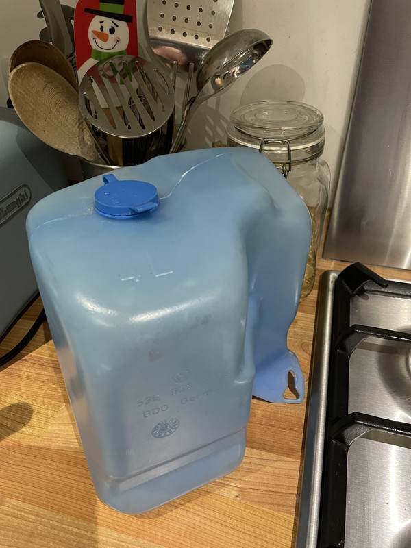

What did you use for the water bottle? A dishwasher tablet in a bucket of hot water did wonders for mine.
Re: Pearl Grey 16v 96k miles
Reply #22 –
I forgot that one . I just used some mould remover and some tfr and kept going back to it . Good job I did it it was full of muck inside

Well with the interior out I have tested to see where the water is coming in. Everywhere pretty much .  The guy I bought the car off never used it and just garaged it for 3 years so that’s why it was so dry when I picked it up .so we’ve got the usual door membranes. All 4 . Rear tail lights . Rear badge grommets.
So all pretty easy fixes . But also the sunroof is leaking . I’m checking that out tomorrow ,
Drains etc. anyway interior is now pretty much out
