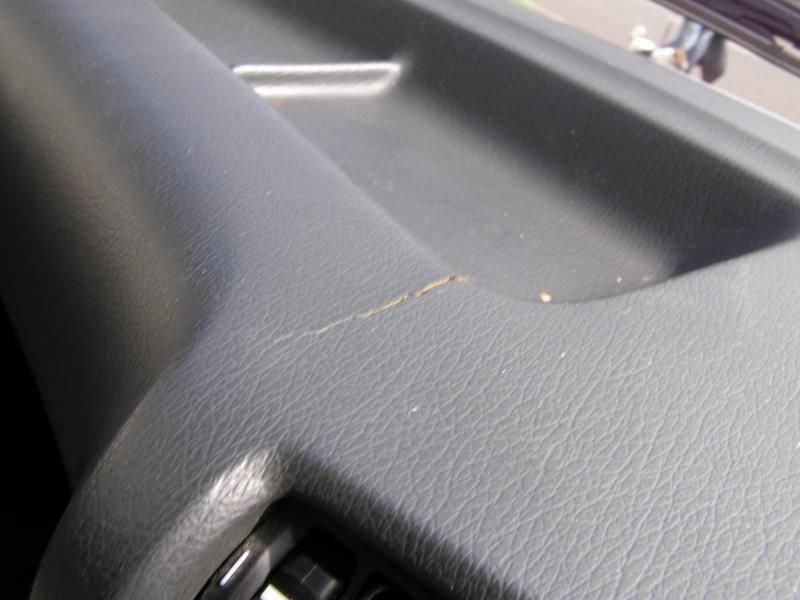

A small crack in the dash

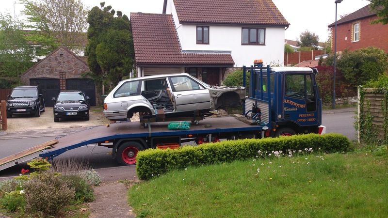

A couple of updates from the weekend. Took the wheels from the one I'm breaking, as they were all in better condition than the ones fitted and got the new tyres fitted, then gave them a bit of a deep clean before fitting...

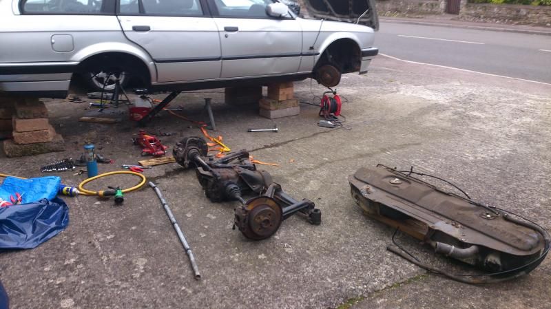

Got this lot dropped.
I remembered to undo the big not in the centre of the hubs and loosen all the bolts on the half-shafts to the cups before removing this time.
Also got the old tank out.... what a crusty old mess that was
Ran into a couple of problems, on one side the centre metal section of the bush stayed attached, shows how knackered the bush was as it fell apart.
And one of the fuel tank bolts sheered off in the bracket, drilled it and tried to use an extraction tool, then the top of that sheered off in the remains of the bolt!
Not great, but pleased to see the general underside of the car is in great shape and no rust.

So lesson to anyone dropping the gearbox, disconnect the water pipes to the heater so no added stress is put on the plastic pipe.
I managed to get it out without removing too may items. I needed to do an oil change anyway and had the stuff so removing the oil filter gave an extra few mm
and I undid the bolts on the lower inlet support bracket and managed to leave the inlet manifold in place which I was very pleased about.
Forgot to add, when I dropped the oil I had to put a long breaker bar on to get the sump plug off. The crush washer had been crushed to a thin tinfoil disc. Unbelievable!
And in an ally sump I'm surprised it hadn't cracked.
the oil change had just been done when I got the car (backed up by clean golden oil on the dip stick, not just the word of the PO) so I'd not done it previously.
Glad to report a new crush washer was fitted and the plug tightened to the appropriate torque... and no leak.

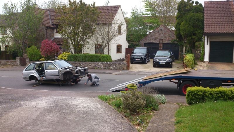

in addition to what I posted on e30zone, there was the breaker I bought, but mainly I left that out of my build thread as the guy I got it off was a member and I promised him I'd take good care of it.  :oops:
but the almost bare shell at the end was bought from a lad down Devon way that was going to rebuild it back up to be a 325.
and finally, just some extra photos for good measure.
